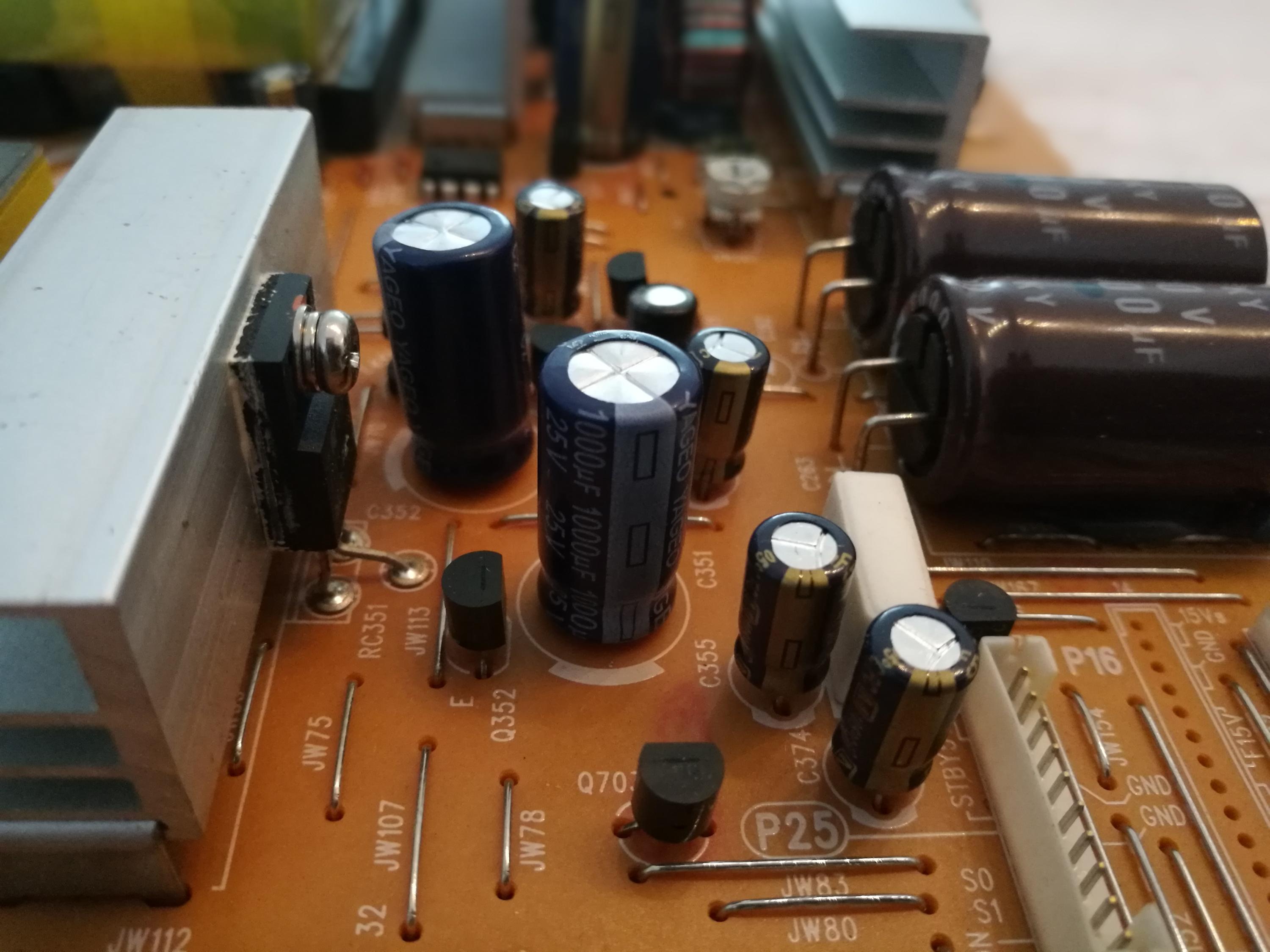

      Ow boy. Somebody tried to replace some capacitors on the powersupply and replaced them for cheaper ones. Bad soldering to be honest.....
      Dont think this is a capacitor problem but i hope i can still fix this board.

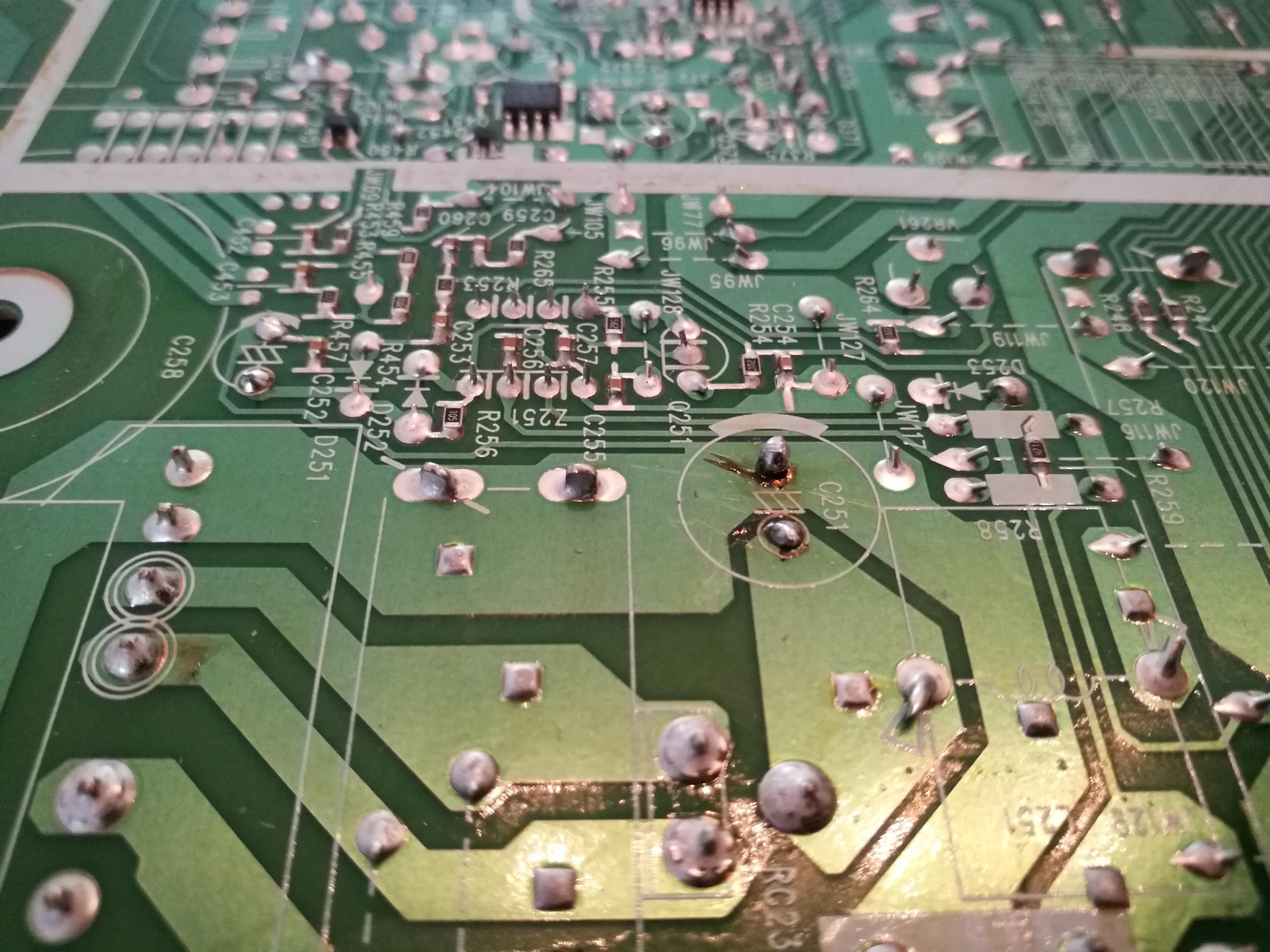

        Resoldered the capacitors but still the same problem.

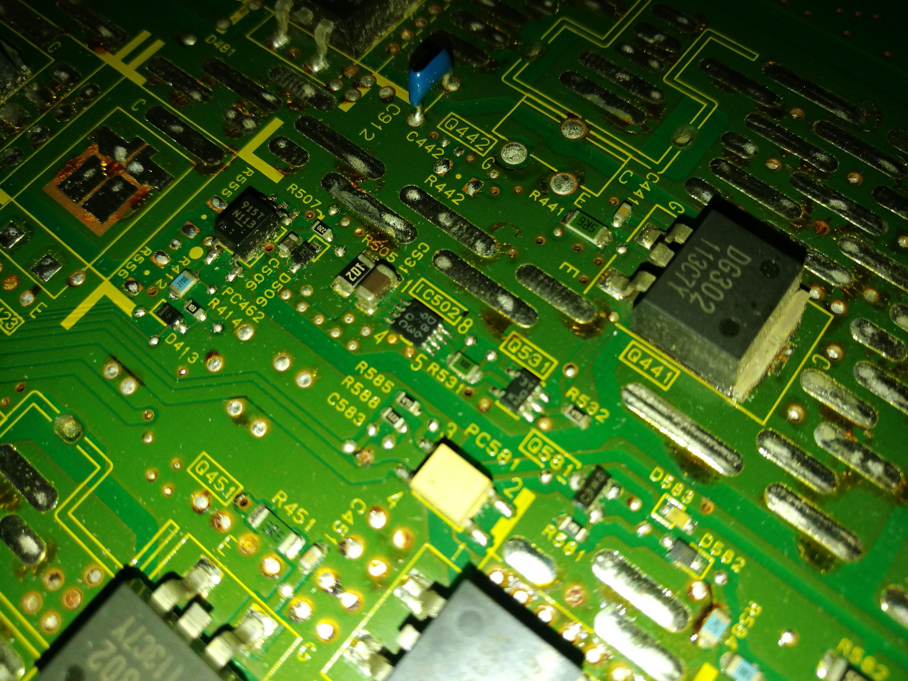

                I was searching the forum for 14 blinks and found a thread from Reecey where he reflowed the audio chip on the mainboard.
                This mainboard has a big CPU which i know from VT/GT/ST models that they get really hot. As i was pretty sure that the mainboard was bad i thought , lets reflow that big cpu.
                Applied flux all around that cpu and reflowed it with a heat gun for a few minutes and let it cool.
                Reinstalled the mainboard and the TV is now working!!!!! Damn , what a gamble!

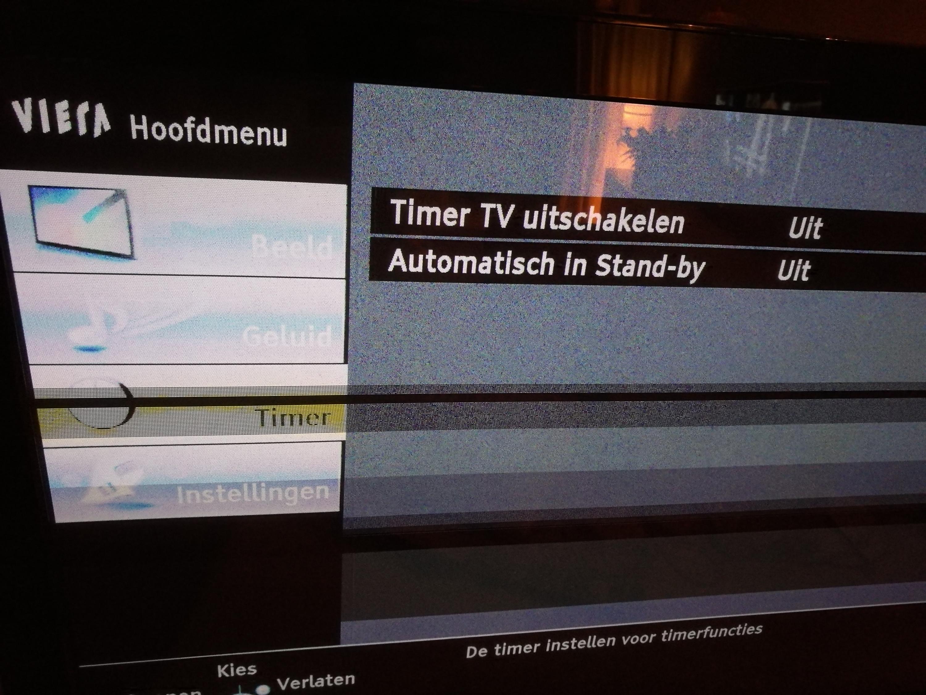

                      Hmmm unfortunately im back to square 1 , picture looked like this and now it wont turn on anymore.
                      It keeps blinking 7 times but i cant find any shorts on the sc board. Is this still a mainboard problem?
                      Will go further test tomorrow.

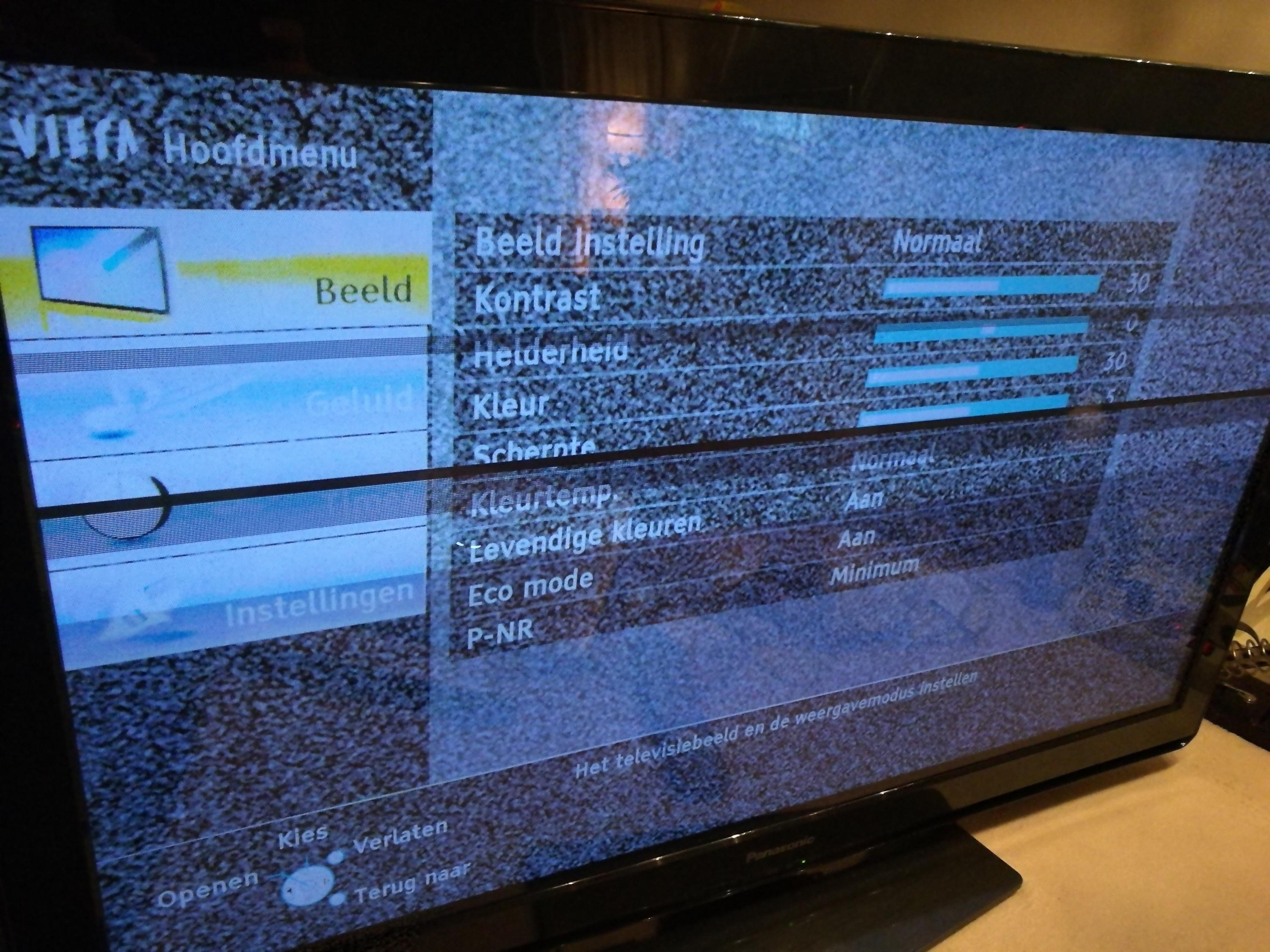

                          It ended to quickly yes!
                          But it only saw 1 HDMI so thats not good either. Will recheck everything tomorrow , i still think that the A board thinks the SC/SN board is blown.
                          Diah has that information out of the service manual that indeed says the infrared sensor is shorted which causes the 14 blink error , service manual is not that great.
                          Lets hope i'll have better luck tomorrow.
                          What causing the negative colours? A board?

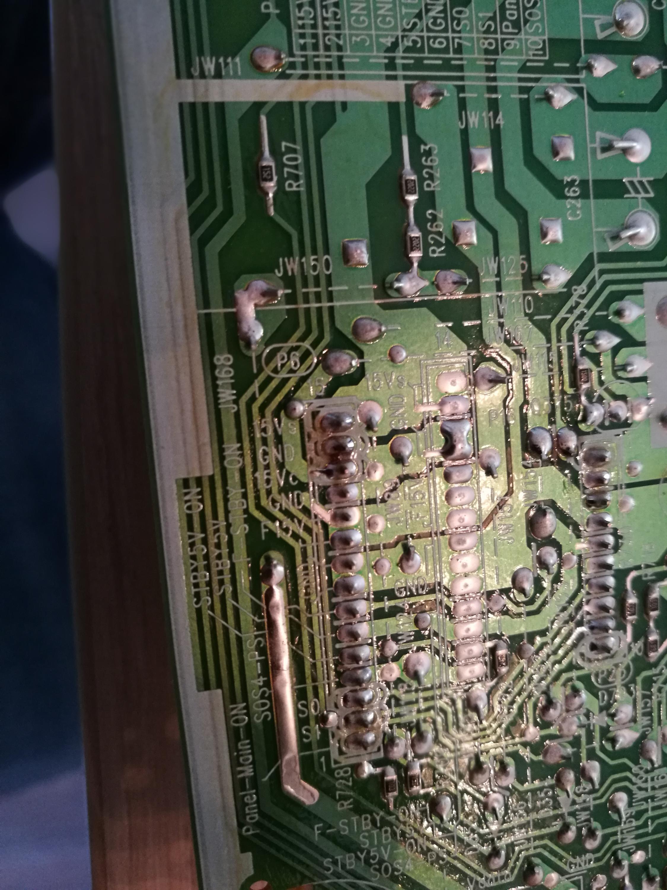

                                    So i took the SC and SS boards out and measured all IGBTS and Diodes. They are all ok and almost all measure the same value.
                                    The resistors are all measuring the same value.
                                    I rechecked the buffer boards for shorts but they are fine also.
                                    I measured P2 connector and it measures 207v when i turn it on and then changes to 215v and shuts down with a 7 blink.
                                    So im lost here and need some help. It's either a bad SC board or the mainboard is detecting something thats not there. As i dont have a mainboard i want to recheck the SC board.
                                    I have a spare repare kit for the VT30/50 , the same small transistor on the sc board is identical so i might replace it.
                                    This all happened after i rechecked the SC20 cable and reseated the ribbon cables.
