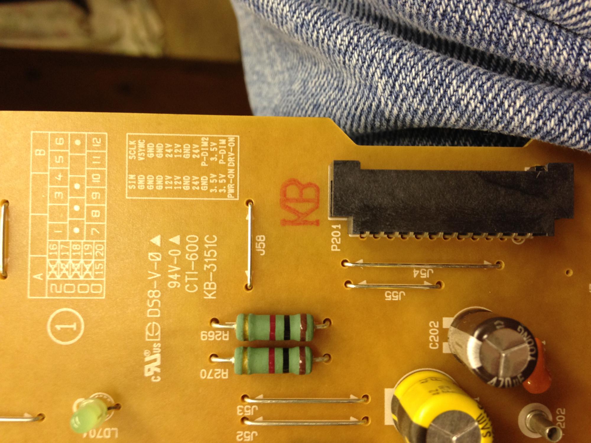

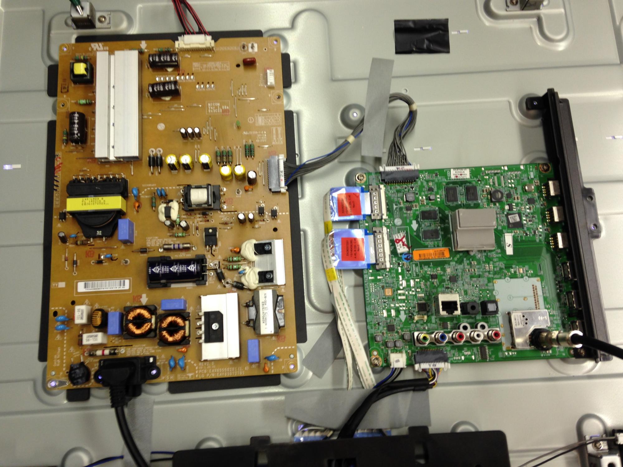

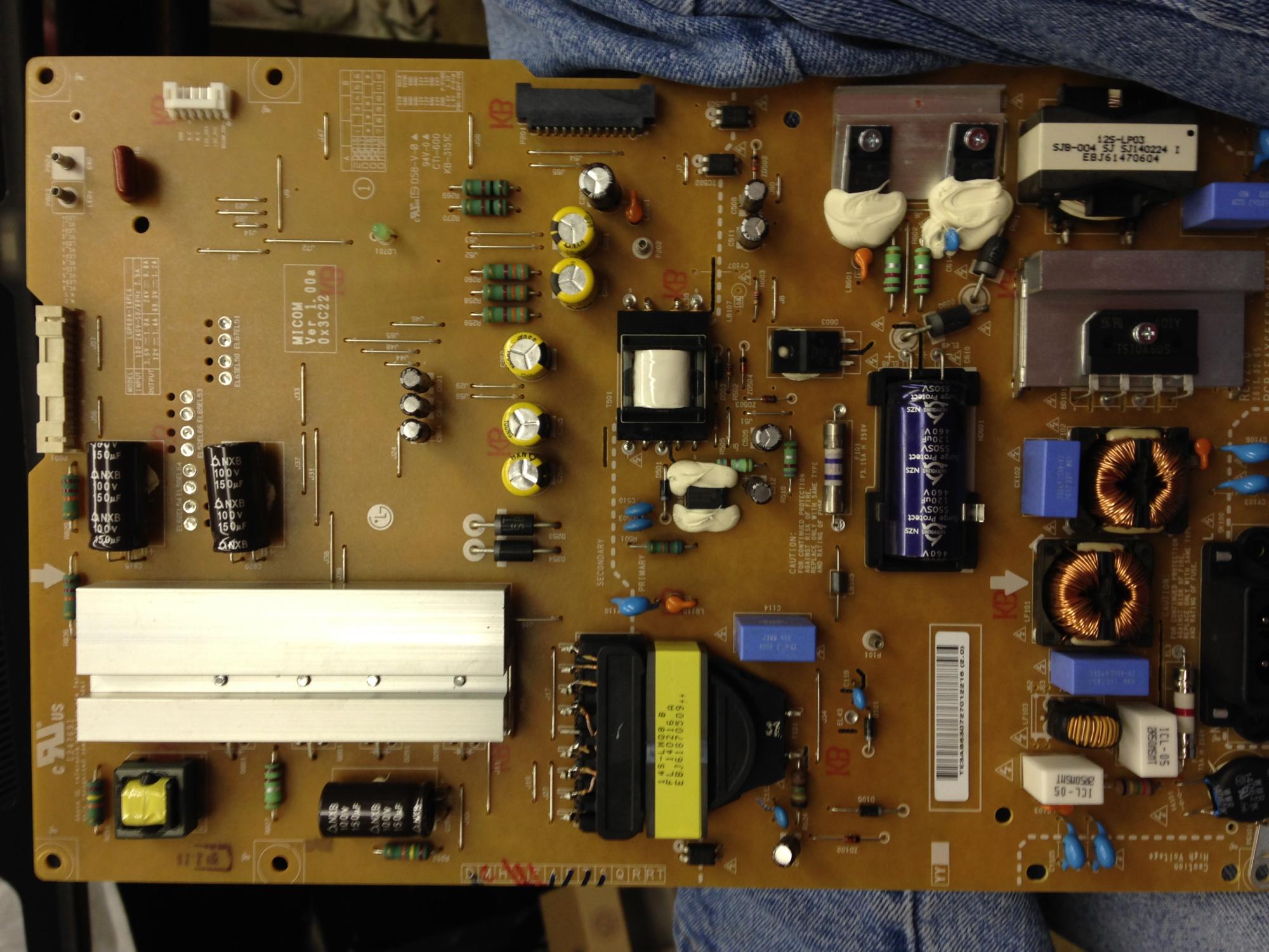

    LG 60LB7100-UT backlights turn on then go out .
    When the set turns on I see the LG logo . Then it goes dark . Flashlight shows no video on the the screen . I also get no command from the remote . Only way to turn off is to unplug it . There is a flashing LEd light on the power board LD701. It blinks 4 times and pauses and 4 more blinks . It will eventually stop and turn off the tv after 5min . 3.5v & 12v & 24v are present . I can't find a service manual on this set . Has anyone seen this problem on this set before ? I have checked the LED's and all of them light up .

    Re: LG 60LB7100-UT backlights turn on then go out .

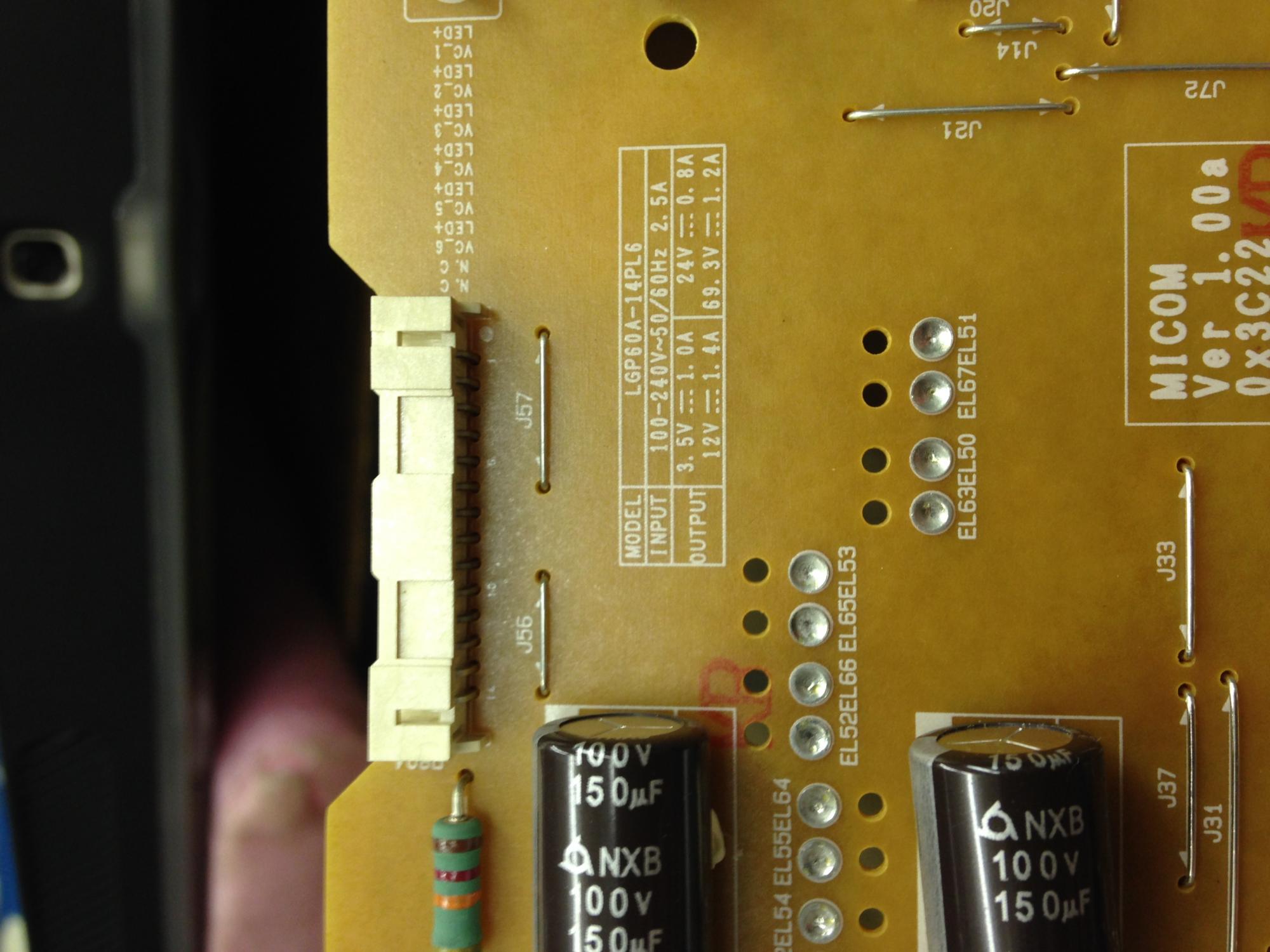

    Two more pics

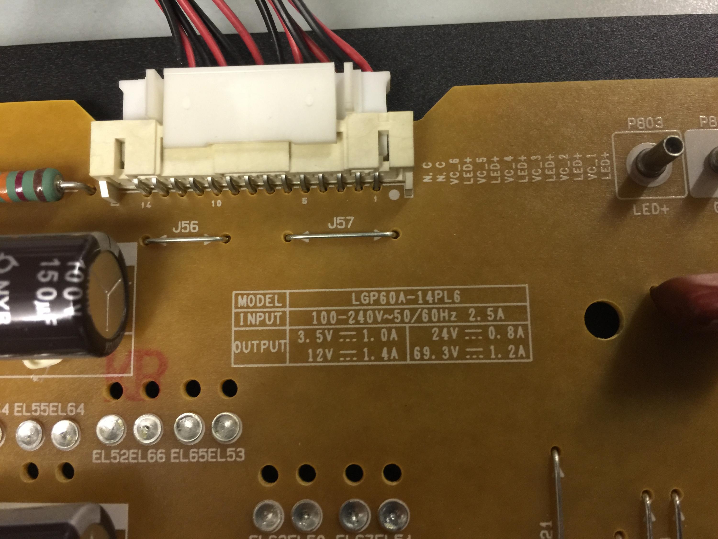

      Not sure what I'm doing wrong but it wouldn't let me send all three photos at once . I'm sure it's my problem ! :
          https://www.badcaps.net/forum/attach...7&d=1468274024
          Please report other DCV readings of all the pins not just the 3.5VDC, 12VDC, and 24VDC.

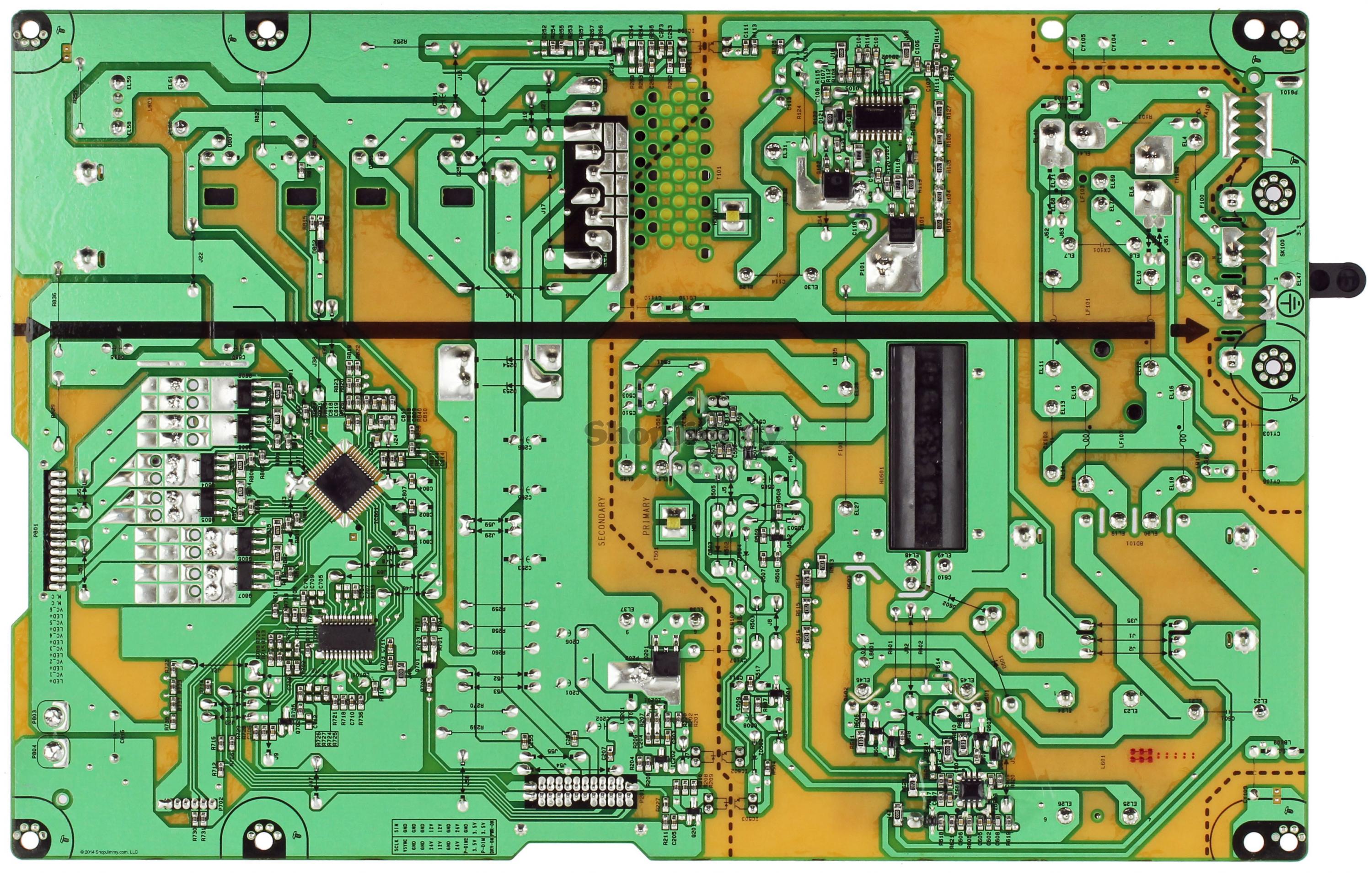

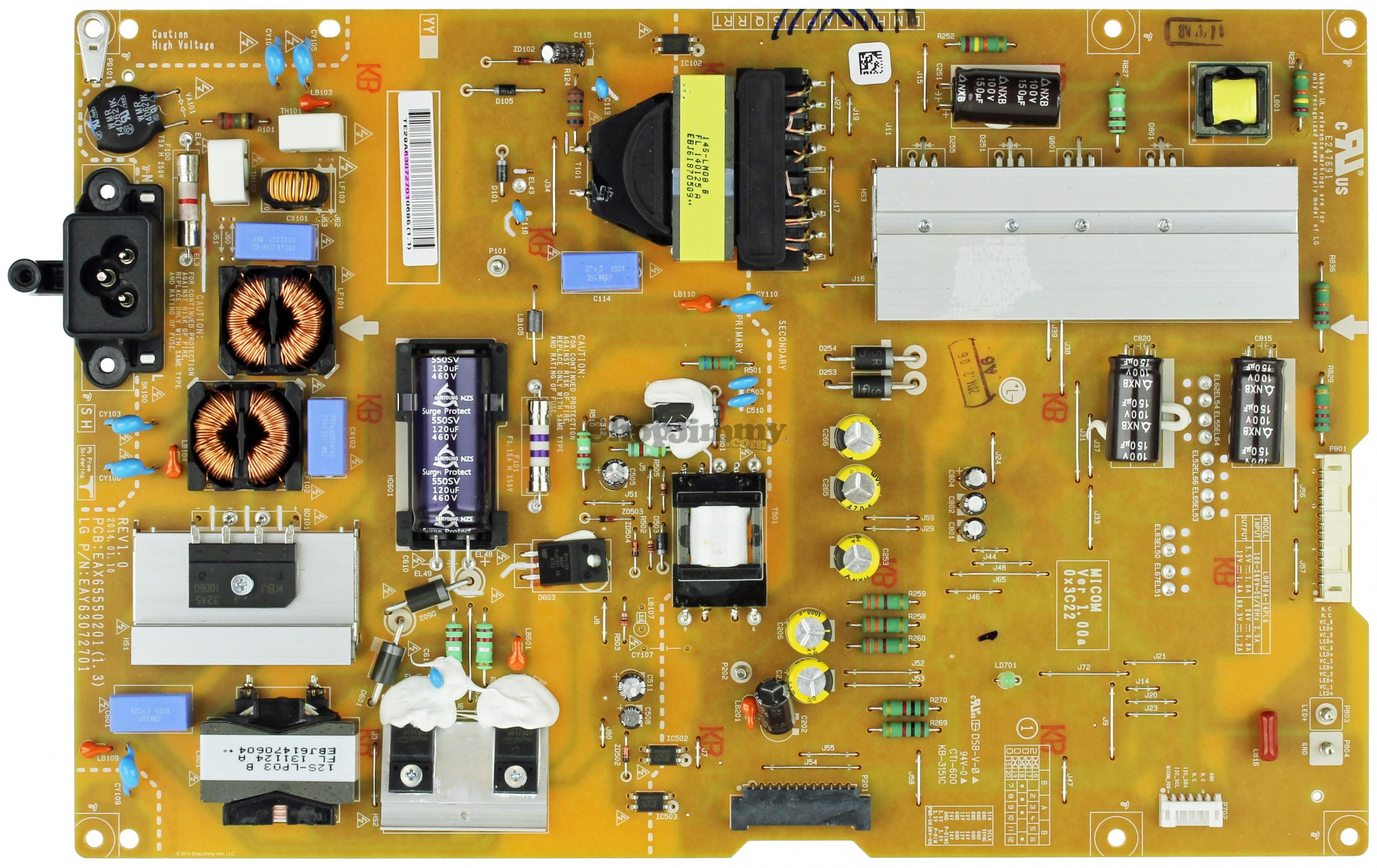

          http://www.shopjimmy.com/lg-eay63072...led-board.htm#
          LG EAY63072701 Power Supply / LED Board for 60LB7100-UT
          Pictures provided by shopjimmy.
          You should also upload pictures of the whole backside of the TV showing all the boards.
          ' Only way to turn off is to unplug it .' This indicate main board problem.
          BTW, do the backlights stay on if you disconnect the cable between the main board and the power supply/LED driver board?
            SCLK .895 at startup then goes to .085
            VSYNC .395 at startup then goes to .010
            SIN 3.2
            P-DiM1 1.7
            P-DIM 3.2
            DRY on 3.1
            PWR on 3.4
            These are the other voltages .
                  Ok tv went back out yesterday . Here are those voltages .
                  SCLK / .086
                  Vsync / .011
                  Sin / 3.19
                  P-Dim1 / 2.44
                  P-Dim2 / 1.735
                  Dry on / 3.128
                  Pwr on / 3.14
                  24v , 12v , 3.5v working
                  Voltages to backlights connector
                  Led + \ 55.5v
                  VC1 / 9.96v
                  Led + \ 55.5
                  VC2 / 9.05
                  Led + \ 55.5
                  VC3 / 11.9
                  Led + \ 55.5
                  VC4 / 8.82
                  Led + \ 55.5
                  VC5 / 9.3
                  Led + \ 55.5
                  VC6 / 9.3
                  Any ideas ?
                  • cooper trace
                    • May 2013
                    • 17
                    Ok so running tv with no picture for almost an hour then turning it off then back on I get a picture back . Here are voltages that are different when it works .
                    Sin / no picture 3.189v - with a pic .128v
                    P-Dim2 / no picture 1.735v -with a pic 3.53v
                    On the led output connector :
                    Led+'s \ when not working 55.5v when has a pic 72v
                    VC 1 thru 6 / when not working voltages range from 9v to 11.9 - when has a pic they range from 9v to 18v
                    So with the changes in the Sin and P-dim2 voltages would that be my digital main is faulty ?
