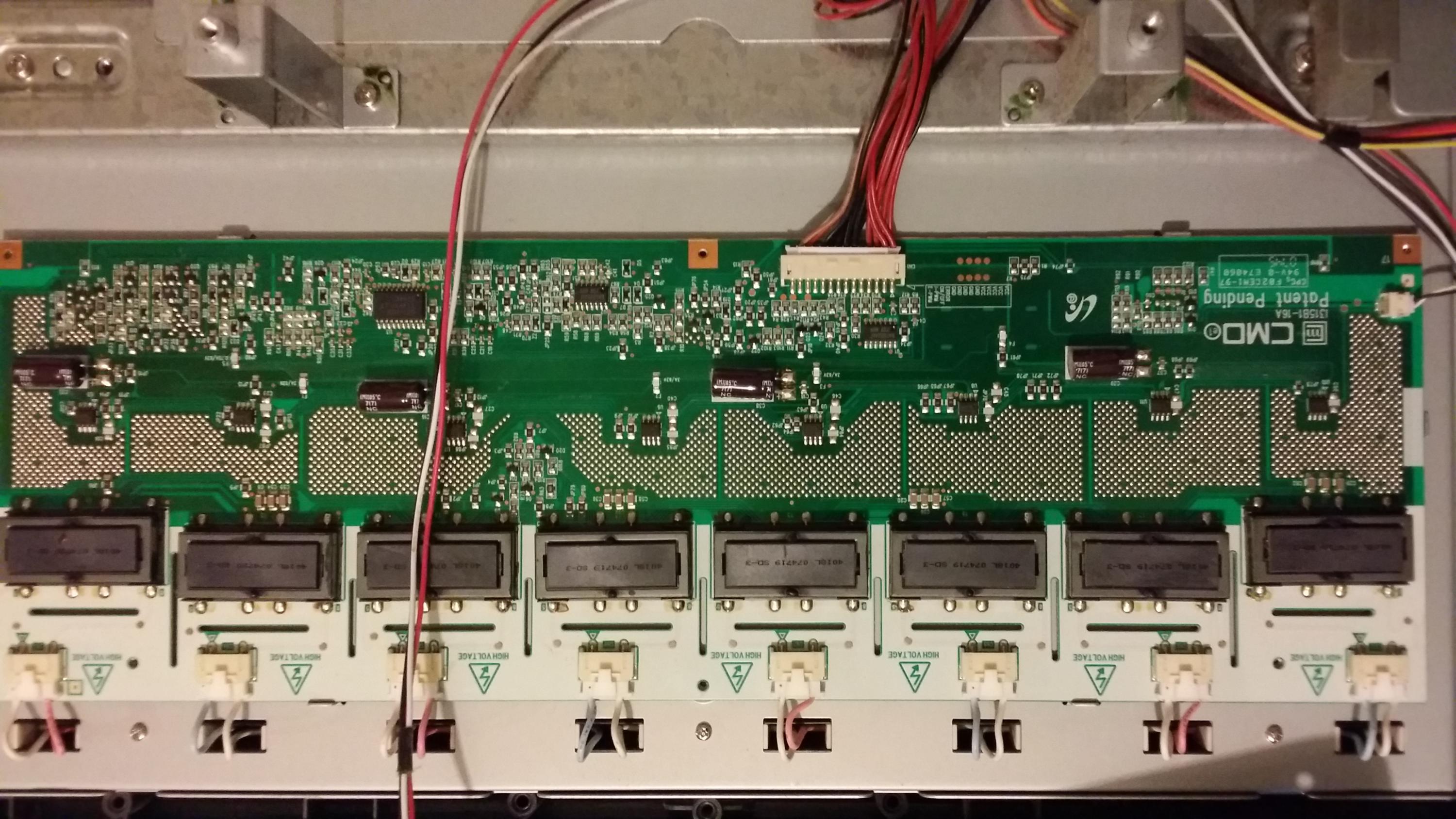

    I think I have narrowed it down to the Inverter Board or the Lamps.

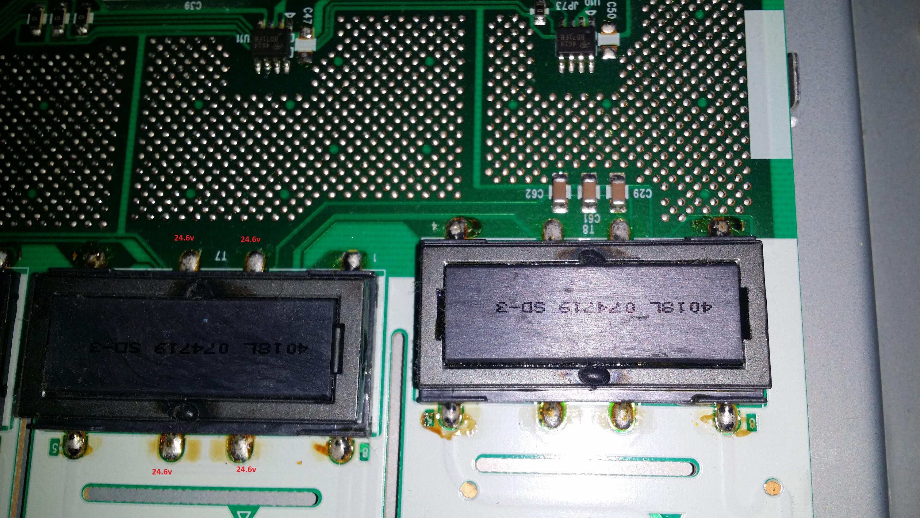

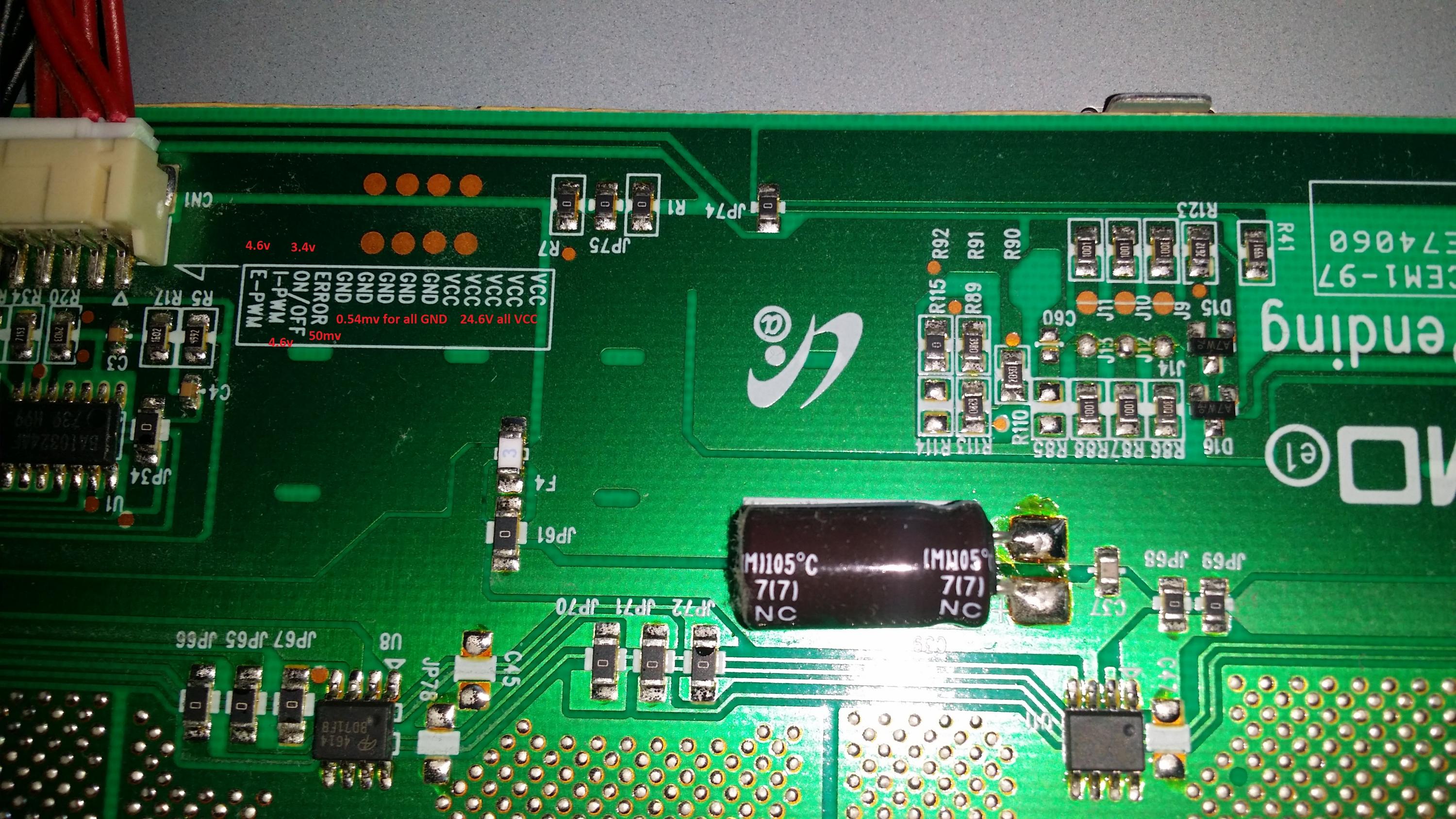

    I have attached a few pics with the voltages.
    I am not sure how to test the primary side of the inverter. The secondary side (inner posts/bindings) I get 24.6V. I have 24.6v on all sides of the white fuses (F1-F4). I did not see a black Fuse anywhere on the board.
    Inverter board is I315B1-16A-C302G.
    All the voltages stay the same when going from standby to On except the error on the inverter, it spikes to 154mvish and then drops back down to the 50mv range.

          I think I have a bad inverter board.
          I have 24.xVDC across all fuses.
          I have 24VDV at the primary side input and output on all the inverters.
          When hooking up a CFL bulb to each CFL connecter (keeping all others connected) it lights up but I still have 2s to black. Voltages steady on input side and output side.
          I am getting a bad IC, shorted SMD Diode. Part order and we shall see....

            Sounds like a failed transformer to me, do you know how to test them ?
              Re: 2s to black. Proscan 32LB30Q
              I read in the links provided earlier in the post. I have up to 20% variance betweeen all 8.
                From memory I believe that anything over 3% is considered as bad.
                  Can you show which pins you use for testing the resistance of the inverter transformer, and what reading did you get?
                  BTW, there are two high voltage windings for each transformer.
                    using this as a guide: http://www.lcdparts.net/TransformerD...ProductID=3497
                    P1-P2: 0.8 Ohm
                    P3-p4: 0.8 ohm
                    S1-S2: 1.022-1026 Kohms
                    S3-S4: 1.032-1.036 Kohms except 1... It was 1.154K ohms
                    Bad inverter?
                      Sound like you do have one bad inverter transformer.
                        Inverter replaced and Backlights stay on. Victory!
