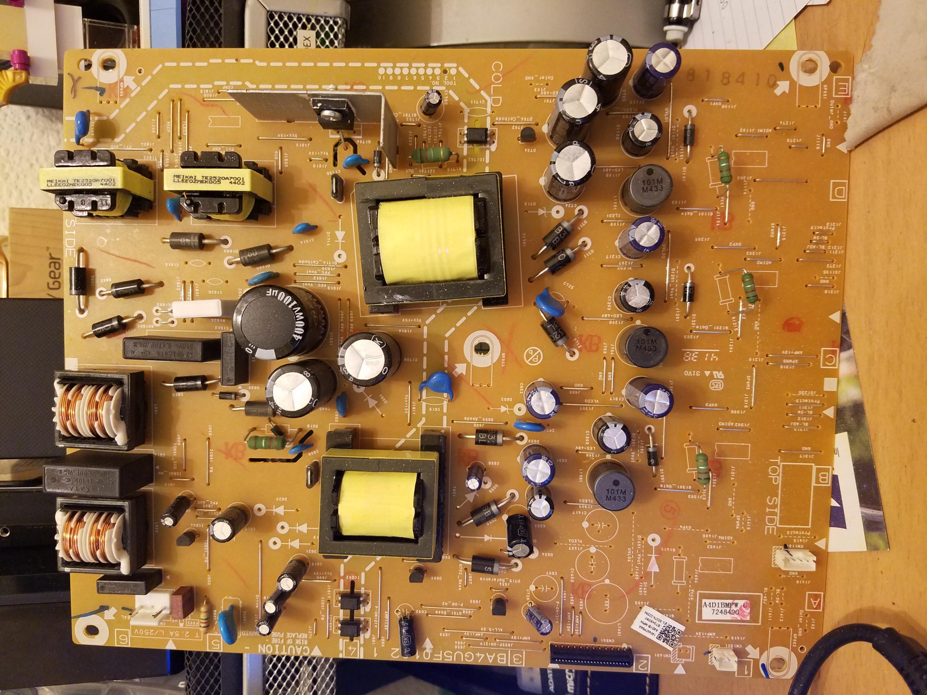

    I have a philips tv won't turn on.
    I replace twice the power supply board and won't come on.
    The fuse is good.
    The weird thing is the metal lines around the board show voltages to half.
    Means the p. On show need to be 24v and i get 12v
    and the another ones show low voltages.
    Like i said, i replace two times the power supply and still same problem.

        The AMP13V and ON21V will be at about 605 of the rating at standby, when the P-ON_H2 signal is present then then those Voltage will be at normal level as printed on the board.
        BTW, your board is similar as in this post:
        https://www.badcaps.net/forum/showth...hlight=P-ON-H2
        Read how we test the board by itself.

          I checked all 3.3v and are present.
          3.3v is stand by on led tvs?
          Anyway, after read the post that you talked about
          I going to order the digital board
          See what happend.

                Well I check p-on_h2 short with 3.3v and now I get 21.11v
                on led connector I get
                3.7v
                47v
                3.7v
                47v
                but backlight doesn't come on the tv.
                Means????

                    Well I follow the thread like you suggest and I find backlight is no turn on.
                    Short with 1k resistors p-on/3.3v and 3.3v/backlight sw
                    Protection pins show voltage <1 volts.
                    So???

                            The STBY power supply is seperate and is always on. So if you have nothing there either you got no voltage in the primary feeding it, there is something wrong with the STBY circuit in the primary, or ther is something shorted in the secondary of the STBY circuit, or it gets loaded down hard.
                              Re: Philips 49pfl4609f7 won't turn on
                              Well. Good news
                              I don't how, but, after replace main board the tv is working again.
                              Thanks to everybody.
