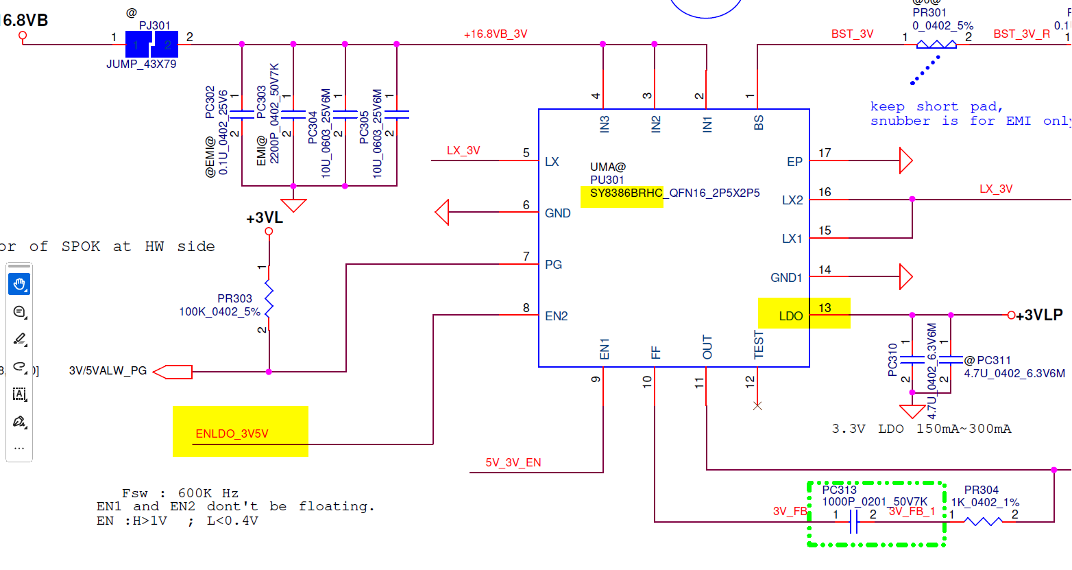

    Hello.
    Have this Thinkbook 15 G2 ITL that have burned USB-C controller U24. After replace i have main VIN voltage, but no ALW voltage. PU301 have VIN but no LDO and other voltages. i relace ic but still the same.
    ic is SY8386. LDO should be working right after vin ?
    board code is LA-K052P
    any hint?

          From the schematics of K051 (hopefully similar) PU301 LDO output has enable pin. It gets a value from resistor voltage divider, might be worth checking out.
          • mon2
            • Dec 2019
            • 14677
            Good point khaahk
            Was this controller replaced with 100% of the same type? The suffix of the part # are important.
            Review the voltage to ground of EN2 pin # 8 = enable for the LDO rail.

              Originally posted by mon2
              Good point khaahk
              no signal to EN1 or EN2

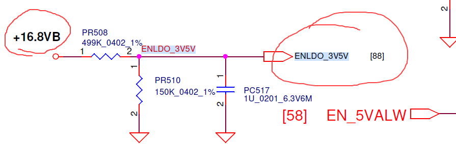

                Review the resistors that build up the enable line trigger for this LDO.
                Do you have the main voltage rail arriving at resistor @ PR508?
