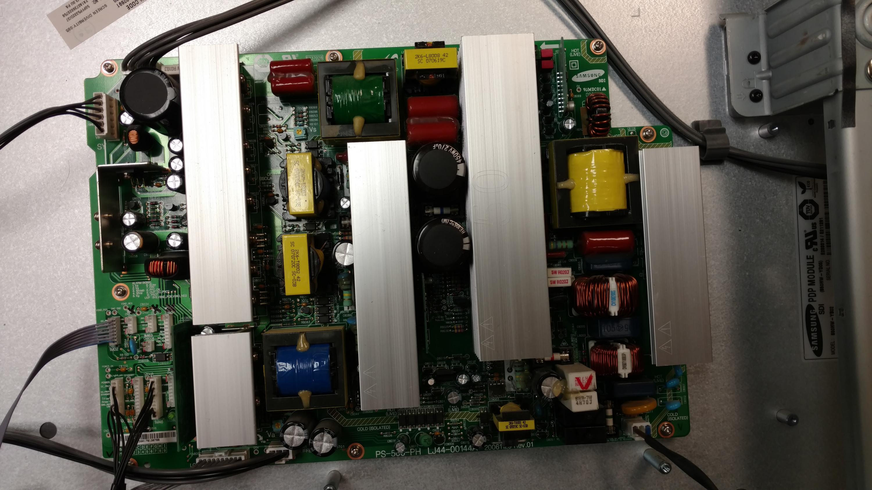

    I've been trying to figure out this 50" plasma for a couple of weeks. This one is stumping me because I've not seen this symptom and this TV doesn't have puffed caps like I usually see with this model.
    Upon plug in, it attempts to power up, relay clicks a couple times, seems to go into shutdown, the led on the front doesn't light up. There is an LED on the power supply board (location: LED8001) that blinks green 10 times. According to the chart printed above that, it says: PROT. UVP: 8V6 VSND_POS, VSND_NEG. I don't know what this means. I've downloaded the chassis EJ3.0U PA service manual from Elektrotanya, but can't find reference to this LED or error code. Maybe someone else can? I tried to get a training manual linked in another thread on badcapsforum, but it wasn't available any longer.

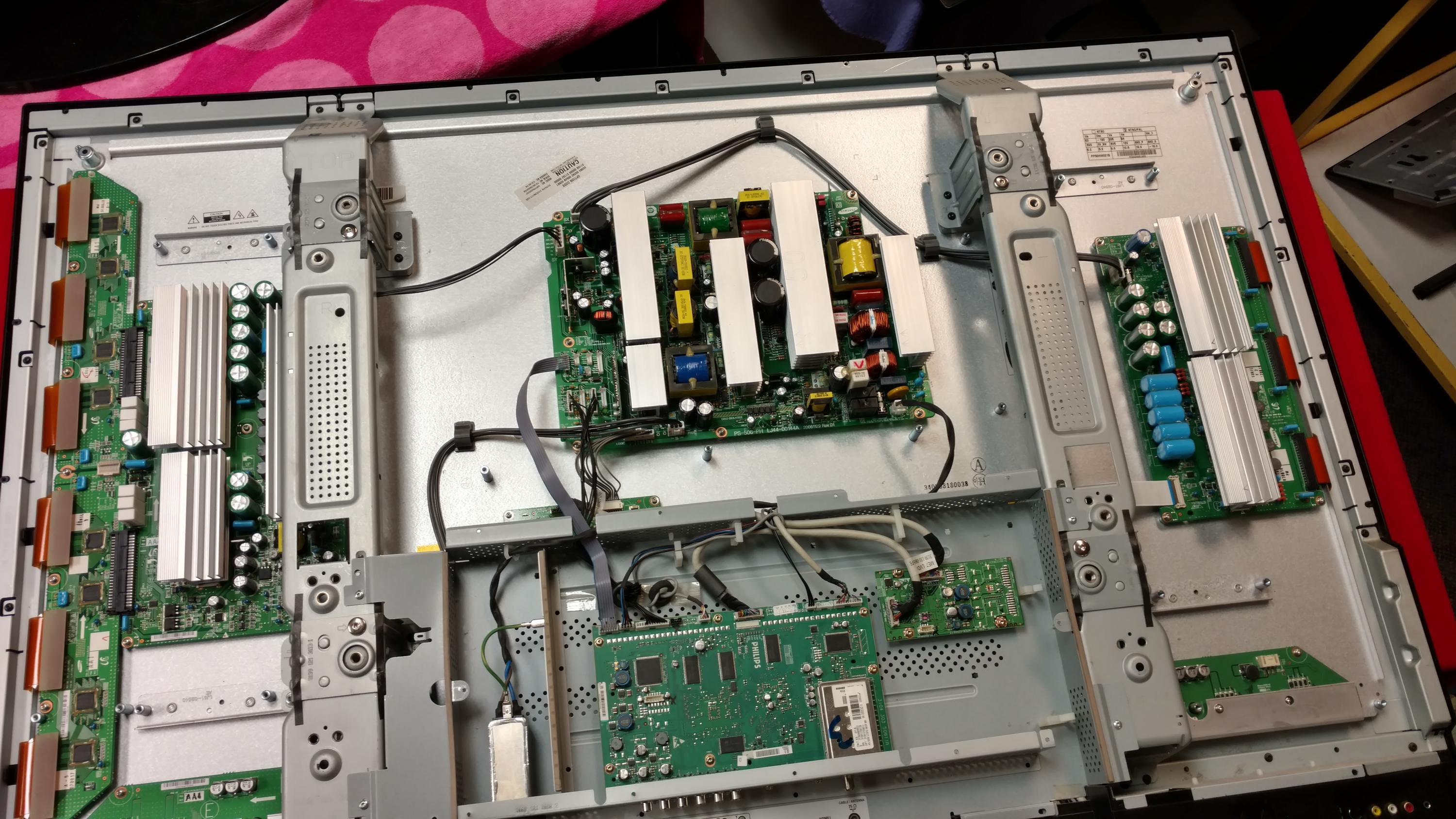

    I will post 8 pics of the TV and boards.

                Thanks. I checked all the fets/transistors and none are blown and no signs of shorting through their insulators. Any other ideas? Wish this one was as evident as yours.

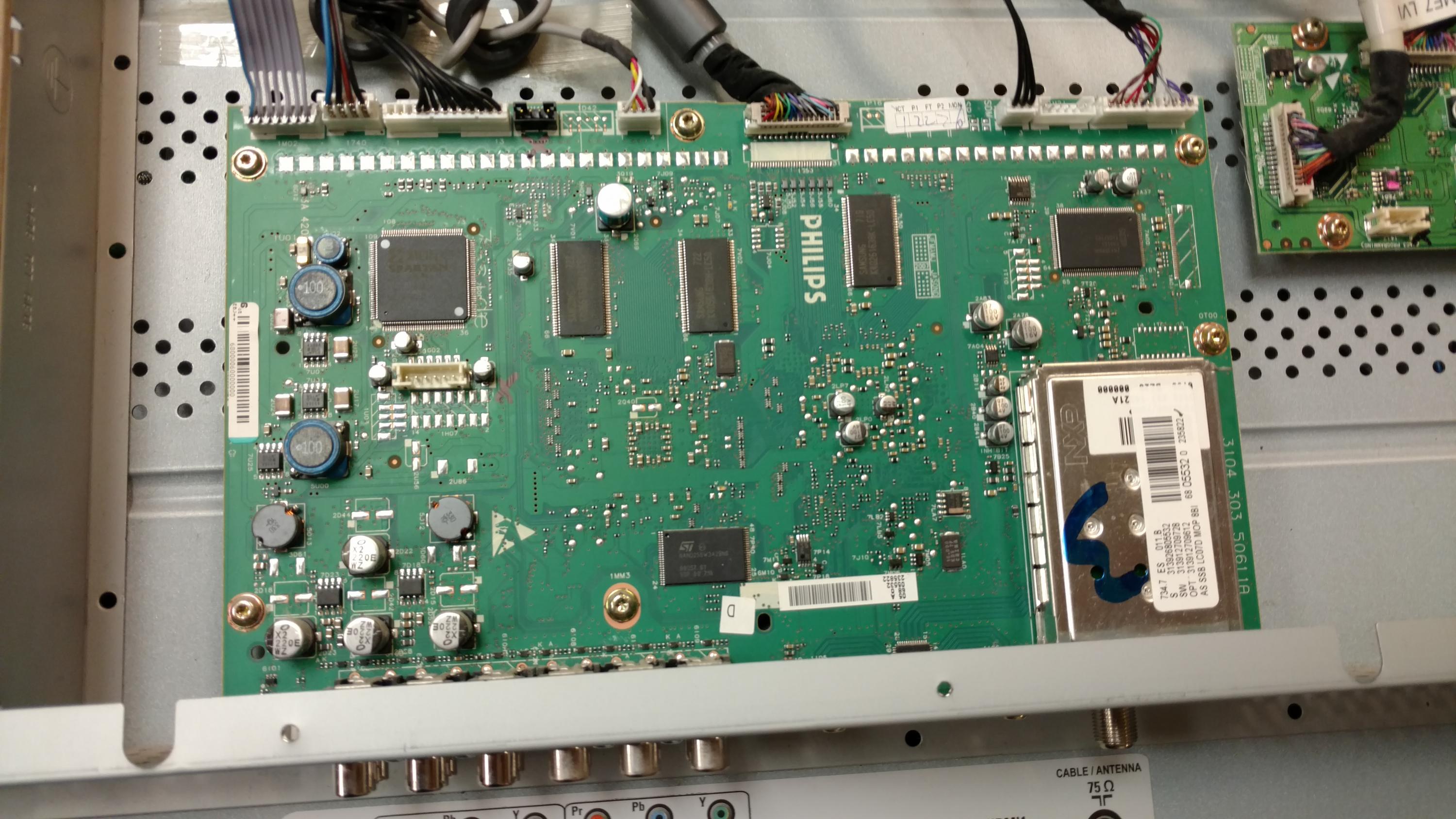

                            Okay, I don't really see an obvious audio amp or something, can someone look at the board pics and point it out to me? I'd like to just replace the audio board if you are sure that is what the error is indicating. I have a great supplier of inexpensive boards.
                              Re: Philips 50PFP5332D/37 TOUGH DOG as they use to say
                              Or is the audio circuit on the main board?
                                Audio amplifier should be on the main board. Look for it in the service manual, should have board diagrams.
