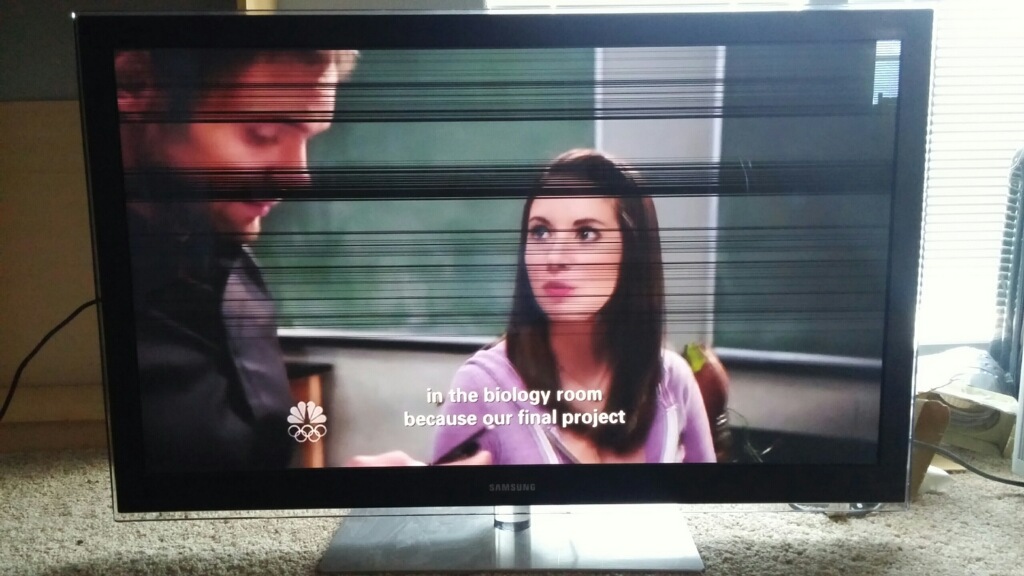

    I'm thinking of buying it for repair but would like someone's opinion. Its a 51" Samsung 3D TV

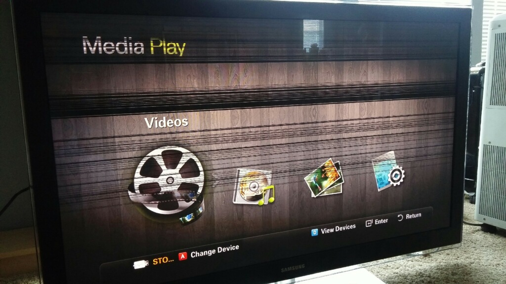

    All I know of are these lines, other than that he says it functions great and a while back had it *calibrated*
    Any ideas are much appreciated!

    Looks like a buffer failure to mean. Ceck out the buffer ics for pitting, burn spots, or holes.!1

      probably would want to get the model and search for common faults. Looks like buufers but I think there were some late models where the panel ribbons chafed and wore through on the chassis in which case not repairable.

        buffer connections or tabs
        Would not pay more that $20 for it

          Panel failure, I would say its not fixable. The ribbon connections from the buffers break off at the glass. Dont spend a penny on it imo.

            Definately a bad Panel, stay away!

                      Yes common issue on all Samsung Plasmas..... Ydrive ribbons break off at the panel right near the glass guess its just a fatigue thing from them being cheaply bonded.
