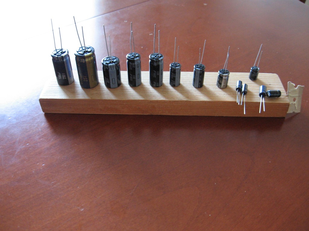

    Are you interested in a Trinitron Sony 21" chassis AE1B that is going to be full recapped?

          Exactly, a lot of caps!
          I'll do the chassis only, not the vertical boards.
          And to be honest, I'll leave the big original elco at the primary.
          All others will be new.
          That sound crazy but it's for a friend.
          Two nichicon PL have eaten 4 square centimeter of copper!
          I told my friend: "You're silly! To reduce a pcb in that condition they must been leaking and smoking since a couple of month! What you're waiting for?
          -stay tuned- elcos will arrive on July 1st.

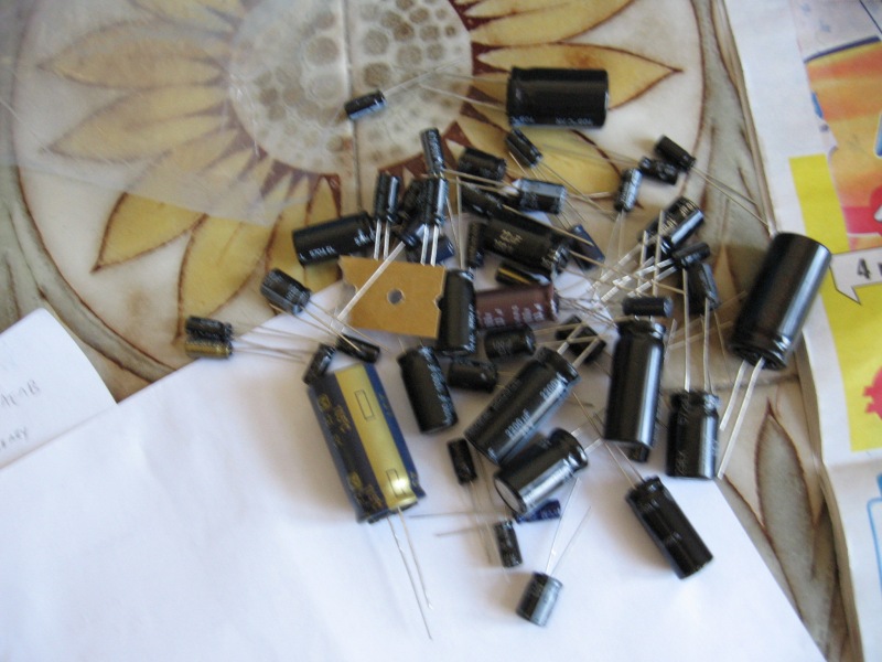

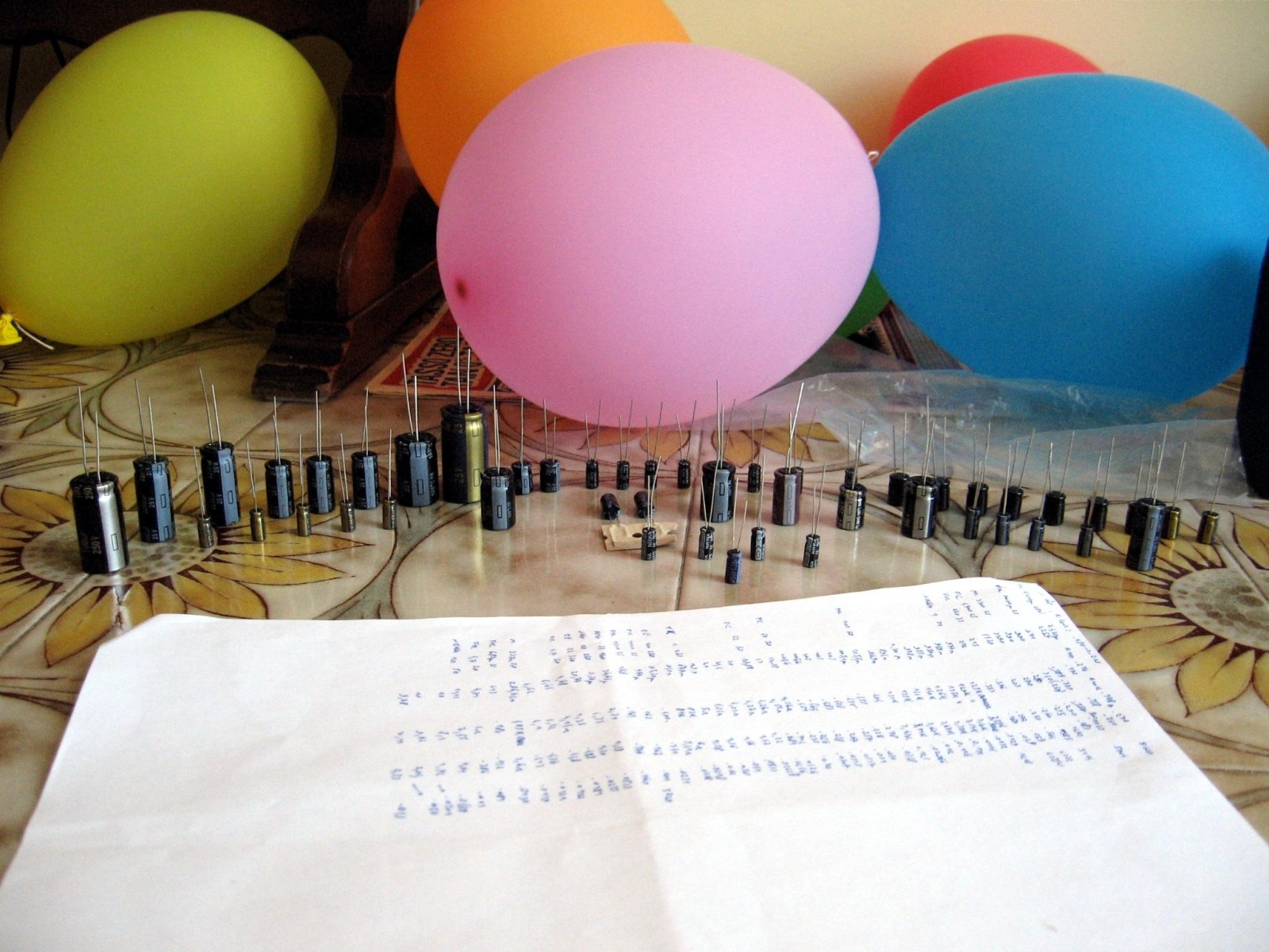

            Re: Sony Trinitron recap -stay tuned-
            The old school treasure
            Arrived!
            Let's the party started
            Some elcos to mount in the next hot days
            Stay tuned.

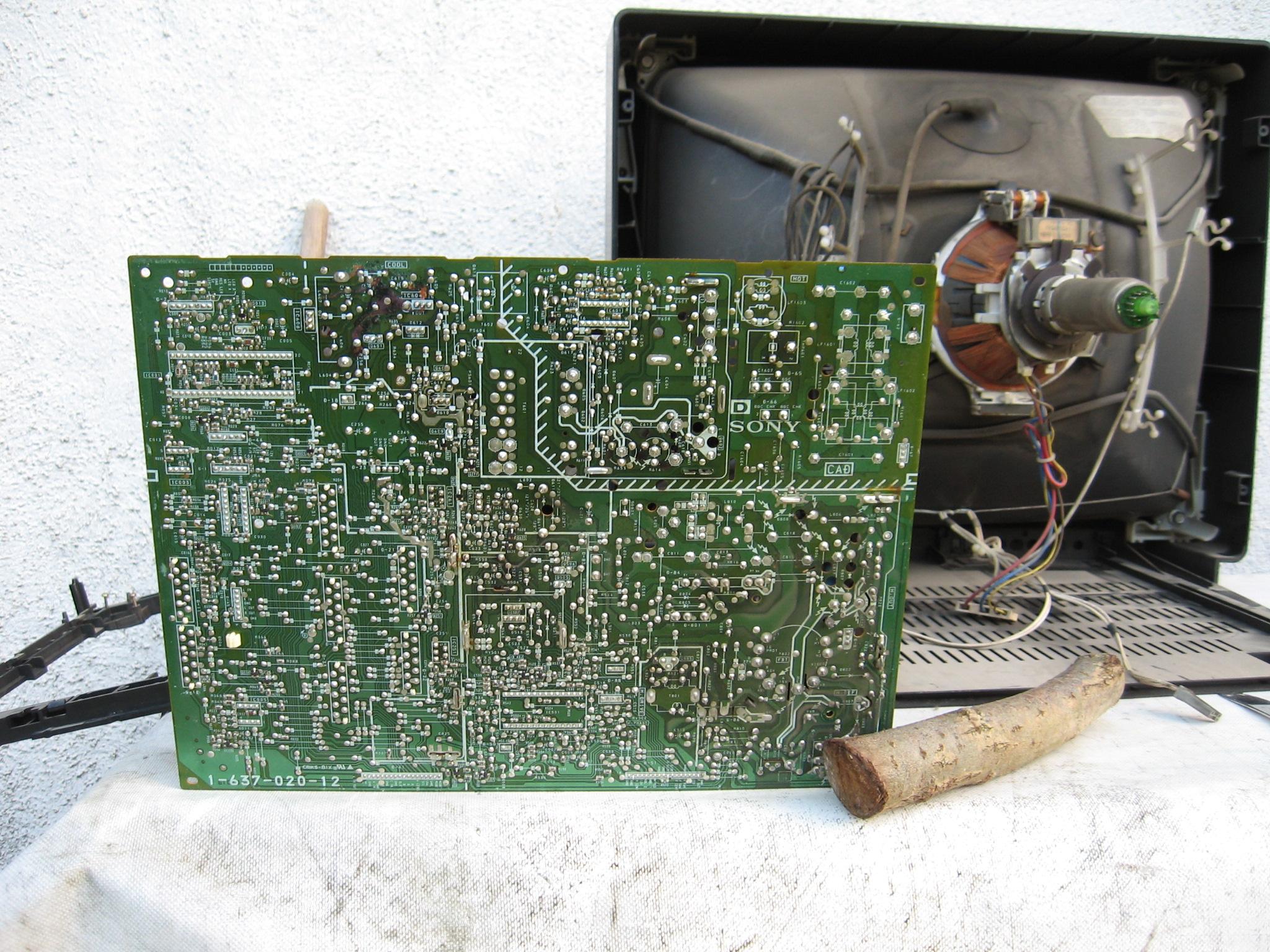

                System is now operative but I need the manual because it need G2 adjustment.
                Never done on Trinitron so I need to read before destroying all the work done till now.
                The chassis needed FULL RESOLD, the vertical boards needed PARTIAL RESOLD,
                the CRT pcb needed FULL RESOLD, the small PCB that link chassis to speaker needed FULL RESOLD.
                So: a lot of Sn-Pb (100-150g), a lot of caps, 4*4 square cm routes destroyed by acid (nichicon PL = bye bye copper )
                If it is NOT YOUR TV, don't do it!
                A lot of time, a lot of components, a lot of Sn-Pb (100-150g)
                Stay tuned.
