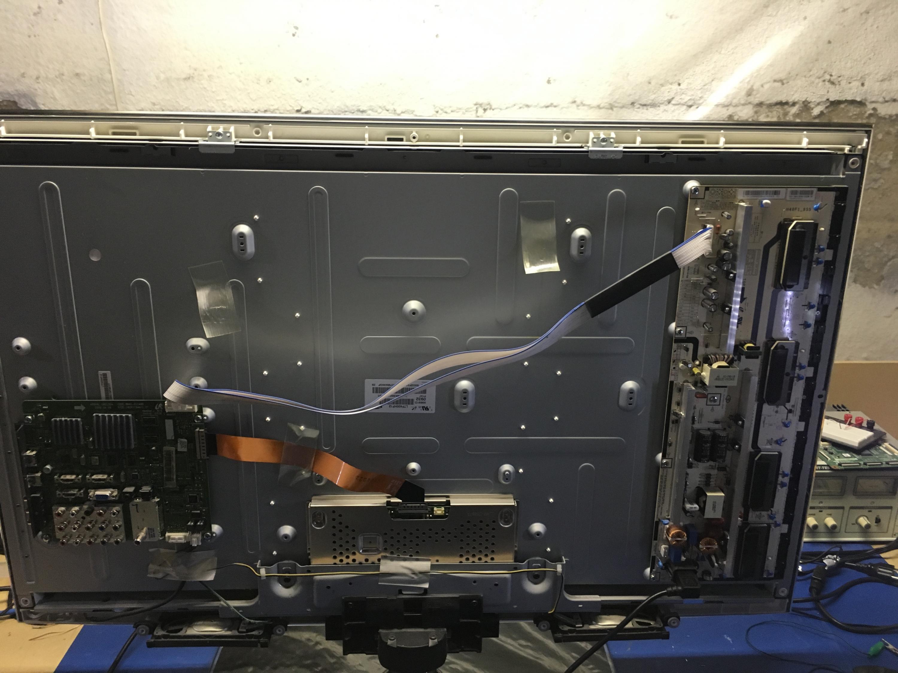

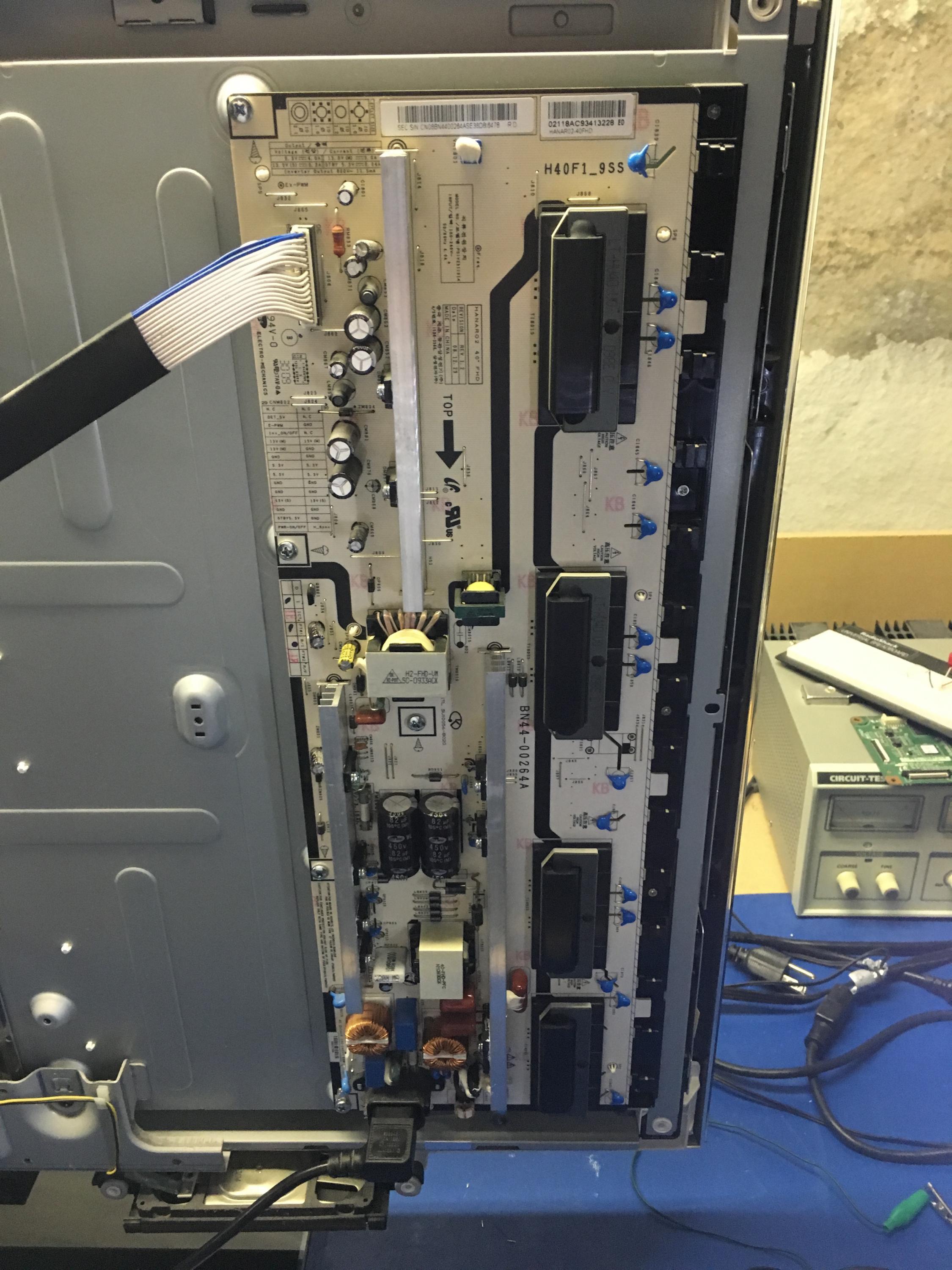

    Hey guys, I have a Samsung LCD TV with a backlight problem. When the tv is powered on, the chime comes on and the screen flickers for a second then nothing. The backlight comes on momentarily. When I do the flashlight test, I see no video.
    I reflowed the solder on all of the transformers and most of the parts on the heat sink. I also get 390V at the main filter caps, so PFC seems ok. I also get 4.7V on the INV ON/OFF pin and I get 5v and 13V. Would this be a board issue or a bad bulb?

        Re: Samsung LN40B610A5F backlight problem
        Unplug the mainboard see if the backlight comes on. Possibly the branch out connectors going to the lamps have worn contacts.
          I tried unplugging the main board and the backlights come on now. I tried this before and it didn't work.
            So that means its the Psu/inverter. Remove it and add fresh solder to the lamp connections they tend to break down over time.
                  The Boosted Voltage stays at 390V and did not dip down below 360VDC?
                  BTW, the high Voltage winding of the inverter transfomers tested OK?
                    I tested the transformers and they were fine. Yes, the PFC voltage did stay at 390V. I also tested the ESR of all the caps and they were all fine.
                      Have you checked the voltage on Pin 16, ENABLE of the SEM2006
                      Enable => 2.0V
                        Its 4.36V on pin 16
                                    thanks dick_barton, I should invest in one. I measured the voltage on pin 17 (FAIL) and it measured 0.66V
