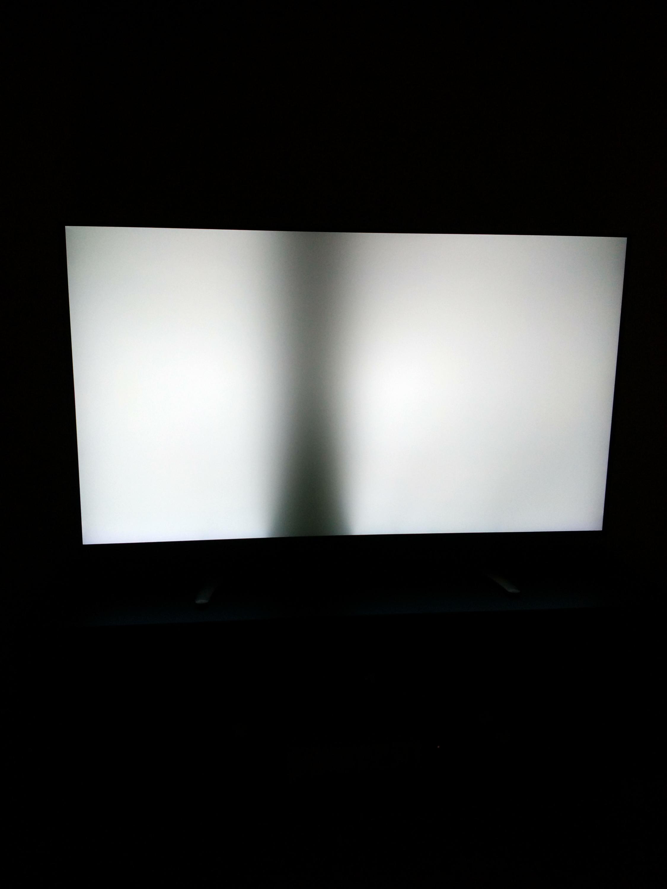

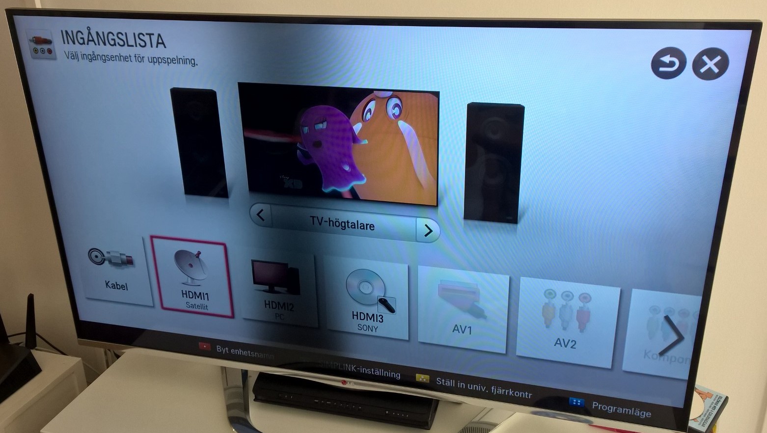

    Hi!
    I have an intermittent issue with my LG 55LA740V LED TV that I would like some help diagnosing. Any ideas welcome.
    A dark vertical band with about 1/6th of the screen width (probably a single LED strip) appears maybe 50% of the times I turn on the TV - the other 50%, it works just fine.
    This is in detail what happens.
    1. Power on - the panel goes up to high brightness. No band, all LED:s seem just fine.
    2. It shows the LG Logo, and starts lowering the brightness of the panel.
    3. The TV finishes booting and starts showing input.
    4. The dark vertical band appears!
    5. On the power/LED driver board (EAX64905801), a diagnostic LED LD701 starts repeatedly flashing four times. (This does NOT happen when the TV starts up normally, so the boards "knows" something is going on.
    6. At the top of the power board, there are two ribbon connectors that goes into the panel with a total of 6 driver voltages pins. 5 of them measures about 50V, and one (no. 3) measures only 7V. At normal startup, all of them measures 50V. Unfortunately I have not been able to measure the pins without the panel attached, since the TV seems to shutdown this output quickly and shows another repeating "3 blink" on the little red led on the power board.

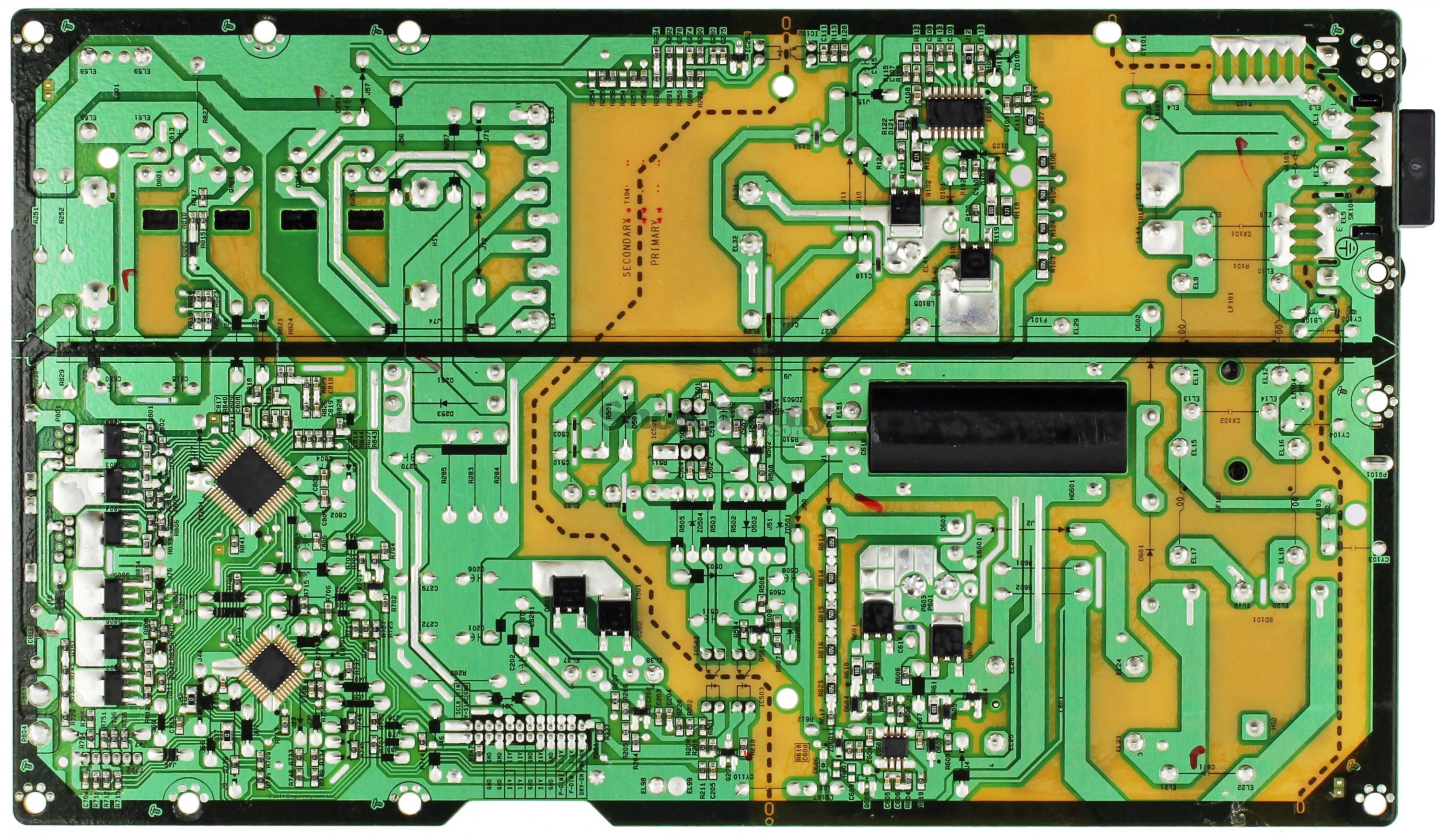

    Can see the pictures of the whole back side of the TV so we can see all the board?
    Straight shot pictures of both sides of the Power supply/LED driver board and close up in the area of the LED connectors?

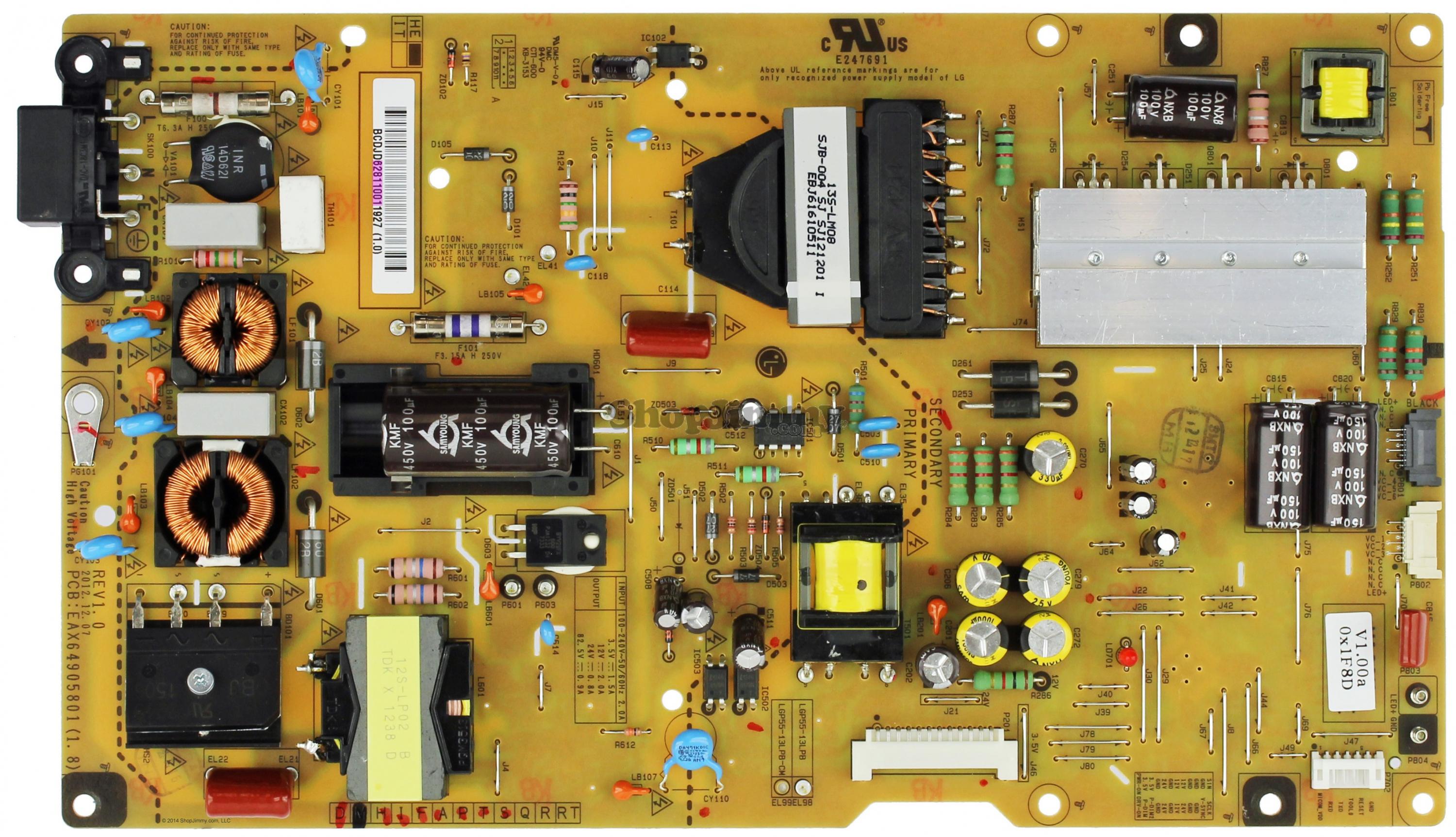

        Lg eay62811001 (eax64905801(1.8)) ps.
        You can also take the DCV reading on the Cathode of the LED strings return pins VC_1~6 (you have six strings of the LEDs) to see what you have.
        Pictures provided by shopjimmy.

              What is interesting is that on initial power up, before the logo is shown, the complete screen lights up - including the area that is darker.
              It is after the logo has disappeared and the current input is being shown that the darker band appears.

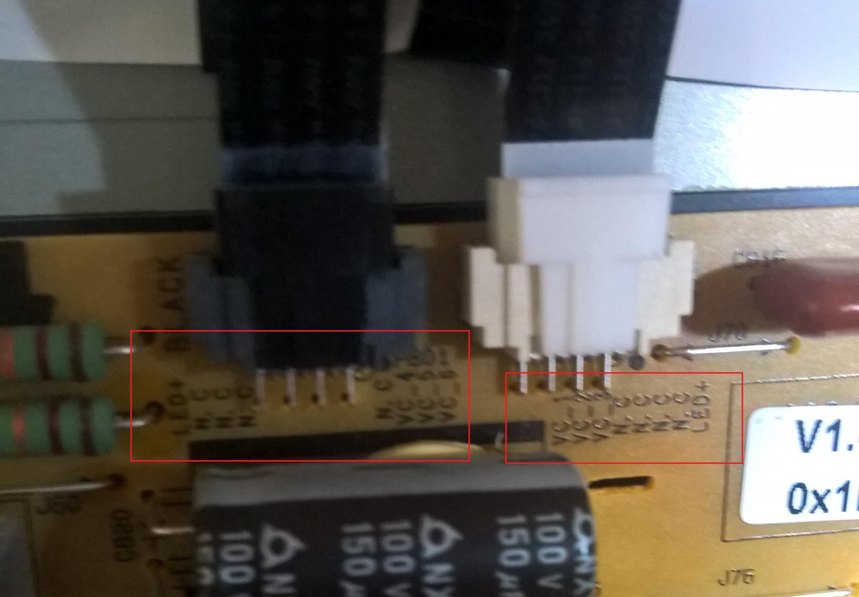

                Have a look at this. For sure I can not swap the cables since the pin-out on the connectors are mirrored?
                One idea would be to try to fit the cables 180 degrees around, since the pins then would be in the right places. Not sure that this is even physically possible though. Don't want to fry anything...
                Sorry for the blurry image...

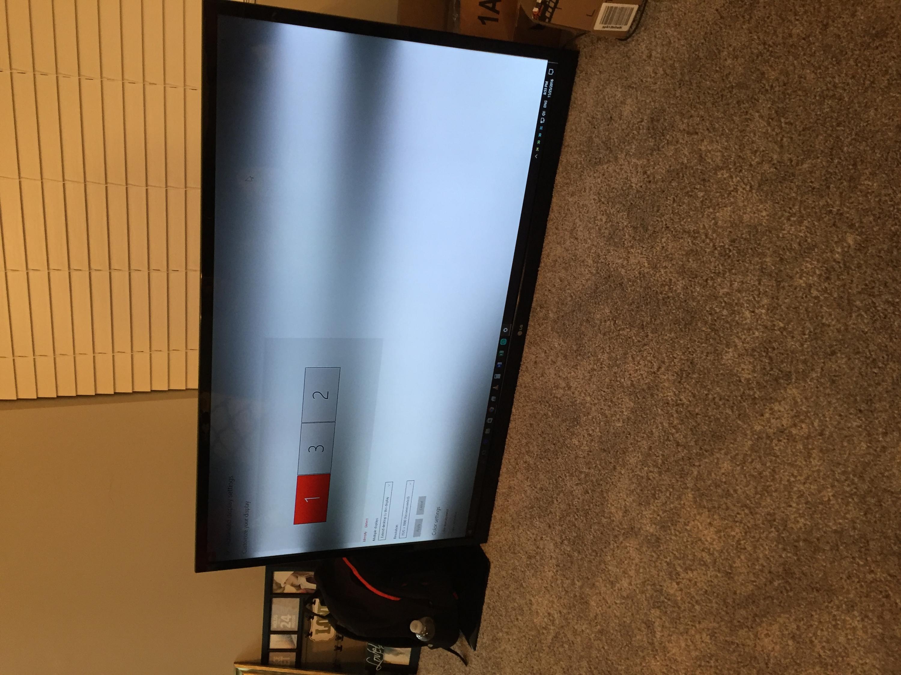

                    I have pretty much the same problem (slightly different TV 55LS4500) with a light labeled LD701 flashing 4 times when parts of the led strips have gone dim. And it's not always the same ones, although its always on the top, sometimes different sides, sometimes all of them. It seems to happen either when there's no input and I turn on the TV, but when I have an HDMI plugged in or something, it seems to work fine with no dimming until I pull the HDMI cord.

                          Okay so a little update, my bars are horizontal, not vertical. I don't think that it actually has to do with the HDMI input anymore. When I turn the TV on, everything works fine for about 5-10 seconds, until the TV boots up and it shows what input is on. After that there is a slight flash and the bars/parts of bars appear. Sometimes only half or parts of the bar appear and then another couple seconds later the other parts appear. I really don't think it's burnt out or shorted LEDs because they all seem to work perfectly at the beginning. Here's a picture. This is the worst that it gets.
