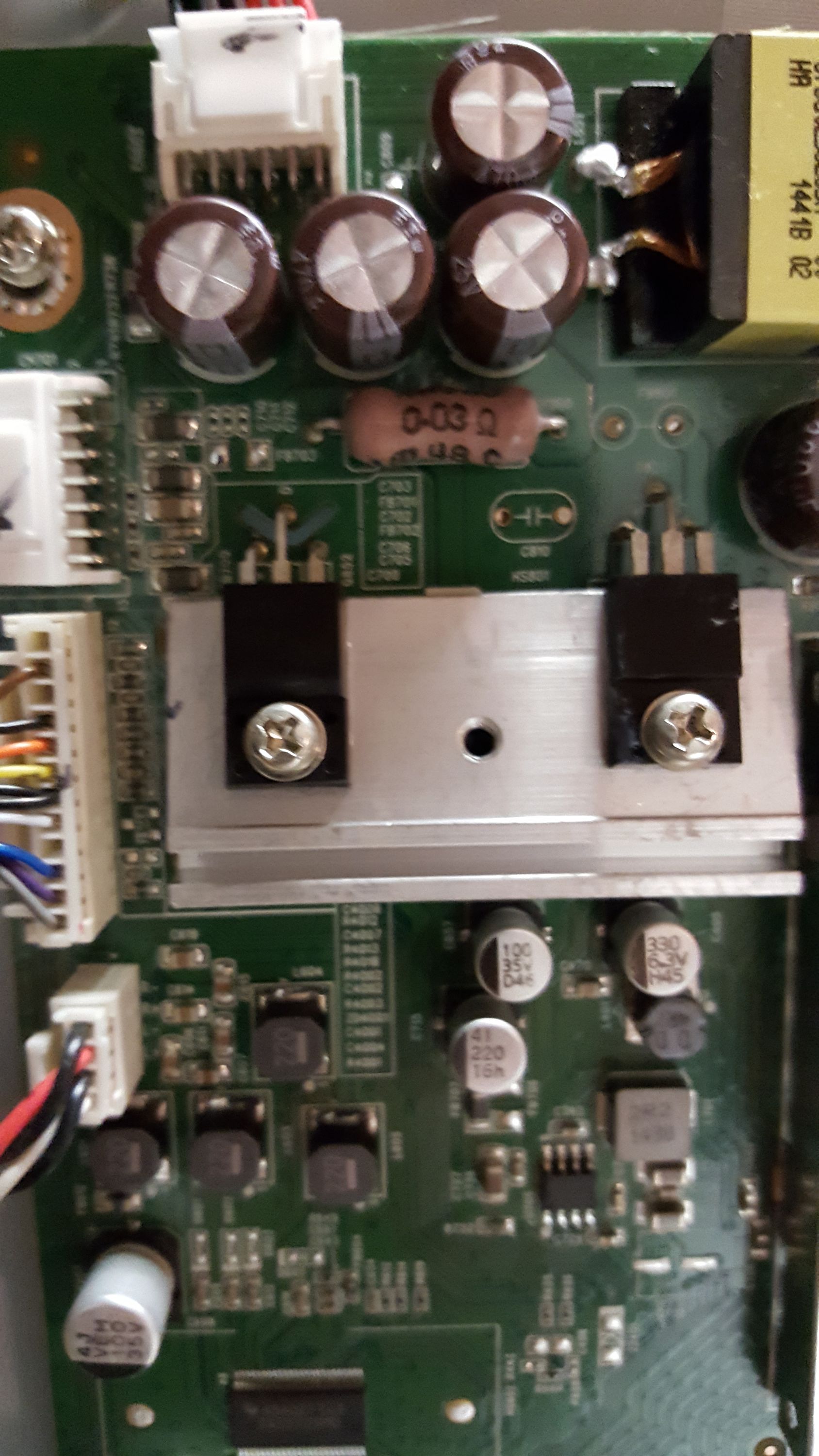

    Any hi resolution, straight shot pictures of the main board that you could post?

      Re: Vizio E500i-B1 - Powers on then fades out - Works if left unplugged for an hour o
      Here are pics of the main board and the power supply. Sorry had some trouble getting my dumbazz smart phone to connect to my pc. (something i never had any problem with until today)
            Here are some additional photos that show connector and voltage markers.
            The voltages are spot on when it is powered on after being unplugged so i will not list them they are as marked. I will have to get it into the failed state then i will list the readings in that state in the next post.
              These are failed state off readings:
              top connector: 0.0V all connectors
              Right side connector:
              Red 5.12 and orange 5.12
              NC - NC
              Blk 0v and bro 0v this rail is 12v when working
              Grey 0v and whi 0v this rail is 24v when working
              Blue /Violet 0v ground rail
              Yellow /Green 0v ground rail
              Red 0v - is 3.3V when working -PS-ON
              Blk 0.26v and Brown 0v DW and ON/OFF
              These are failed state when trying to power on - pressing power on
              Top Connector: reds go to 7.9v then bleeds slowly down to 0v again
              Right Side Connector:
              NC - NC
              Blk 6v and bro 6v then slowly bleeds back to 1.4v and pauses then goes to 0v after 15seconds or so - this rail is 12v when working
              Grey 12v and whi 12v peak then bleeds back down same as above - this rail is 24v when working
              Red 2.98v and N/C - this on holds for much longer than the 12 and 24v rails is 3.3V when working -PS-ON
              Blk 0.26v peak and .06v and Brown 3.3v when I press power first then back to 0v if i press it again. ---DW and ON/OFF

                  First we got to figure out what PSon, On/Off and DIM signals do when the TV fails. It's not quite clear how you written it. So just checking...
                  So what you saying is that you lose PSon in the failed state?
                  On/Off is the backlight. what does it do when the TV fails? Same for the DIM.
                  Sounds like an EEPROM going bad or a bad Wifi module, both already have been suggested.
                  Find the EEPROM on the main board and freeze it with a can of air upside down, turn the tv on and see what happens.
                    OK it is not the wifi - tried it with and without it connected.
                    ON/OFF signal works correctly at button push.
                    The PS-on voltage is about .5 v(half a volt) lower when it is in the failed state than when i turn it on after being unplugged.
                    I believe it is a mosfet or IC that is not switching upon power off and stays on. One of the tiny SMD caps or diodes is likly shorted or something. This is also a known issue with this model tv.
                    I am just wanting to replace the board as opposed to spending several hours of my precious time trying to find the haystack needle.
                    My question is therefore:
                    Most likely board to swap- Power supply or Main board
                    Seems that the signal going to and coming from the main board is correct, however I am wondering why the PS-ON voltage changes slightly.
                    and I suspect this may be the reason for the 12/24V rails not starting.
                    It is obvious that a device is not switching on power off question is which one.
                          You can tell if the PS-ON signal is OK or not by checking the DCV between the two legs of the main filter caps (you have two of them and they are connected in parallel), when TV is OFF, the dcv should be around 165VDC, and when the PS-ON signal is present, the dcv should be around 380~400VDC, if you do have that Voltage then the PS-ON signal is fine.
                          PS-ON is also used to turn on the switched 12V power supply and the switched 24V power supply. The SMPS IC9101 for the 12V/24V runs from the 380V PFC Boosted Voltage through the fusible resistor R9140.
                          The ON/OFF signal is for backlights ON/OFF.
                          PS-ON, ON/OFF, DIM signals are generated by the Main board, the PS-ON, ON/OFF usually >2.5V = ON, <1V = OFF.
                          BTW, there are more than one versions of this TV model.
                          Which are the boards used in your TV?
