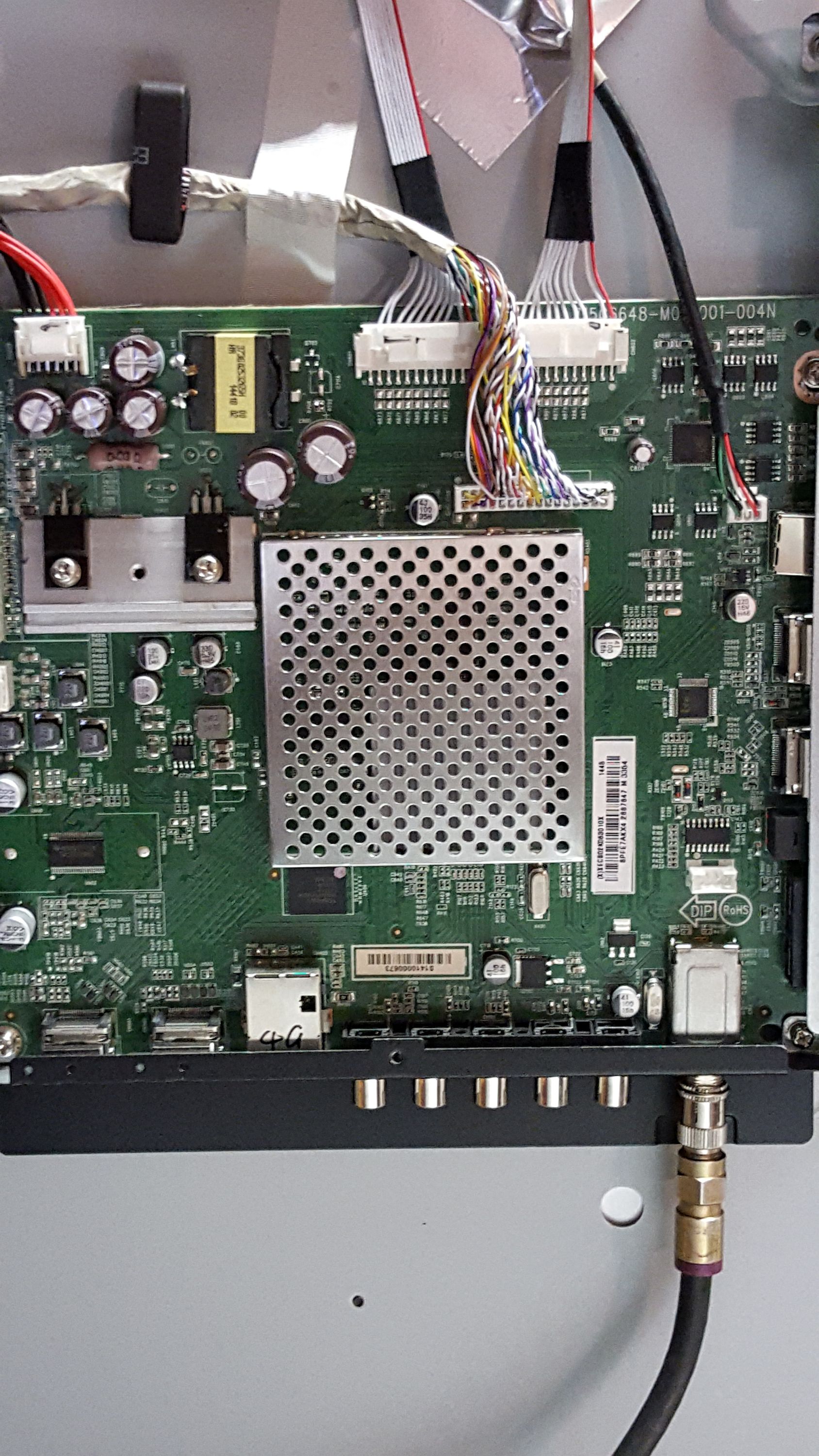

    Vizio E500i-B1 - Powers on then fades out. No backlight flash just the led power indicator comes on then fades slowly out.
    Now here's the burn, if i unplug it for an hour or longer it will power on like normal and even run all day long, up until I turn it off again. If I leave it plugged in as normal it will not power back on.
    Standby voltage 5V normal in both cases, as well as the power on signal, 3.3V when i power it on but the set does not fire up. Unless of course I have had it unplugged for a time.
    Also note that the 24V supply going from the power supply to the mainboard works in the case where the set has been unplugged for a while but does not power up when it is plugged in and powered down normally then turned back on.
    Any help pointing me in the right direction is appreciated. I wish the board had fully failed it would be easier to find the actual problem.
    Thanks!!

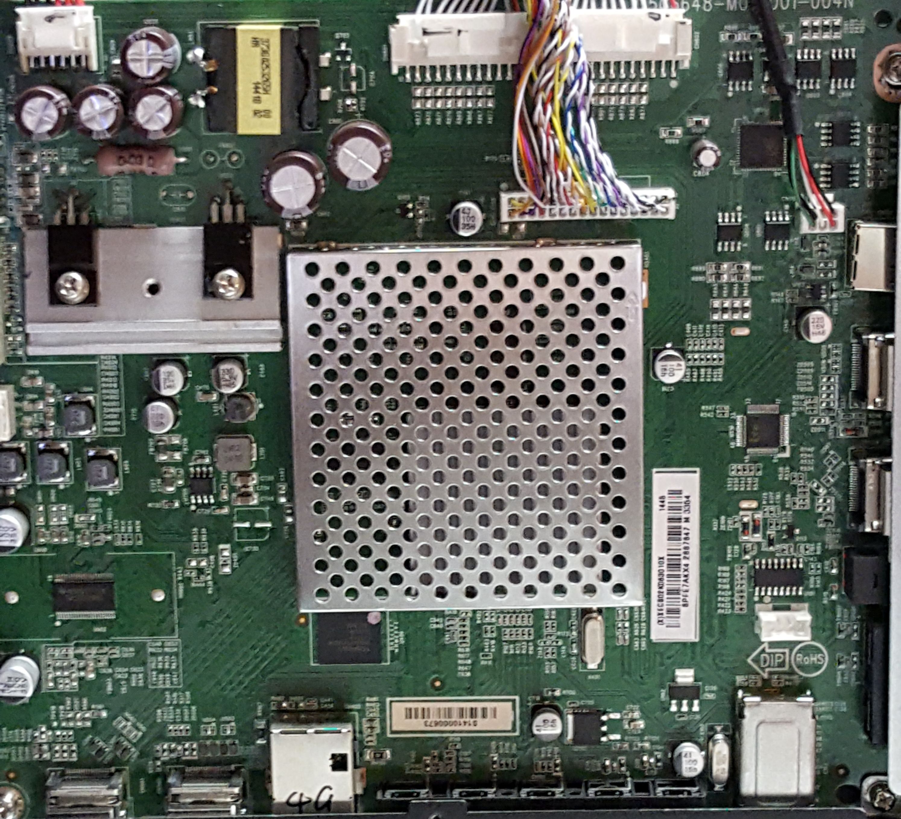

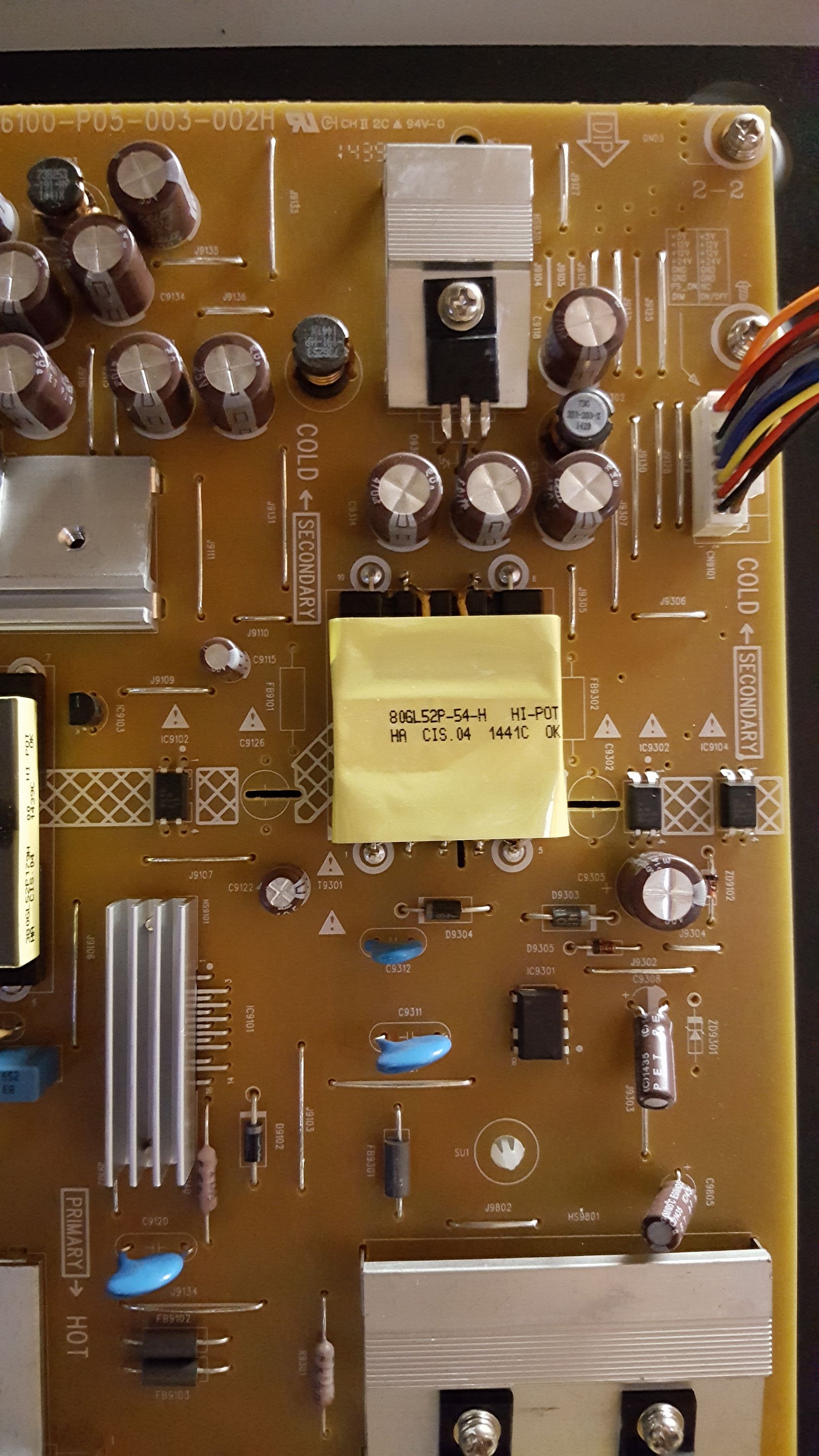

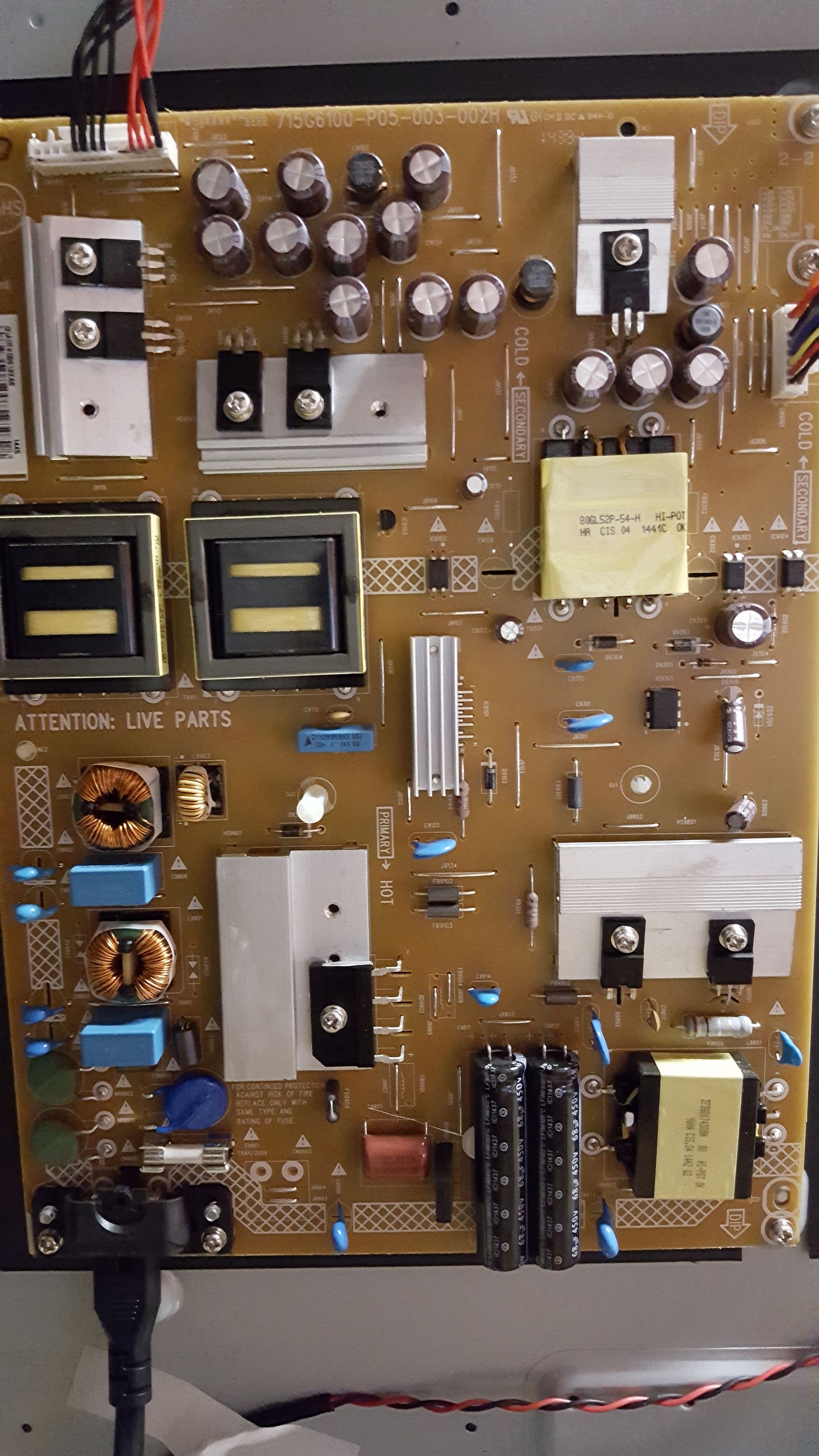

    Any hi resolution, straight shot pictures of the main board that you could post?
    • Doc38343
      • Apr 2015
      • 402

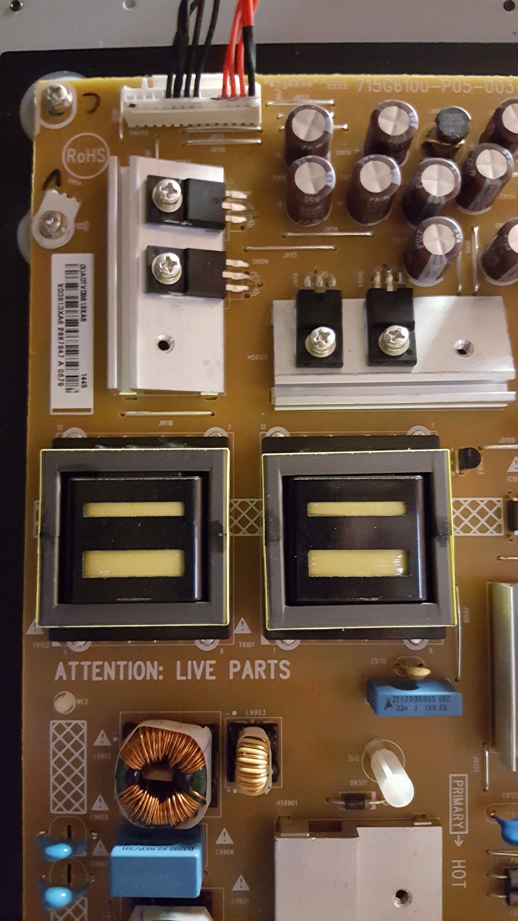

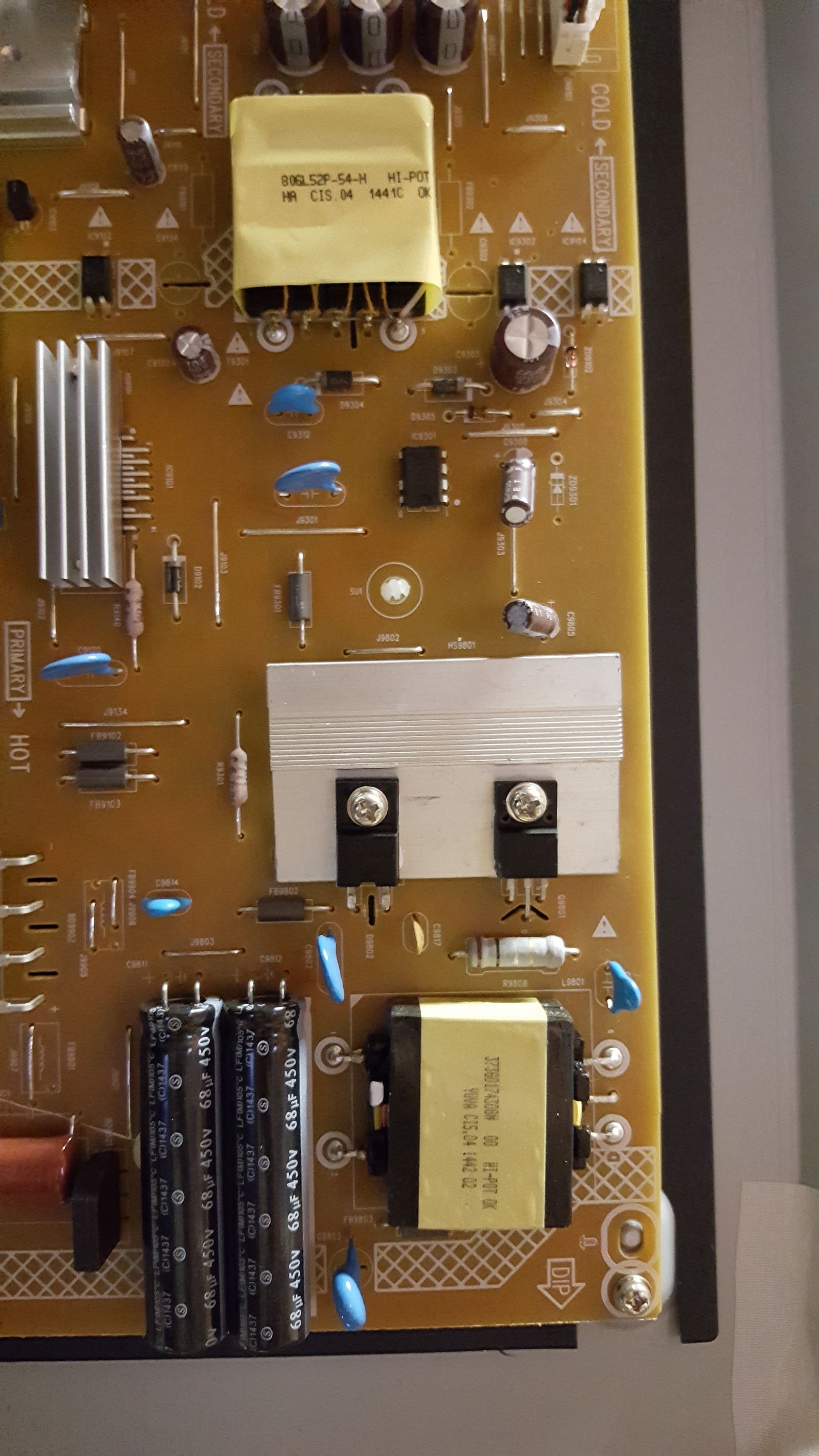

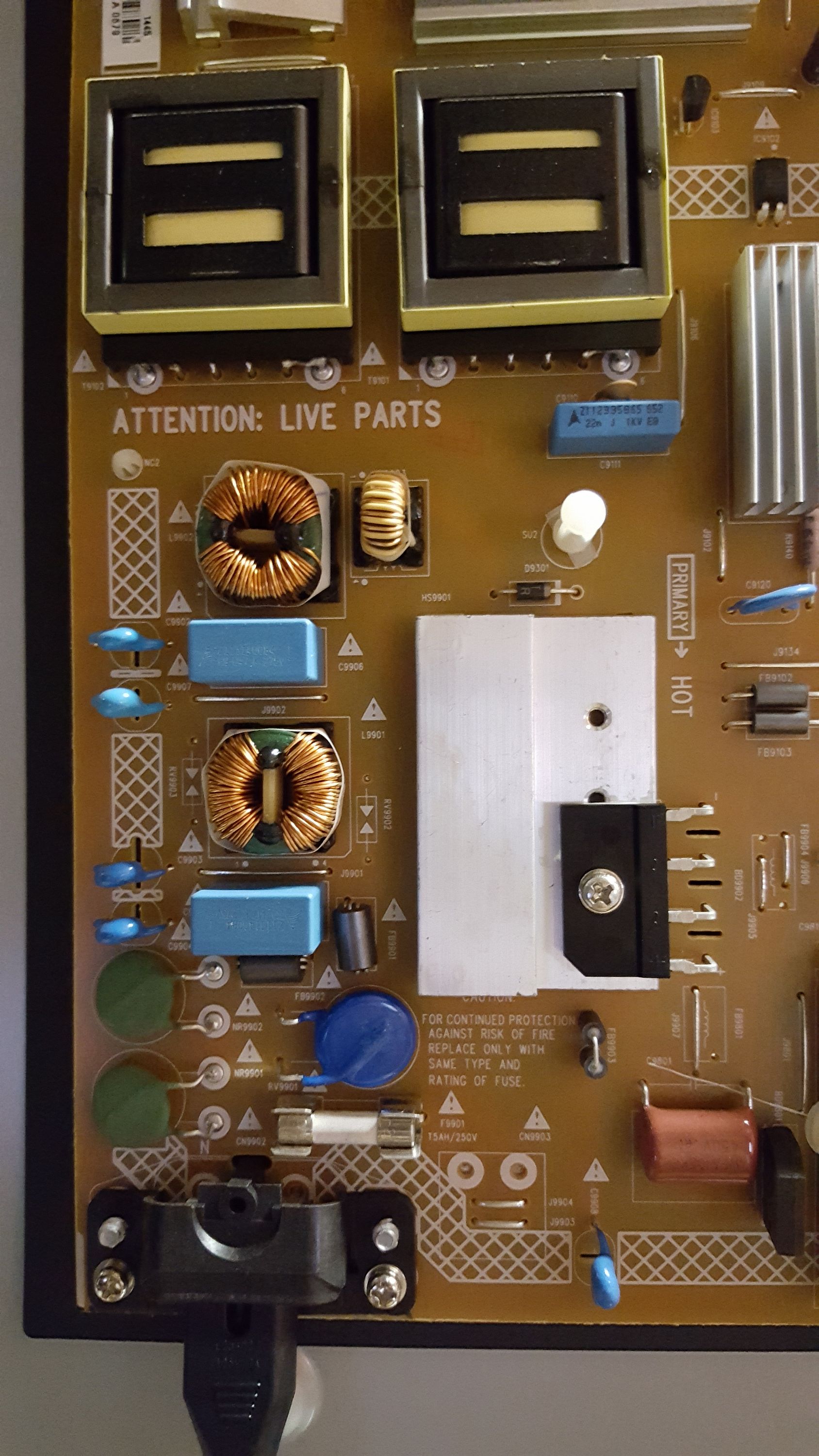

      Re: Vizio E500i-B1 - Powers on then fades out - Works if left unplugged for an hour o
      Here are pics of the main board and the power supply. Sorry had some trouble getting my dumbazz smart phone to connect to my pc. (something i never had any problem with until today)

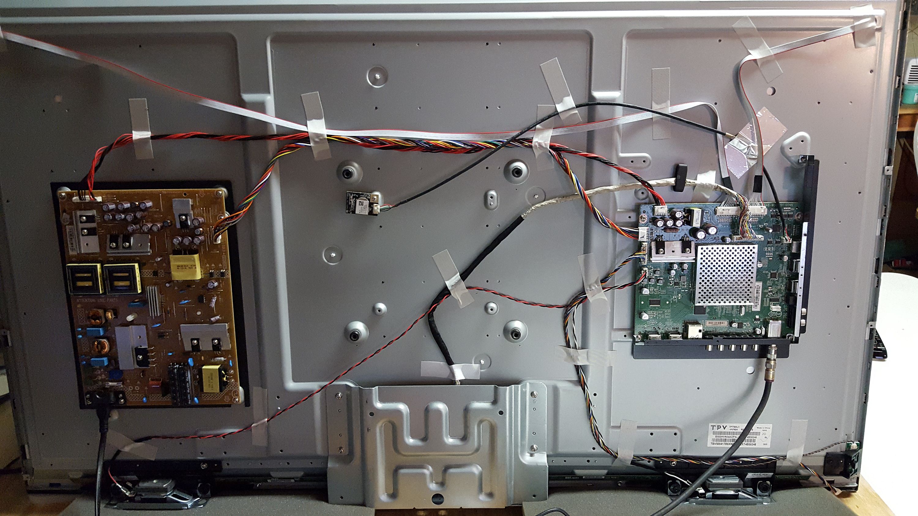

        Can we see the pictures of the whole back side of the TV so we can see how all the boards are connected together? I wonder what that Transformer on the main board is for and the red/black wires on the connector on the main board.
        I wonder if it has EEPROM problems.

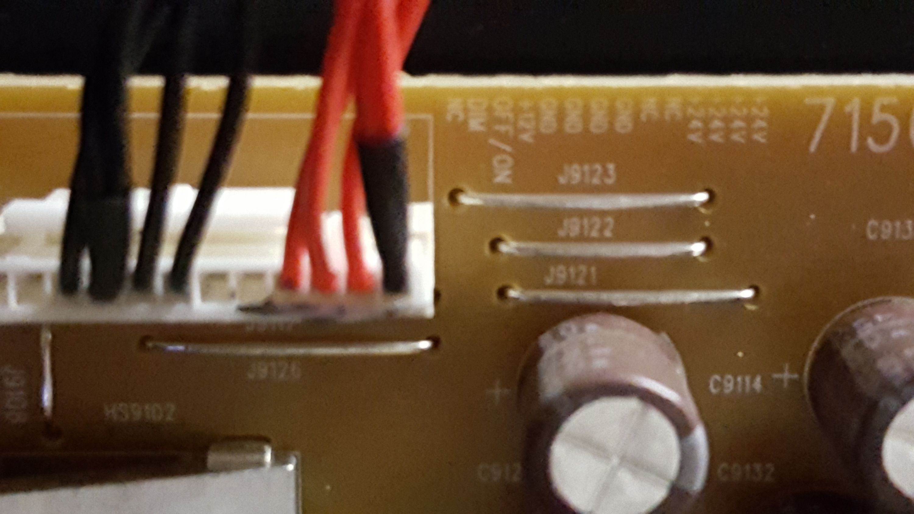

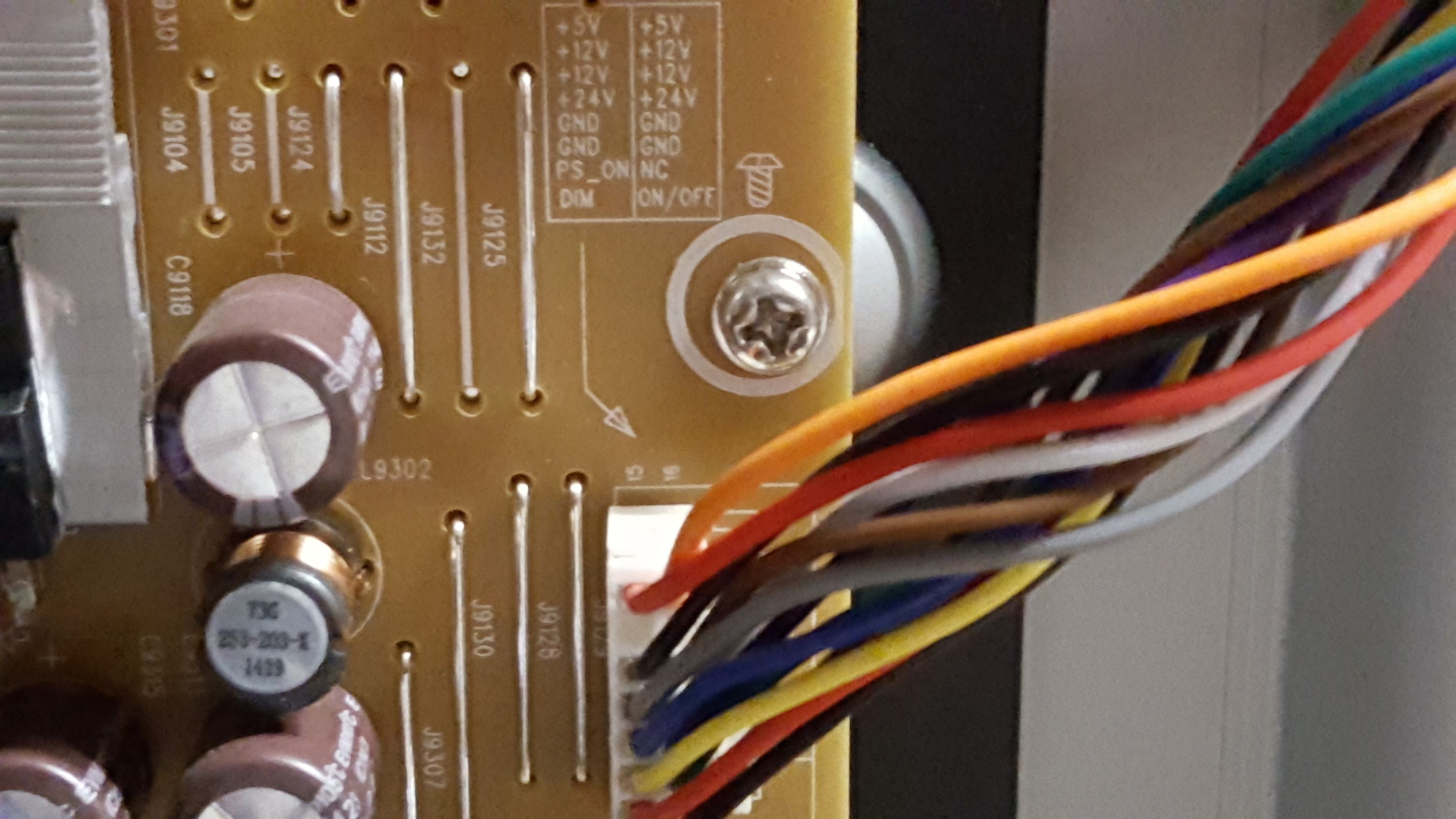

          Can you provide the voltages on the connector along with the name for each pin when in standby and when out of standby.
          • Doc38343
            • Apr 2015
            • 402

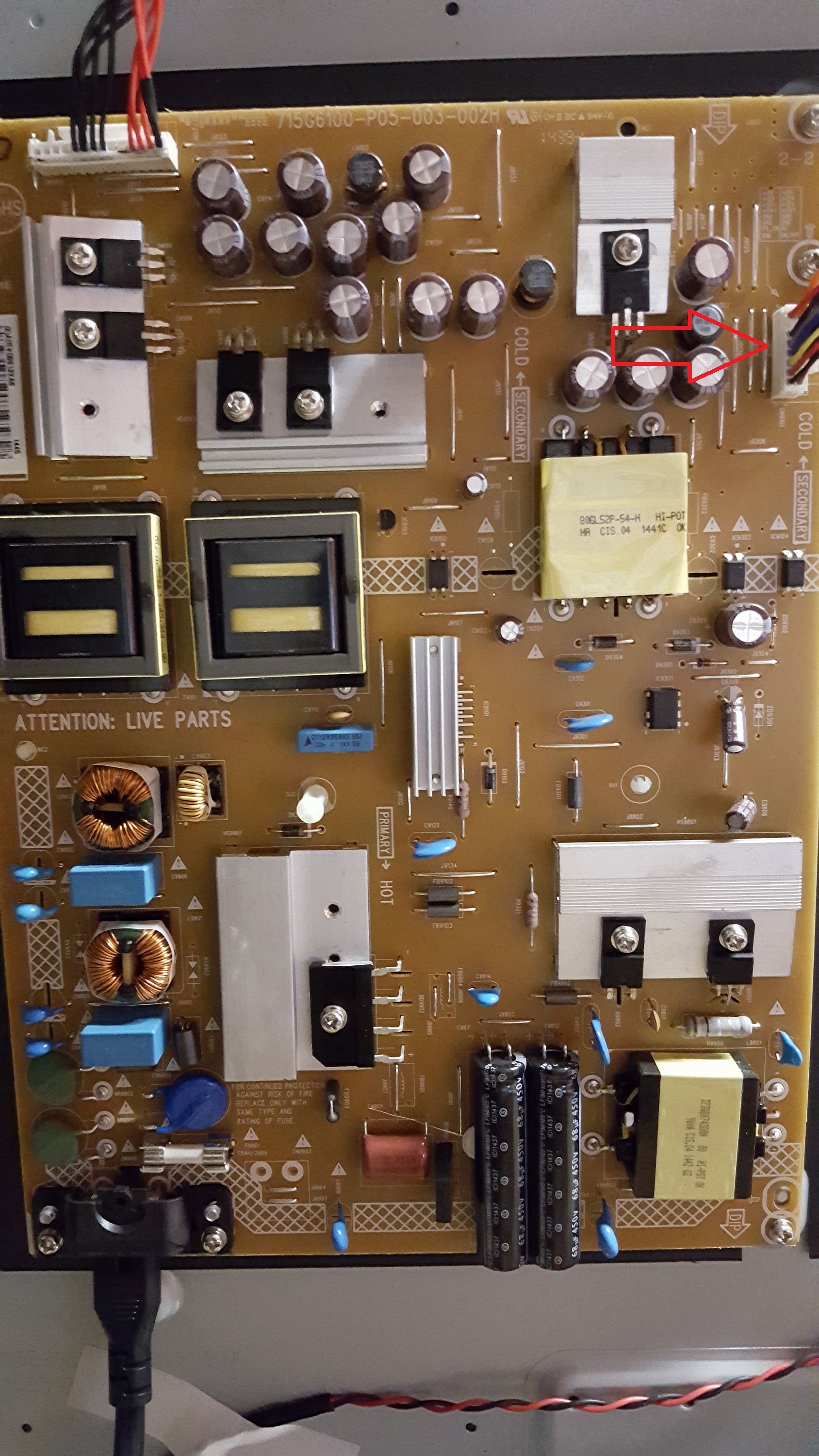

            Here are some additional photos that show connector and voltage markers.
            The voltages are spot on when it is powered on after being unplugged so i will not list them they are as marked. I will have to get it into the failed state then i will list the readings in that state in the next post.

              These are failed state off readings:
              top connector: 0.0V all connectors
              Right side connector:
              Red 5.12 and orange 5.12
              NC - NC
              Blk 0v and bro 0v this rail is 12v when working
              Grey 0v and whi 0v this rail is 24v when working
              Blue /Violet 0v ground rail
              Yellow /Green 0v ground rail
              Red 0v - is 3.3V when working -PS-ON
              Blk 0.26v and Brown 0v DW and ON/OFF
              These are failed state when trying to power on - pressing power on
              Top Connector: reds go to 7.9v then bleeds slowly down to 0v again
              Right Side Connector:
              NC - NC
              Blk 6v and bro 6v then slowly bleeds back to 1.4v and pauses then goes to 0v after 15seconds or so - this rail is 12v when working
              Grey 12v and whi 12v peak then bleeds back down same as above - this rail is 24v when working
              Red 2.98v and N/C - this on holds for much longer than the 12 and 24v rails is 3.3V when working -PS-ON
              Blk 0.26v peak and .06v and Brown 3.3v when I press power first then back to 0v if i press it again. ---DW and ON/OFF

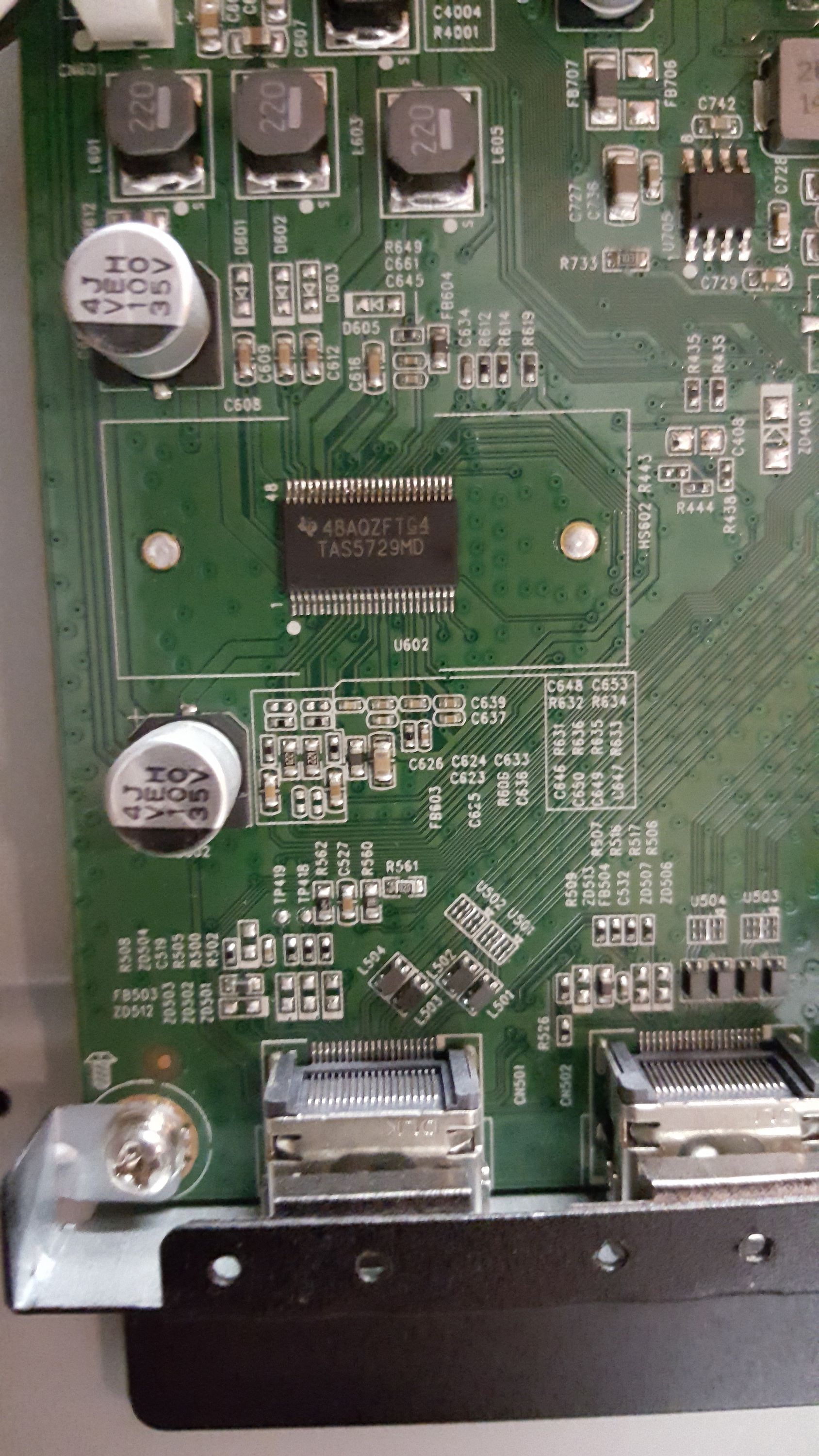

                  Sounds like an EEPROM going bad or a bad Wifi module, both already have been suggested.
                  Find the EEPROM on the main board and freeze it with a can of air upside down, turn the tv on and see what happens.

                          You can tell if the PS-ON signal is OK or not by checking the DCV between the two legs of the main filter caps (you have two of them and they are connected in parallel), when TV is OFF, the dcv should be around 165VDC, and when the PS-ON signal is present, the dcv should be around 380~400VDC, if you do have that Voltage then the PS-ON signal is fine.
                          PS-ON is also used to turn on the switched 12V power supply and the switched 24V power supply. The SMPS IC9101 for the 12V/24V runs from the 380V PFC Boosted Voltage through the fusible resistor R9140.
                          The ON/OFF signal is for backlights ON/OFF.
                          PS-ON, ON/OFF, DIM signals are generated by the Main board, the PS-ON, ON/OFF usually >2.5V = ON, <1V = OFF.
                          BTW, there are more than one versions of this TV model.
                          Which are the boards used in your TV?
