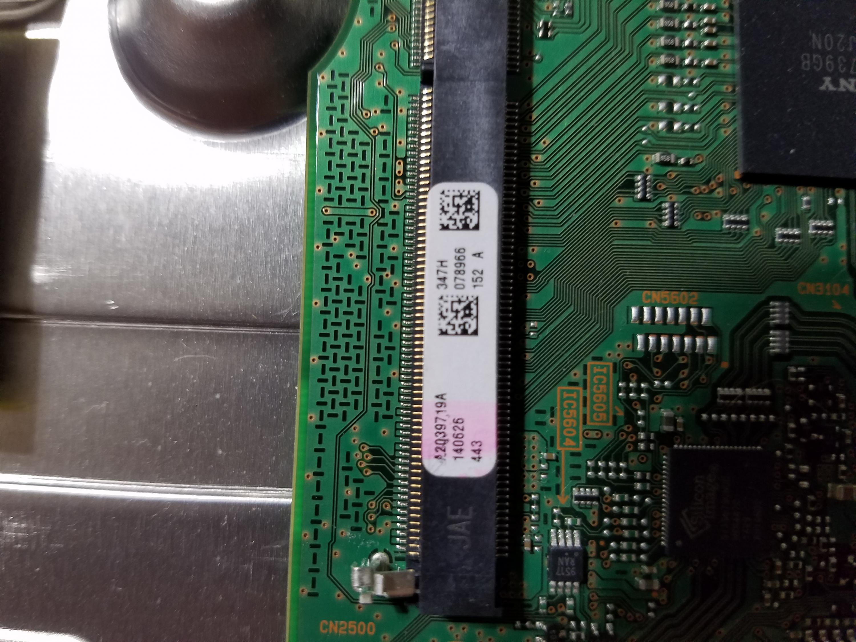

                  Re: Sony Bravia XBR-55X850B - three blinks
                  theres usually a white sticker on the mainboard or sometimes its printed on it if you cant find the number upload a good clear picture and we will try to help.

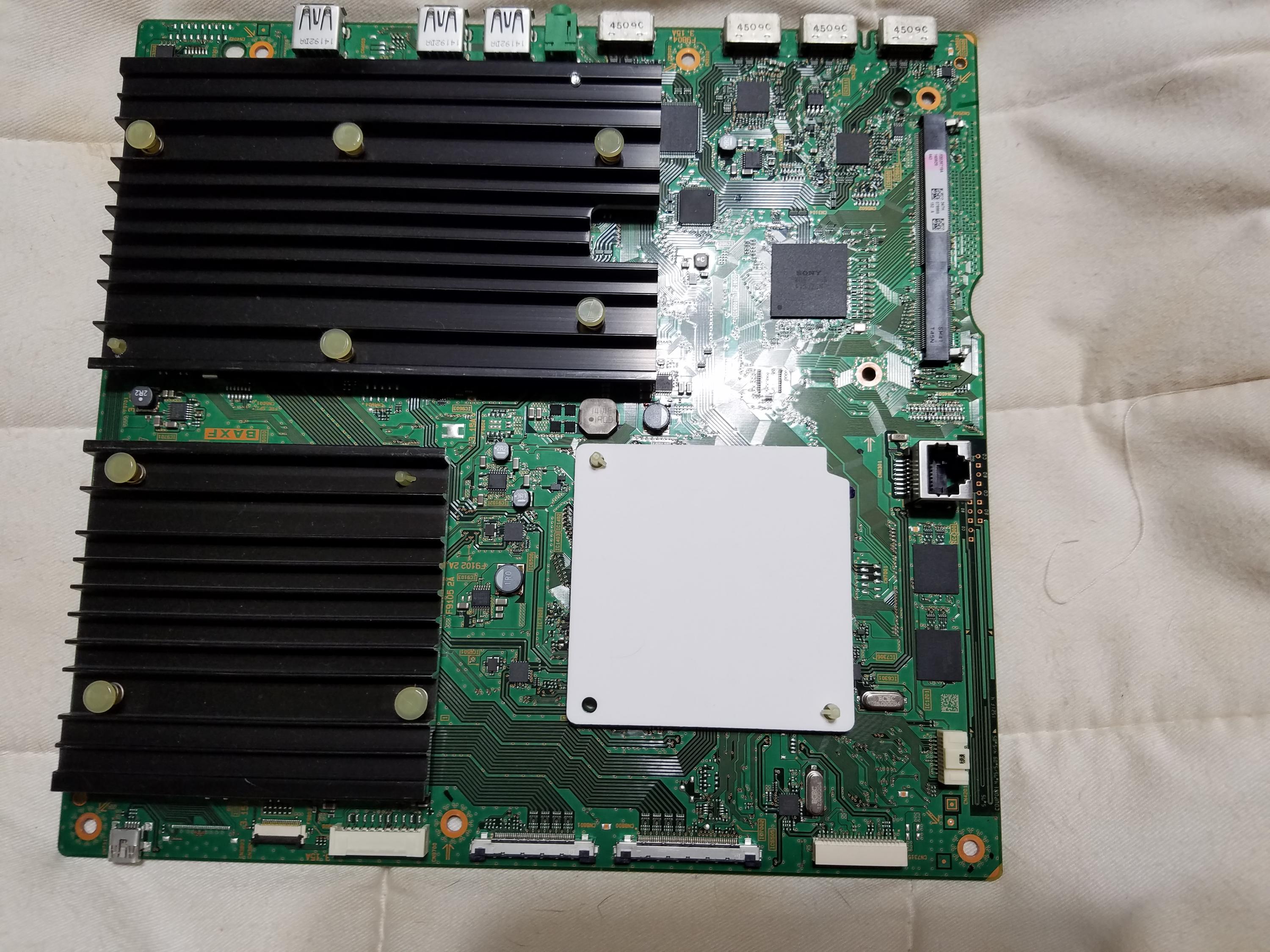

                    #29
                    Here are two photos one of the whole mainboard and the other is a close up of the white tag.

                      #30
                      A-2039-719-A-Main-Video
                      140626
                      443
                      Now there are a fair few versions of this board i guess diffrent software etc for whatever panel the tv uses so be carefull when buying a replacement
                      http://www.ebay.co.uk/itm/Sony-XBR65...wAAOSwy5ZXBx4R
                      http://www.shopjimmy.com/sony-a-2039...main-board.htm
                      Also on shopjimmy they say this
                      A software update is required upon installing this part. After replacing this board please visit esupport.sony.com and download the correct version for your model and follow all instructions. After the update the television may seem to be running slow, but this is normal as the TV is adjusting to the new software and will return back to normal after a few minutes. PLEASE NOTE: Sony software updates can be extremely finicky. We've found that after downloading the correct software to a USB drive, the following procedure has worked best:

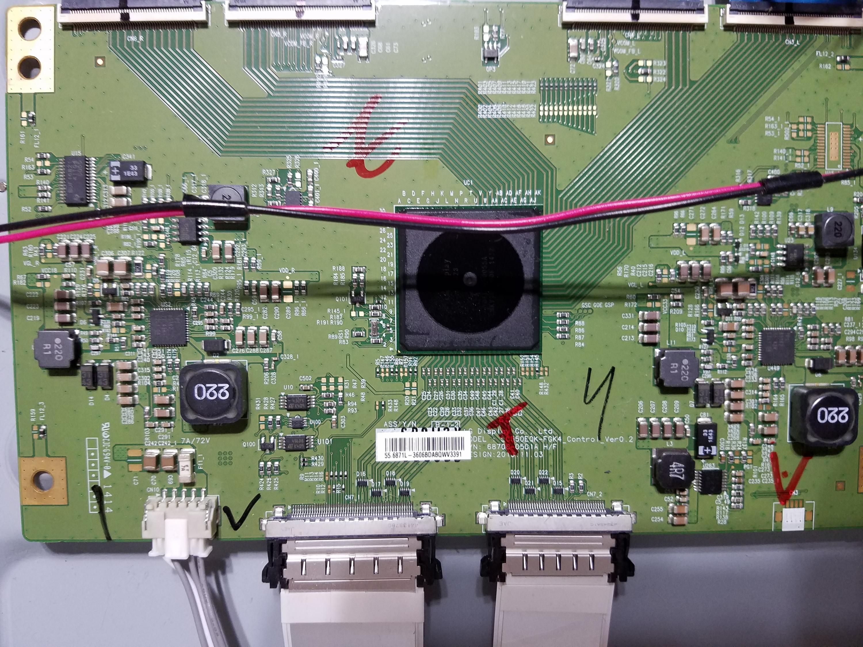

                                      #38
                                      do you know what a t con board is? there will be a fuse on it i wonder if its worth checking the dc voltage at each side of the fuse incase its blown or no voltage too it.
                                      • Milburnt
                                        • Oct 2016
                                        • 8
                                        #39
                                        I am unsure of which is the fuse, but I checked both sides of the white piece and had power both places.
                                        • vinceroger69
                                          • Mar 2012
                                          • 6714
                                          • uk
                                          #40
                                          yes thats the fuse so its not that then at fault no sure what to suggest next too be honest maybe more experienced members can advise further
