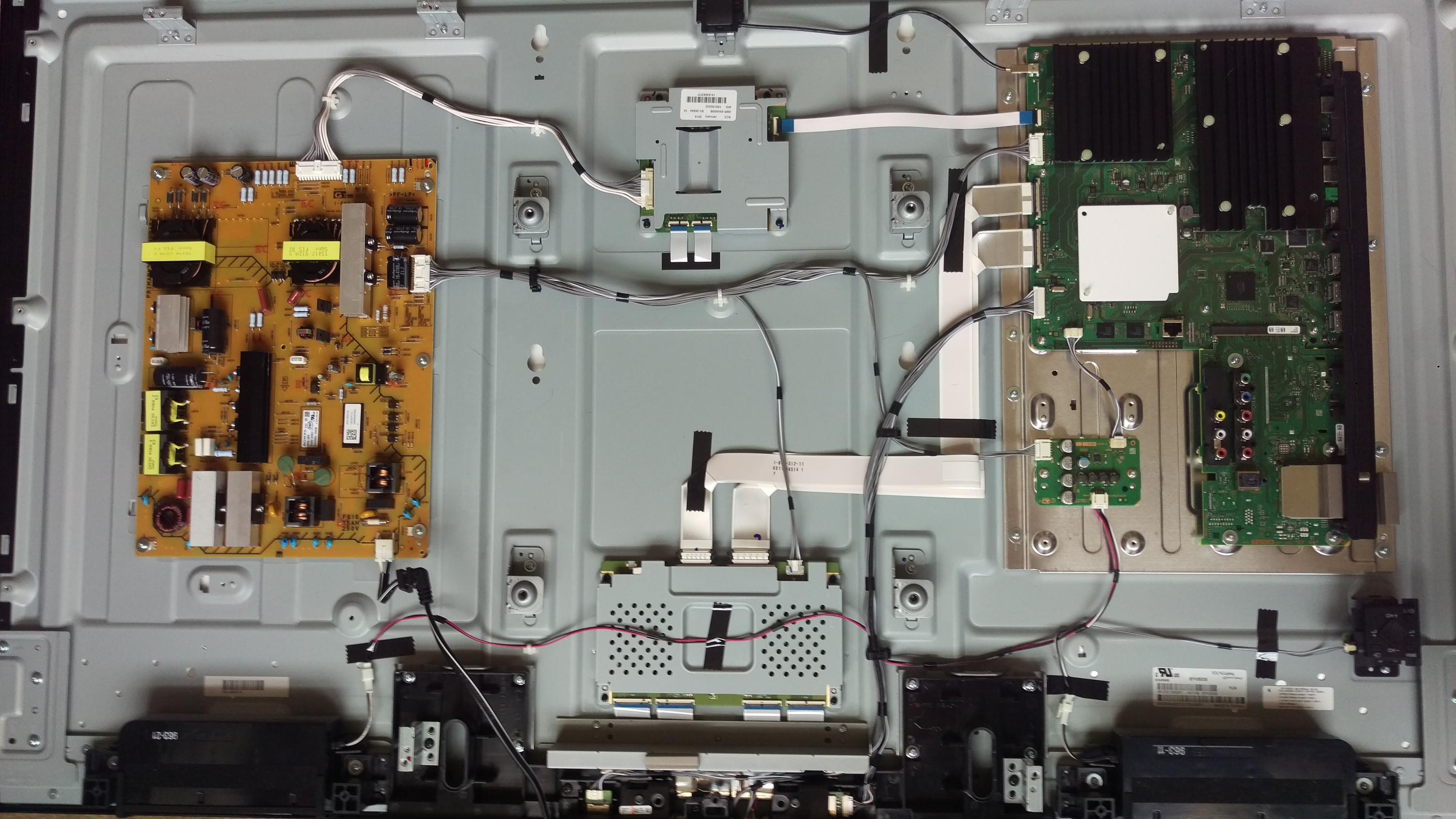

    First step is to show us good clear pictures of the whole back side of the TV so we can see the board.
    Then we need DCV reading of the connector of the power supply board that goes to the main board, we need the pin names and pin number of each pin.
    Take the reading when the TV is plugged in but not turned ON, then the reading after the power switch is activated. We need to know what Voltages and what command signals are there or not there.

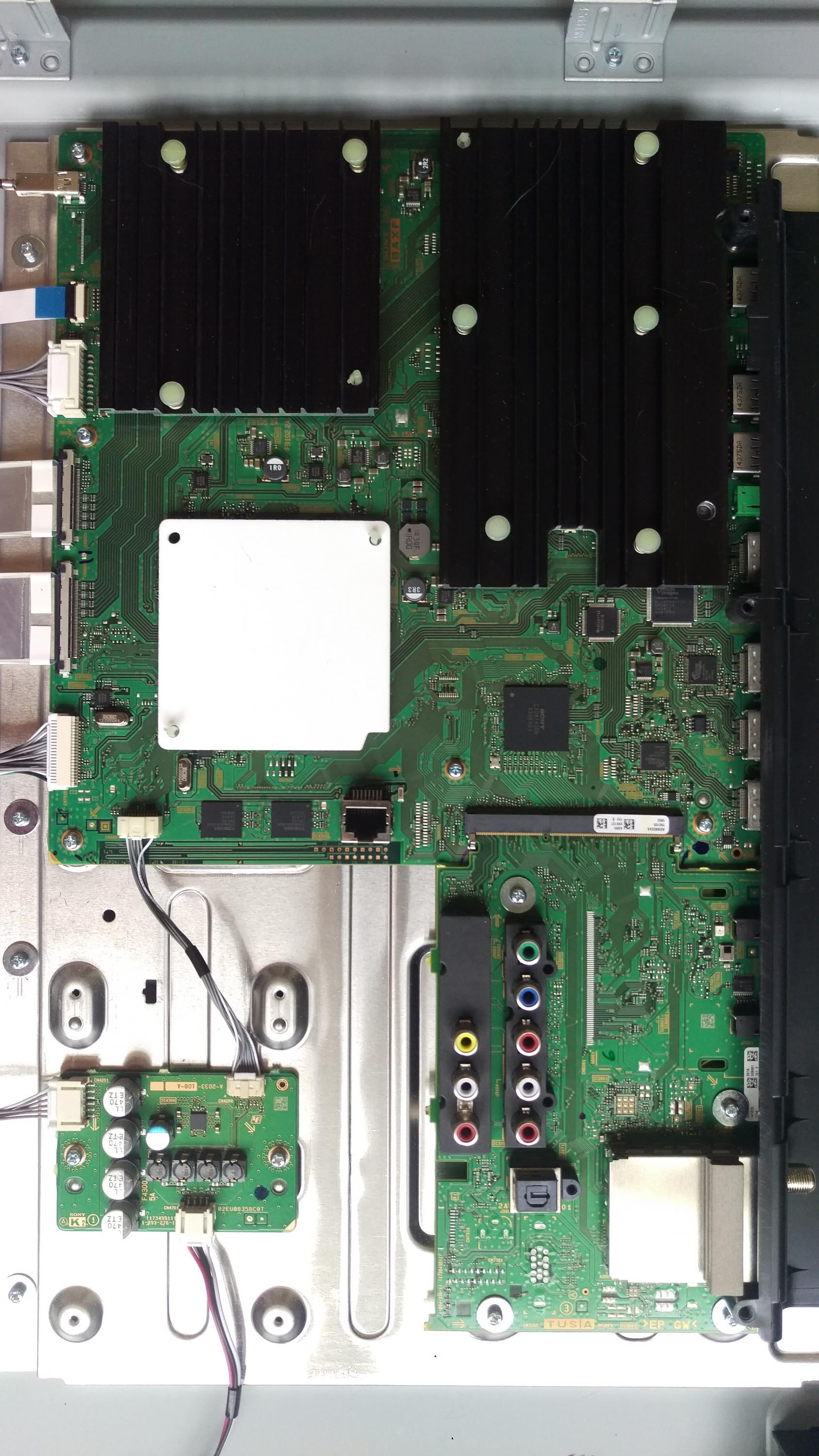

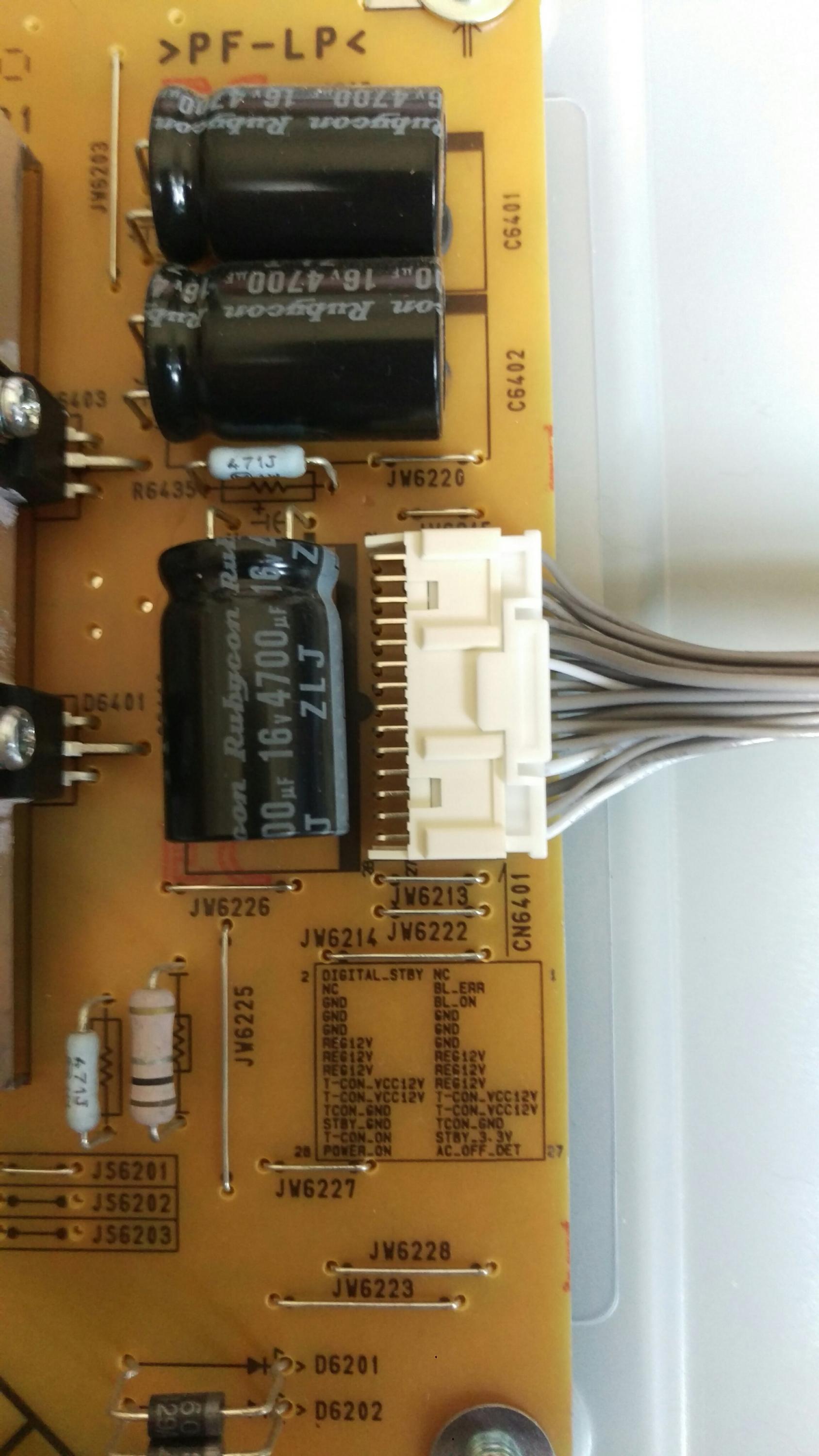

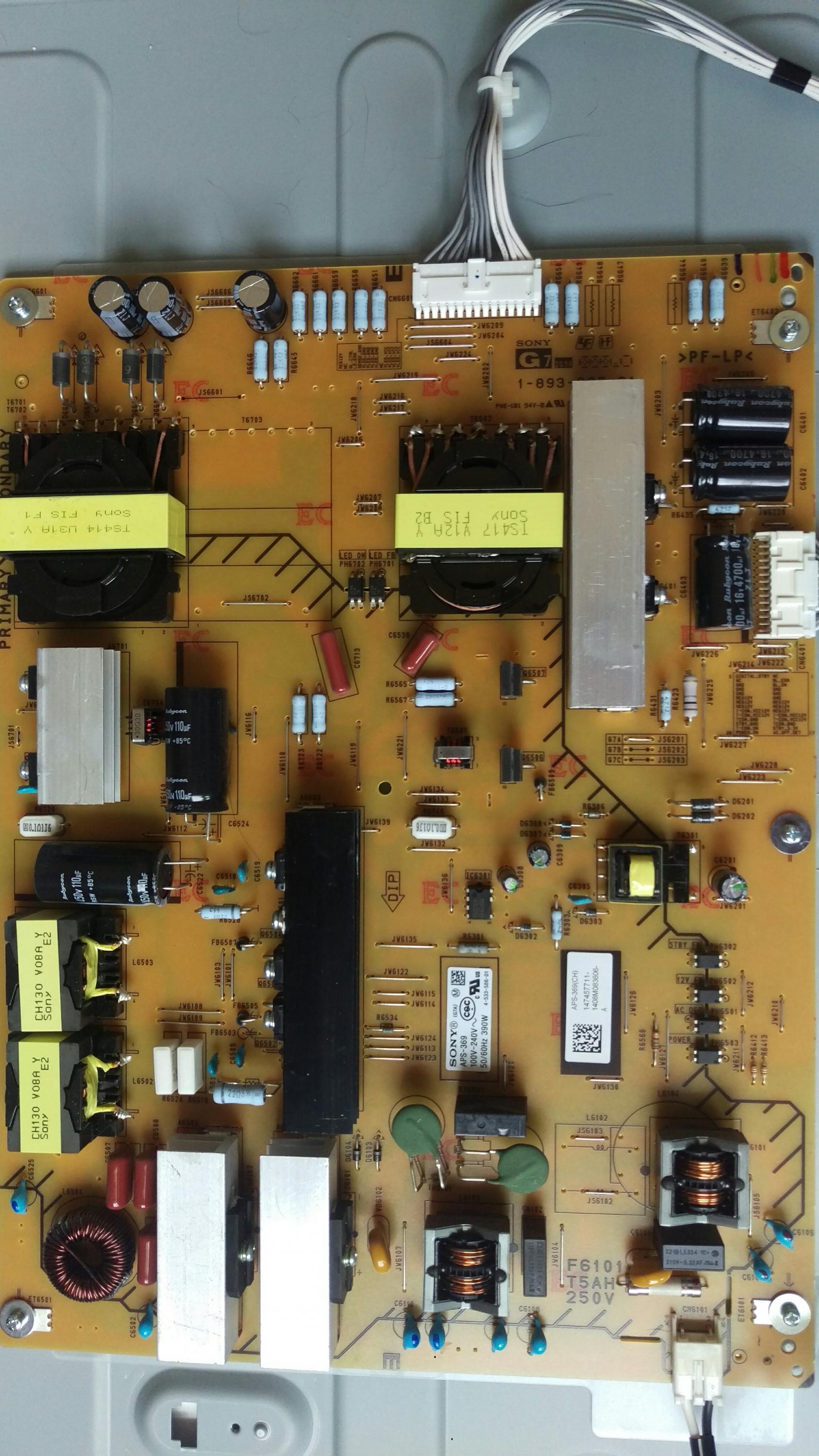

      Re: Sony Bravia XBR-55X850B - three blinks
      Thanks for the quick response! It is appreciated.
      The pictures of the back of the TV, along with the PSU and the Mainboard are attached.
      The pin numbers and names are included in a close-up of the port on the PSU, but also outlined below with a note of their voltages when the TV is plugged in.
      # Name Voltage (DC)
      1- NC - No Pin
      2- DIGITAL_STBY - Varies between 100mv – 205mv – not constant
      3- BL_ERR - 0v
      4- NC - No Pin
      5- BL_ON - 0v
      6- GND - 0v
      7- GND - 0v
      8- GND - 0v
      9- GND - 0v
      10- GND - 0v
      11- GND - 0v
      12- REG12V - ~2mv
      13- REG12V - ~2mv
      14- REG12V - ~2mv
      15- REG12V - ~2mv
      16- REG12V - ~2mv
      17- REG12V - ~2mv
      18- T-CON_VCC12V - 0v
      19- T-CON_VCC12V - 0v
      20- T-CON_VCC12V - No Pin
      21- T-CON_VCC12V - 0v
      22- TCON_GND - 0v
      23- TCON_GND - 0v
      24- STBY_GND - No Pin
      25- STBY_3.3V - 3.467v
      26- T-CON_ON - 0v
      27- AC_OFF_DET - 3.465v
      28- POWER_ON - 0v
      I am not able to turn the TV on and when the power switch is pressed, none of the voltages change. There is an audible click when the TV is plugged in, then about 7 or 8 seconds later, another click then the three flashes from the front LED.
      Based on the 3.3v standby being there, does this point to an issue on the mainboard?
        OK, I cannot find the service manual for this model to verify the blinking code, but from looking at the list of the DCV readings, the main board is not sending the POWER_ON to turn on the power supply.
        No T-CON on command to turn on the T-CON 12V power supply, no BL_ON to turn on the backlights circuit.
          The readings were taken when the TV was plugged in. Nothing happens when I hit the power switch on the back of the TV, but if I am quick with the multimeter probes, I get a few mv's from both BL_ON (roughly 4mv) and then roughly 2mv on TCON-ON. Both of these values quickly go to zero after the second audible click followed by the three flashing lights on the front LED. When looking at the screen and hitting the power button / plugging it in, the TV doesn't even flash like the backlights are being turned on though.
            You need to leave the probe on the Power_on pin to see if it jumps up to >2.5VDC when you hear the power relay click and then drops down, it sounds like the POWER_ON signal was present then goes away.
            It is may be sensing the fault some where so the POWER_ON is cut off.
                Left the probe on the POWER_ON pin when plugging it in and when pressing the "Power" button on the back of the TV with no result, voltage stayed at 0v. So does this mean that the TV is getting the error before it even enters the start-up process? The mainboard isn't giving the "OK" back to the power-supply to send over the 12v from the other pins that allow the rest of the MainBoard to power on?

                        https://www.badcaps.net/forum/attach...5&d=1465843674
                        Try disconnect that small green board with 3 white connectors at the bottom left corner of the main board to see what happen.
                          So all boards have been disconnected and cables have been reseated and, as a result, I am now getting 3.44v to the POWER_ON pin on the main PSU output right when the TV is plugged in to the wall but nothing happens when I hit the power button on the back of the TV. This went on for about 5 or 6 restarts (unplugs then plugging back in) and then after that, no more 3.44v. I probably should have done this the first time, but I will disconnect each cable from the mainboard and test disconnected and then reseated. Hopefully something good will come of this, but the initial 3.44v on POWER_ON is a step in the right direction.
