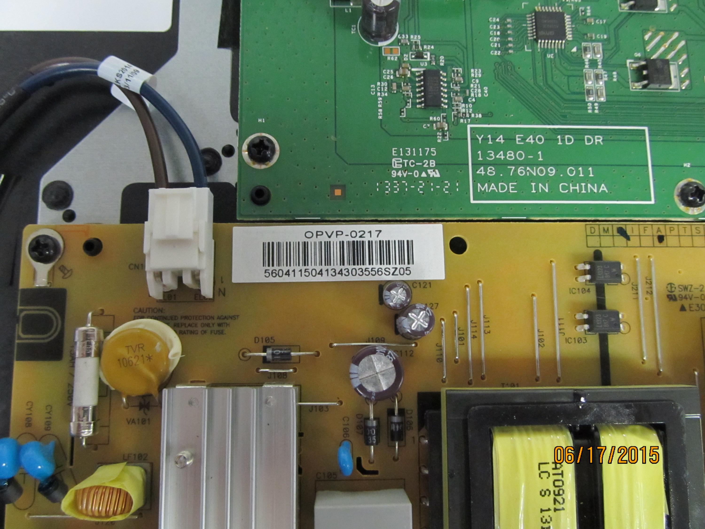

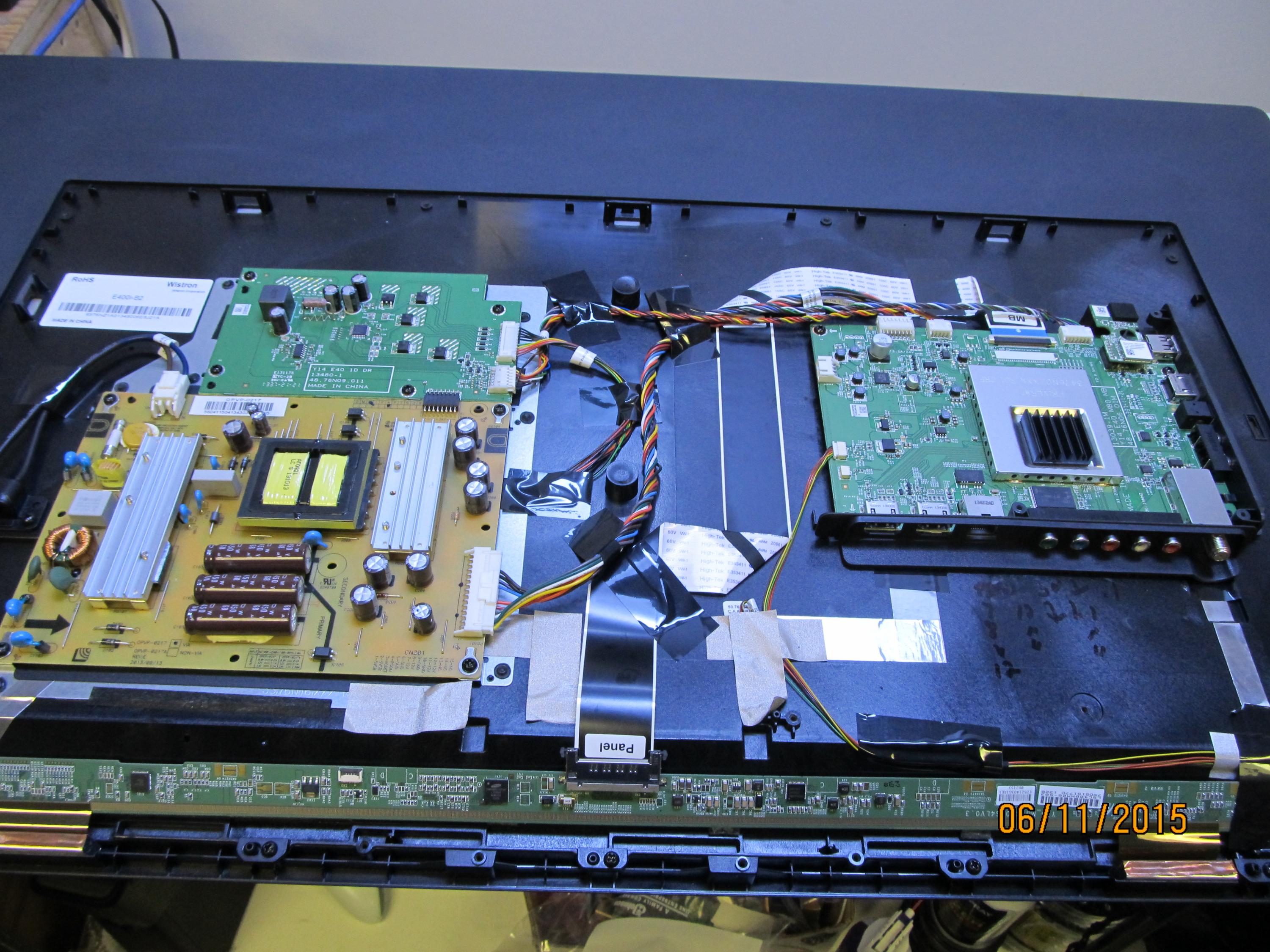

        Re: Vizio e400i-b2 turns on backlights flash
        I am not at my store right now but there are only 3 boards, main, ps and tcon which is part of the lcd panel.

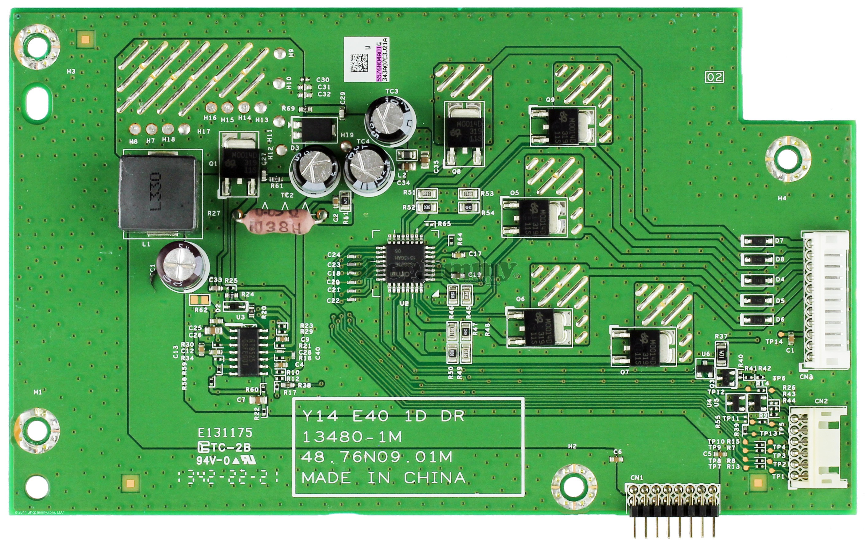

          What DCV do you have on CN1 connector of the LED driver board?
          http://www.shopjimmy.com/vizio-55-76...ed-driver.htm#
          Vizio 55.76N04.A01 (48.76N09.01M) LED Driver
                  It looks like Q5~9 are the PWM controlled power MOSFET's, the big tab should be the Cathode return of each LED string.
                  Put the black probe on the chassis GND, red probe on Q5 big tab, turn the TV on and watch to see how high the DCV goes up too, then wait and see how low it will go down to, record those readings.
                  Then turn the TV off and then do the same thing again on big tab of Q6, same thing for the Q7~9.
                      That CN1 is the input Voltage to feed that LED driver board Boost converter circuit (L1, Q1, D3, TC2~4), I do not expect that input Voltage to drop out. The BL-ON control signals is usually used to turn the Boost converter ON or OFF not the Voltage feeding the boost converter circuit.
                      I need to look further on how that 25V is generated by the main power supply and see if there is protection shutdown circuit for that 25V power supply.
                        BTW, which one of the power supply board do you have?
                        http://www.shopjimmy.com/catalogsear...Vizio+e400i-b2
                        Vizio 56.04115.002?
                        Vizio 56.04115.003 (OPVP-0217)?
                        BTW: what is the dcv rating of the caps TC2~4?
                          Just saw your post so I took a picture of of the power supply label. A lot more information that way.

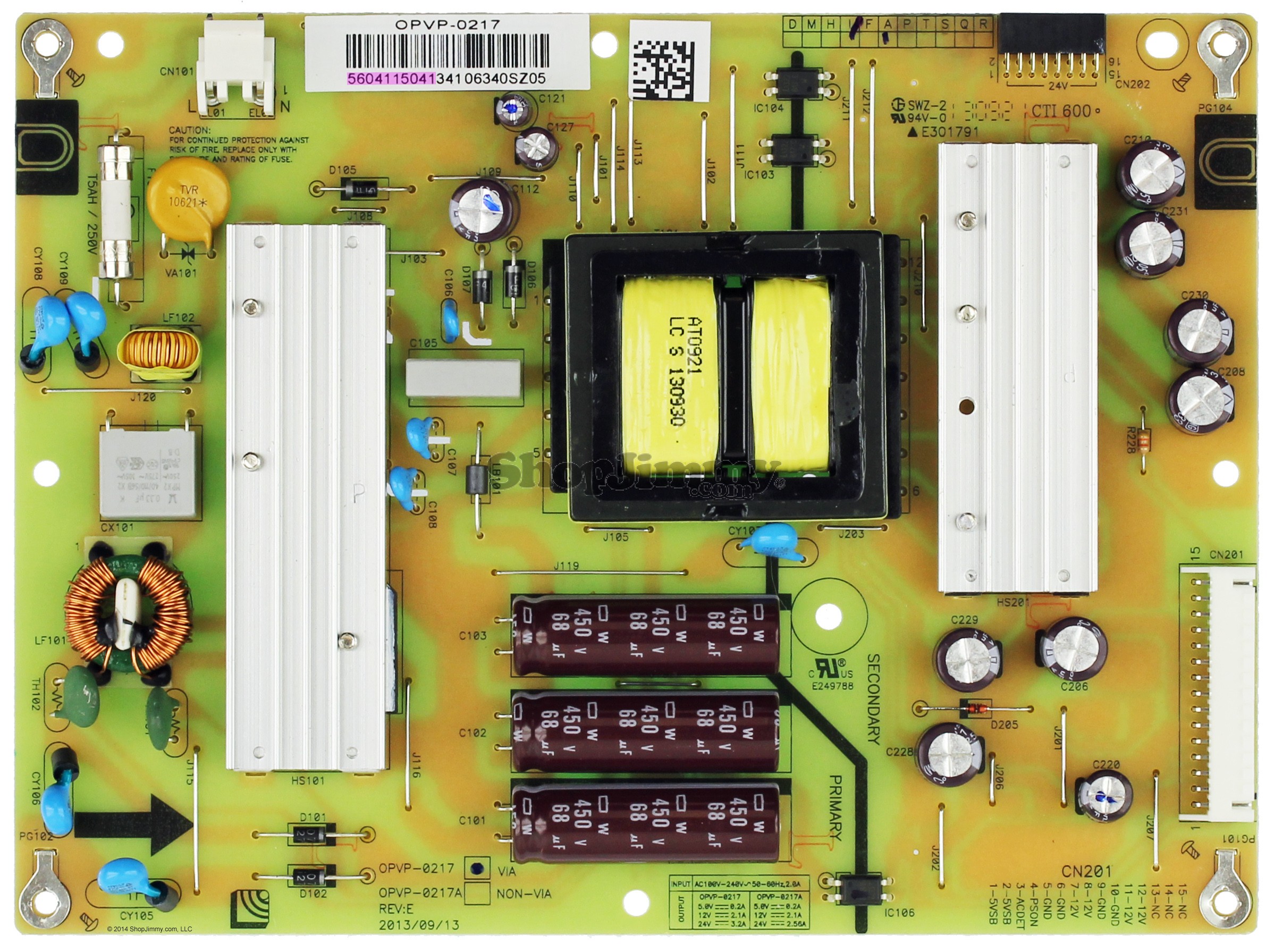

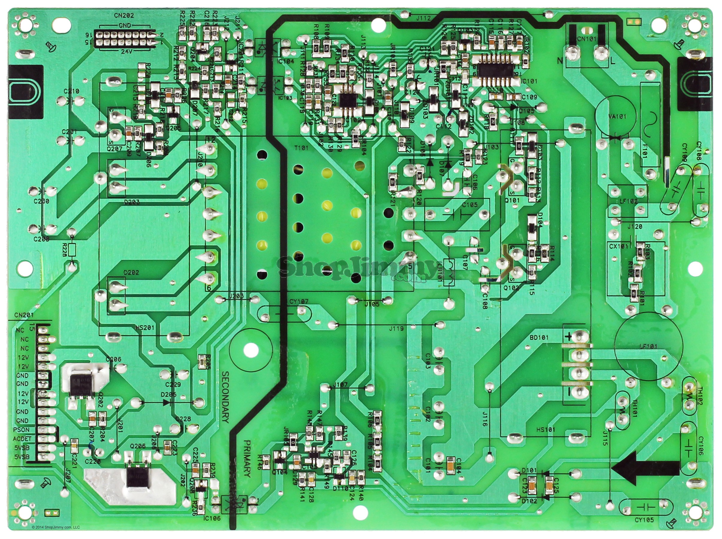

                                  Vizio 56.04115.041 (OPVP-0217) Power Supply Unit
                                  http://www.shopjimmy.com/vizio-56-04...pply-unit.htm#
                                  So you have indicated that the switched 24V on CN202 that goes to the CN1 of the LED driver board drops down to 0V. How about the switched 12VDC on CN201, does it drop out also?
                                  If trace out the board you can see that the Main power transformer T101 generates the 5VSTBY, switched 12V output (MOSFET Q202 is the switch), switched 24v (MOSFET Q207 is the switch).
                                  Both Q202, Q207 Gates are driven by Q205, this Q205 gets the turn on signal at the PS-ON pin from the main board.
                                  The 12V is fed to linear regulator Q206 to produce the the 5VSTBY.
                                  So see if the 12V is still present when the 24V drops down to 0V.
                                  For the switched 12V and the switched 24V to drop out, the PS-ON has to drop to <1VDC, and since we know that the 5VSTBY does not drop out then we know that it is not in the T101 drive circuit is the problem otherwise the 5VSTBY will shutdown also and kill the whole circuits.
                                  Pictures provided by shopjimmy.
