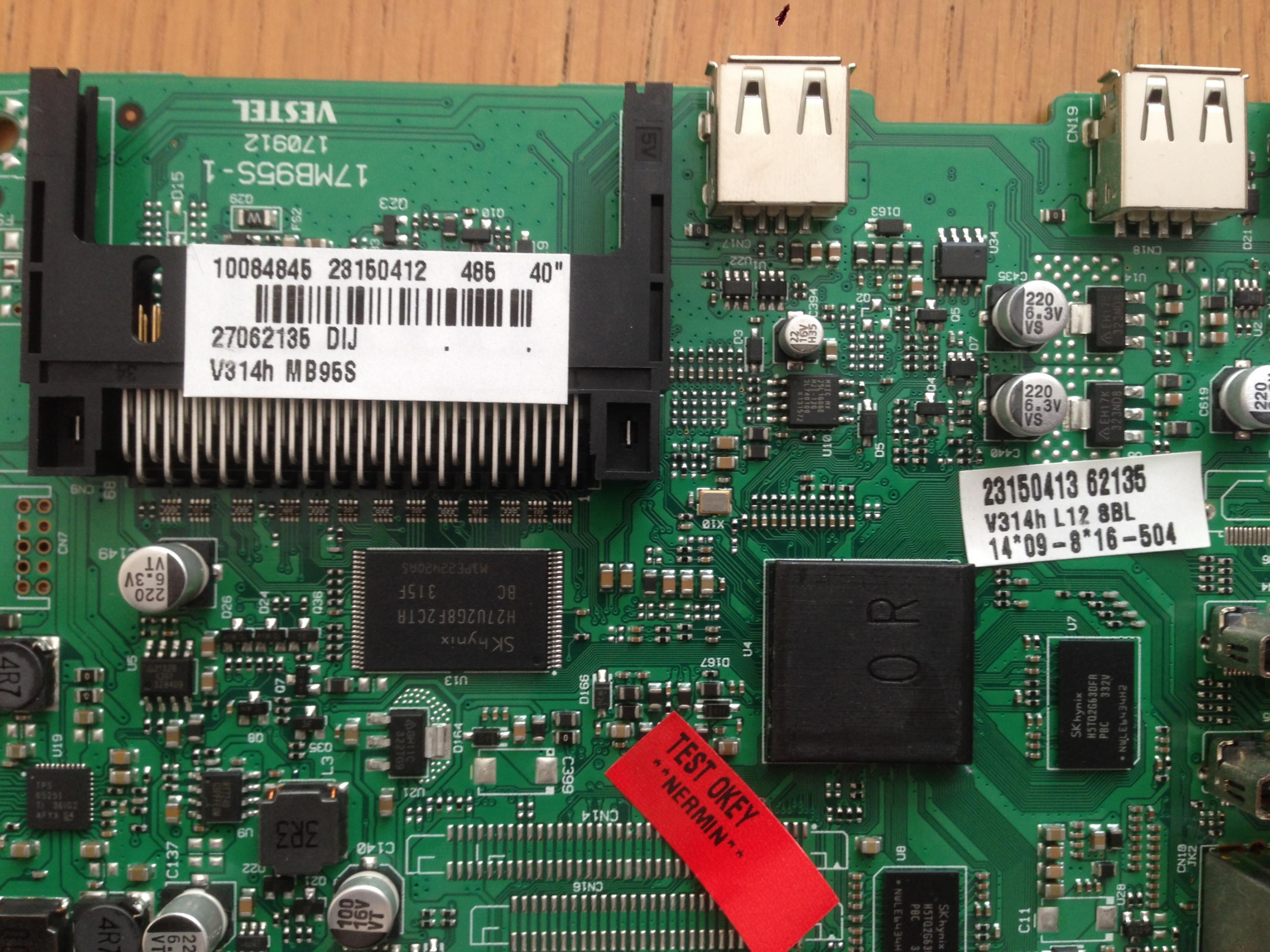

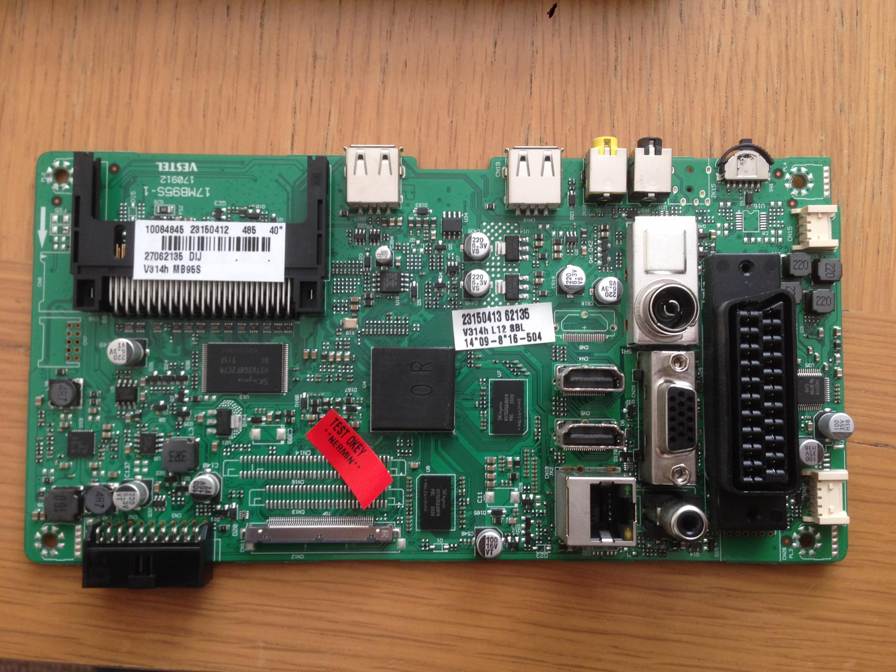

    Hi All
    Got this bush that comes on then turns off after 60 seconds
    Cant do anything with the remote while its on
    Suspected corrupt firmware so want to re flash but cant find the firmware anywhere
    Iv seen quite a few posts on this but looks like they are different versions and i dont want to kill the board
    Mine is 17MB95S-1 V314h MB95S
    does anyone have this firmware or is there a factory reset option that might kick it out this loop ?

      cant see the chip but they do have a USB with the upgrade file on
      UPG122 BUSH LED40127FHDCNTD 17MB95S-1 VES400UNES-04 COMPAIBLE SOFTWARE UPGRADE
      I dont fancy paying £15 for something i can download, someone must have the file

                Not going so well, i tried freezing the Firmware chips to see if i could dumb to USB and now the set wont power on
                It flashes red then powers back lights while still flashing red, does this for about 60 seconds then back-light off and starts the cycle again
                If no one has the fimeware dump i will have to buy the USB from CHS and update that way.
                If it is a hardware fault it wont take long to corrupt again and i will get the suggested kit from ebay
                will post back findings and files

                            Repair kit arrived
                            only has one component
                            U9 RT7240A
                            will let you know how i get on after fitting it.
