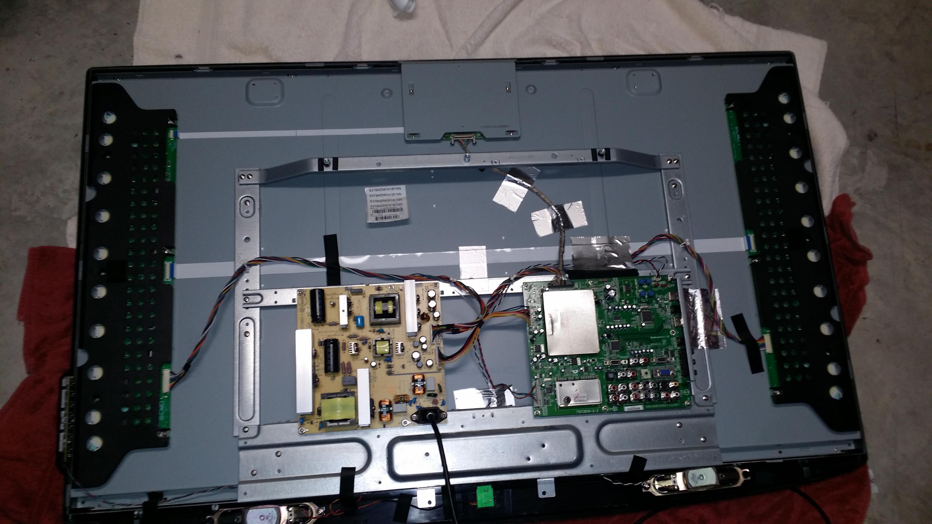

    Ok. I have now come into my possession an Insignia (yeah yeah, cheap brand) 47" TV that, when working, will be on the outside covered patio.
    Got it in unknown working condition.
    Plugged her in. LED goes purple (Blue and Red at same time) for a split second, 5 red flashes and then solid Red. Power button on side does not affect the tv. Checked all the buttons, they are all open until pressed then I have continuity. No burn marks or smells of burnt electronics. Caps aren't swollen (not always accurate).
    I do not have a remote for her.

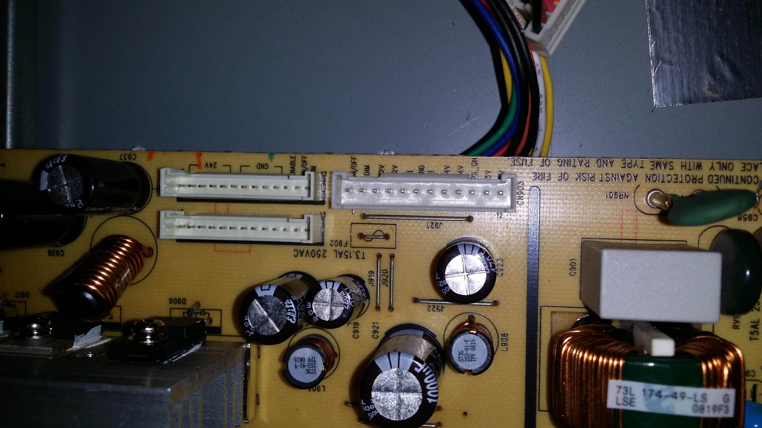

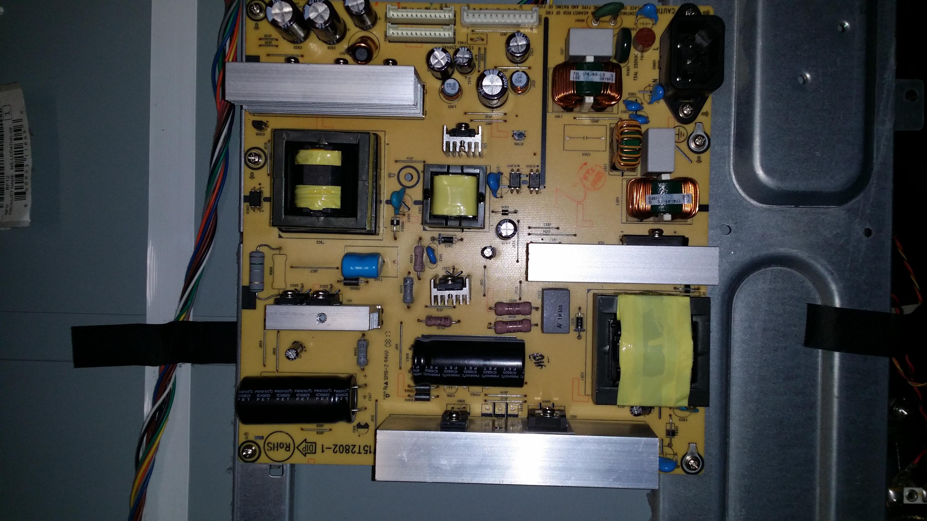

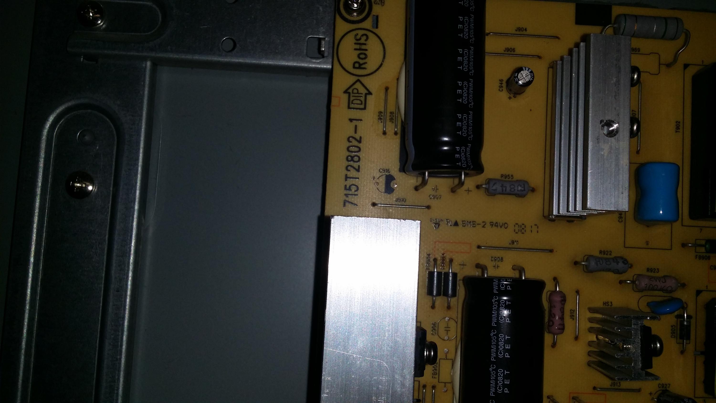

    I have uploaded pics of the boards and board layouts.
    I think there is an issue with the Power board and here is why:
    CN903 (left plug in pic) volt readings
    Pin 1 on/off: --
    Pin 2 DIM: --
    Pin 3 12v: 12.5v then quickly falls to under 1v.
    Pin 4 12v: 12.5v then quickly falls to under 1v.
    Pin 5-7 GND: --
    Pin 8 24v: 24.5v then quickly falls to under 1v.
    Pin 9 24v: 24.5v then quickly falls to under 1v.
    Pin 10 PS On: --
    Pin 11 5v: 4.95v (steady)
    Pin 12 5v: 4.95v (steady)
    CN904 Right Plug Top, connected to bottom plug via trace on underside)
    Pin 1 -5 24v: 24.5v then quickly falls to under 1v
    Pin 6-10 GND: --
    Pin 11 Enable: --
    Pin 12 On/Off: --
    Pin 13 Dim: --
    This to me is telling me at first glance that the power board has some issues with voltage regulation. I attached the service manual. Let's see what I can find out about the 12 and 24v falling to under 1v..... I will entertain all ideas and troubleshooting.... It is my night to watch the kiddo so I couldn't devote too much time troubleshooting. Tomorrow night the wife has to watch the kiddo so I get more time. Thanks!!

    Well if the power supply board is not getting the command signals that stay there then those Voltages will drop out.
    So disconnect the Inverter board from the power supply board, then turn on the TV, then you should see those 3 signals which should swing from <1VDC to >2.5VDC and stay at that level, no command signals no switched Voltages.

      Thank you. I put -- where I did not take a measurement. I will do that when I get home. Mow after some sleep and rereading your guide I think I have a better understanding....
      It looks like my powerboard has the 5v standby and is awaiting the main board to send the signal to pin 10 on cn903. Once the power board receives the signal it knows to switch on the 5v switched, 12v and 24v. Without this signal they don't have the wakeup call. So the issue may lie in the main board if i get the voltages as you state after disconnecting the inverter boards?

        Ok Pin 10, PS_ON is about 55mv. So no power.
        I jumpered the 5v standby to the PS_ON and the 12V and 24V hit 12.6 and 24.4. Ok. It looks like the power supply is leaning towards being good. Time to track that circuit.... more to come.

                I have no smd reworks tools right now. I decided to order a new board. Will be here end of the week. Will report back then.
                • culcuhain
                  • May 2016
                  • 186
                  • U$@
                  Re: Insignia NS-LCD47HD-09 Stuck in Stand by
                  Update. The new Main Board showed up. Installed her. Same issue. Time to do some more digging.

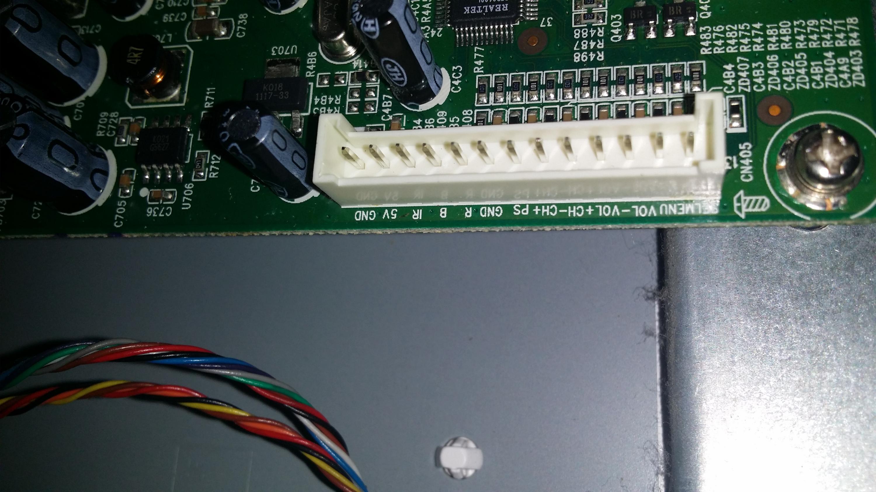

                  I have found one of the culprits.
                  I have uploaded the pic of the connector on the main board from the keyboard and IR.
                  Pin Voltage
                  GND 0.00
                  5V 3.3
                  IR 3.3
                  B bouncing. .171mv--.4v
                  R 1.75
                  GND 0.00
                  PS 3.3
                  CH+ 3.3
                  CH- 3.3
                  VOL+ .50mv
                  VOL- 3.3
                  Menu 3.3
                  Sel 3.3
                  Hmm... I disconnected the keyboard connector and vol+ goes to 3.3v.
                  Since I don't have a remote for this tv I quickly jumpered the PS to the GND and low and behold I get a beautiful blue light but no back lights. The same happens with the old Main board. So it looks like the vol + switch on the Keyboard is wonky. Looks like the old main board, might have been good... back to testing the voltages from the main post.

                  So now it looks like there is an issue with the Inverter part of the PSU/Main Board. Looking at the service manual I have a lot of parts to test on the inverter side. That will be another night.
                  Anybody see anything I might have missed?

                            From poSt 1:Checked all the buttons, they are all open until pressed then I have continuity.
                            So now do they still check out OK?
                            what resistances are you getting between the two open contacts on each switches?
                            • culcuhain
                              • May 2016
                              • 186
                              • U$@
                              Looks like 18.4K ohm across all except vol+. Vol+ shows 0.6K Ohms.
                              Did the checks from p24 of the manual except for IC901 and IC903 and the transformer T902. Not sure how to test those ICs. All others tested fine with no shorts. I think it is time to crash and regroup tomorrow. thank you for your help.
                                The resistance between the two terminals of the normally open switch should show open circuit, the VOL+ is bad for sure.
                                You did remove the cable to the board first, right.
                                • culcuhain
                                  • May 2016
                                  • 186
                                  • U$@
                                  My bad. It was still connected. I disconnected it. All show OL except for Vol+ is it showing 0.6K ohms. So bad switch. Time for bed. 445 cones quick.
