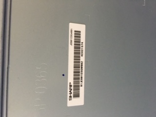

        Re: Sony LC-60SQ15U looking for LED backlight part #s
        Sorry, Sharp. I have a few things going on in the shop right now and looked at a sony as I was typing. The number on the panel is R1JE601D3GW00Z. I don't have pics of the strips because I don't want to take this thing apart without knowing if I can get the part.
          Can we see the LCD panel number sticker? That number does not look right.

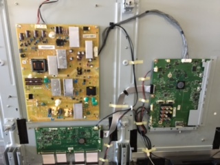

            I added a pic of the boards since I was taking pictures.
              OK, not much info out there for that LCD panel.
              By the way, out of four LED strings, how many are bad?

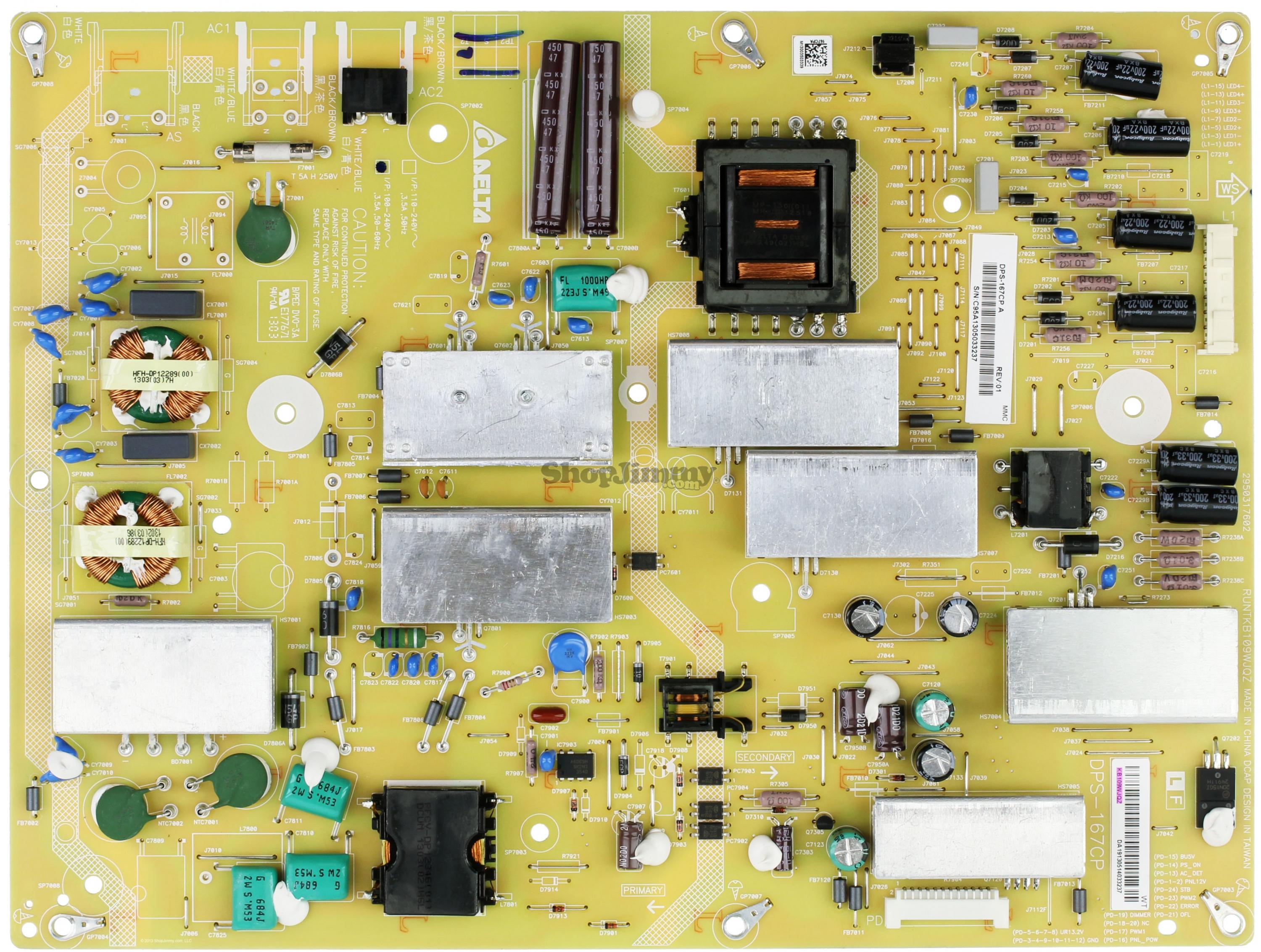

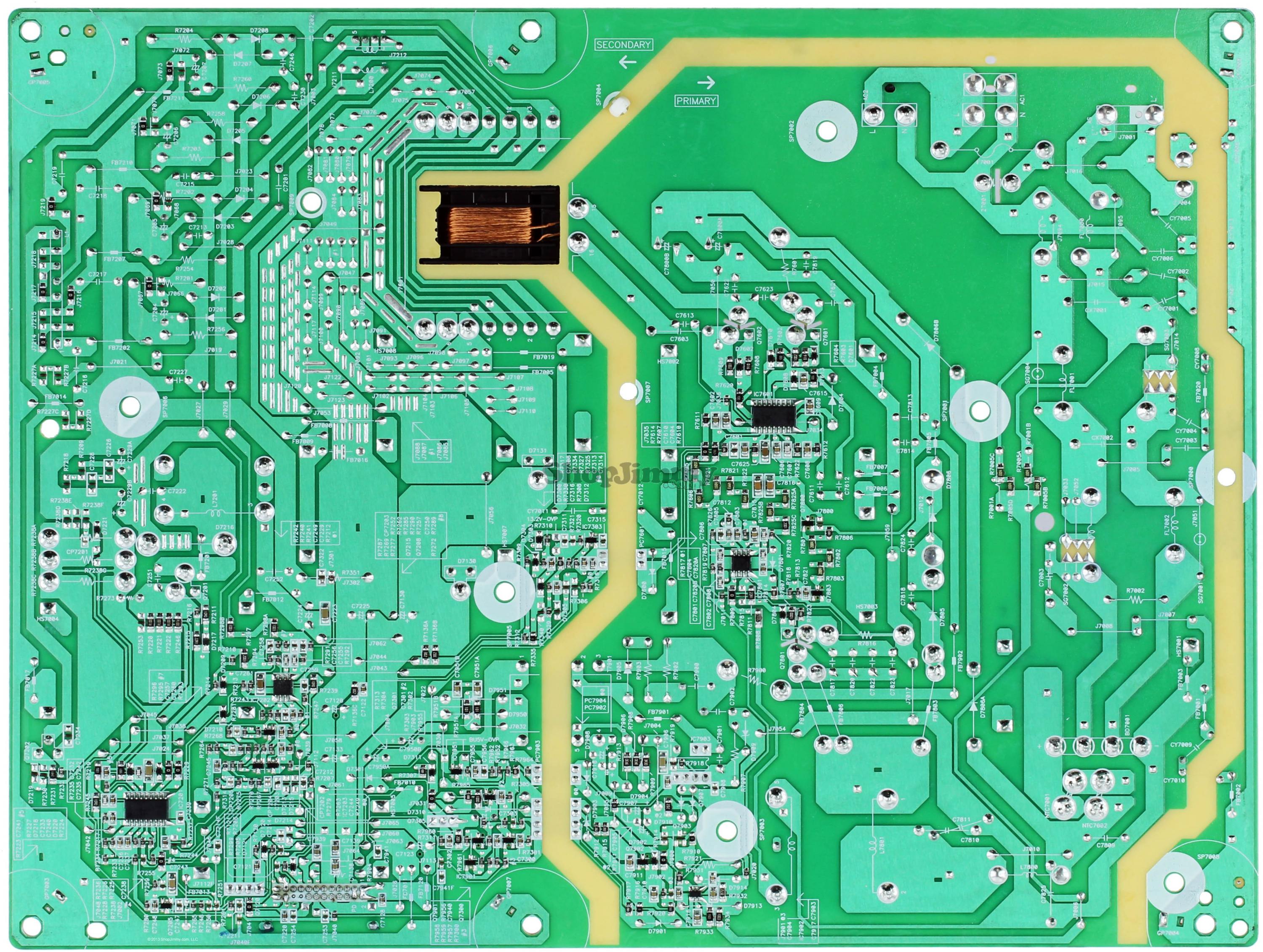

                        Sharp RUNTKB109WJQZ (DPS-167CP A) Power Supply / LED Board
                        http://www.shopjimmy.com/sharp-runtk...-led-board.htm
                        Pictures provided by shopjimmy.
                        I would inspect and resolder the transformer legs, the legs of the devices attached to the heat sink.
                        Check and report the DCV reading of the connector PD, make sure to put the pin names with each reading.
                        Check and report the readings for the DCV between the two legs of the caps:
                        C7204, 7205, 7206, 7207, 7229A, 7229B.
                        This is done to verify that the power supply/LED driver board is good or not unless you are sure that the LED is bad then do not do any of those above.
