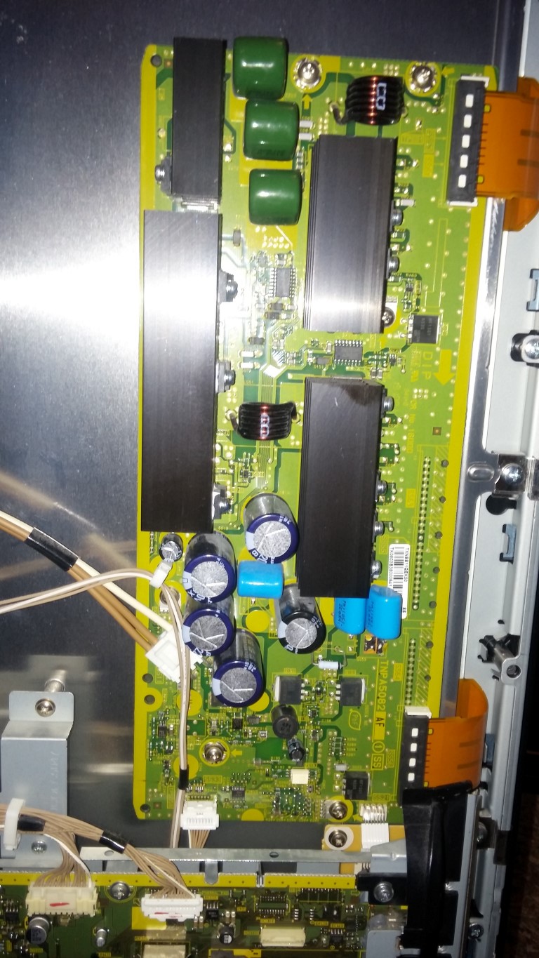

    Hi

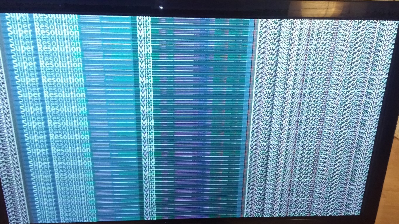

    I'm having a weird problem with my Panasonic P50G20E.
    After a few minutes the screen starts "scrolling" vertically, or broken up in different sections. Hard to explain, see picture. Power off with switch on TV, temporary cures the problem, then it starts again.
    Nothing seems to change when using the remote. Eg. menu changes. The image is locked in this scrolling mode.
    Anyone had this problem?
    It is not shutting down and no blinking errors.
    Updated firmware, but still the same. Any advise is appreciated.

    I'd say your A-board has suffered heatstroke on one of the BGA chips and the solders have come free.
    When looking pay attention to what version , each size has a different revision.

      What's with the word Super Resolution being displayed on the left? Is that from the TV?

        Thanks for your answer, yes its from the menu. At this point I had it unplugged from any source.
        That was my assumption too, something with the AD board, hence I hoped for a firmware upgrade. Anything to do, or is a board swap the best option at this point?

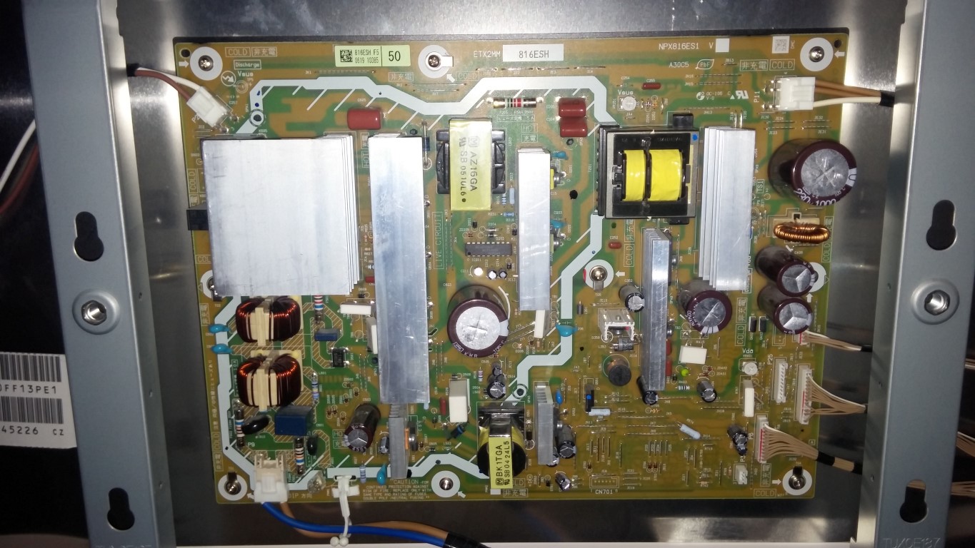

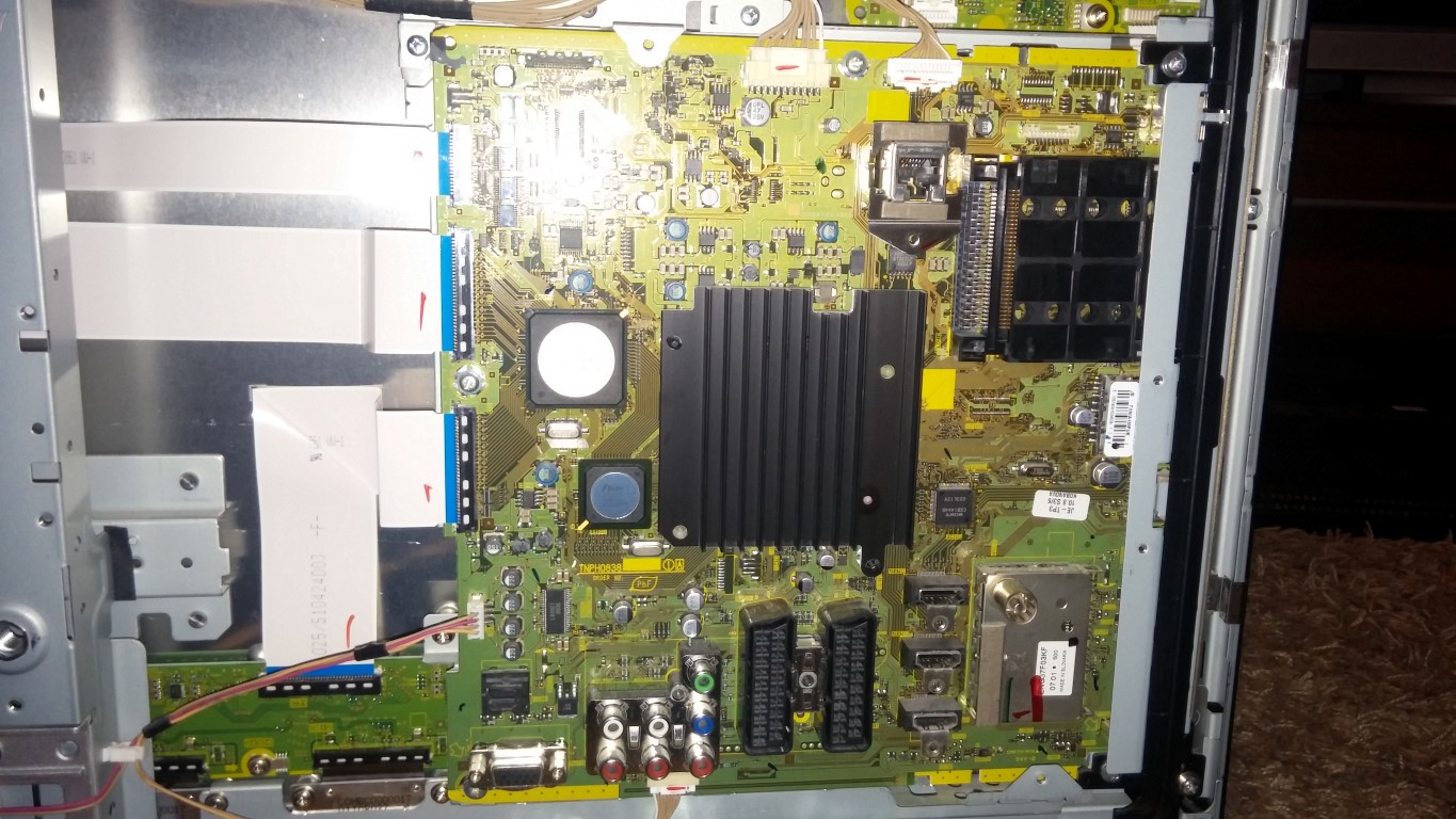

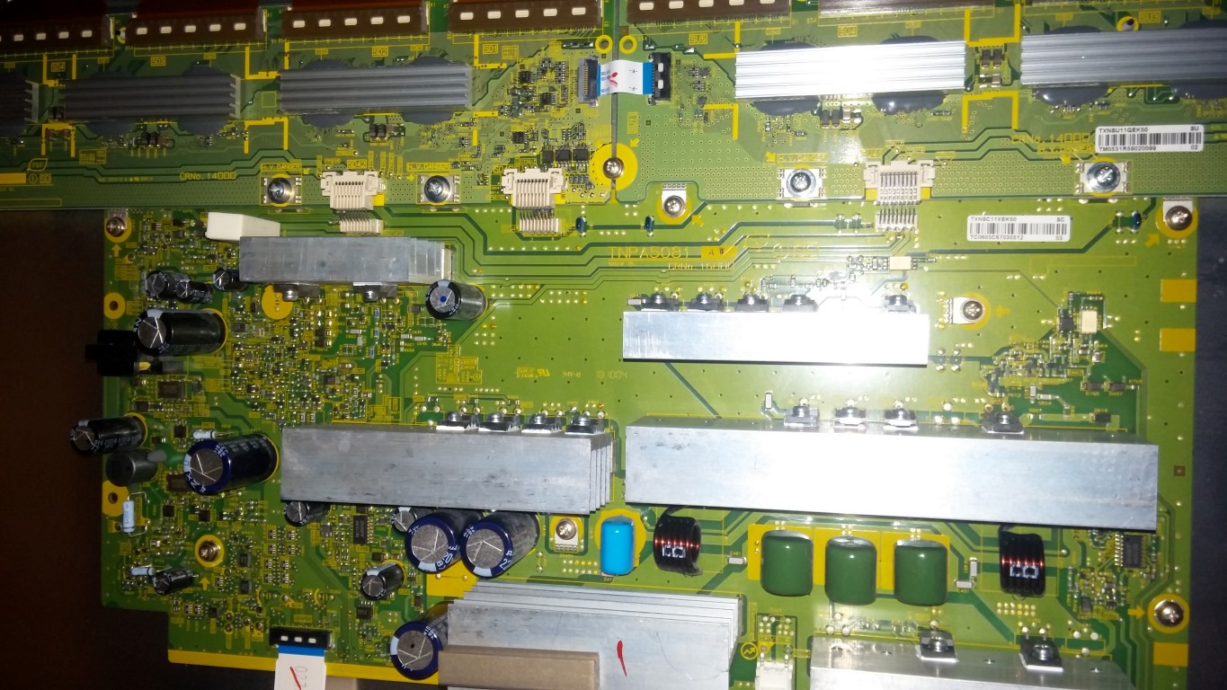

        Added some board pictures.

          Board unless you know or have a bga rework station. They very hot those chips even with a heatsink.

            Probably the chips with no heatsink that have failed.

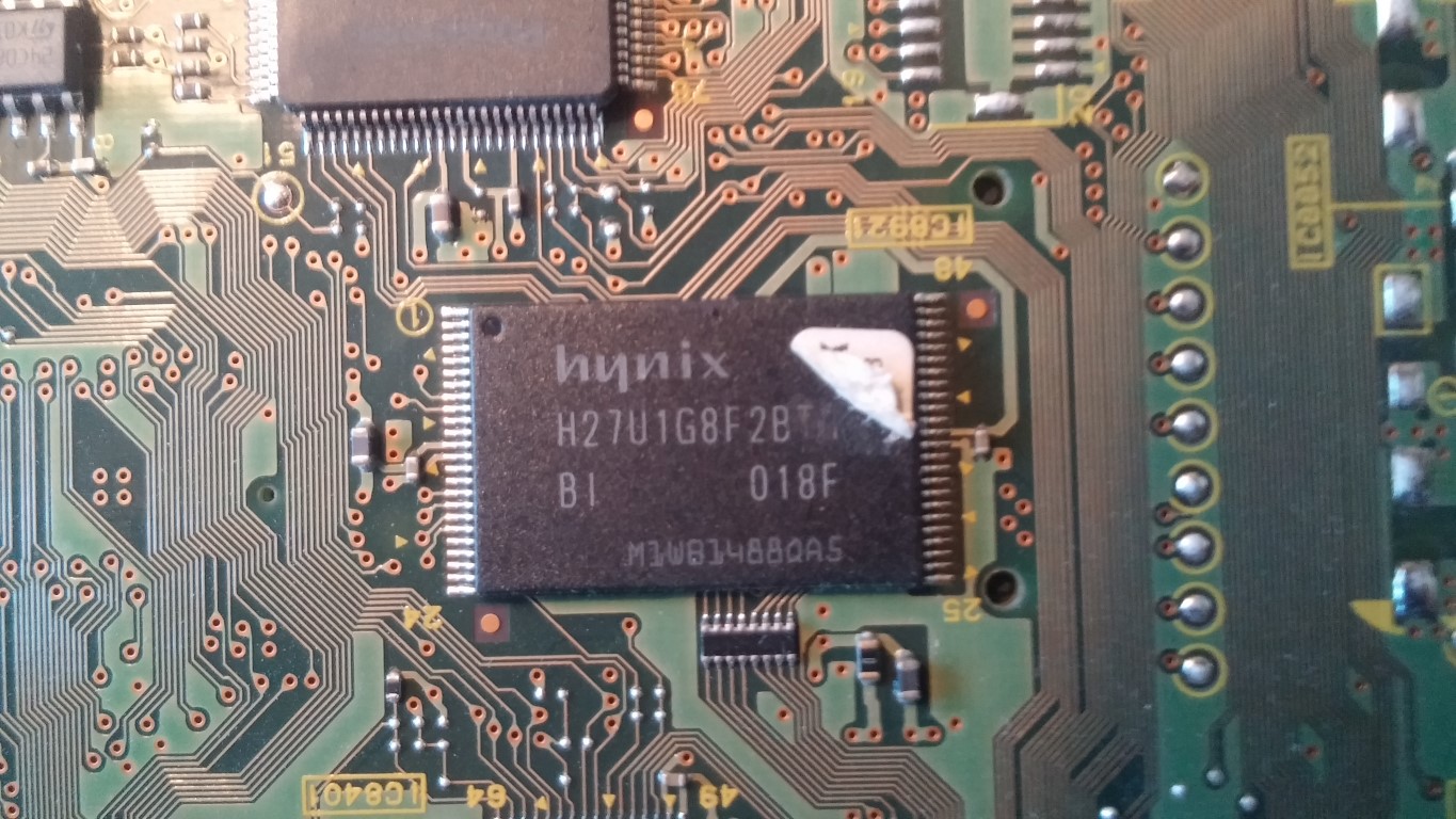

                        On the under side of this board , there's a large Hynix Flash chip, 48 pin ic8921, if there is a white sticker on it, what's the 3 digts 2 letters?
                        • bluebear
                          • 90
                          Re: Panasonic P50G20E
                          Ok i Will Hook it off. Aything to consider before unhooking, so I dont damage other parts?

                            Maybe to change termal pad between cpu and heatsink, or if it is a paste to change it, and then install a fan on heatsink, maybe it would help, for how long i don't know, but just an idea

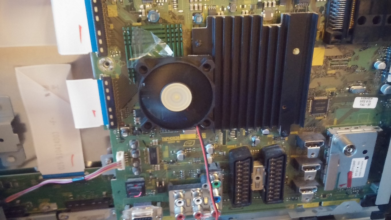

                              Hombre, you are a genius. Had some time to continue testing this evening. Measured the chips and the little one on the a-board where hot to touch. Measured 90 degrees Celsius with my IR thermometer. Tried first with my wife's hair blower with no heating and it worked longer than ever before. Mounted som small DRAM heatsinks if that would help. Nope still to varm.
                              Then tried a small fan, and voila. It has now stayed on for 1 hour.
                              Lovely, maybe a short fix we will see. I mounted the fan on the outside of the backpanel and power it by a separate power supply. A little noisy though, have to try if less voltage will be enough to cool the chip. Great idea though, thanks Hombre. Also thanks to ReeceyBurger123 and tw2005 , I´m still interested in your solution, picture attached if this does not work as planed.
                              The white sticker has 329AK on it.

                                  Short update.
                                  Still having the same problem, but now it runs for hour, rather than minutes.
                                  Perhaps I need to increase the fans to keep it cool enough.
