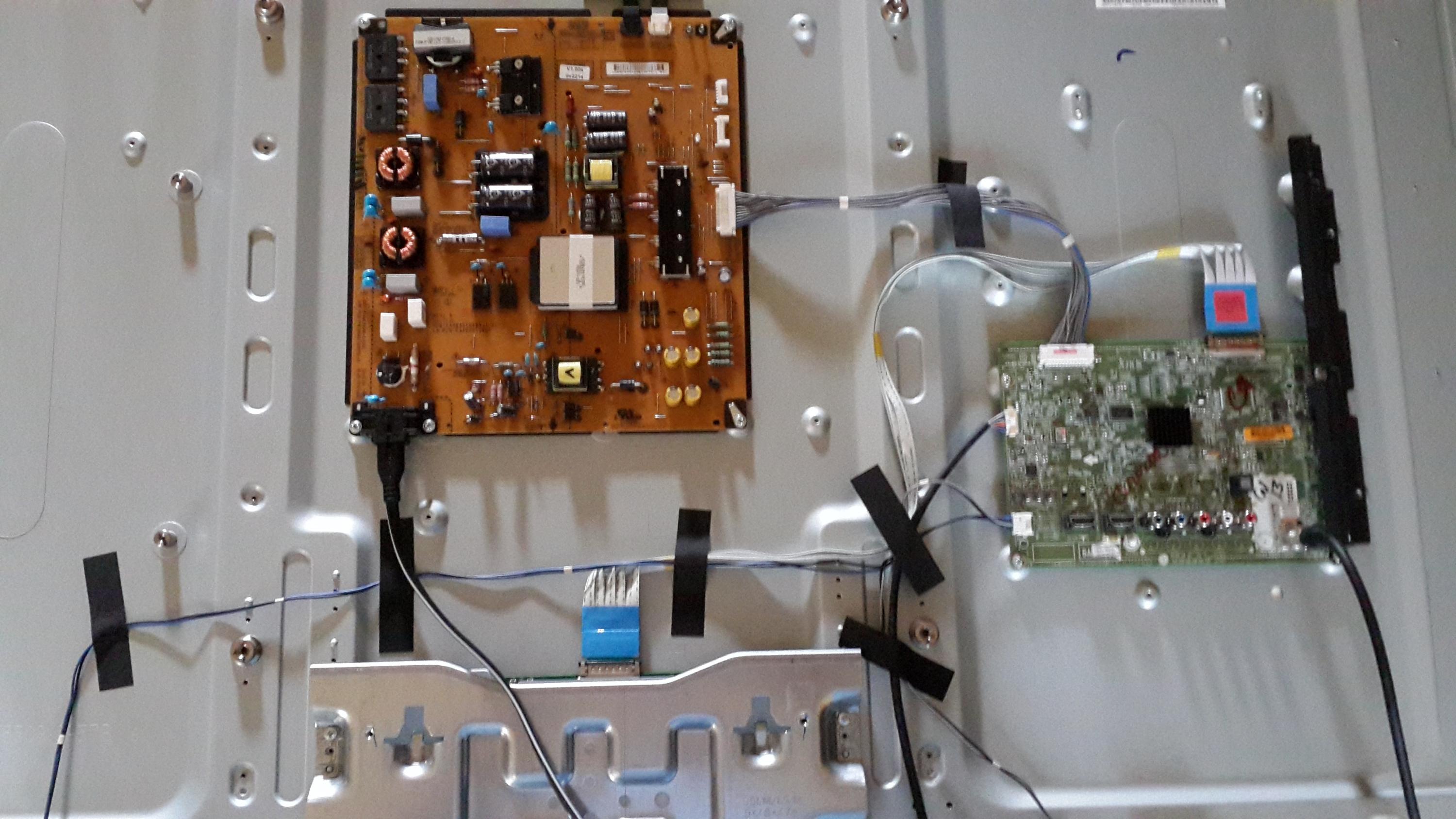

    This Tv came into our shop today from our local church thrift store so we are going to try to help them out hopefully so they can sell it and help the poor. It has a solid red power light at plug in. When you turn it on the backlights come on for 2 seconds and Tv shuts back off. There is a led on the power supply that blinks 4 times...stops...then 4 blinks ect.

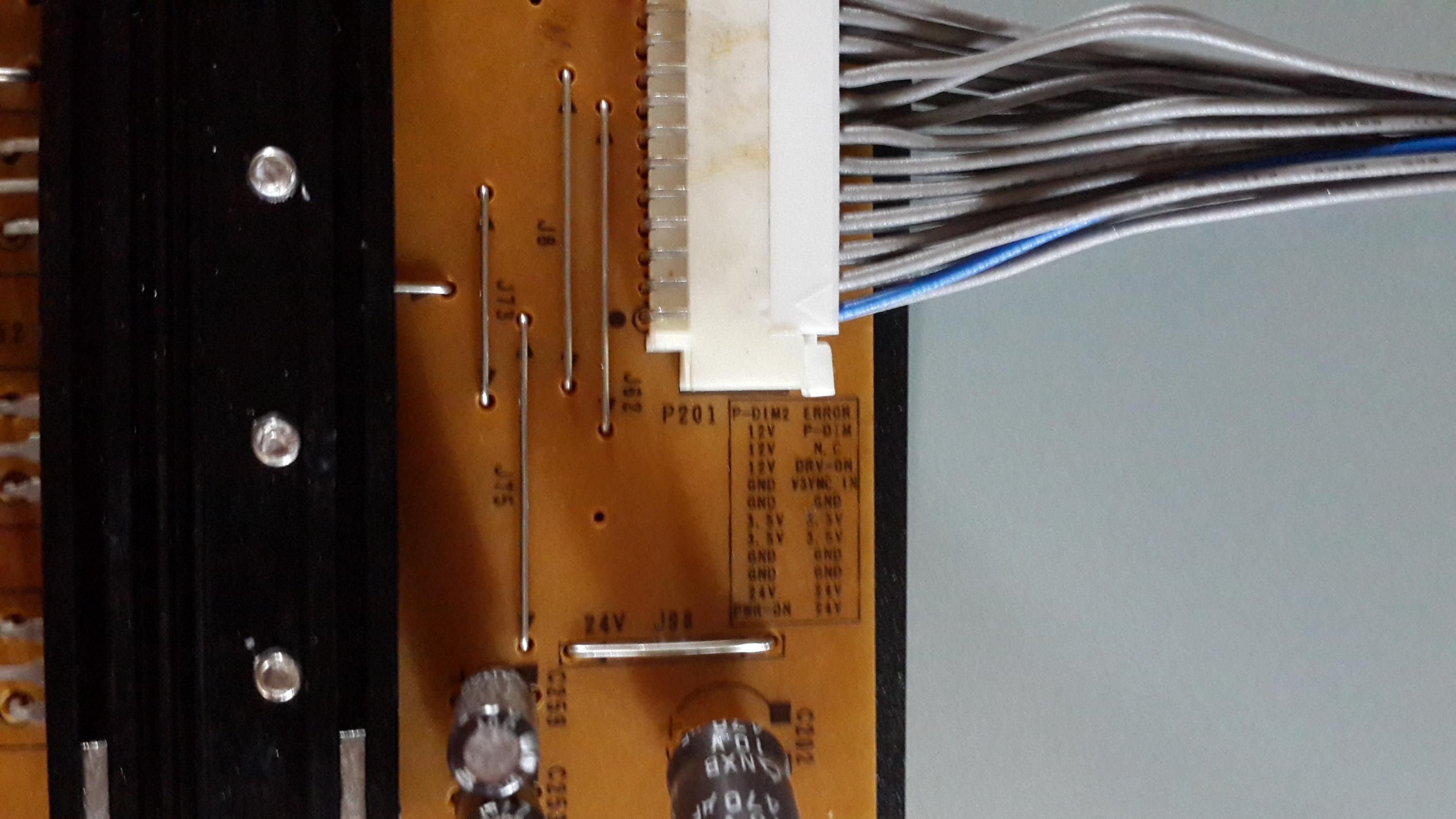

    Voltages when plugged in with main connected
    P Dim 2 Error 0.11Dc
    12v P Dim 12.07
    12v NC 12.07
    12v Drv On 12.08
    GND
    GND
    3.5 0
    3.5 0
    GND
    GND
    24v 24.87
    Pwr On 24v 3.406 Thank you for the advice

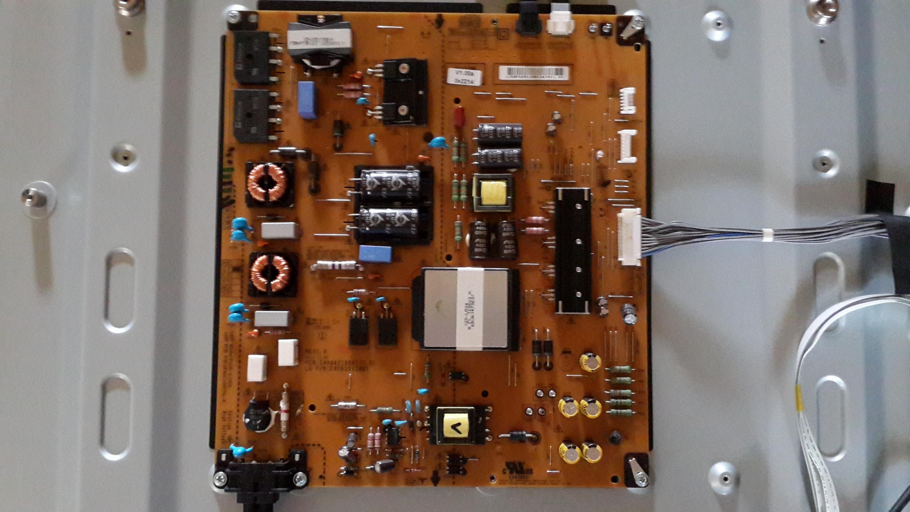

    Re: LG 55LS4500-UD Shutting down
    Top left of the power supply board you have a transformer. Below you have a blue rectangular capacitor. and then just underneath and to the right you have a diode. That diode is in parallel with the blue capacitor to its right. That capacitor and or diode I have seen short out many times.
    Take your multimeter to either or of those 2 components, and check for shorts. Now the picture is to blurry and low quality for me to actually see anything on the board such as location codes, but if I assume you have a EAY62512801 power supply then the diode is location code D607 and the blue cap is location code C603
    Good luck!

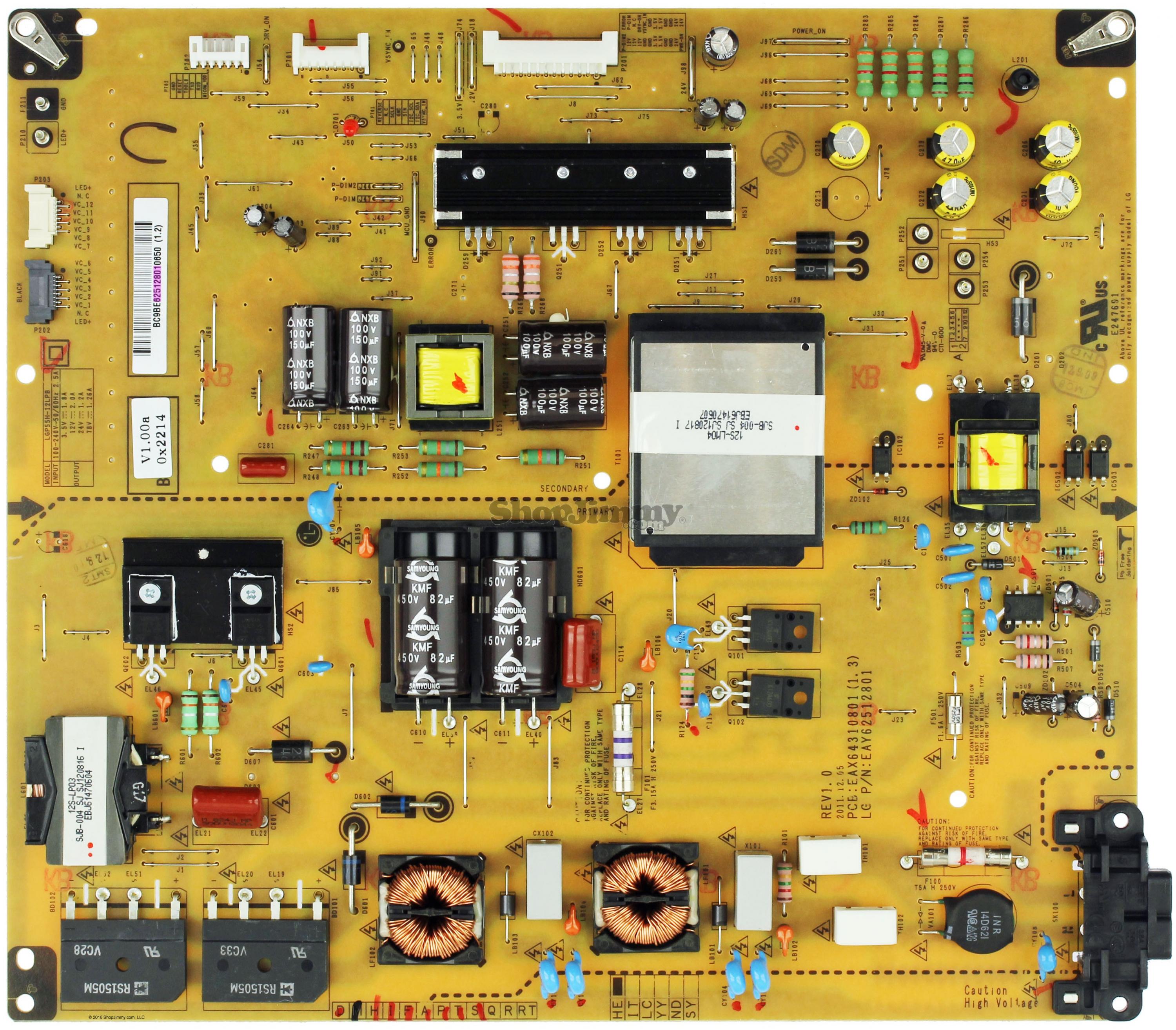

                  You have 12 strings of LEDs VC_1~VC_12
                  The LED+ is the boosted Voltage feeding the Anodes of the LED strings, the VC_1~VC_12 are the Cathode return for the LED strings.
                  So put the black probe on the chassis, then put the Red probe on the VC_1 then turn on the TV and keep and eye on the meter to see how high the Voltage will go up to and how low it will settle down after 3~4 seconds, record the reading, then do the same for the VC_2~VC_12.
                  Pictures provided by shopjimmy.
                  LG EAY62512801 (PLDK-L102A) Power Supply / LED Board
                  http://www.shopjimmy.com/lg-eay62512...led-board.htm#
                      That is normal for the Return (each return pin goes to the PWM controlled power MOSFET and the current sensing resistor to GND) pin to show higher Voltage at startup because the LEDs will be driven at low current start up.
                      You do have problem on V_1 (shorts, big doubt on this one, may be you are on the wrong pin) and V_12 (open).
                      BTW, are you sure that is what you are getting at V_1? You count the pins correctly?
                      Connector P202 (Black dot = pin 1)
                      Pin 6 is the V_1,
                      Pin 7 is N/C
                      Pin 8 is LED+
