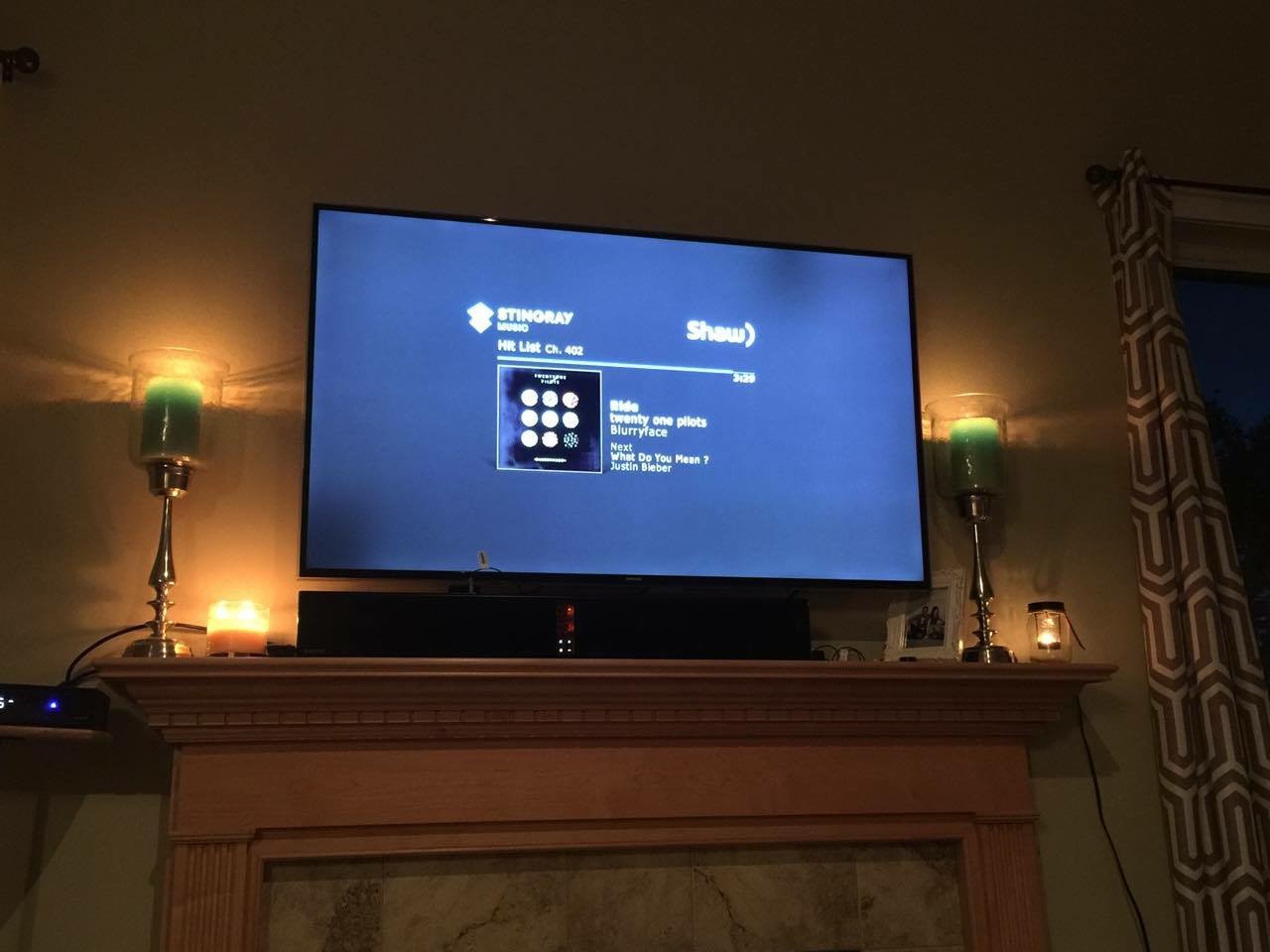

    Samsung UN55H6400 LED TV shadow on screen
    My friends tv has shadows on the screen. Is this an LED issue or a panel issue?
  • ReeceyBurger123
    Never Give Up !
    • May 2014
    • 7325
    • Britain
    Re: Samsung UN55H6400 LED TV shadow on screen
    Might be a failed Led in the array or possibly the diffuser sheets are not seated properly. Only way to know is tear it apart also please tell him to turn down the back light having it that high is asking for a breakdown might already be failed.
      It looks like some of the LEDs are shorted out but not enough to trip the protection circuits yet but more LEDs will probably go out soon too.
      • Diah
        • Feb 2013
        • 6599
        from photo i can see most the LCD rand hat shadows at different level, also there ar no LED exact at the corner down left .. i think its Panel Sandwich open ( fault )
        • tech2014
          • Aug 2014
          • 807
          thank you very much guys.
