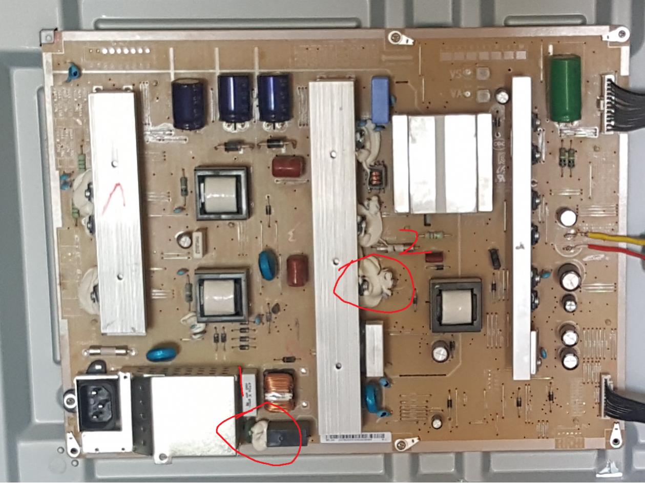

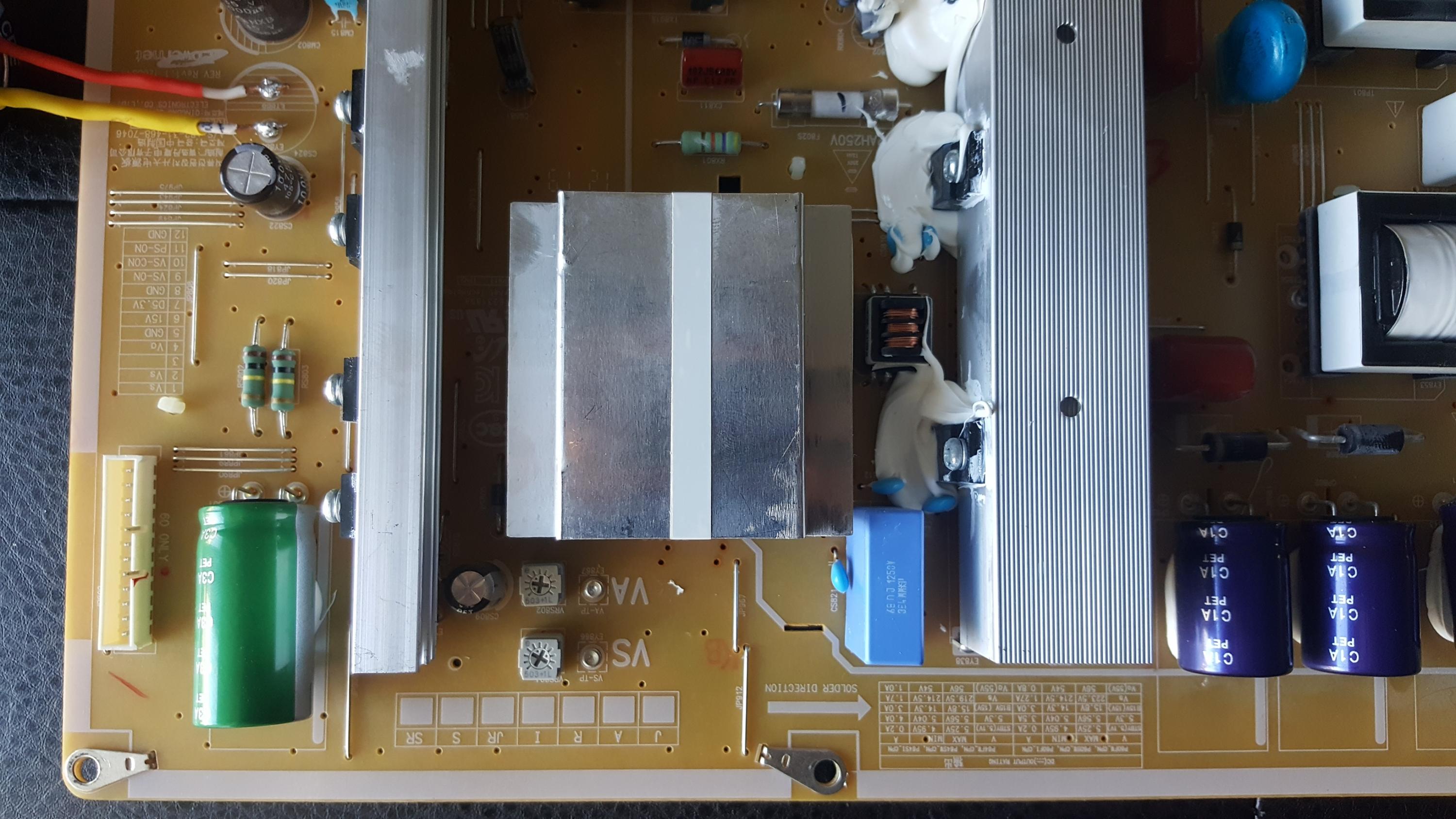

                  See the silicone "blob" on the bottom of the power supply board ?
                  Remove it and clean the area with denatured alcohol then
                  re-solder the pins of the regulator IC.
                  HTH.
                  • kyij
                    • Jul 2013
                    • 45
                    #29
                    Re: Samsung PN60E6000GF 60" Smart TV turns off, red flashing power light
                    HTH.
                    Are you talking about the silicone blob "1" or "2"? Do you think it has to be replaced or just resoldered? Thanks

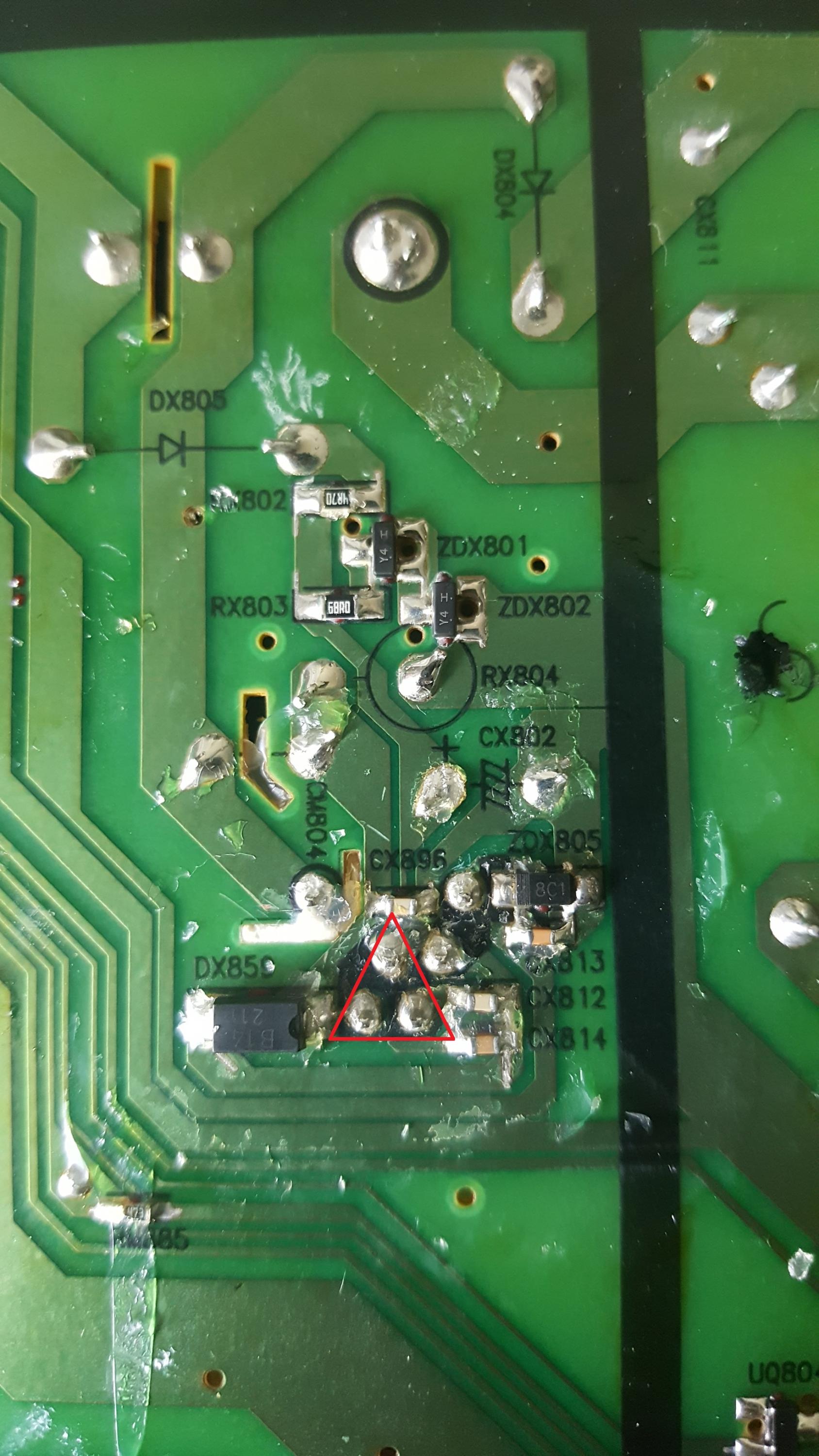

                        Okay. Working on it now. And sorry for my ignorance, I just only saw a relay, an inductor, the 275v relay. Plus what looks like a green resistor? Did not see what appeared as a regulator IC, hence why I asked.
                        • dick_barton
                          • Aug 2015
                          • 6643
                          • Wales
                          #32
                          There appears to be components legs going through the power supply board from top to bottom and then connecting to the opto-isolators. The strange thing is I would have thought they would have soldered these components in because other componets on the bottom of the board are left with a very thin copper track to these IC's because of the hole drilled out out the centre of the pads. I think it would be worth doing a continuity check.

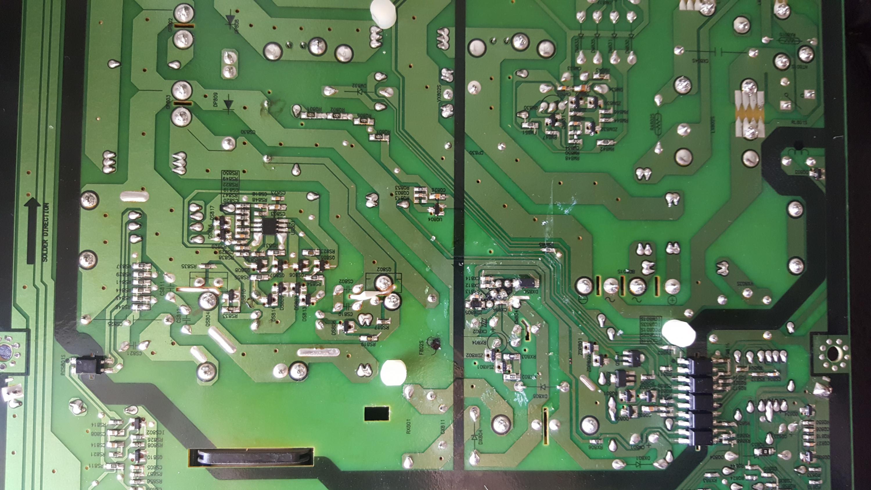

                          • Terryfictv

                            Remove clear "blob" on the solder side of board ( area #2 )
                            Leave white blob on component side alone for now !
                            • kyij
                              • Jul 2013
                              • 45
                              #34
                              Yea I should've known you meant the solder side. I am almost done cleaning the area but here is a picture. Although I am not 100% certain which solder joints are for the regulator IC. On other areas of the board, they seem to be denoted with a "Q" but I do not see that in this case. Highlighted is the 3 pins I believe could be for it, but again, not certain.
                              Edit - now that I look at that region, I am not even sure those are for it, as the upper solder joint of the triangle appears to be connected with the solder joint to the right of it.
                                I see what you mean. There appears to be a wire on the flip side that connects two of the legs of the opto-isolators. When I was searching more on these, it seems like they should be tested against resistance rather then continuity. The continuity 0's for a few leads but the resistance varies from each pair.

                                  Use an old toothbrush and alcohol to clean area.
                                  Pins are two offset rows.....
                                  Take another pix when clean....

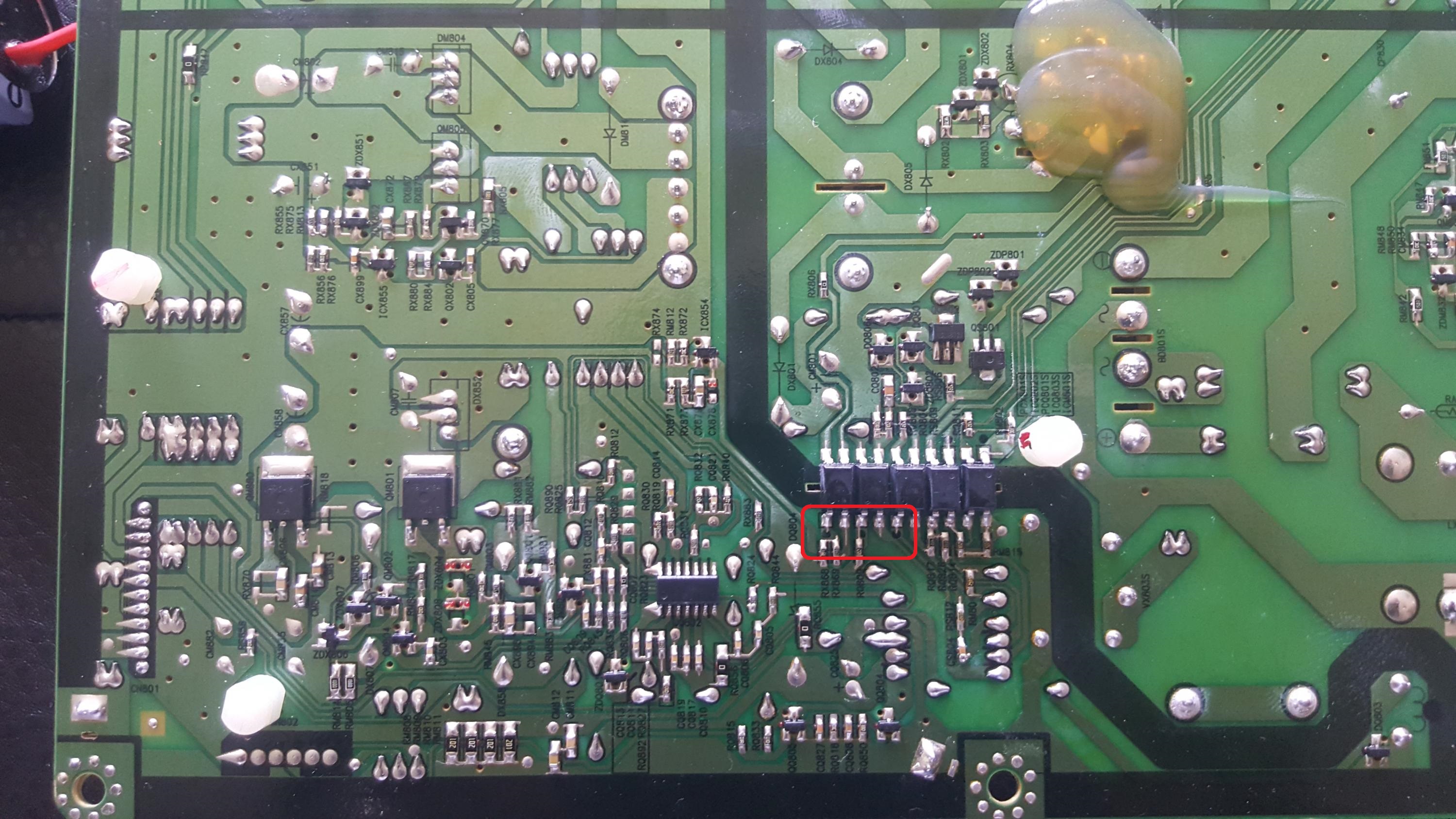

                                    Ooopps! Evidently the removed blob was not covering the pins of the IC !
                                    Can you take a close-up pix of component side beneath area 2 ?

                                      Not a problem as I know it's hard to tell from just pictures. Took a picture of the front and the back, for comparison. Let me know if you need a closer up picture.
                                      I know there are a lot of repair kits sold online for the Samsung power boards which contain these regulator IC's. Do you think they just need resoldered or replaced? Is there a way to test them without applying a input voltage?
                                      PS: It does look like there is some corrosion on the QS802, think that is the issue?

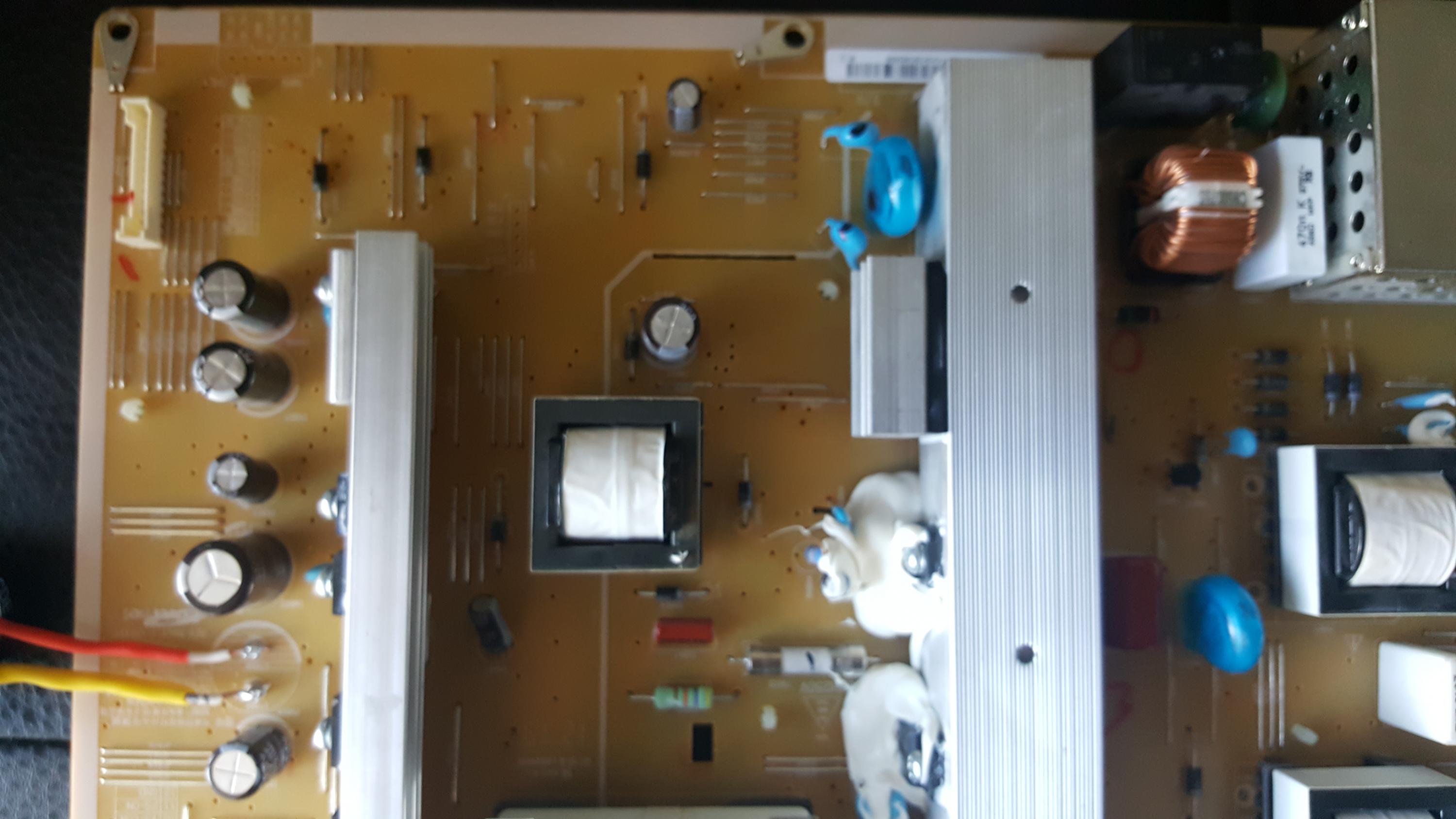

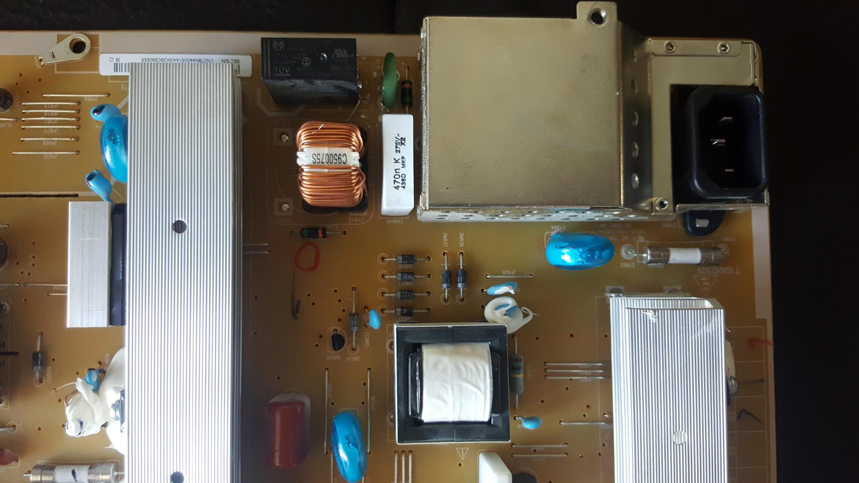

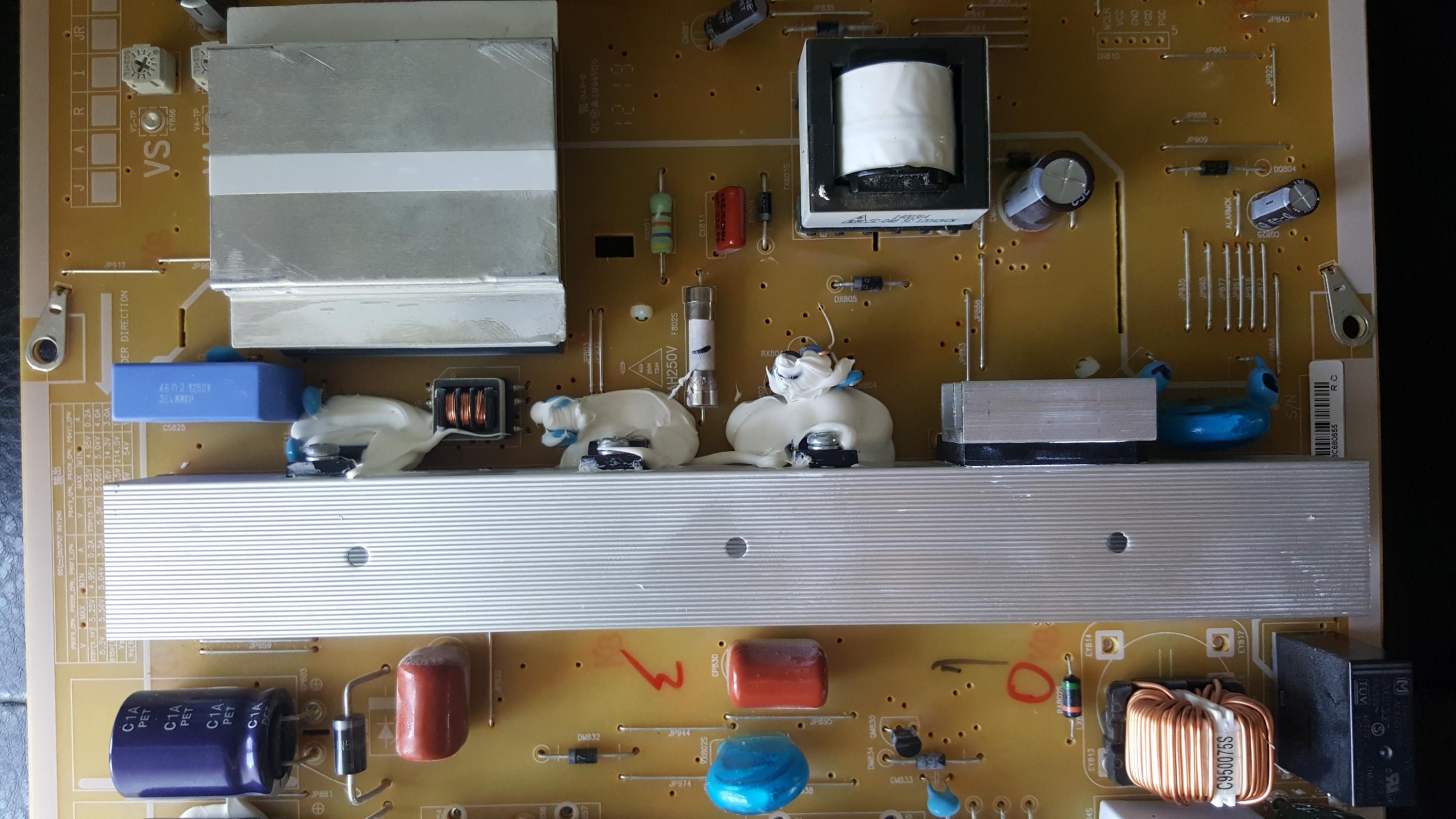

                                        Pix of component side divided in four quadrants ( half / half = too large )
                                        So, four pix should show with magnifier....

                                          Attached are each quadrant.
