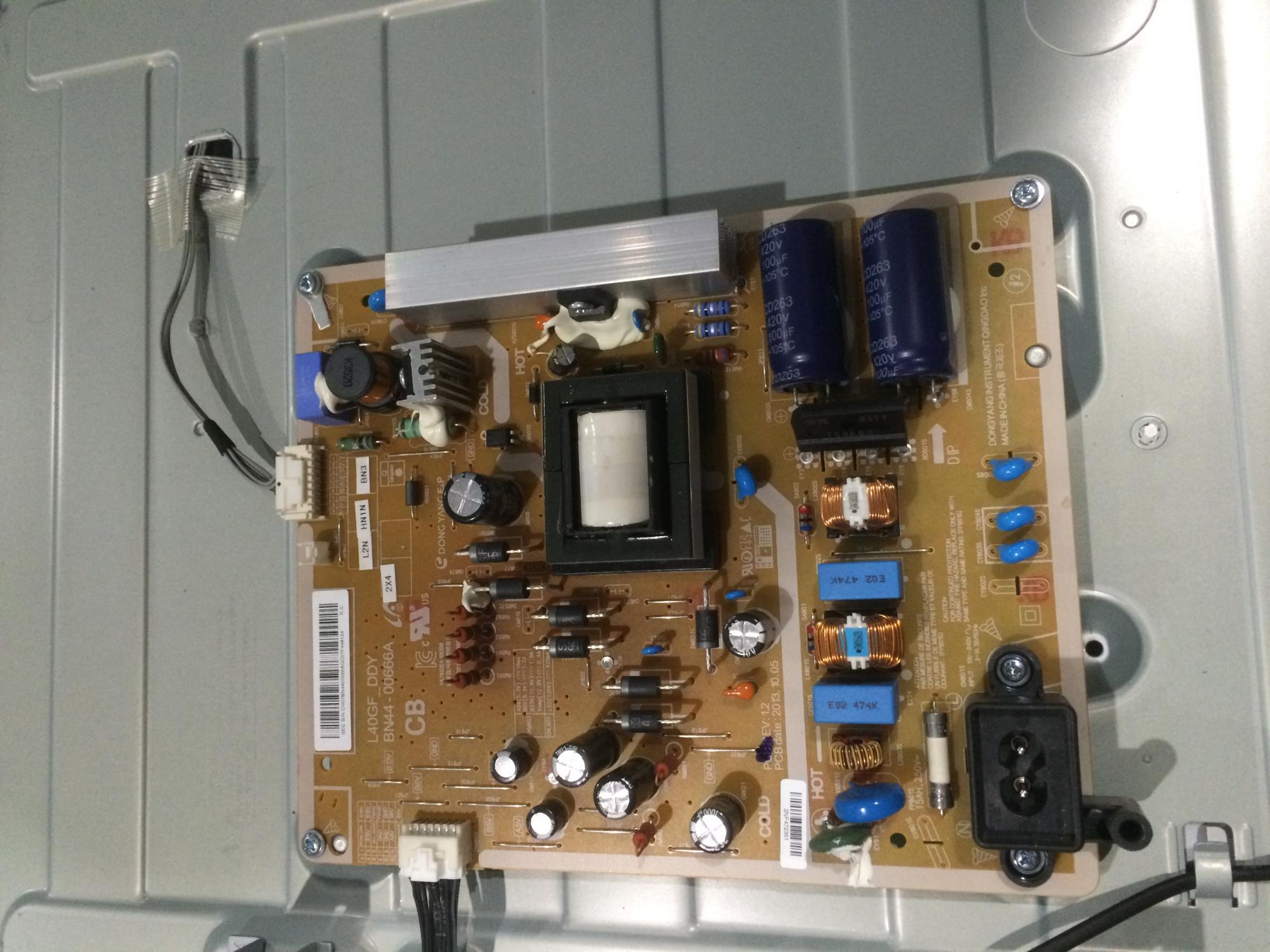

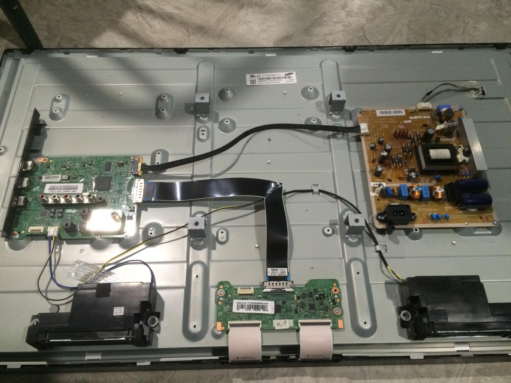

      picture and sound yes. Just confirmed "NO" back lights. Which lands us at the "back light inverter"
      this make/model looks like it has the inverter coming off the power supply board as there is no seperate inverter. All I got are TCON board, Main board, PS board and 2 speakers
      • sugar_ray
        • Dec 2012
        • 121
        Re: Gotta be a T-con problem?? SAMSUNG UN40EH5000
        Pics
        • sugar_ray
          • Dec 2012
          • 121
          Pic 2
          • dick_barton
            • Aug 2015
            • 6643
            • Wales
            The led driver output voltage I believe should be 145V@470mA so check the voltages on the pins of the connector which have the wires going to the LEDS.

                I bet its the Leds' but first before you take the whole Lcd module apart. Check the drive voltage with the Leds unplugged, it should rise to 145v. If it does but collapses the driver is shutting down meaning there is a O/C Led in the screen if it does not rise to 145v the driver is not running meaning it is at fault.
                  If the LED string has open circuit, it the DCV at the pin 1 d+ on connector CNL802 will be close to 200VDC, around 135V if the load (LEDs) is present.

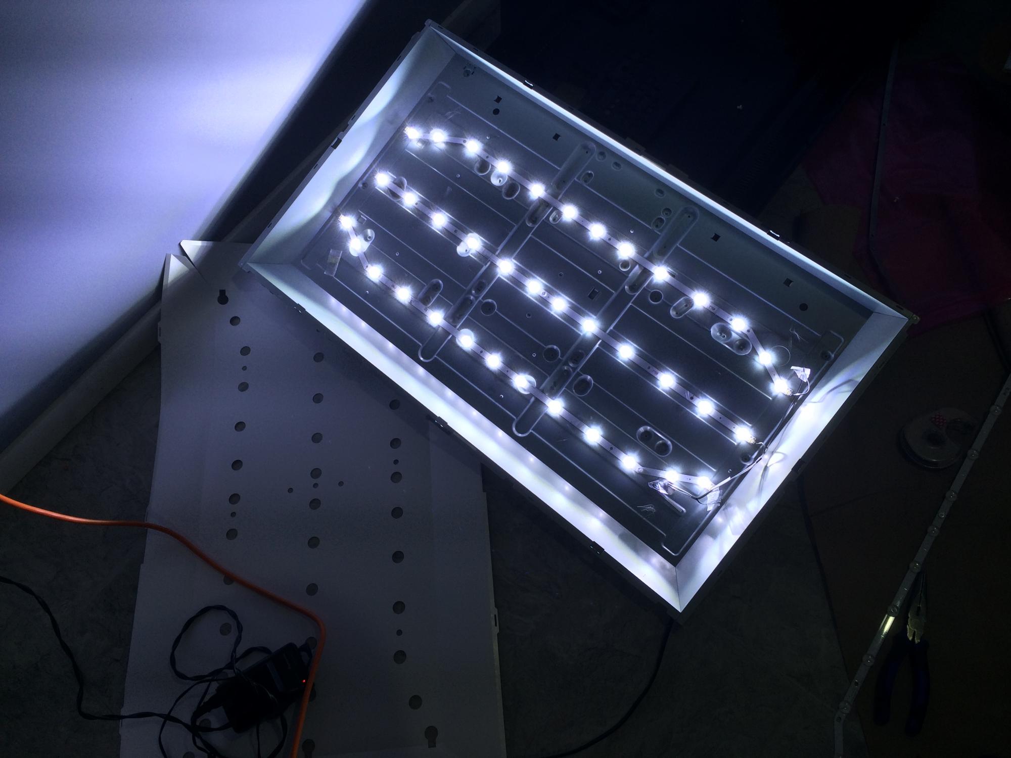

                            • sugar_ray
                              • Dec 2012
                              • 121
                              ReeceyBurger123
                              Thank you my friend!! Very relevant tutorial. While I didn't replace any individual LEDs. Using 2 AA batteries jumpered to Achieve 3 volts I was able to test each bulb, sure enough 2 deadbeats within the string.
                              Shopjimmy had a replacement set (12 in stock actually) for $39 so I ordered, they arrived and boom!! We have backlight!!
                              Now for getting the trim plate and bezel back on without damaging the wafer thin panel!!
                              Final step......dim backlight via remote control
                              Saved another one from the scrap yard!! Thanks guys for all your input
