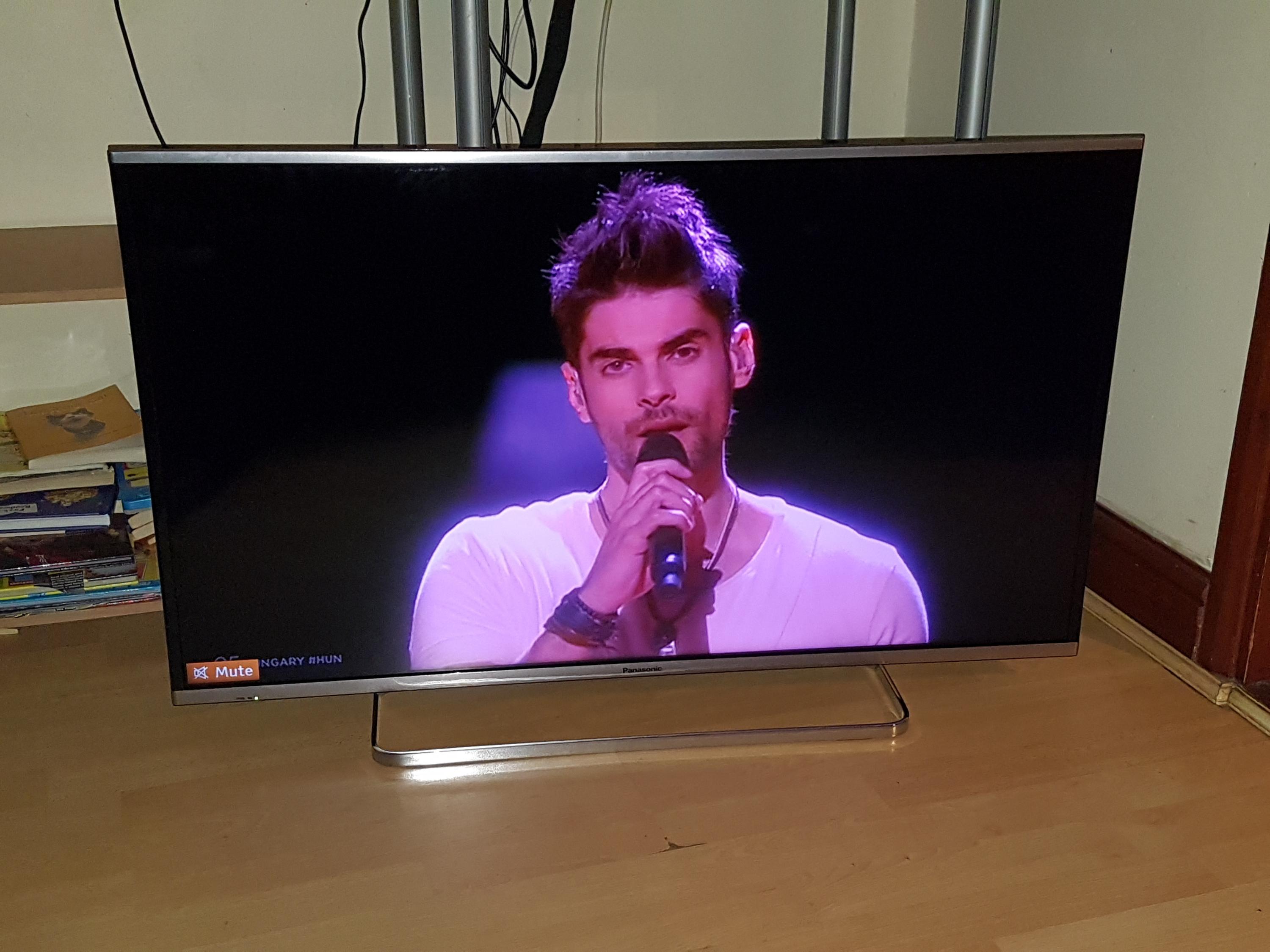

      UPDATE :
      one strip of LEDS blown and possibly more but still testing
        Re: Panasonic TX-40AX630B flashing green standby
        sorry to hear that, i assume the LED unit at this set are the small one with Just one LED light vor 2.8-3-2 Volts. if replace one or 2 dont worry on luming as size 60 will never effect either if you just jumper it with zener diode
          All fixed and what a pain in the arse that was
          but on the plus side its a nice tv
          thanks for all your help guys
            How did you fix it in the end buddy ?
              Had to stack the LED luckily only one had blown on the strip

                good job, but who are on the photo.. he will not win at all... its go this year to Australia
                  I know lol the wife is watching it so i might put a tenner on australia now
                                    Hi, I am new to the site and came on here as have exact same TV and problem you had and also have one LED rail outputting only 3.1v, same as you. I had already replaced the A board when I found your posts and would be most grateful if you can advise me what type of LED strip I should buy to fix it with please. I cannot obtain the correct LED Strip to just replace, so will need to Stack as you did. I would like to buy a strip before I pull the back off and would greatly appreciate you telling me what one I should buy, or will any strip from a Panasonic TX TV have the correct LEDs? Thanks for any advice. Mike
                                      Hi
                                      If you take the panel apart the strips have a part number on them,
                                      with a bit of luck and a search you may find one.there could be two different
                                      strips in there.
                                      If not you need a strip from the same maker as it needs same voltage /
                                      current specs.
                                      Alan.

                                        Thanks Alan, I thought that would be necessary. I had hoped to be able to contact directly the guy who started this post, as he had the exact same tv and my symptoms are exactly the same. I really wanted to have replacement part to hand, so I could take the backplate off and repair it all in one hit. I will do as you suggested, I guess that is the best way of getting the correct part anyway.
                                        Mike
                                          #40
                                          Mike
                                          Hi
                                          The problem is, that possibly your set has a different panel fitted
                                          to the o/p so it's best to open it up and know for sure.
                                          Alan.
