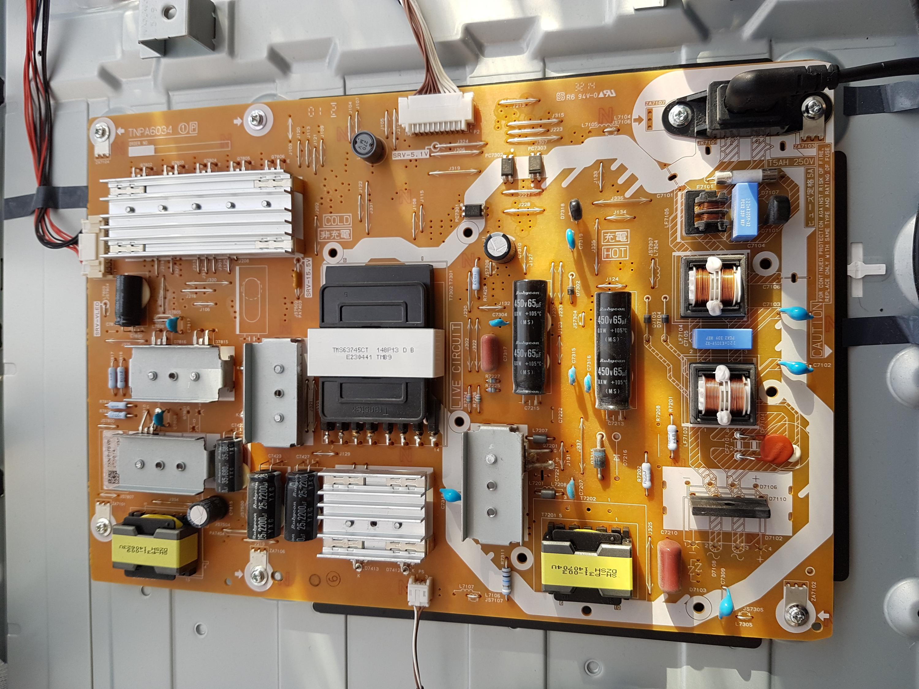

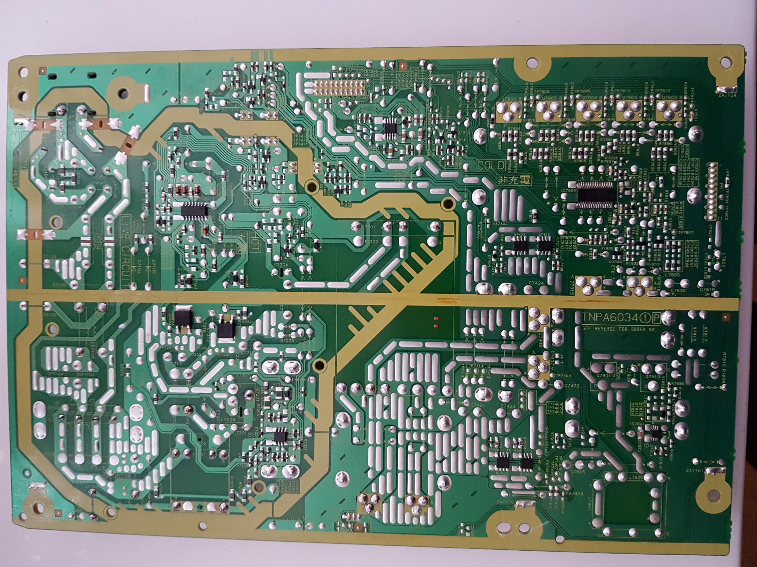

            Re: Panasonic TX-40AX630B flashing green standby
            Can we see the straight shot pictures of the bottom side of the Power supply board?

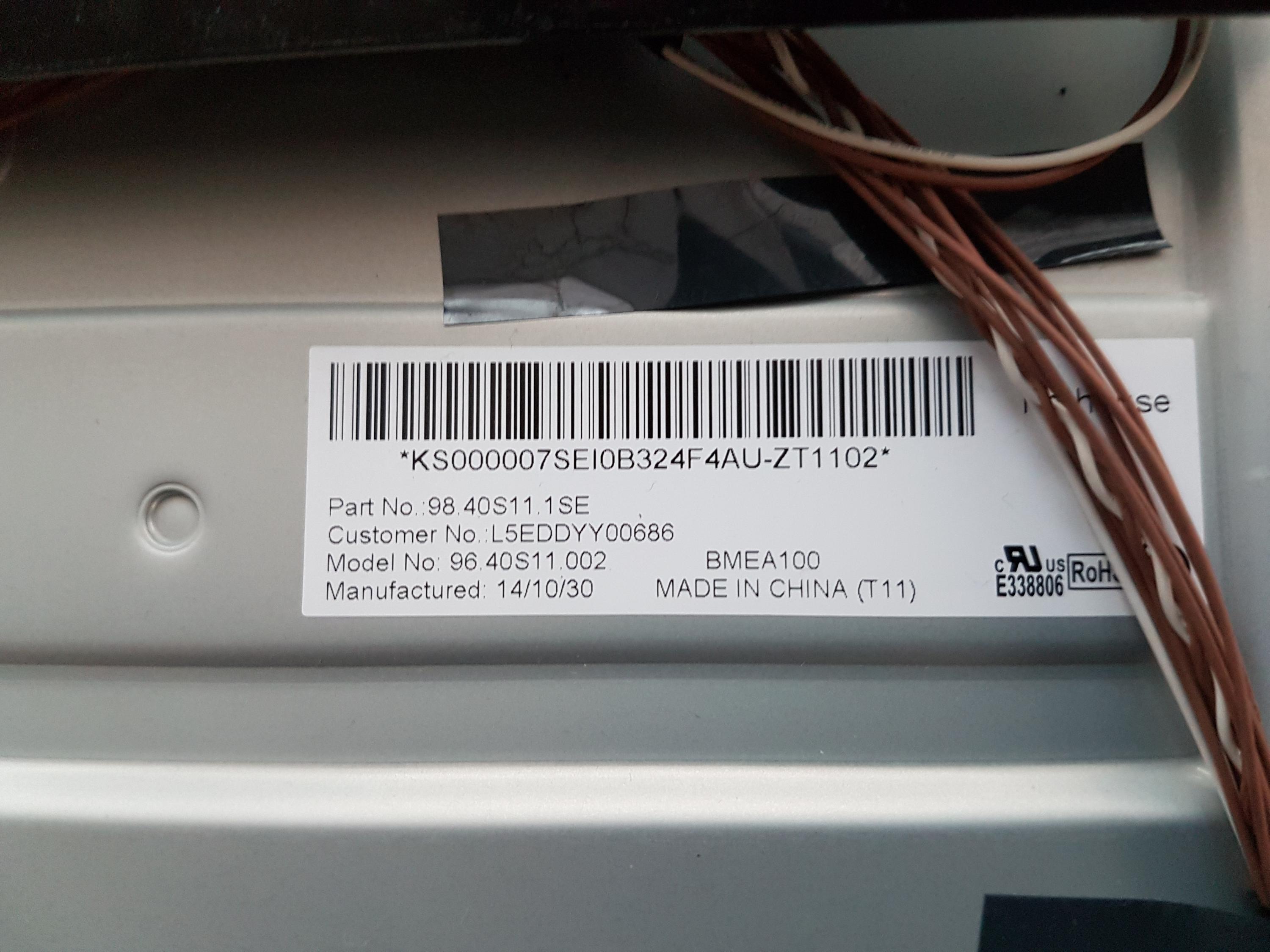

                BTW, what is the LCD panel model number, I cannot read the sticker.

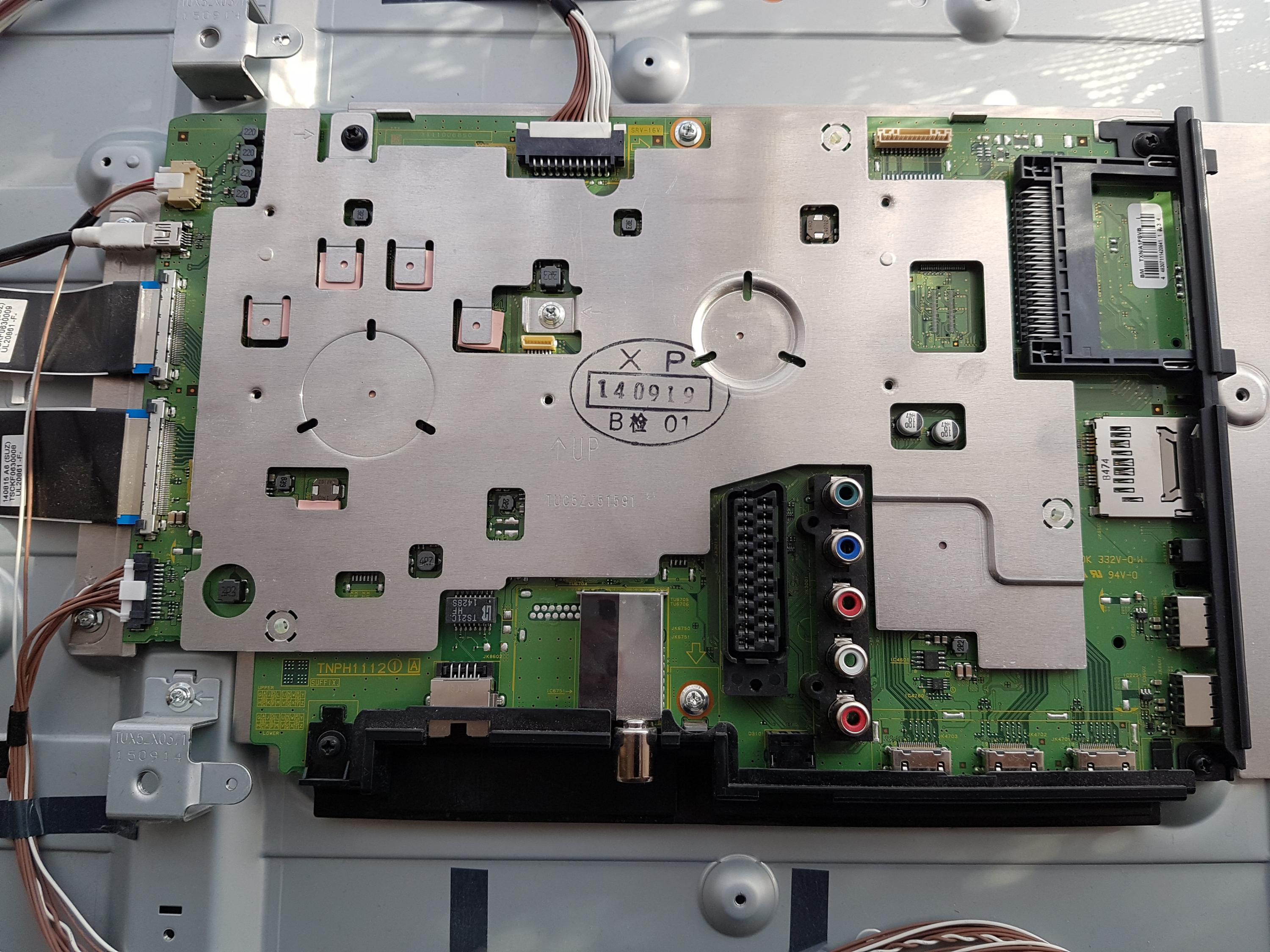

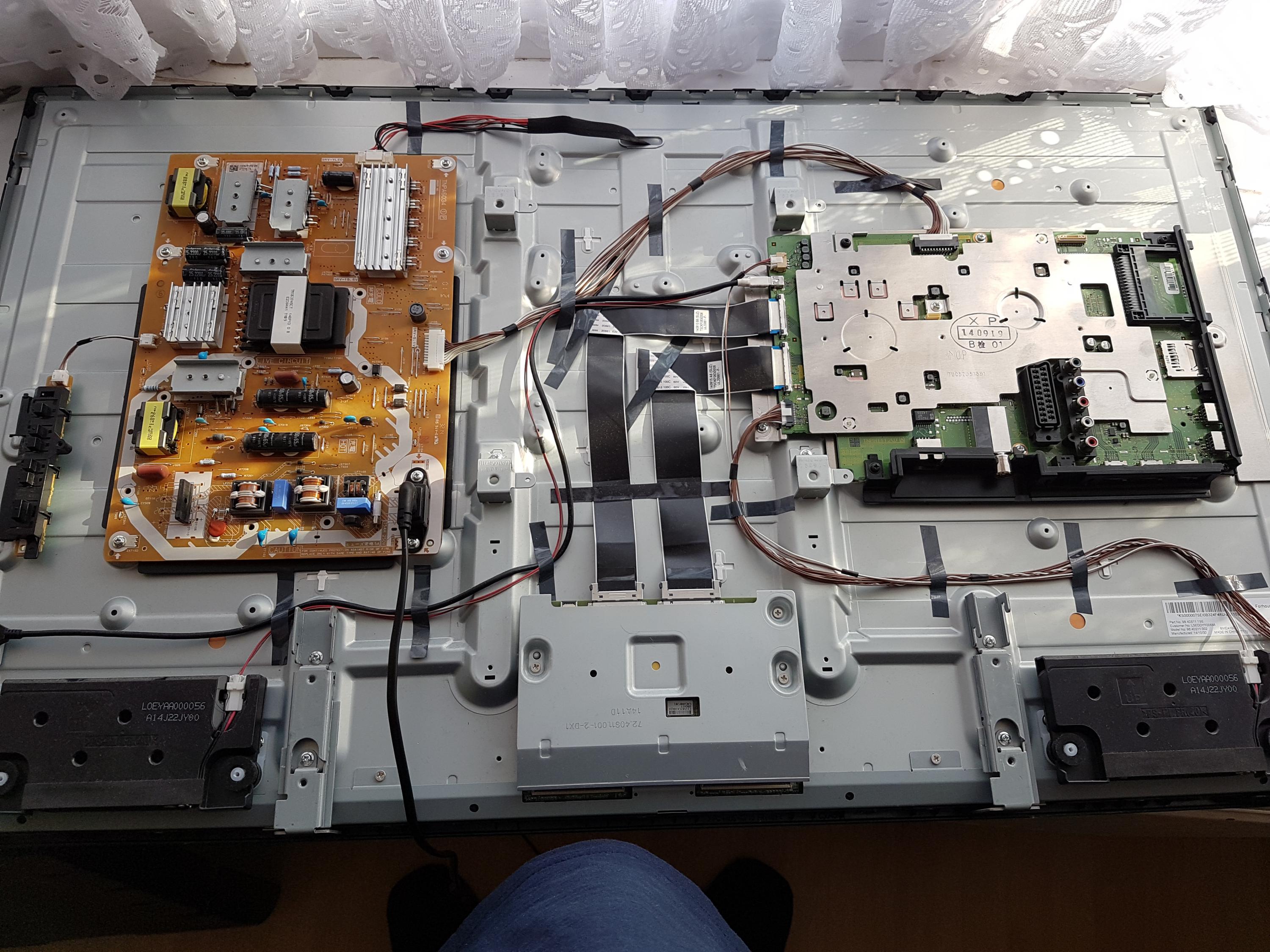

                    Pictures as requested
                      Looking at the pictures, it looks like it has 5 strings of LEDs, they are controlled by 5 Transistors Q7802~7806.
                      What you can do is to put black meter on the chassis, leave the red probe on 'E' of Q7802 then turn on the TV and record the reading, then turn off the TV then move the Red probe to the 'C' of Q7802, turn the TV on and record the reading, do the same for Q7803~7806. If we have one or more open, short LEDs, or open connections in one or more of those 5 LED string the Voltage readings will help us verify.
                      BTW, the filter cap for the boost converter is only rated at 100uf 100V so 50V reading may be correct.
                                Also what panel is this ?
                                • sordids999
                                  • May 2013
                                  • 2152
                                  • uk
                                  thats all i cant find in the picture if you scroll up m8
                                  • ReeceyBurger123
                                    Never Give Up !
                                    • May 2014
                                    • 7325
                                    • Britain
                                    Ahh its one of those crap ones, quite sure they are Auo Lcd screens with some cheap backlighting.
