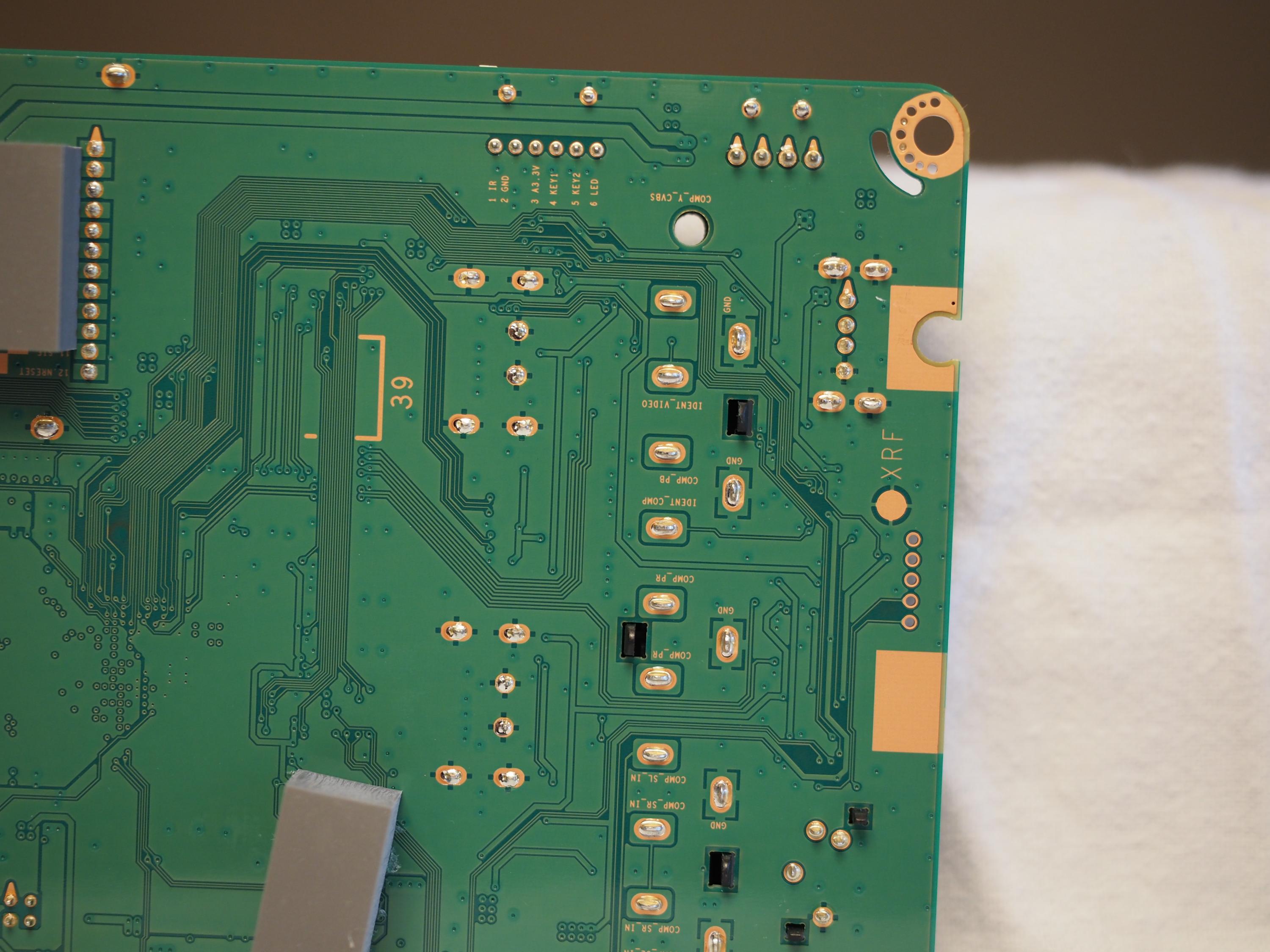

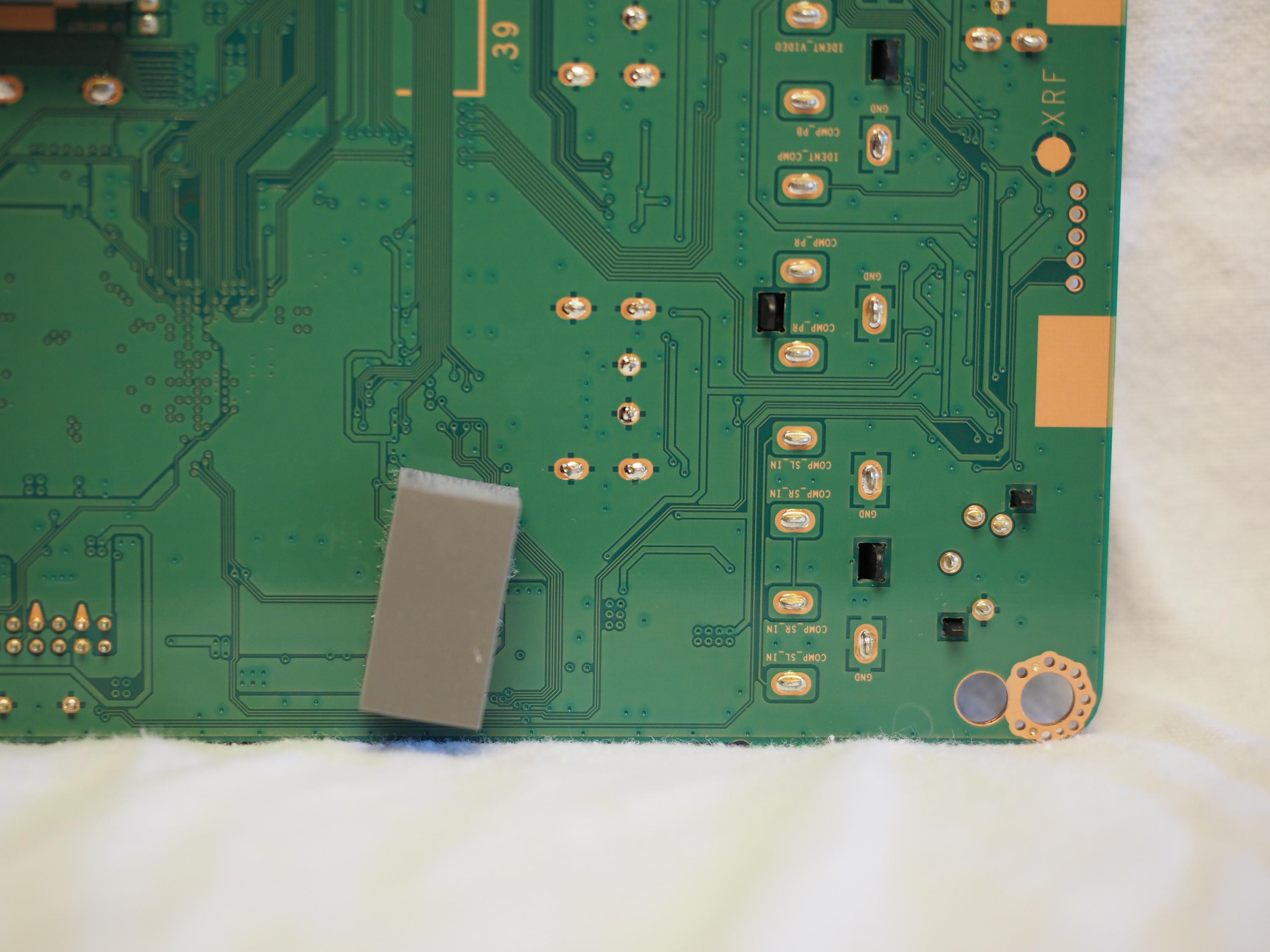

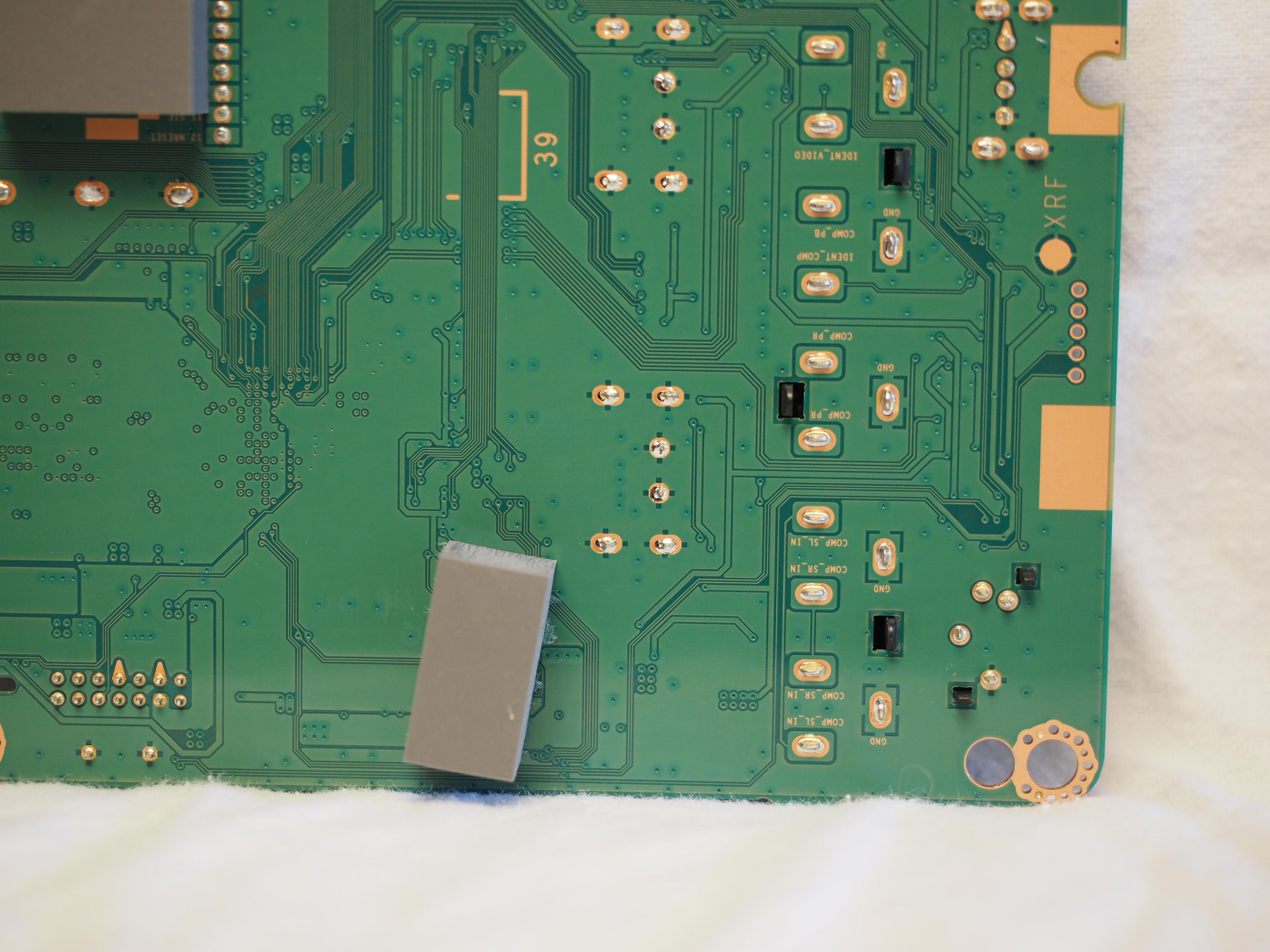

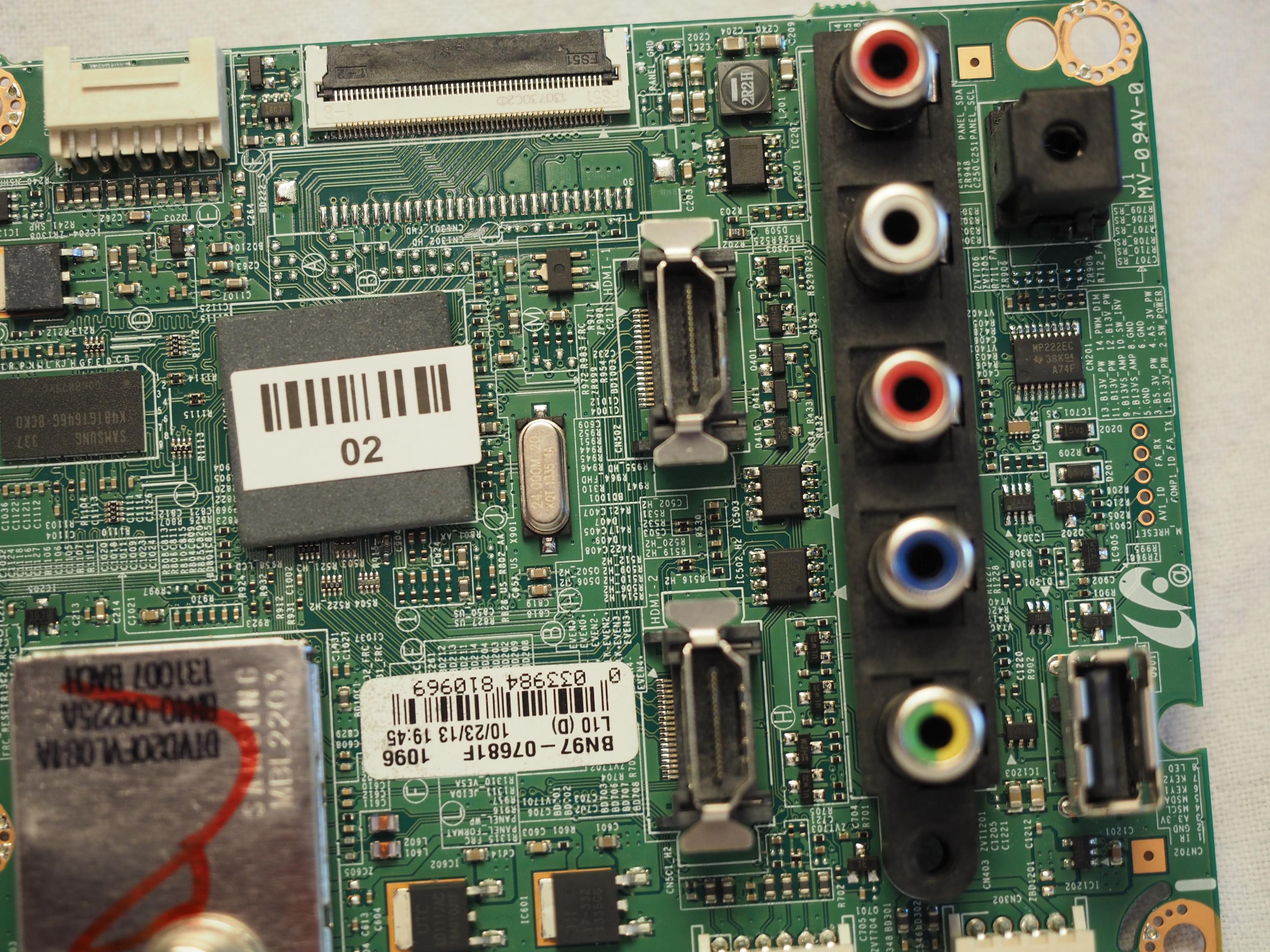

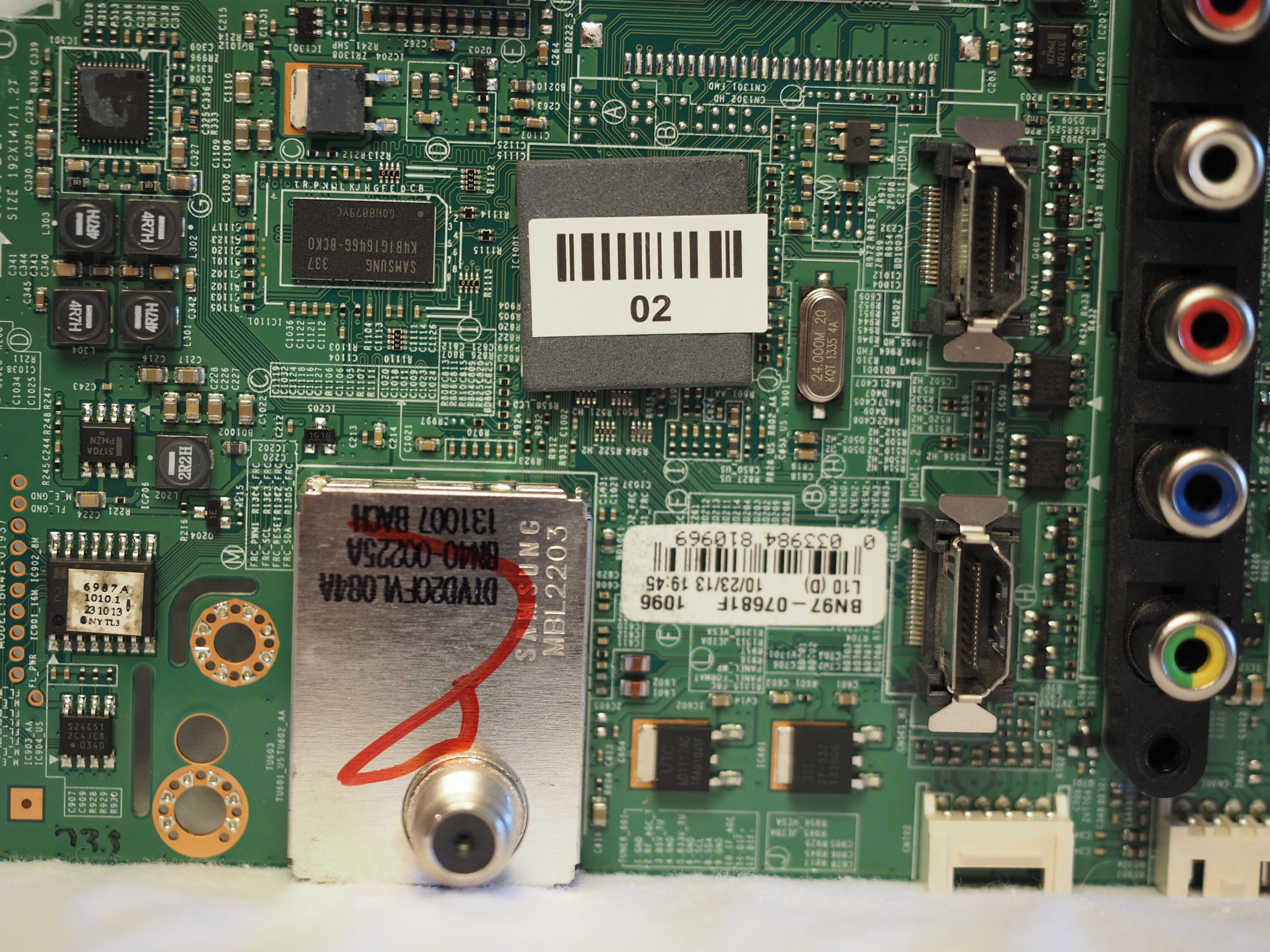

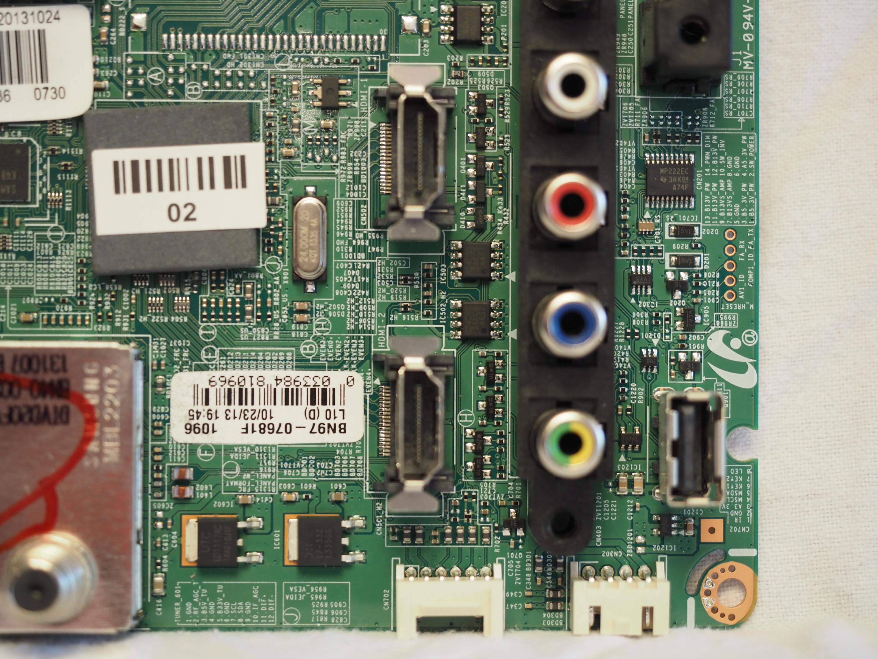

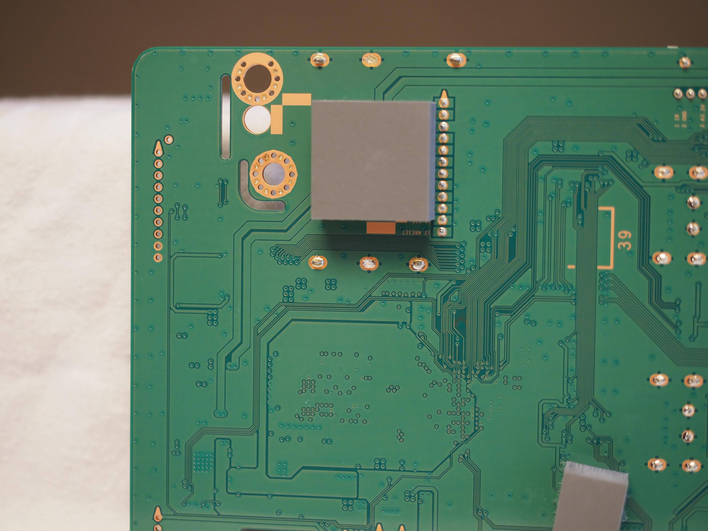

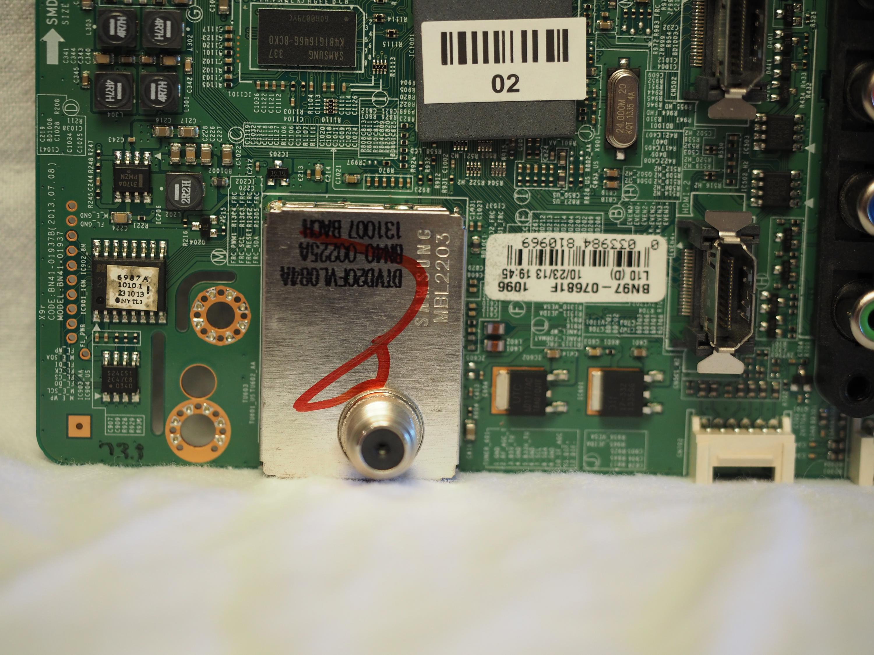

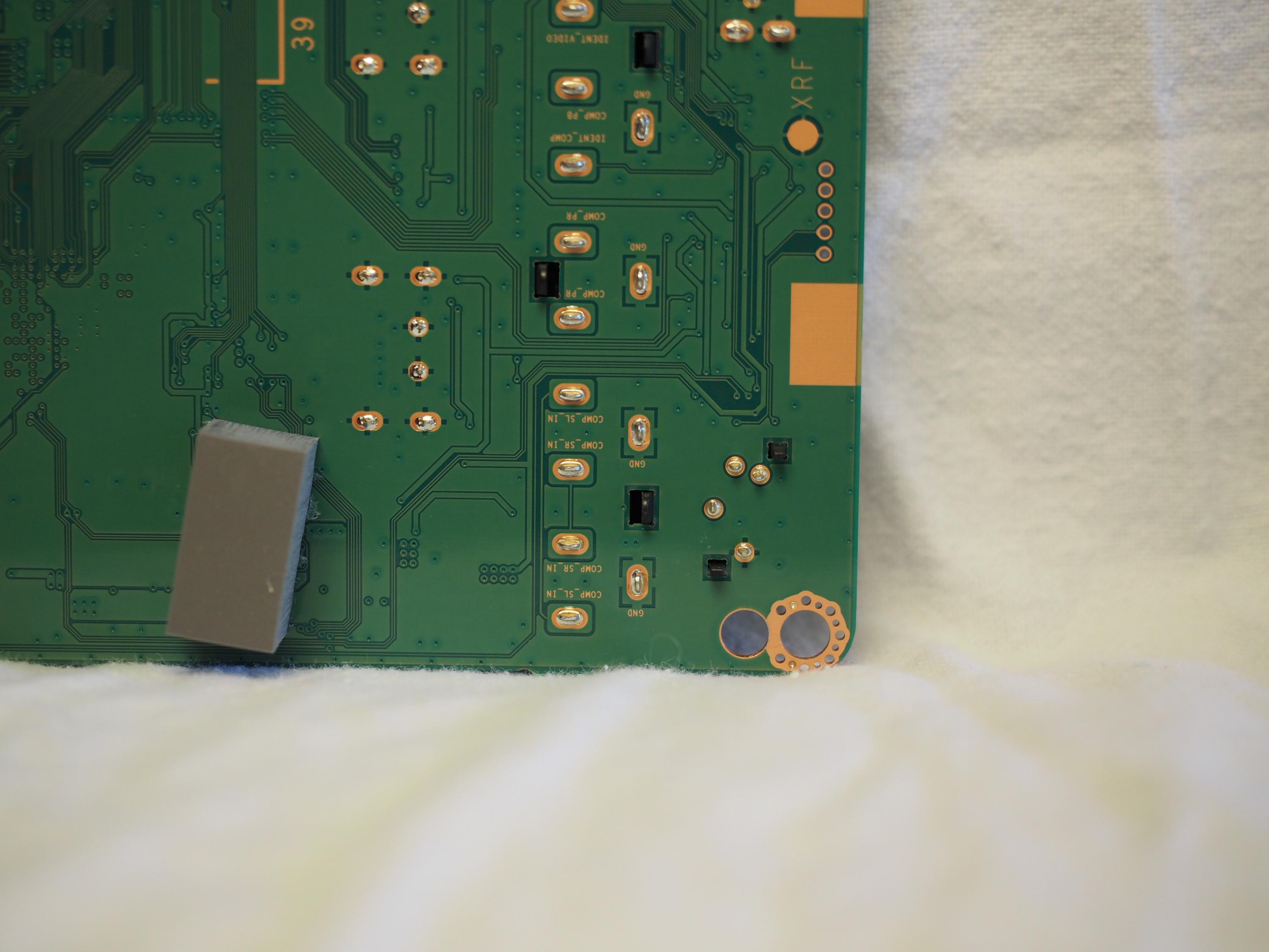

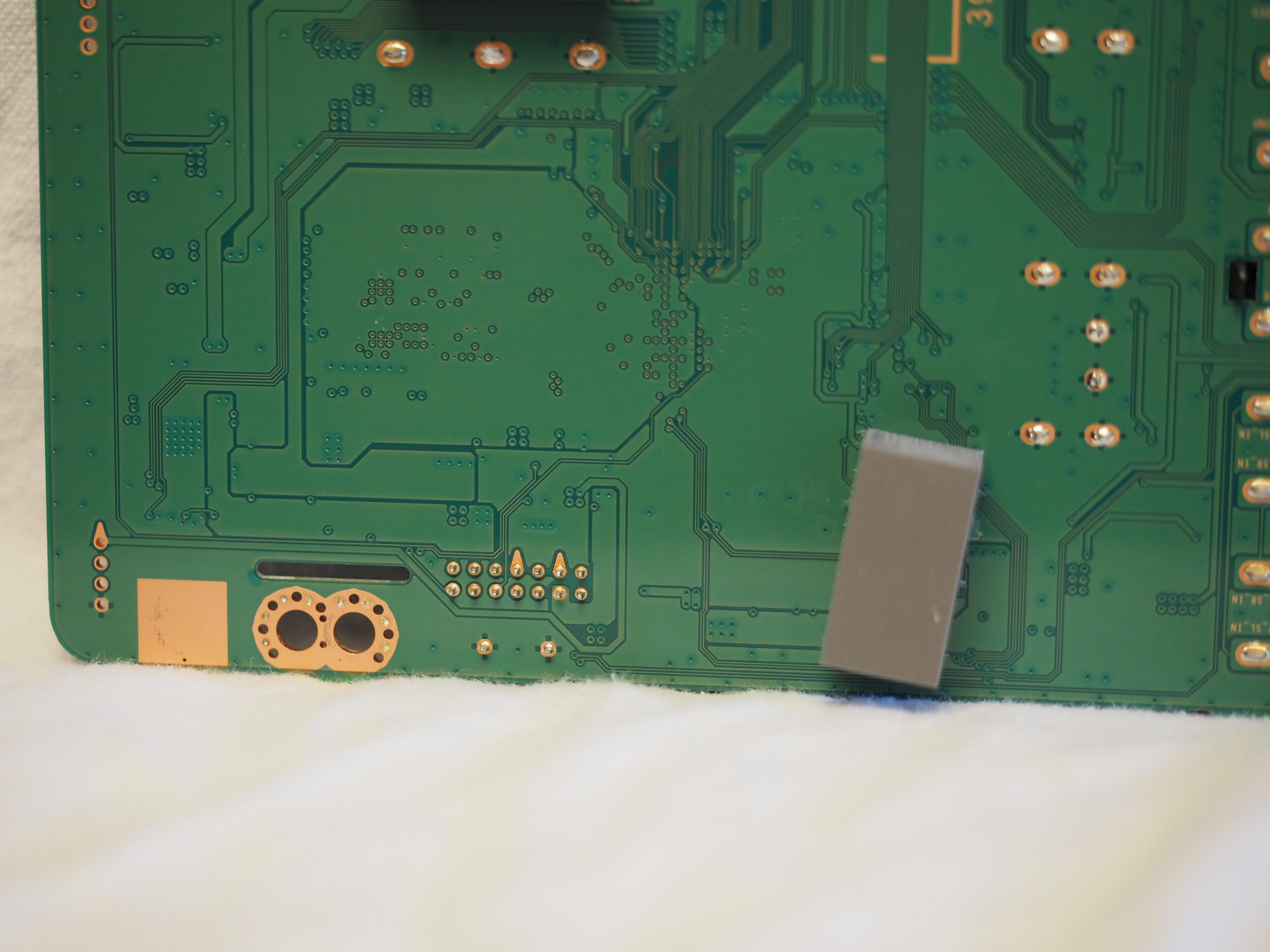

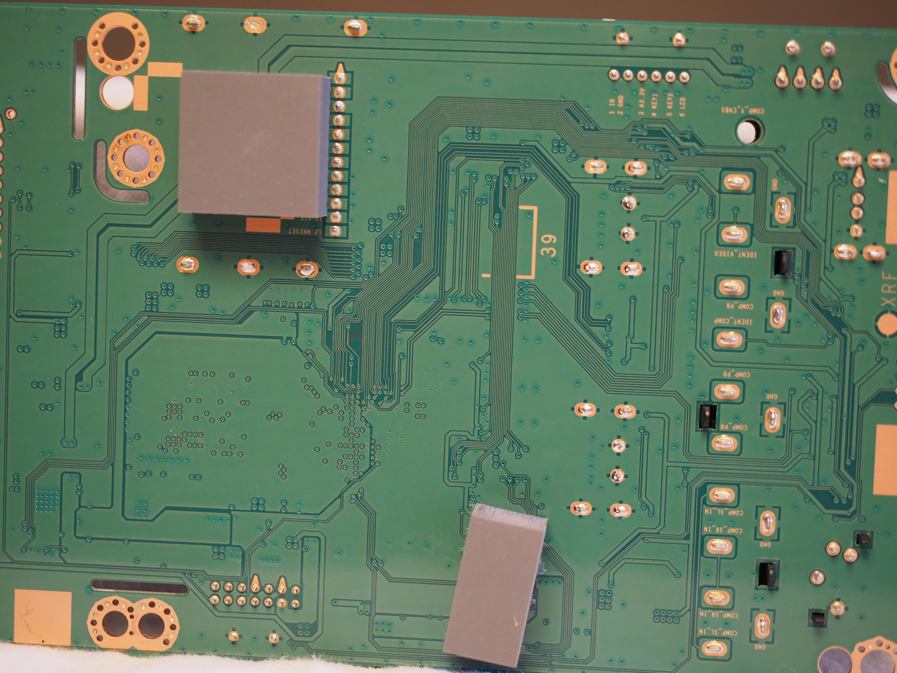

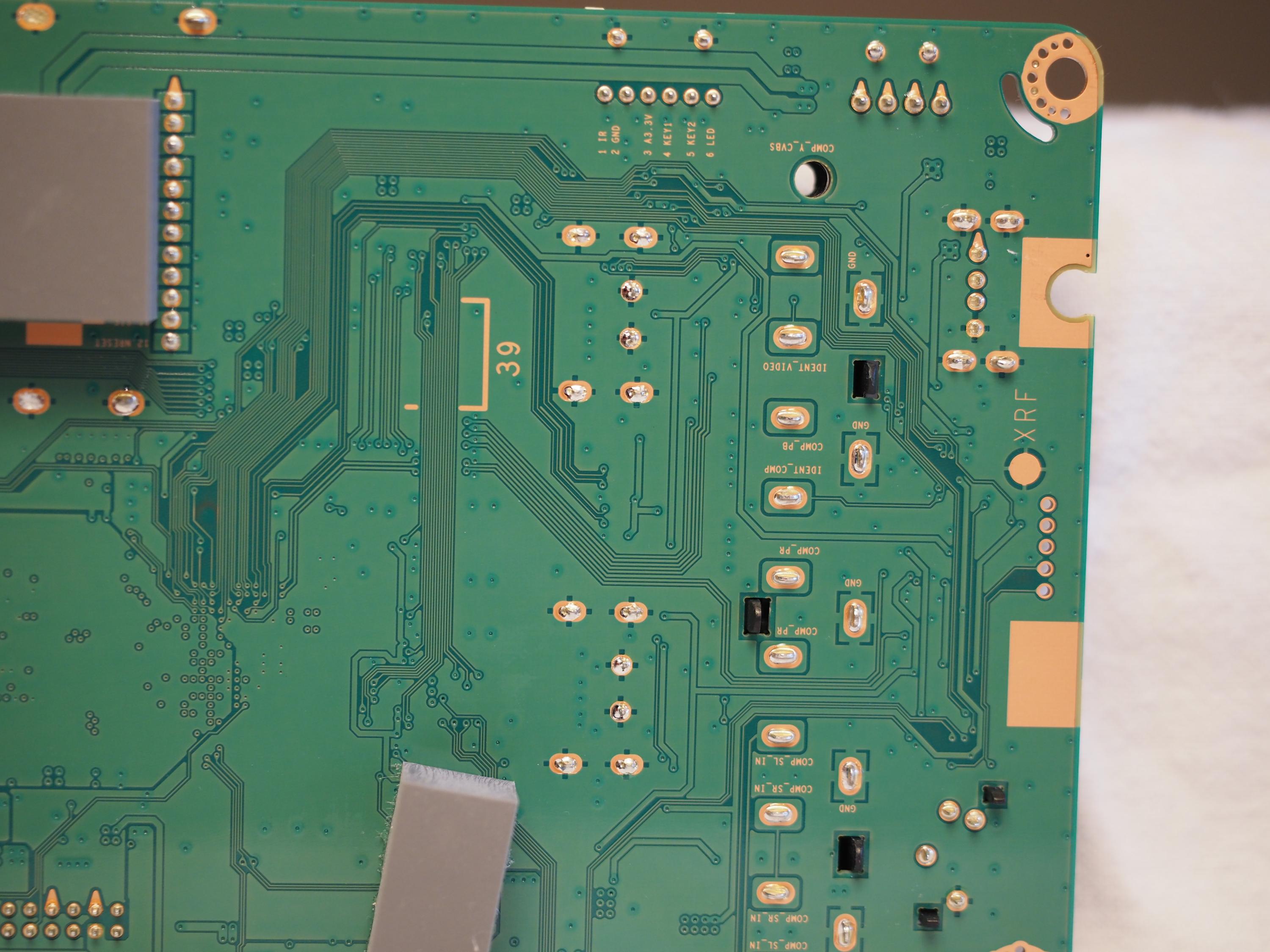

                          • Jp06
                            • May 2016
                            • 127
                            • Usa
                            #53
                            Re: Samsung un65fh6001 has no standby light and no power please help
                            Hi guys here are some pictures .. i hope these are clear enough. I can't find anything wrong.
                            • Jp06
                              • May 2016
                              • 127
                              • Usa
                              #54
                              more pictures. if ya need a close up of anything more specific please let me know
                              • Jp06
                                • May 2016
                                • 127
                                • Usa

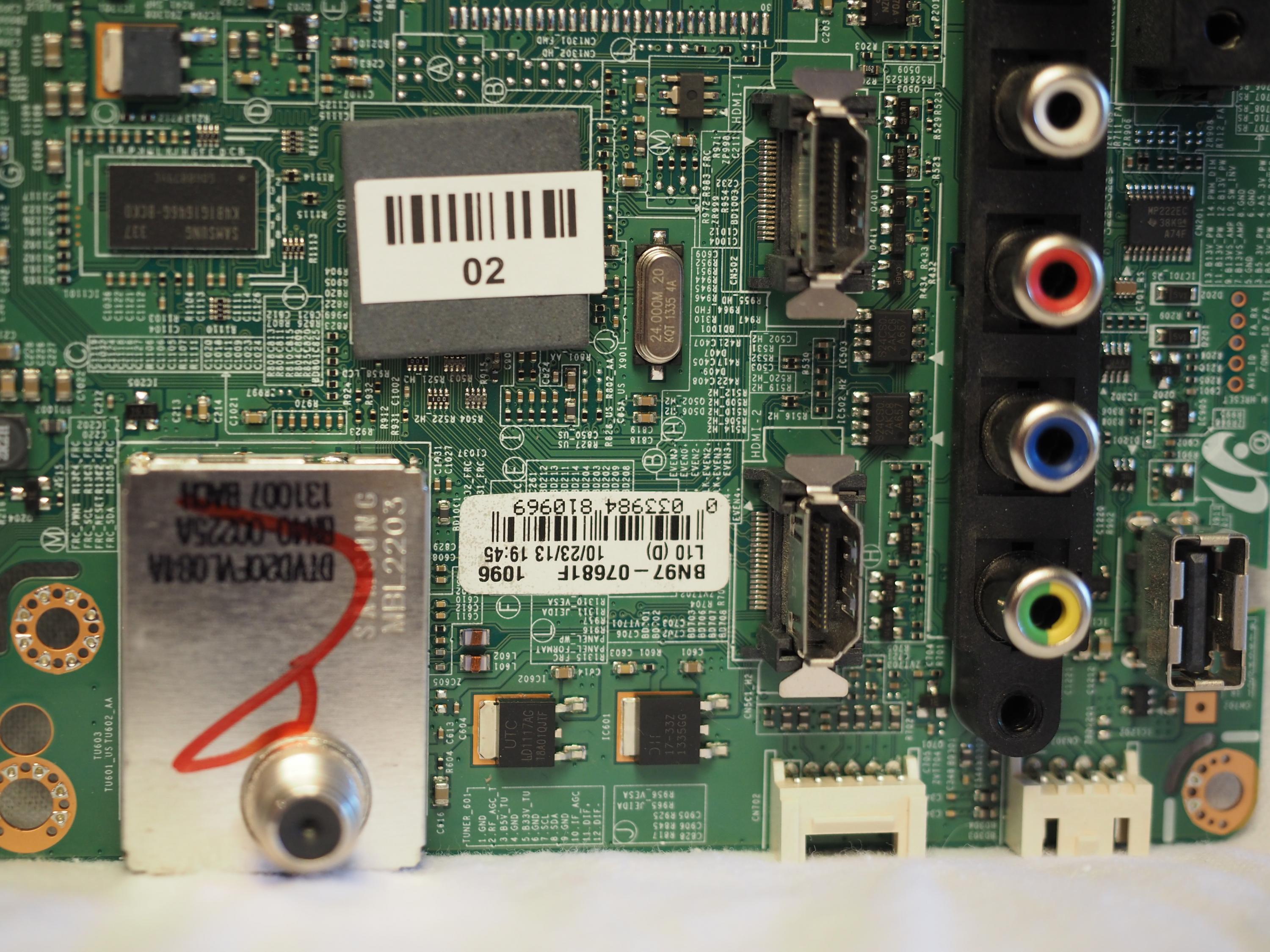

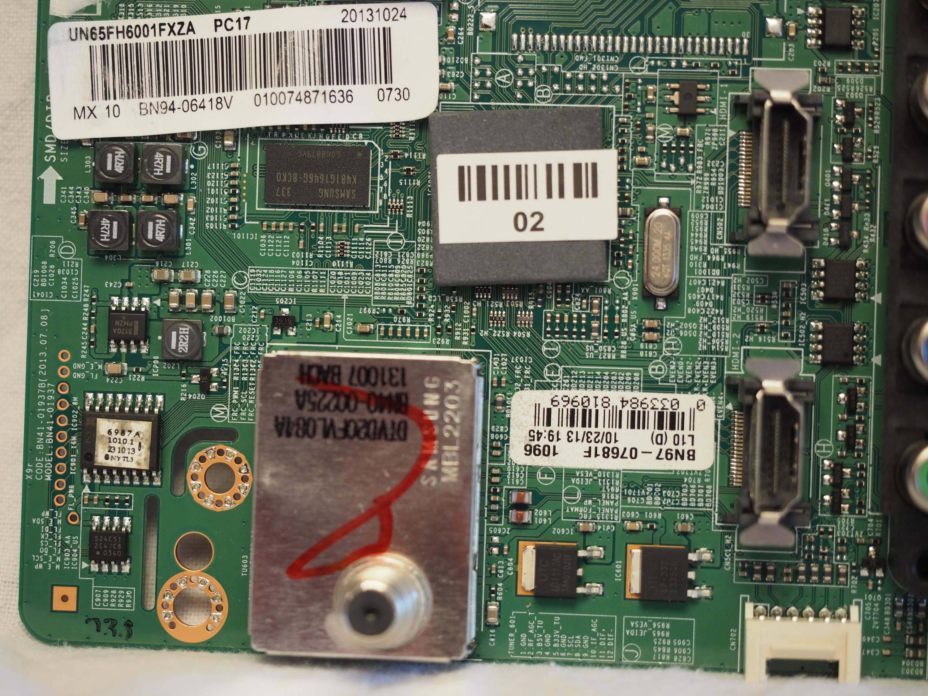

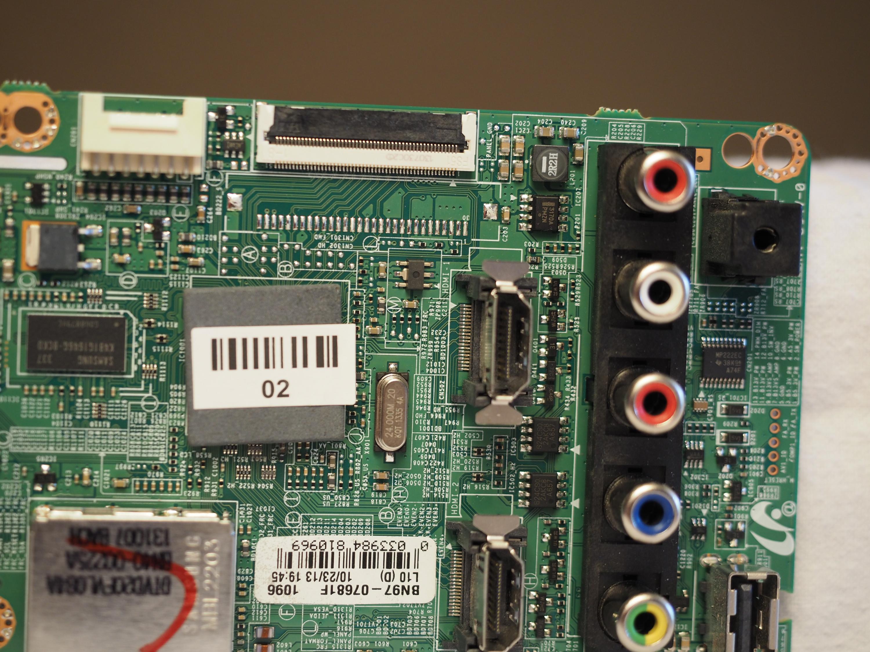

                                #55
                                last set of pics
                                • Jp06
                                  • May 2016
                                  • 127
                                  • Usa
                                  #56
                                  Dick_barton in not sure how to go about to check that i don't have any resistor on hand.
                                  • dick_barton
                                    • Aug 2015
                                    • 6643
                                    • Wales

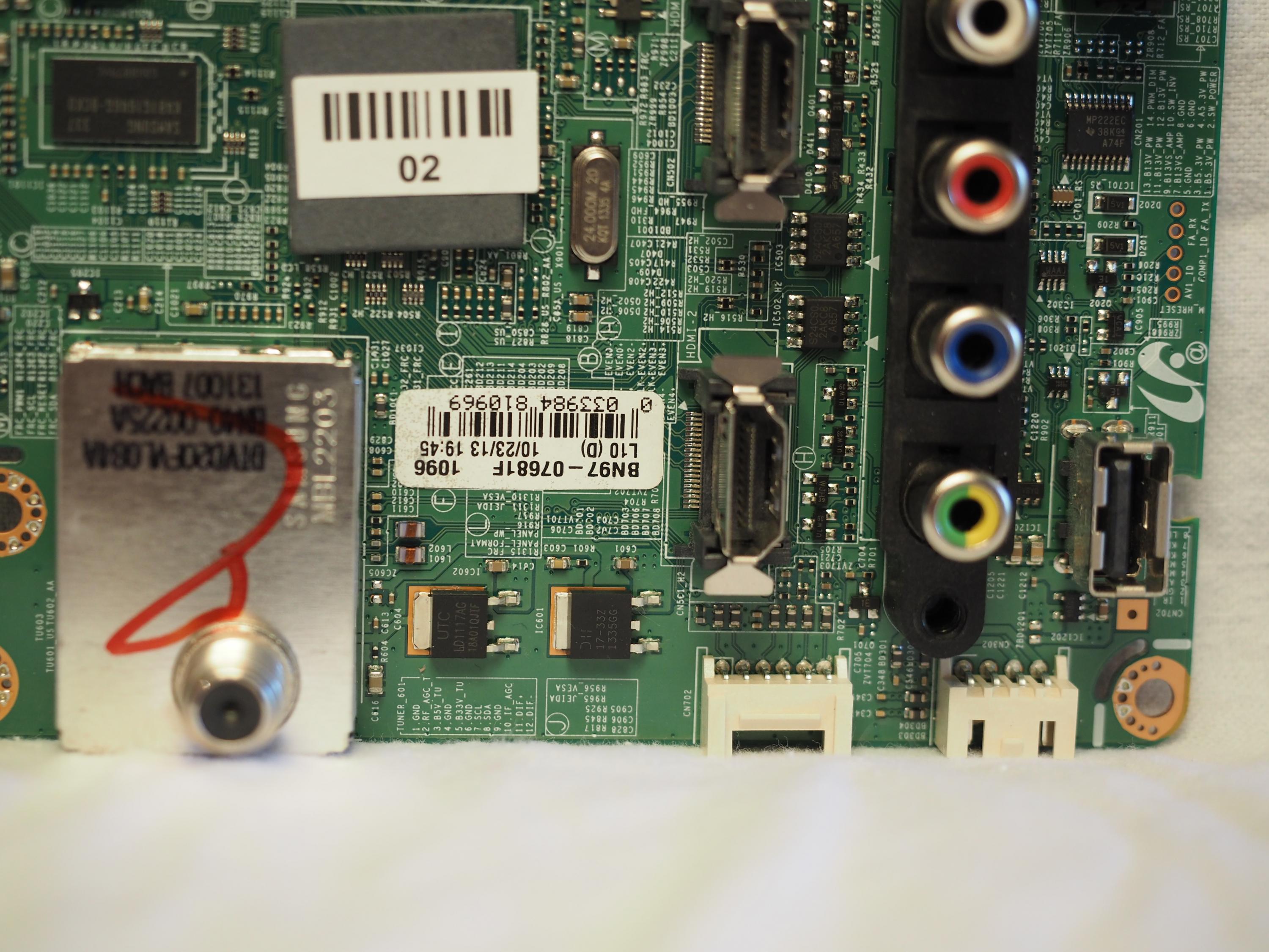

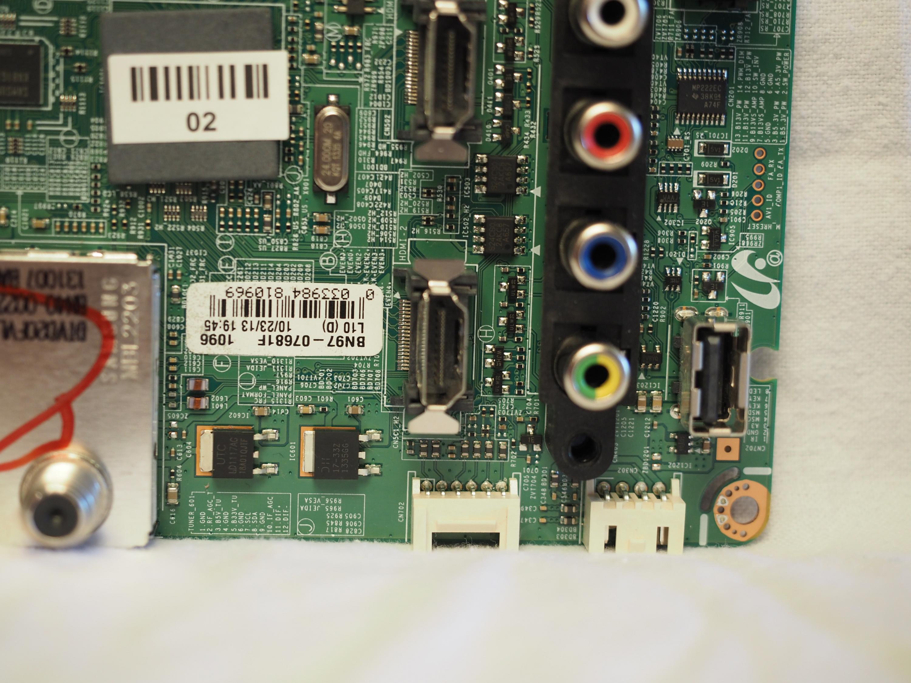

                                    #57
                                    Many thanks for the pictures which now make components readable.
                                    The following picture shows two voltage regulators and it would be worth posting the voltages on them. LD1117AG & 1117-33Z
                                    https://www.badcaps.net/forum/attach...0&d=1463343424
                                    • Jp06
                                      • May 2016
                                      • 127
                                      • Usa
                                      #58
                                      Dick_barton.. those are measured at 5.2v when everything is plug in.
                                      • dick_barton
                                        • Aug 2015
                                        • 6643
                                        • Wales
                                        #59
                                        The 1117-33Z is a 3.3V output regulator and the 1117AG is an adjustable voltage regulator so I would expect all 3 pins on both devices to be giving different voltages?
                                        • Jp06
                                          • May 2016
                                          • 127
                                          • Usa
                                          #60
                                          Oh i did not realize that there are 3 pins. Those are the measurements with pin 1 and 3. I will do the others in a bit
