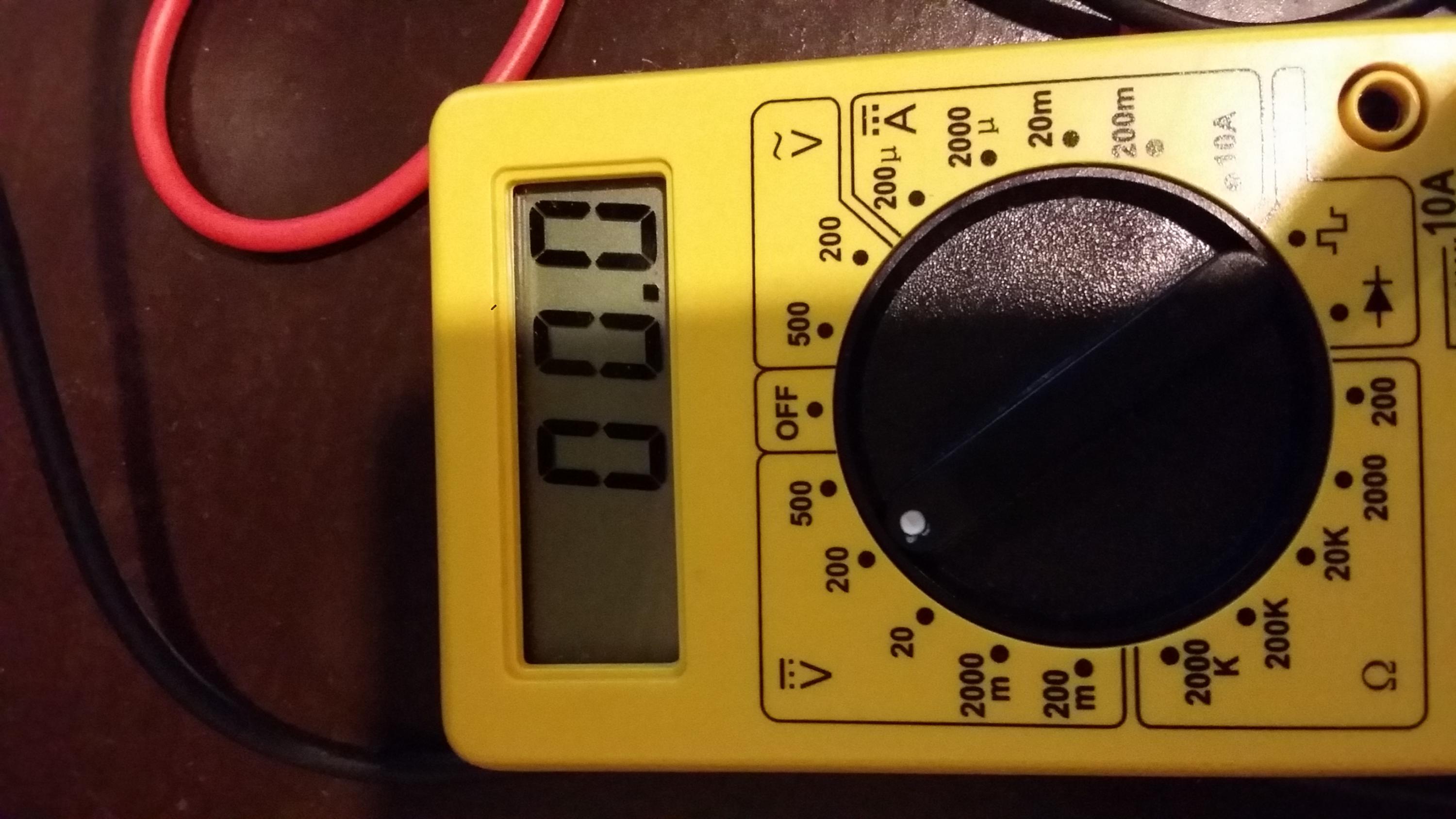

                  Looks like you have the meter set in diode or ohm setting. Put your meter in DC volt and re measure that again.

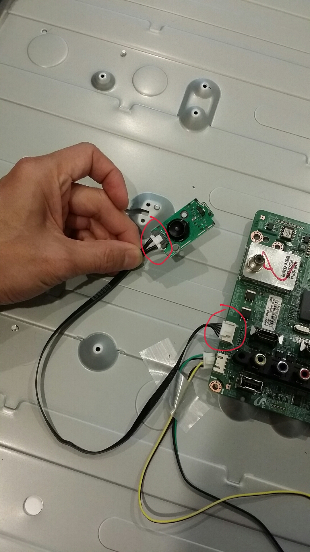

                          Hello everyone this time i'm uploading pictures along with descriptions so ya can tell me what i'm doing wrong.
                          fig1. this is my cheap meter with this setting for the readings.

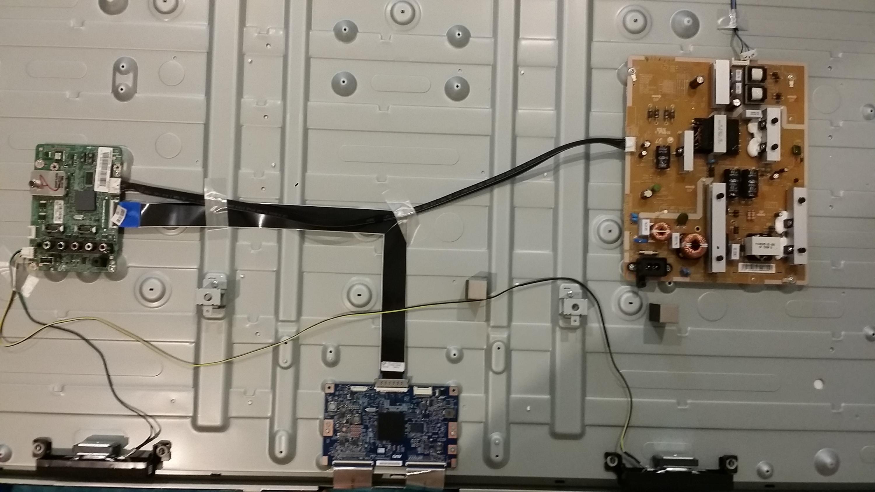

                          fig2. with original boards and everything is connected.
                          fig3. I get these readings. Measurements from the power board side and main board side. Readings are the same. And i use the screw in fig 4 for gnd.
                          fig4. screw for grounding.

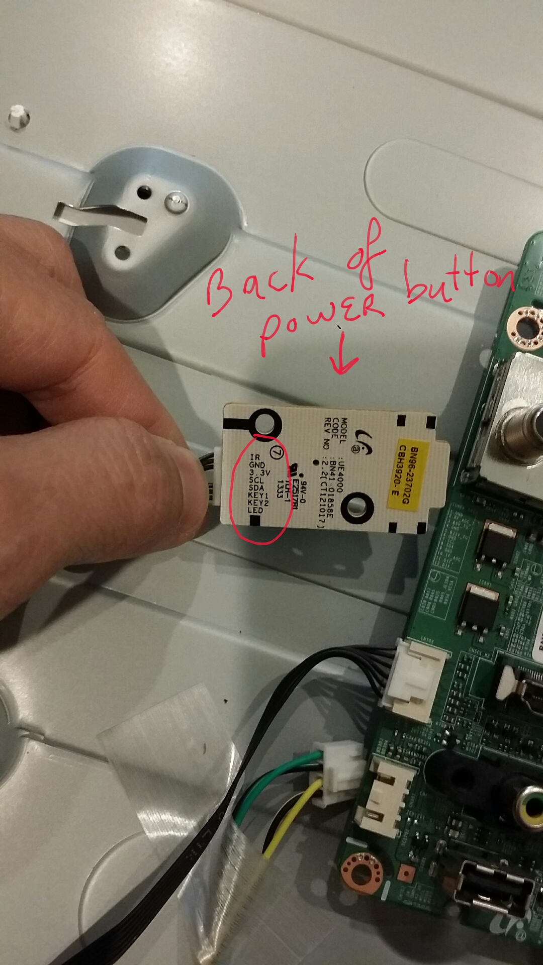

                          fig5. readings from the back of power button mini board. Readings are the same from the main board side and power button board.

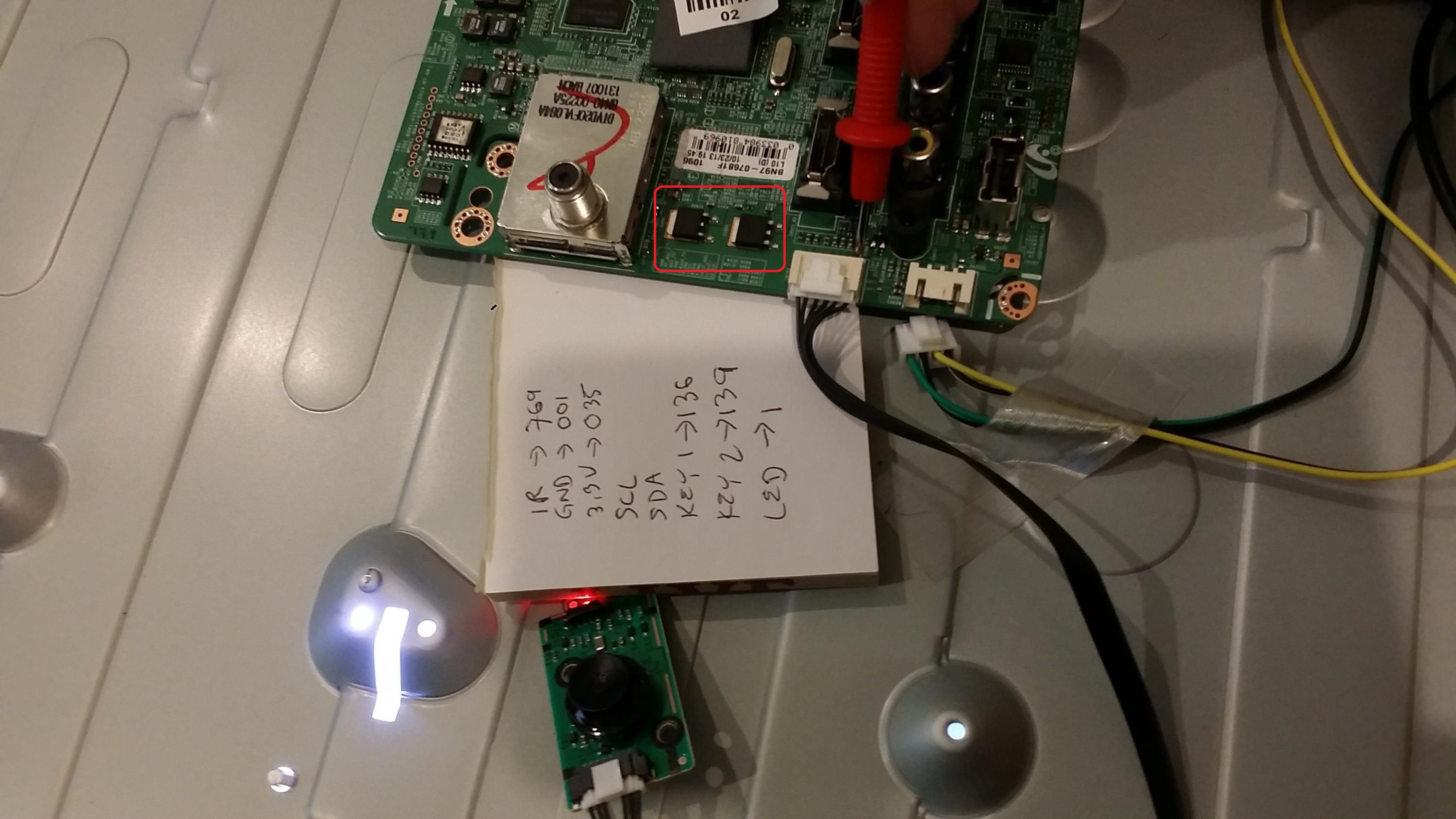

                          Fig6. as suggested by Diah to release the ribbon cable from tcon side which go to the panel. In this case there are two.
                          So the readings from this scenario are.. Please refer back to fig3.. everything is the same except for the last two B5V.. readings are now at 5.2 instead of 5.34
                          And reading from Fig 5 is also the same.
                          BTW, when i release these two ribbons (circled in red) the backlight did not come on. It would only come on when if i disconnect the tcon from the main board.
                          Then i replaced the original main board with the one i got from ebay. I got readings of zeros for fig3 with the two ribbons connected and disconnected. But I got this from the power button mini board..
                          fig7. the IR reading fluctuate between .4 .5 and .6 same with 3.3V and key1 and key2 and LED is zero.
                          I hope i've done the measurements correctly this time and that everyone can follow me. Thanks ahead for the all the helps guys!

                            1- yours ebay boards when you put it the LED of stand by go Red. did you try to switch the TV with remote control... if you did and nothings happen then this boards don't match this set or defect
                            2- yours original main boards had defect or bad Soldering
                            i suggest you to put every things back as original ( dont forget the back light sockets ) as it show in photo open. and use when TV off use hot air gun to heat the big chips on the main boards
                            when you turn on the TV put signal at it you may hear sound .. and give attention on the screen to watch any sign of picture or light.

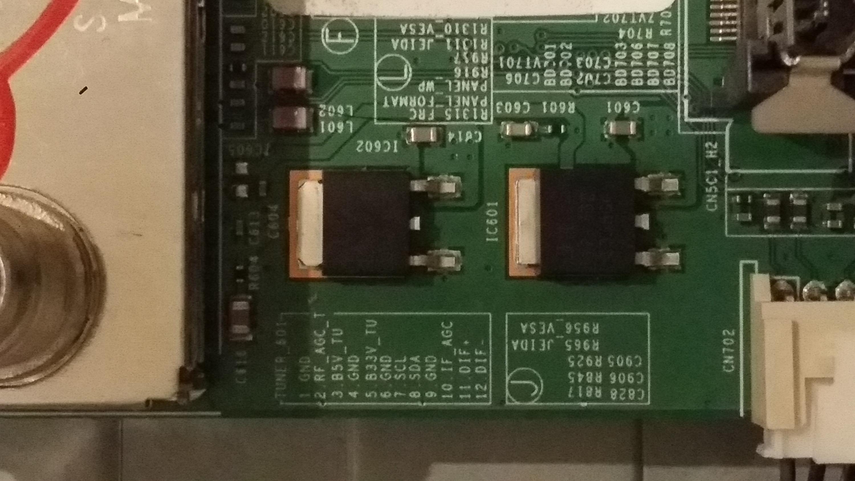

                                With the original main board and power supply in place it looks like the 3.3V is missing and it would be worth checking the voltage regulators on the main board. The 3.3V probably supplies other components on the board.

                                  Re: Samsung un65fh6001 has no standby light and no power please help
                                  What numbers are on these components.

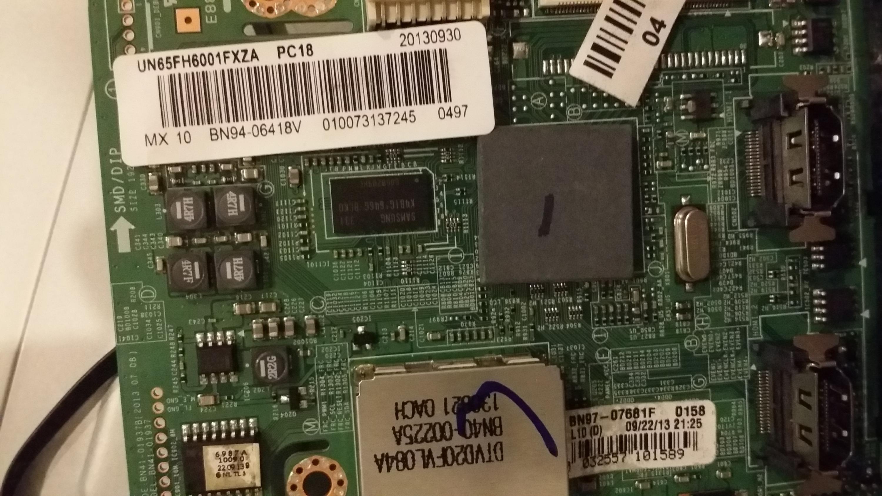

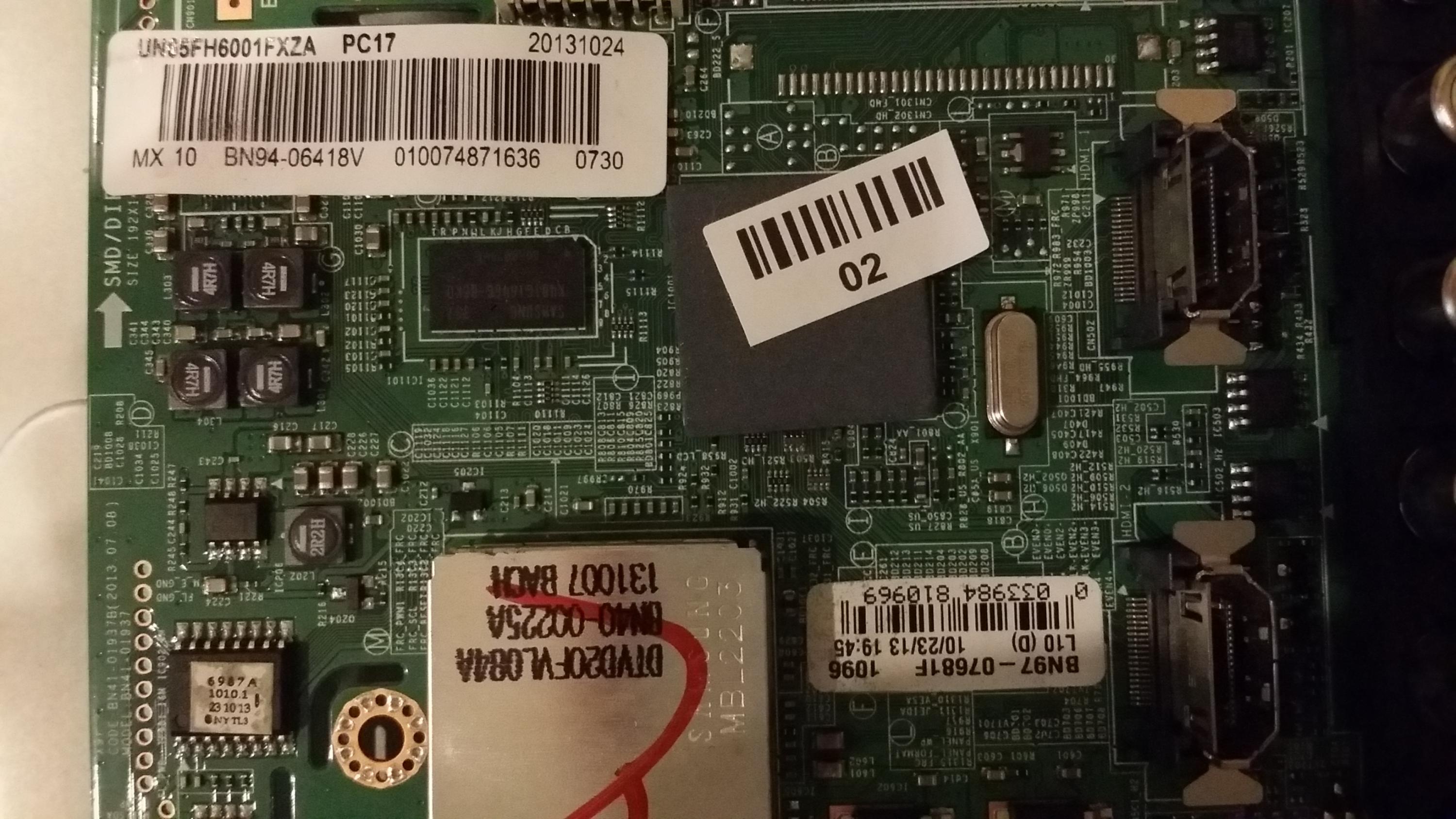

                                    Diah in all scenarios the LED light does not turn on. I have another samsung tv at home and tried to use that remote and nothing happen. I will try the hot air gun method later. I will observe closely to see if i can find and defect on the main board.
                                    the two fig. show the number on the main board.. they are compatible correct? I believe the board from ebay is bad.

                                    Dick-barton.. please show me how would i proceed to check the voltage regulators. Fig.8 shows the numbers that you asked for. C604 and IC601
