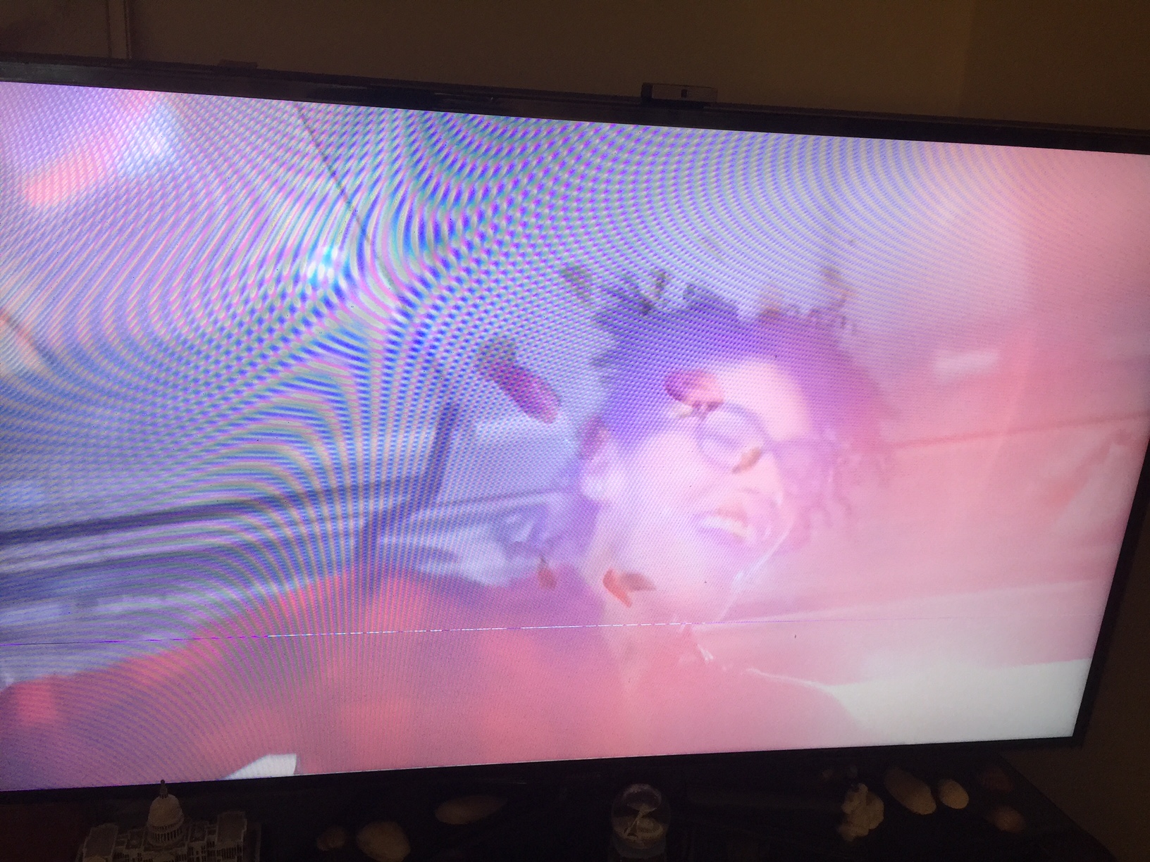

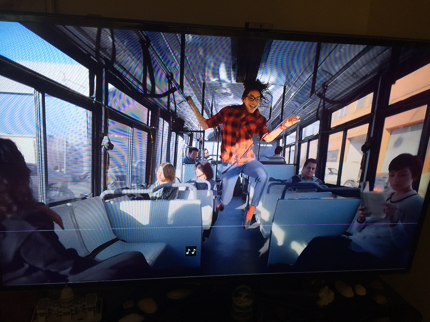

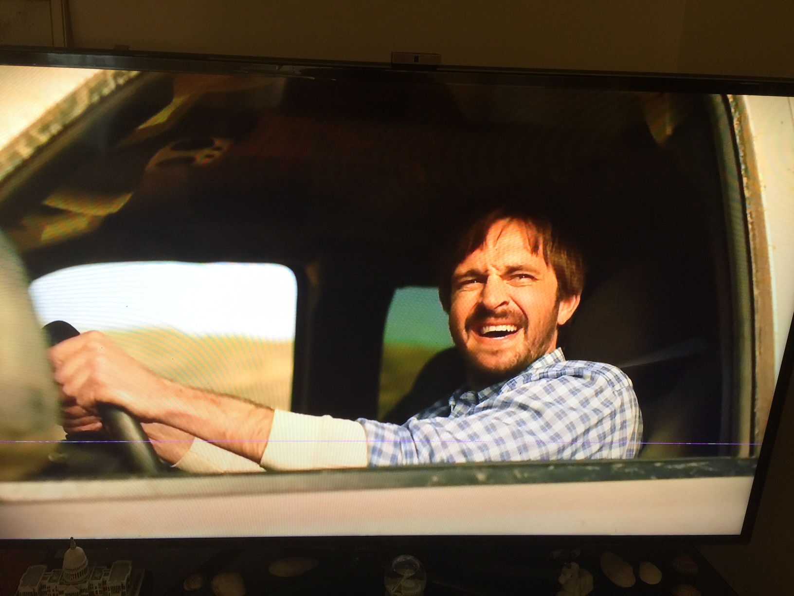

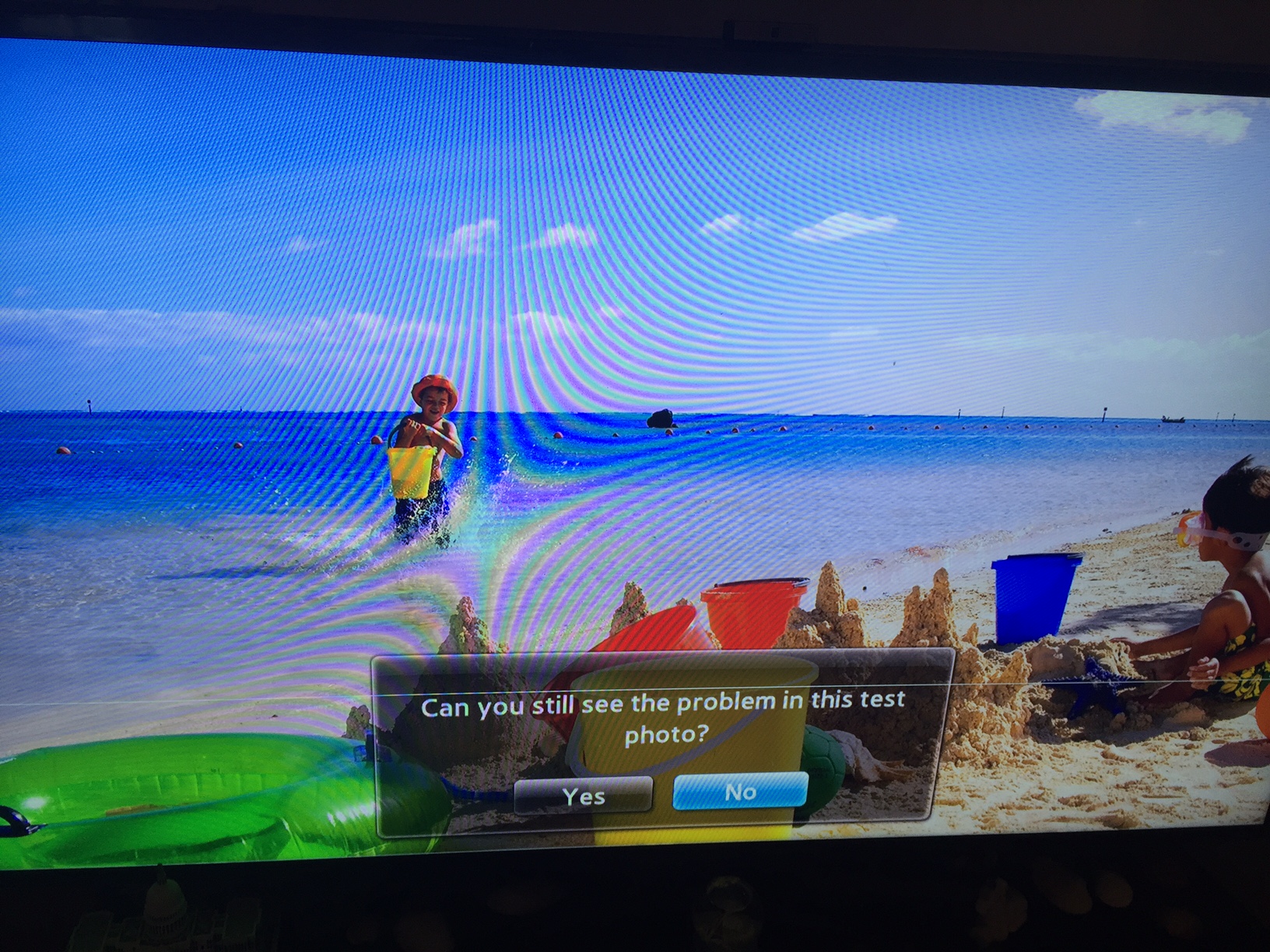

    Samsung LED UN55ES6550 horizontal lines
    I have two bright lines on my Samsung LED UN55ES6550.
    I need to know what component can be defective in this case , power supply , motherboard or i dont know.
    Pictures are attached.
    Can somebody help ?
  • budwich
    • Jul 2015
    • 3097
    Re: Samsung LED UN55ES6550 horizontal lines
    :-( it is not repairable. Its probably a tab driver problem which can't be fixed. People have had limited success by applying thermopads / pressure to the tabs to try alleviate the condition which will likely get worse with time.
    • esprimous
      • May 2016
      • 9
      what is a tab drive problem ? do i have to replace any internal component ?
        It is IC mounted on the flexible circuit board.
