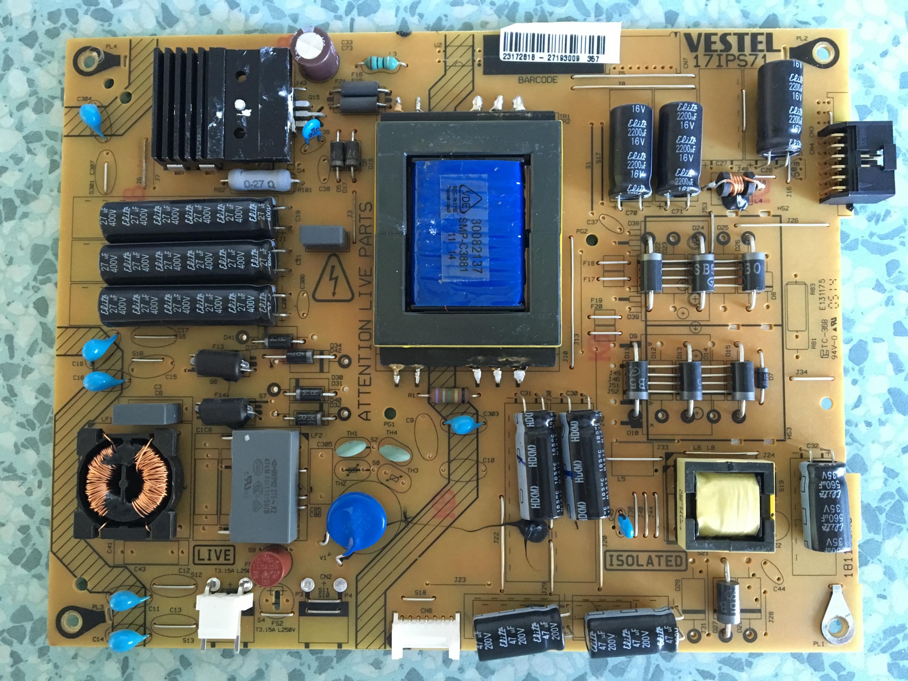

    Dead Vestel 17IPS71 power board
    Help please working on a Busy tv I have had give which I believe may have suffered a power surge
    Power board seems completely dead no standby light no output voltages that i can find
    Input fuse FS1 on board is ok
    Anyone any ideas where to start looking now
    I know I can just change the board plenty on ebay but would like to at least try and find out what is wrong with this board
    will take some pics of the board and post them asap

      Re: Dead Vestel 17IPS71 power board
      Have you checked what voltages there are across C19, C20, C21 with the meter set to 600V and measure across the two pins of each capacitor in turn.
        Also check the diodes.

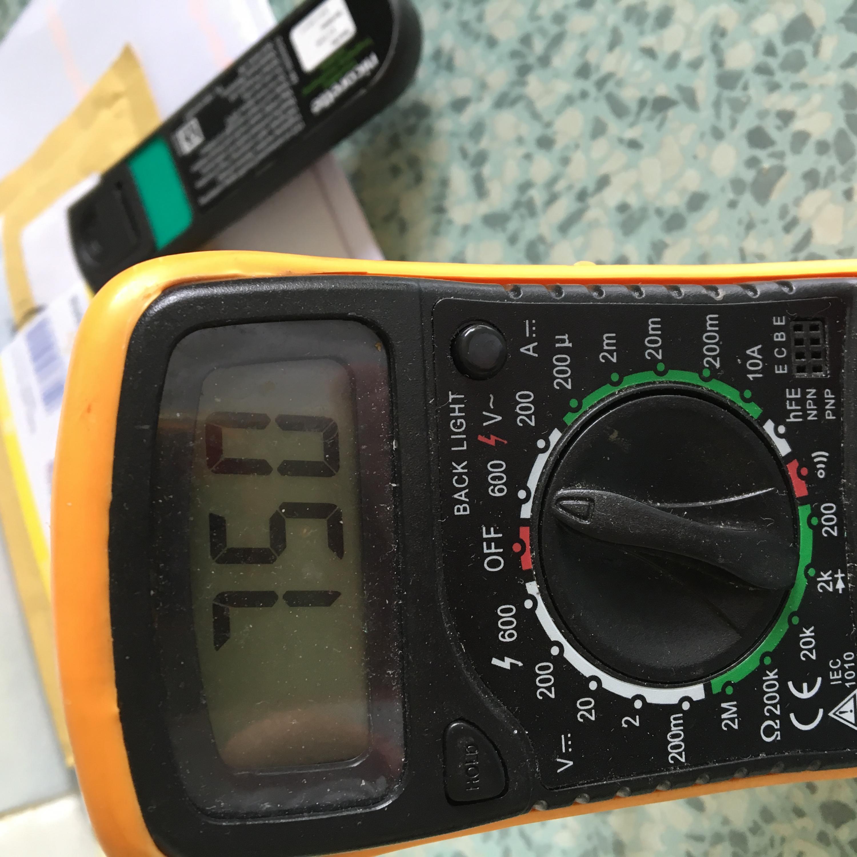

              Originally posted by london-freddie
              748v on each cap C19/20/21
              The readings are incorrect. The capacitors are only rated at 400V DC!!!
              • london-freddie
                • May 2015
                • 472
                just checked again def showing 747/8 v at + & - legs of caps
                • dick_barton
                  • Aug 2015
                  • 6643
                  • Wales
                  There's no way the voltage across the legs of each capaitor in turn is as high as you say without damage. They are only rated at 400V. It should be somewhere around 340V dc
                  • london-freddie
                    • May 2015
                    • 472
                    meter set at 600V AC red probe on +ve leg black probe on -ve leg 747 or 748v on all three caps if that makes any sense
                    • dick_barton
                      • Aug 2015
                      • 6643
                      • Wales
                      DC Voltage measurement please.
                      • london-freddie
                        • May 2015
                        • 472
                        am i doing this right ?
                        • london-freddie
                          • May 2015
                          • 472
                          ah 336V DC
                          • london-freddie
                            • May 2015
                            • 472
                            senior moment i think
                            • dick_barton
                              • Aug 2015
                              • 6643
                              • Wales
                              Thanks. So you have rectified DC so now to find out why you have no DC outputs.

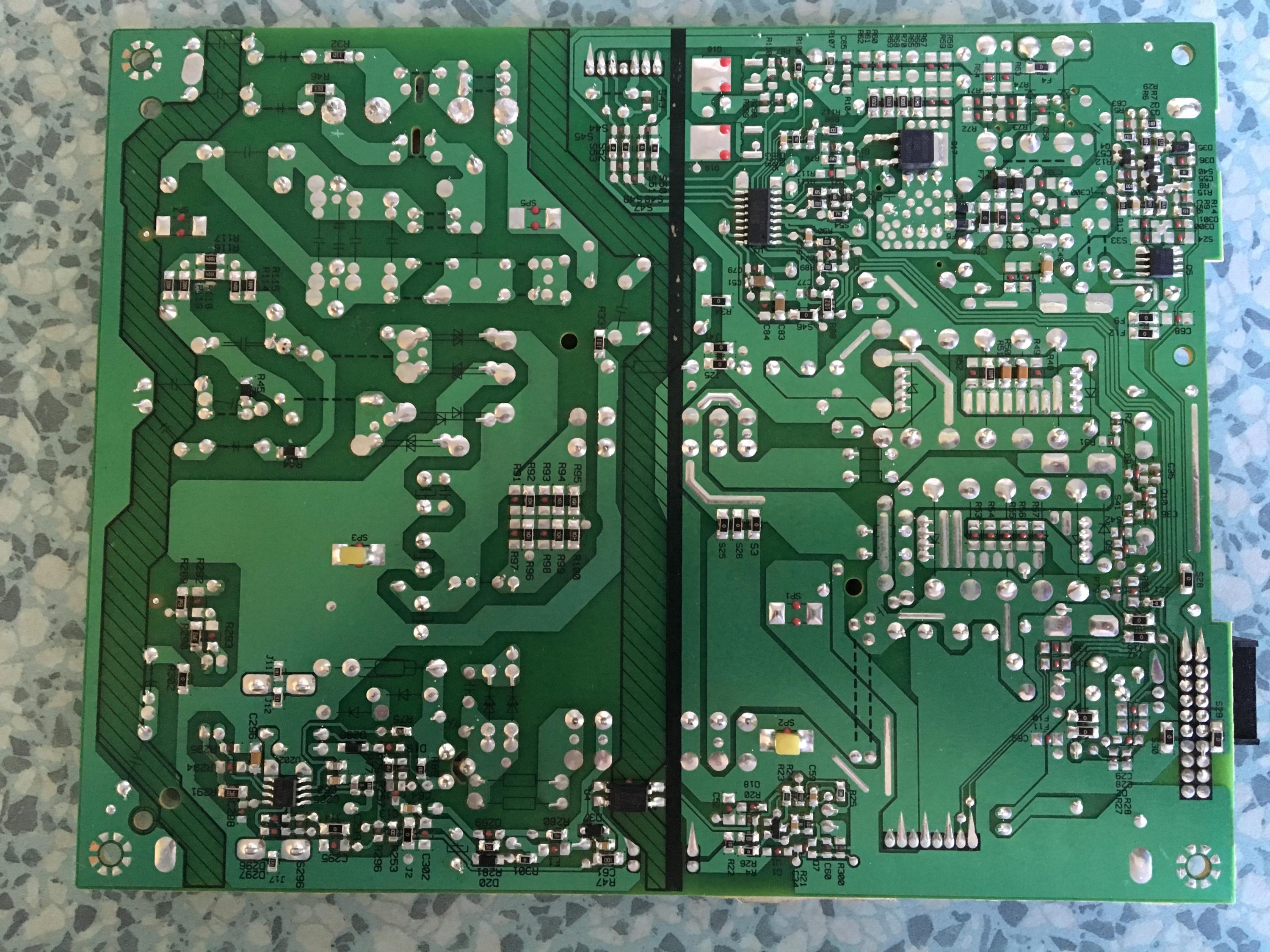

                              Could you measure the dc voltage on CN3-CN4 (black connector) with the mainboard disconnected and see if there is at least a standby voltage?
                              • london-freddie
                                • May 2015
                                • 472
                                no voltages at all at CN3/4 connector
                                • dick_barton
                                  • Aug 2015
                                  • 6643
                                  • Wales
                                  I don't know how close this schematic is but it's time to start checking components.
                                  There are a lot of 0 Ohm resistors that I would check as well.
                                      Checked the output diodes for S/C ?
