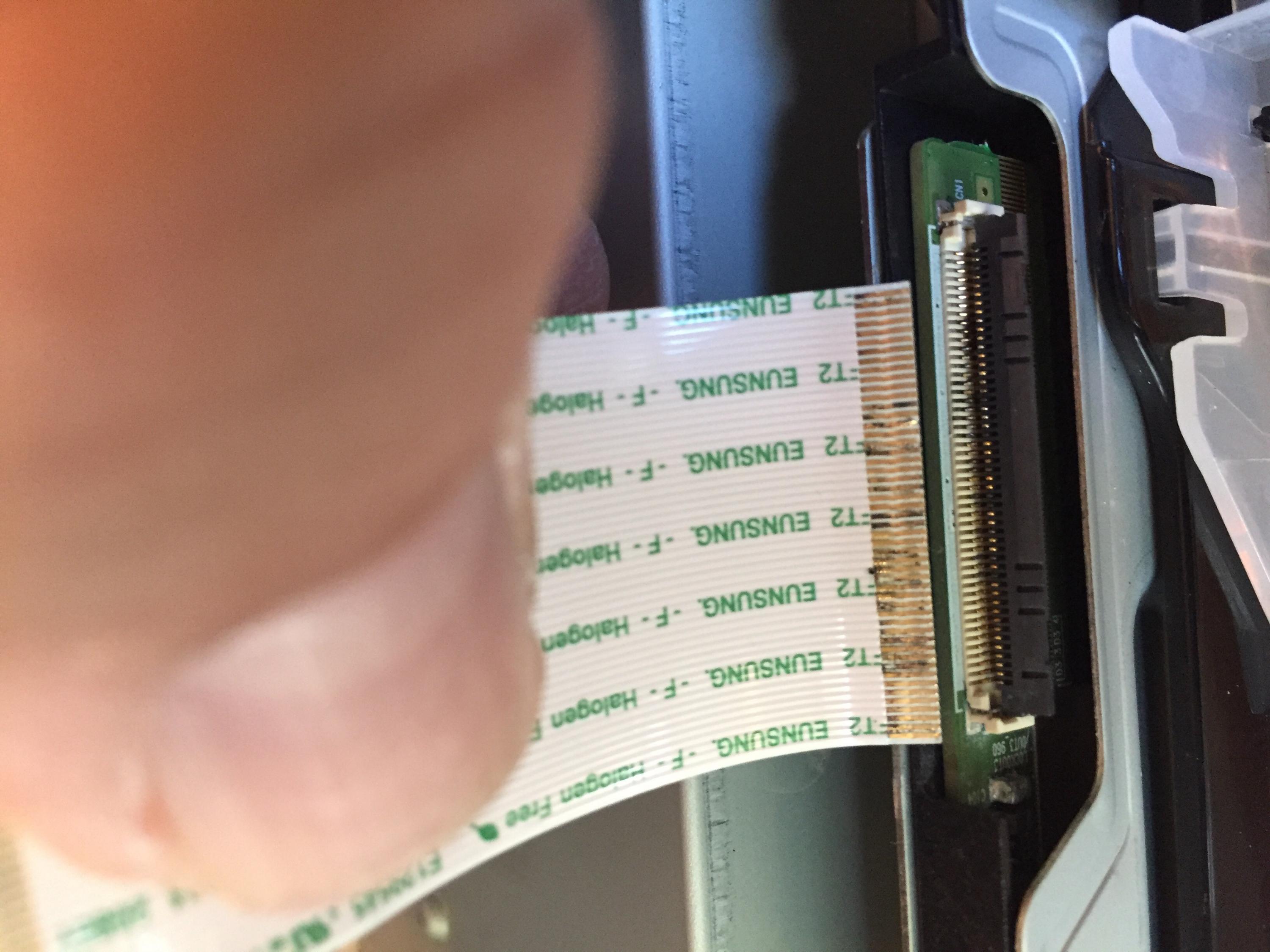

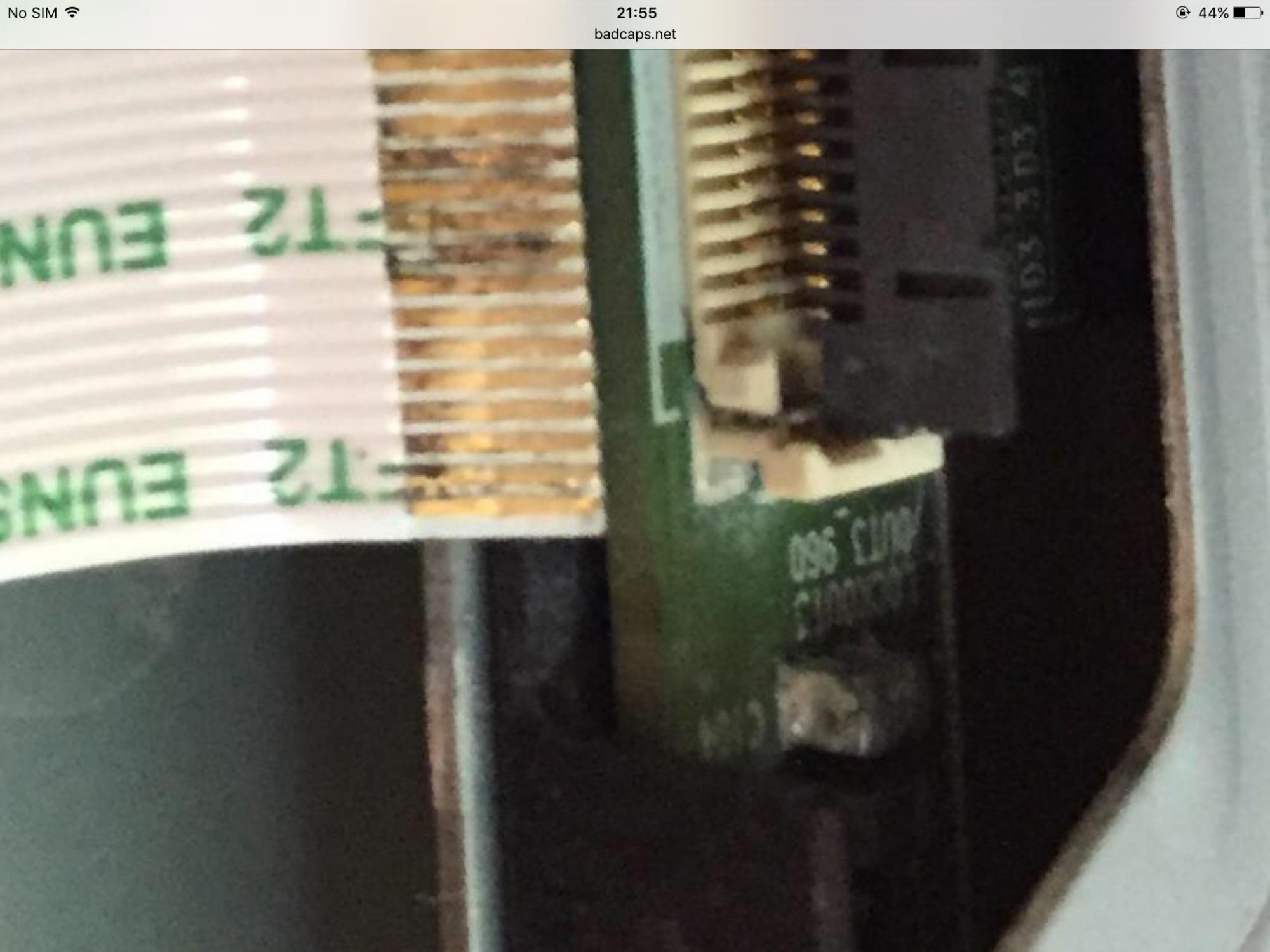

                  Re: Lg 42ln5400 no picture or sound
                  Here is what it looks like. Can it be fixed?
                  I did try a tcon. It was only $8. Shipping included.

                    #29
                    Looks to me like liquid damage, have you took the frame off to see if the tabs have corrosion on them ? Also the cap behind it looks corroded:

                      #30
                      i did say about ribbons ages ago
                      see maybe 2 shorted lines red ring where replace it

                        #31
                        I had checked the ribbon cables but only the end that plugged into the tcon.
                        There was a bit of dust on the other end where the cable goes into the panel.
                        I didn't check those but I do believe it was because the I put might have been set on pc or something because while one of them was on, I pressed the input button on the side and the word "hdmi" came on the screen. I pressed it again and the other options came up.
                        I can't repair that and I did take a good ribbon cable from the other Tvs and tried it. It's the connector and the cap I bet. Lol. For $10 I got 2 working 42" Tvs.
                        I'll take the boards and LEDs out of the other.
                          I did notice the capacitor also.
