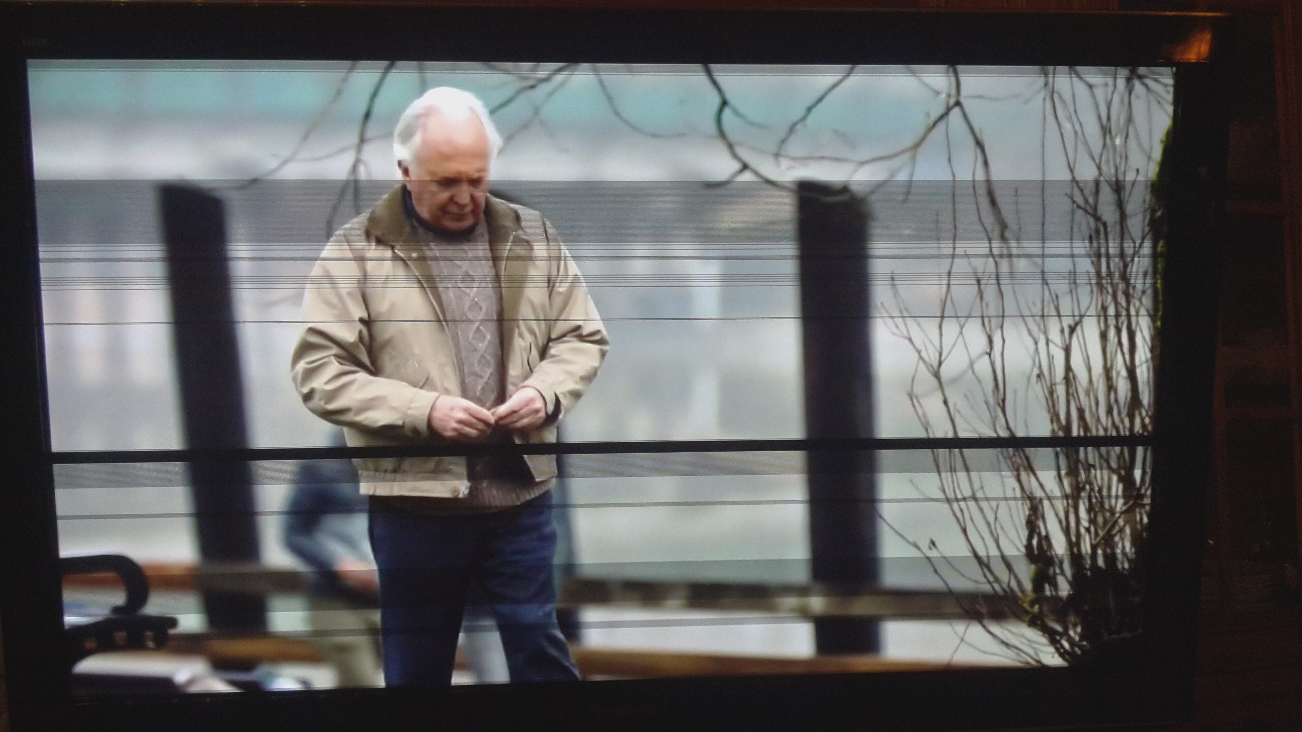

                        TW, Sooo....
                        I sent the SC Board, the SU board, and the SD Board back in to PTS. They found my SD board was fried beyond any repair. SU Board was ok!!!
                        So they fixed the SC Board, and sold me a refurbished SD board.
                        I reinstall them, and did the power up test, and ALL IS GOOD.
                        So I put it all back together, plug it into cable, and I have horizontal lines and bands across the screen. RATS!
                        Am I correct in assuming this is caused by me not properly seating or aligning the ribbon cables to the SU and SD boards?
                        I'm asking because I don't want to disassemble this thing again if the problem is the panel. If that's the case, the kids are going to have to learn to read books or something.
                        Help lm one more time. I think I'm almost there!

                          there's no easy way to describe what to do other than the ribbons are not in straight or all the way.
                          So, only adjust with the TV off. Take the back off, turn it on , look at the lines and they will ine up with the buffer connector that is wrong, take note or get a marker to put a dot on what is wrong.
                          Turn it off, lift the latch, gently pull the ribbon out and with two hands get it really even and straight , insert and you can feel it wedge in.
                          If the latch is really hard to pull down that's usually the first warning it's not right.
                          The other thing is compare to a good one and often you'll see it's crooked.

                              SUCCESS!!! It took some learning, but I figured it out and the set works like new again!!!!
                              The total cost of the repair was about $240 US. And it only took about 5 months to fix.
                              I'm happy!
                              Thanks tw2005. I sincerely appreciate it!!
