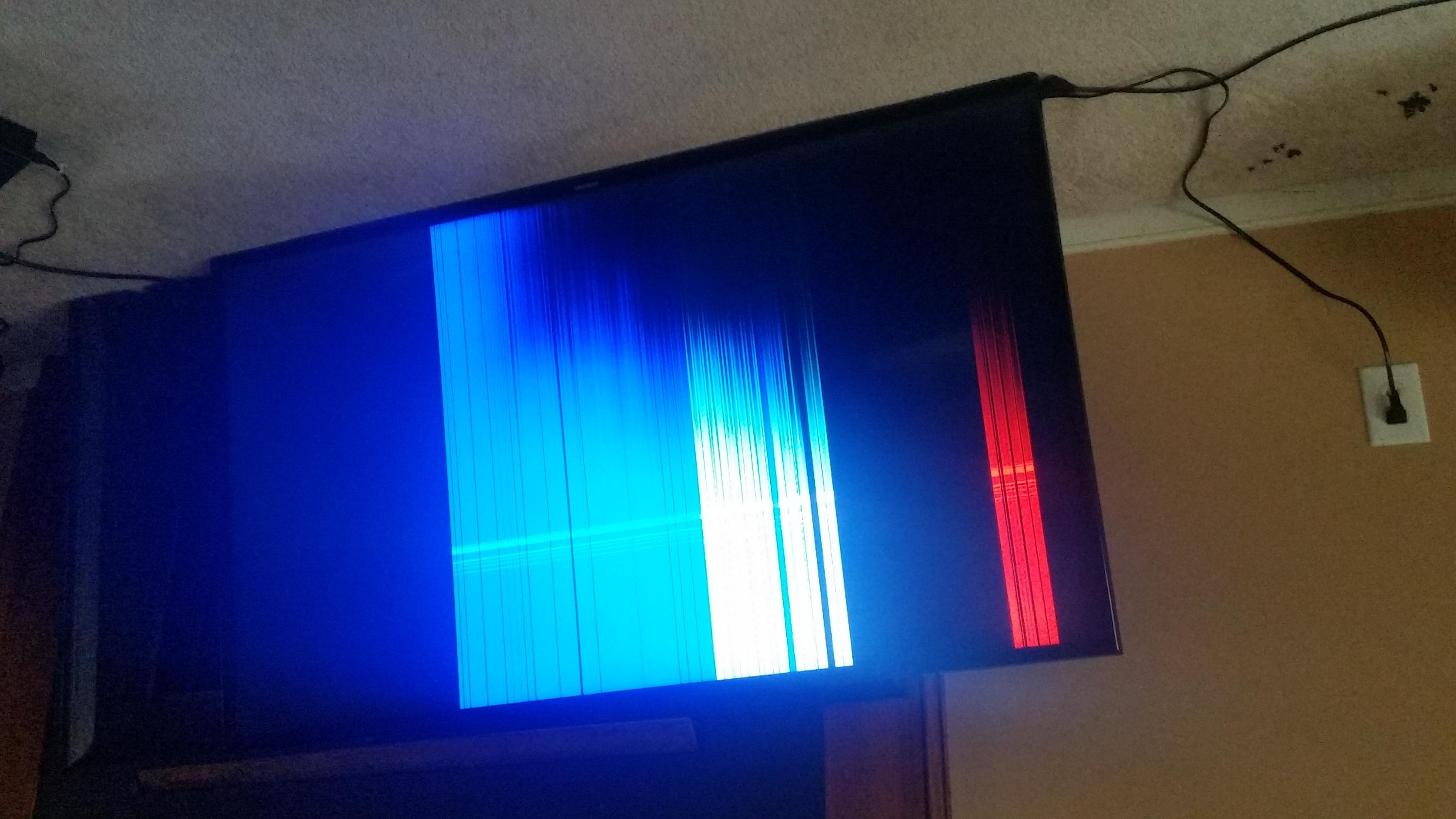

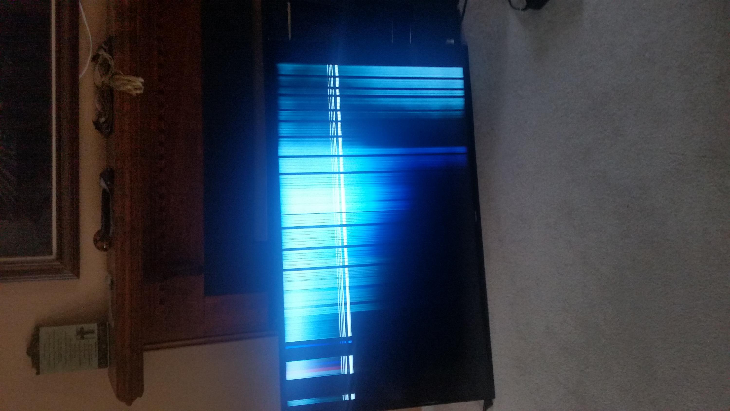

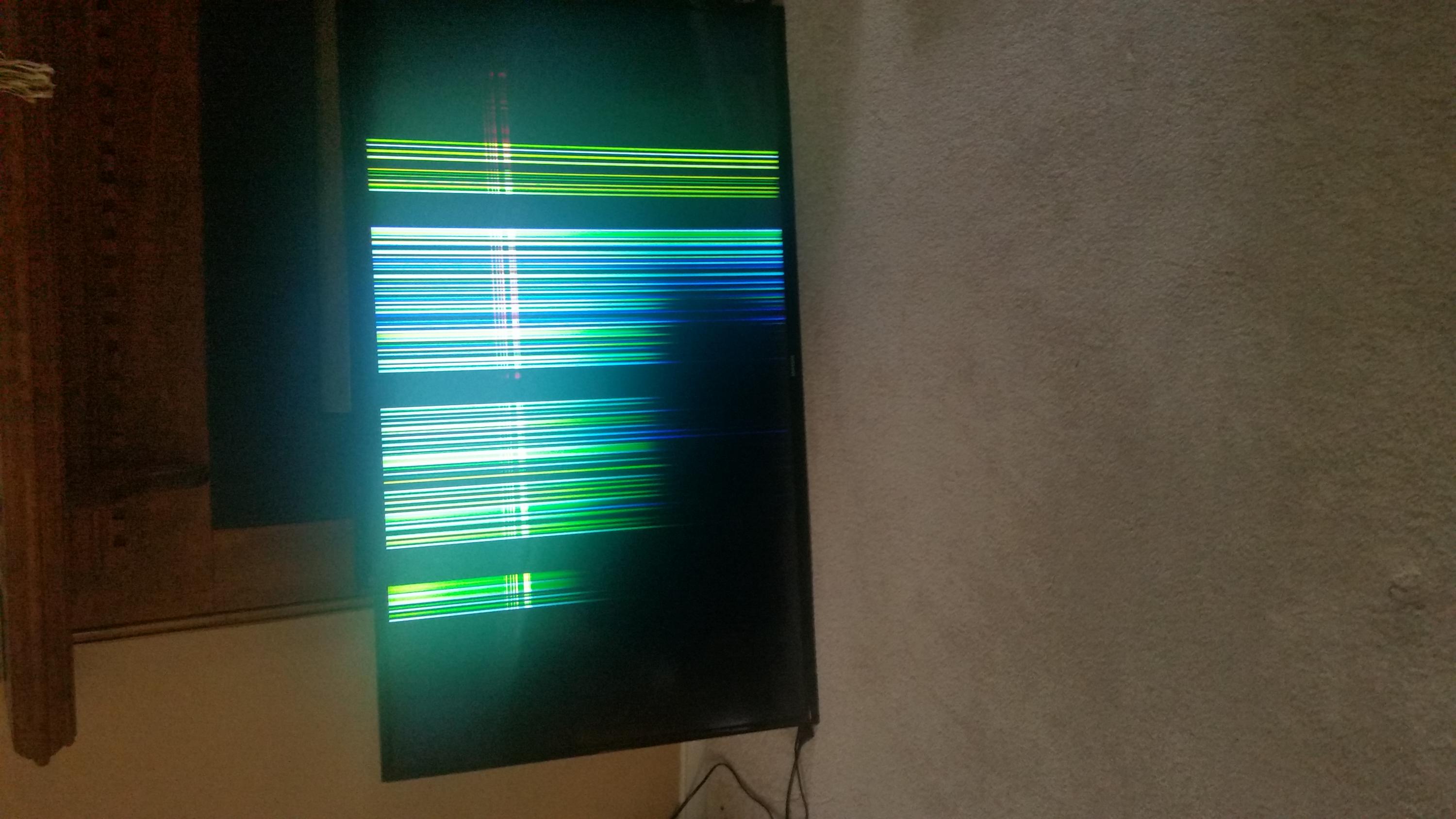

    Hello, I'm a new subscriber to this forum. Having some issues with a Samsung UN60FH6003FXZA. Here's the history.
    1. Purchased TV second hand under the impression it needed a Tcon board.TV powered on, backlight on, sound on, blank bluish tinted screen. Researched the repair and proceeded with the replacement.
    2. Replacement Tcon didn't resolve the issues. Wasn't exactly certain the replacement board was functional, so re installed original. Did some further research. Came across a site advising a reset by holding power button, restarting TV etc. Once done the screen illuminated, briefly saw the menu function screen, but no full visible picture. Checked cables to Tcon etc and restarted, screen would illuminate to various stages. Vertical lines, horizontal lines, white screen with horizontal lines etc.
    3. Tried different video sources, results varied, but no video just sound. Horizontal limes seem to show some changes while video is playing, menu button pressed etc. Noting at all viable other than multi colored lines, sometimes fading into white screen, other times just horizontal and vertical.
    I'm not certain if the Tcon would cause these issues or maybe the main board itself. Maybe simply the ldvs ribbon. Or worst a completely bad panel. Im seeking some advice prior to moving on. Any assistance is appreciated

    I would say bad panel since I do not believe bad T-CON can make black cloudy patch like that.

      Re: UN60FH6003FXZA*no video
      Thanks. But the screen does not always exhibit the cloudy patch. Each time I power on the TV it exhibits different patterns, horizontal and vertical lines, color streaking, white screen etc. At times the cloudy patches show othe times not. But the location of the patches varies
        Did you try having one ribbon cable between the panel and the T-CON connected one at a time to see what you will get on the screen?
          Vertical colored lines with horizontal lines on only side of connected ribbon cable. No video visible
            It is the panel.
              So all other possible culprits can be eliminated. Tcon, main board, ldvs cable etc etc. Thanks
                Wait take the frame off and get us an image of the tab bond Pcb.
                  Well without taking apart the back, I decided to examine the connector ribbons going from the Tcon board to the screen. As I loosen the ribbons and gently pull away from tcon, some visible picture comes to the screen. The words No signal can be slightly. So I'm wondering if these ribbons could be the issue
