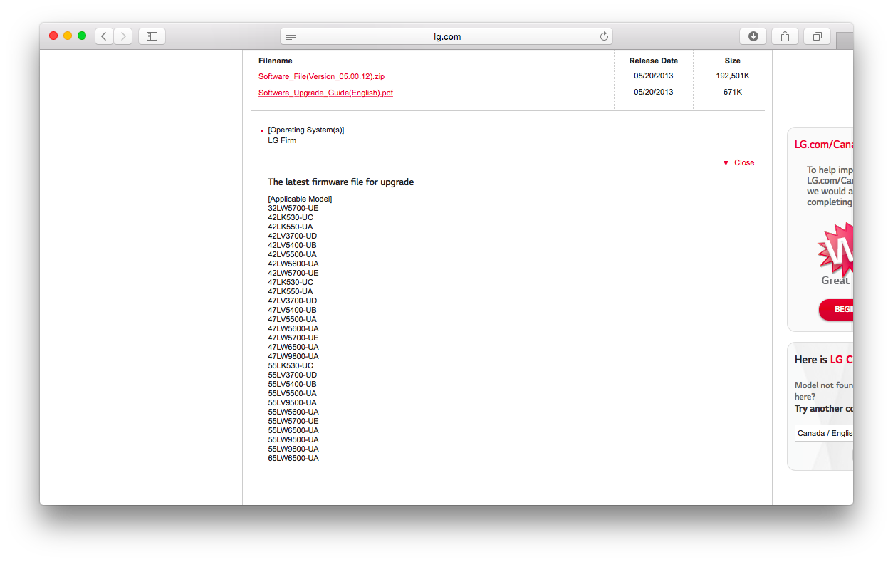

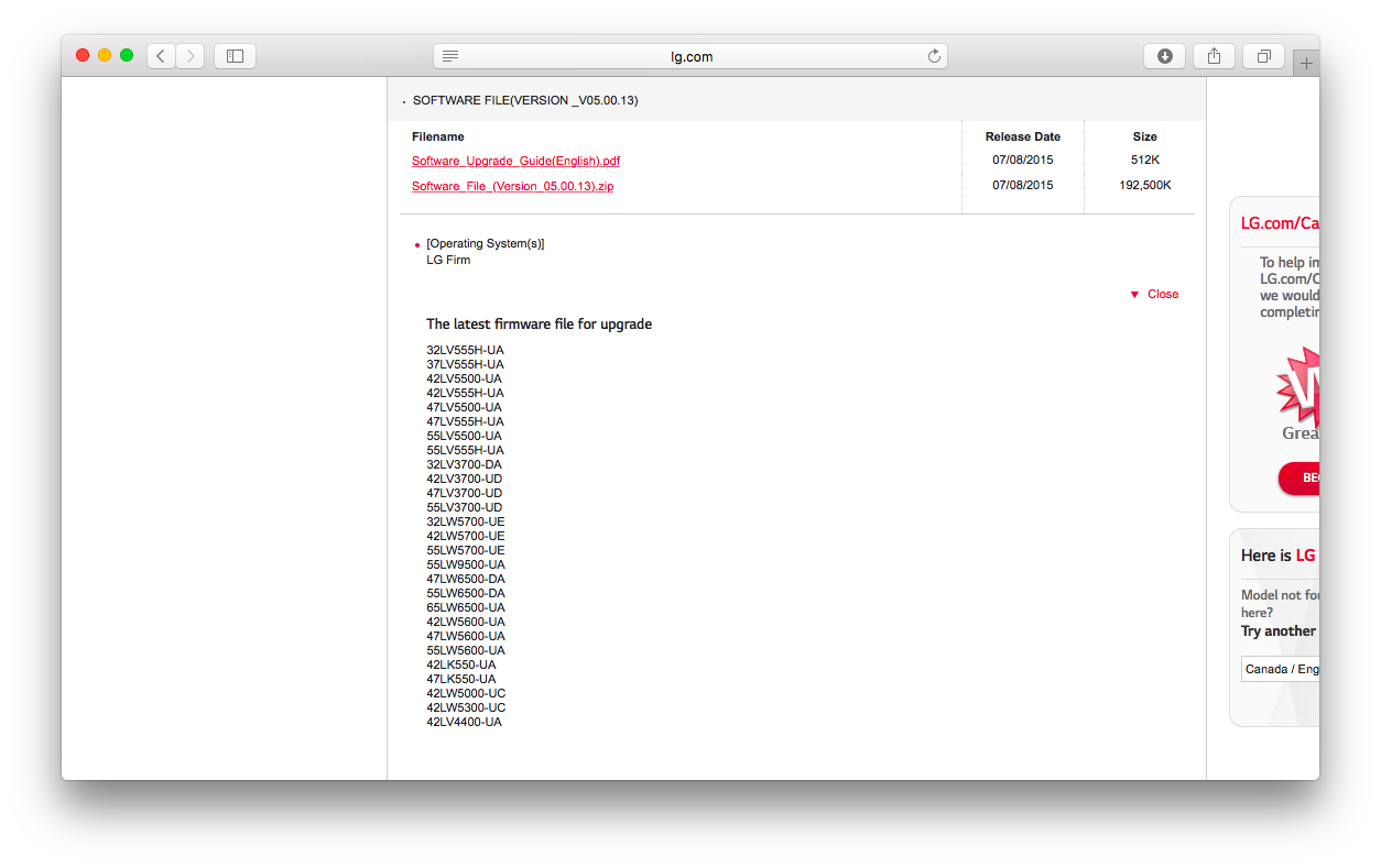

        Re: LG 47LW5600 Firmware Rollback - No Screen
        LG Firmware Info. In pictures.
