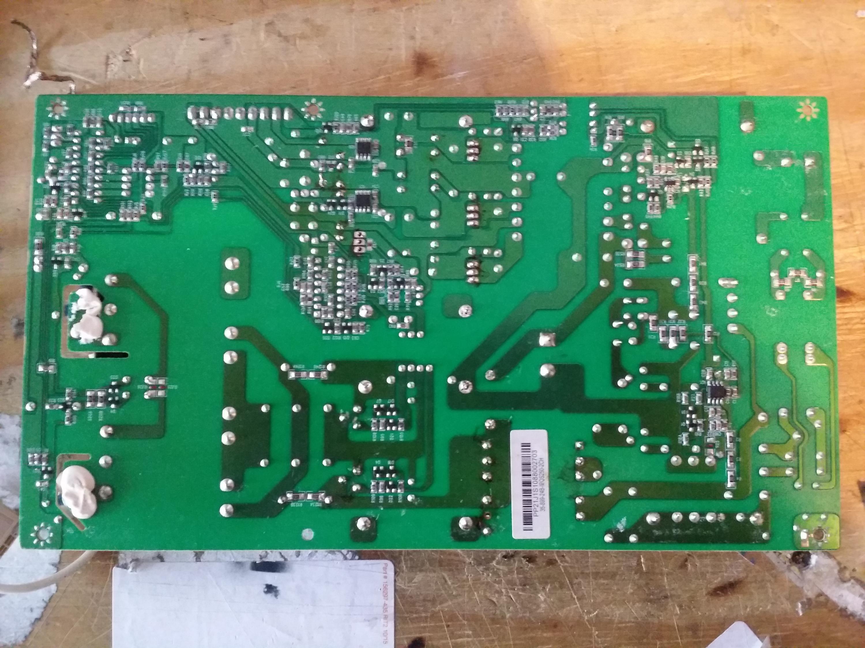

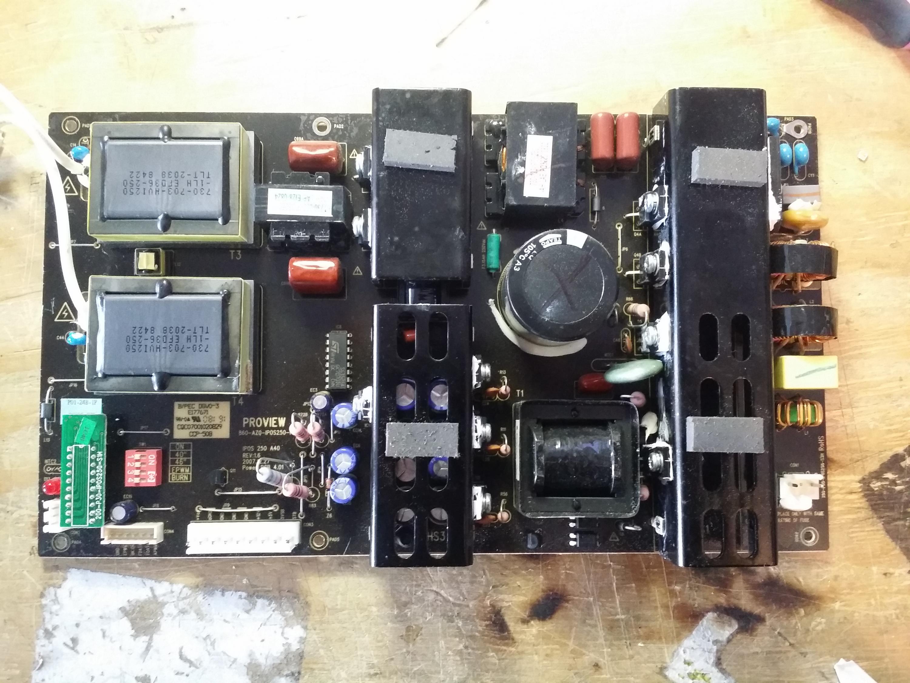

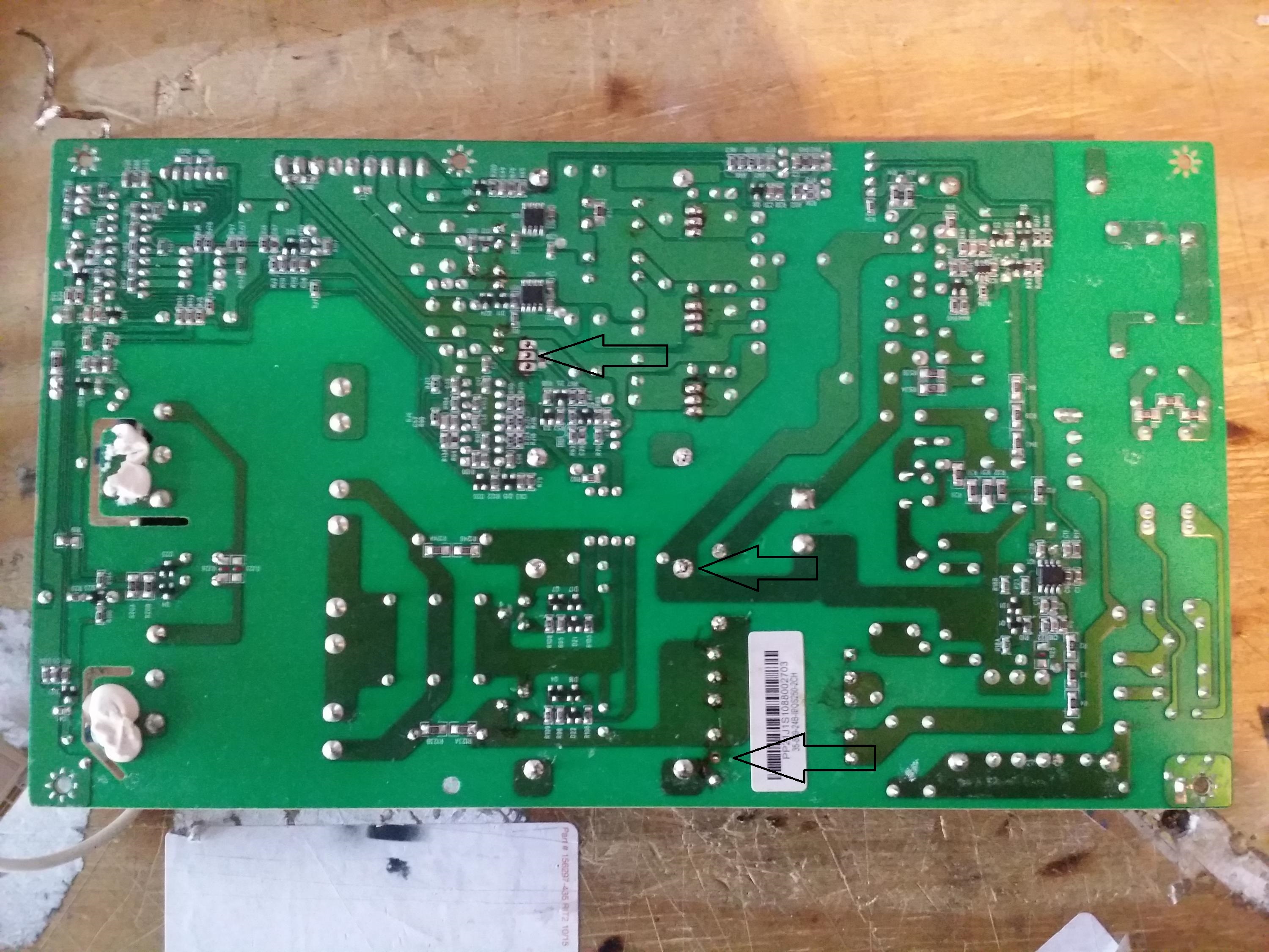

                    Re: Polaroid TLX04243B Backlight flashes then out
                    https://www.badcaps.net/forum/attach...7&d=1459812008
                    The 3-leg device on the middle of the board is soldered properly? It looks like it was removed and put back in place with bad soldering works.
                    Also check the capacitance of those two big brown poly caps by the inverter transformers.
                    How is the DCV on the main filter cap, about 380~400VDC and steady?
                    • dick_barton
                      • Aug 2015
                      • 6643
                      • Wales
                      Spot on budm. There's no way that is soldered back in place.
                        He desoldered that to get at the caps though. But it does need to be properly resoldered.
                          There's a few poor solder joints but the image is not well focused so there could be more bad joints
                          • 102mm
                            • Dec 2013
                            • 181
                            • us
                            Oh yea, I took the pictures before i soldered the parts back after taking off the heat sinks and replacing the caps. everything is soldered properly that i took off..
                            SO now i also have a 32" version (FLX-3211B) doing exactly the same thing.. It has a smaller Power supply P/N: IPOS 150. on this one there the red light of the power supply does not flash, it's just a solid red.. exact same symptoms
