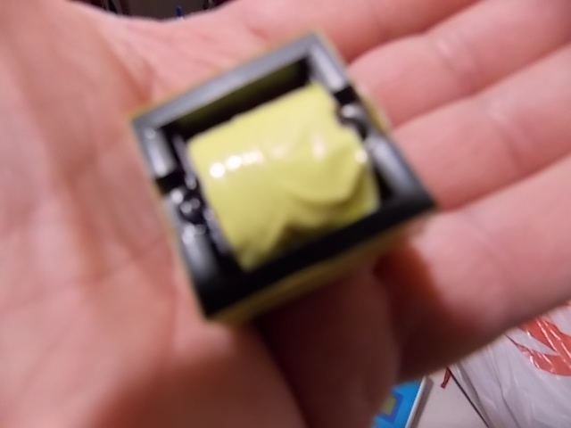

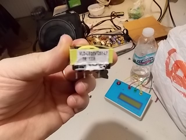

        I may have been thrown a curveball by receiving a defective new power supply. Even after replacing the main, and eeprom board? i just jumped the power on to 5 volts standby, and the 12 volt to backlight on Voltages were fluctuating up and down from 12 volts to 5 volts very erratic. I lifted TR1338 VLD-LEDTV1251-L7 that is the number on the part. not a location number. After I lifted it voltages all stabilized. I think I found my problem. anyone know where I can buy this part?

          'TR1338 VLD-LEDTV1251-L7 ' we have no idea what that is. Where are the pictures? It sure does not sound like P/N of components to me.
          Some kind of transformer? Inductor? so when you lift it the drive circuit that drive this part may be bad so when you disconnected it the circuit no linger draw the current, so it may not be this part that is bad but the components that drive this part may be bad.
          We cannot do much until we get to see good clear pictures of what we are dealing with first.

            TR1338 VLD-LEDTV1251-L7, L7 looks to be designator for the part.
            Model number on the barcode sticker is 'VLD-LEDTV1251????'
            P/N for the board on the barcode sticker?

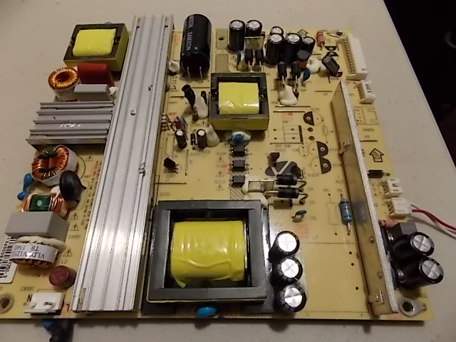

                    here are some pictures

                        That is not transformer, that is the inductor for the Boost converter for the LED sriver circuit, so when you remove it it is no longer connected to the power MOSFET that is used for driving the inductor. It will also show low DCR value which is normal.

                          Any Straight shot pictures of the bottom side of the board without the insulator sheet in place?

                            Stupid me, I will test that as an inductor. It might not be my problem.

                              Glad I didn't throw it away. That means I am back to square one on this set. If that part isn't bad. Then the new power supply was probably OK. As I said in one of my first post. I replaced the power supply, main board, and FRC board, mistaking it for a eprom board. Since none of those boards made the repair, and I thought I had found a bad transformer on the original board. I sent all those boards back. How much voltage am I looking for to light the led's? When you jump 5 volts to power supply on, and 12 volt to backlight on, if there is nothing wrong with the power supply or the main board, or the led's then the backlight should light, right?

                                The inductor was fine. I found a bad fet and replaced it. I jumped the 5 volts to power on, and the 12 volts to backlight on. All voltages came back steady 5 volts and a steady 12 volts. However, at the led + and led - the voltage seems high and is fluctuating from 172 to 175 on both sides. what regulates that voltage?

                                        We need to see the straight shot pictures of the bottom side of the board to see if it has one or more than one LED driver circuits.
