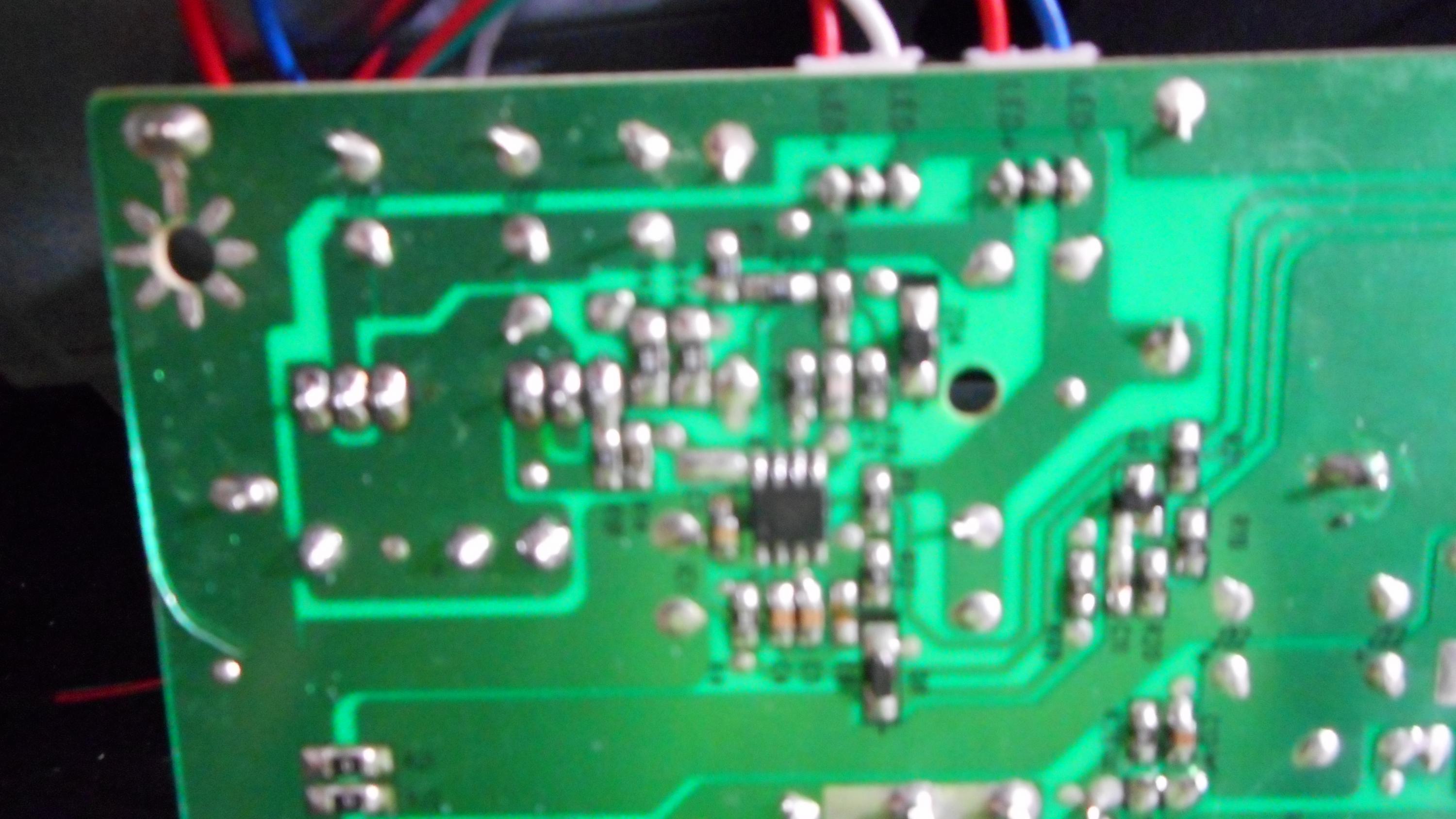

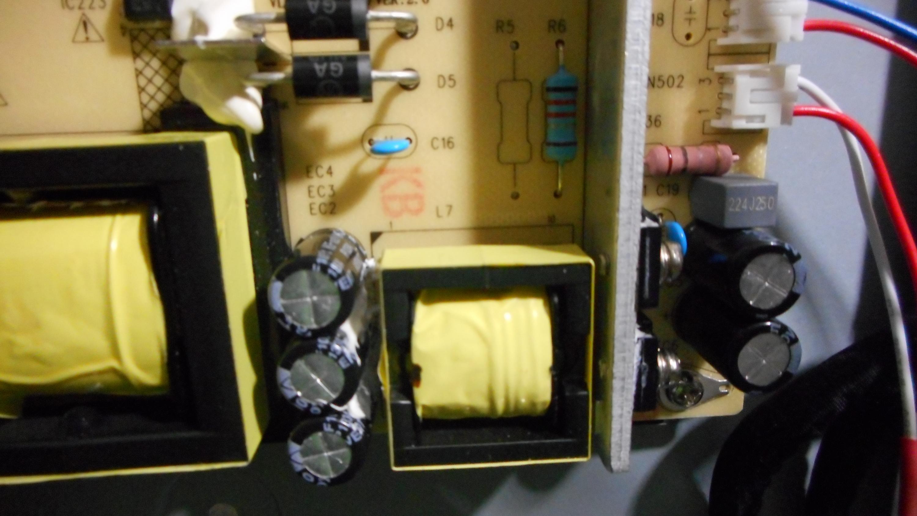

                  I do not get what you are doing, you put the jumper between 5VSTBY and the PS-ON at two places? How did you figure out which pin is the PS-ON? I do not see the pin labels on the top side of the power supply board.
                  Can you show good clear pictures of the bottom side of the power board where the connectors are, may be the labels for the pin functions are on the bottom side of the power supply board.

                                  That is why I request the pictures of the bottom side of the board also since as you can seem they did put pin labels for the LED connectors on the bottom side side of the board, so I need to see good clear pictures of the board especially around the connectors.
                                  As you can see the pictures from SJ, the bottom side of the board has insulation sheet so I cannot see if there are any labels on the bottom side of the board for the CN201 connector.

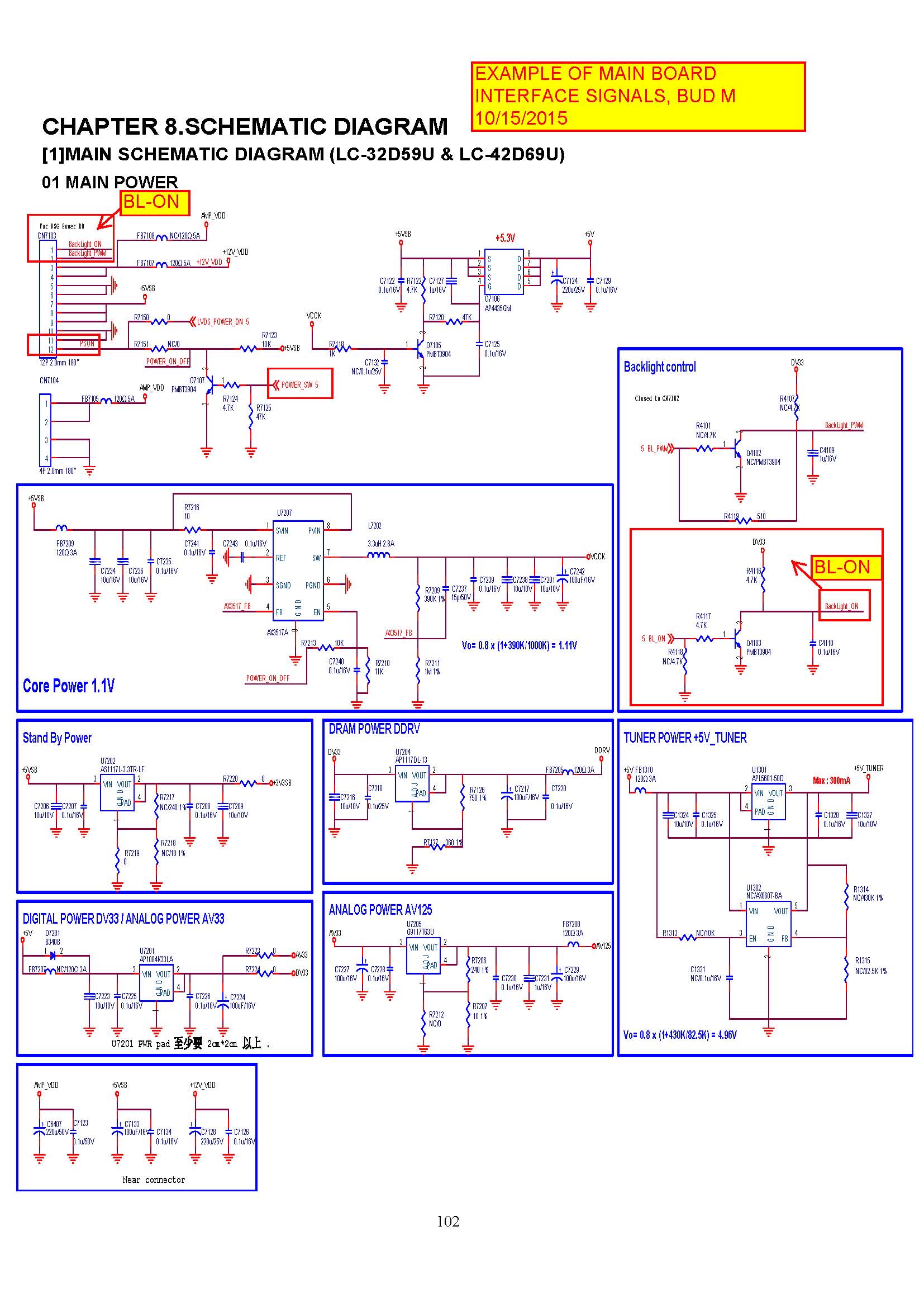

                                      Another thing you have to watch out for when using the direct connection between the Voltage source pin to the command pin, you must disconnect the cable back to the main board first since the switched transistor will normally be FULLY ON (Transistor is in Saturated mode) to keep the command line output at LOW state (basically shorted to GND), if you connect the force on Voltage source without disconnecting the cable to the main board you can damage that switched transistor on the main board, using resistor is also help limit the current in case the connection is made wrong. I ALWAYS use the resistors.
                                      See the schematic on how the switched Transistors are used as the switches on the main board for PS-ON, BL-ON.

                                        Thank you for taking the time to educate me on that subject. I guess I have got very lucky in the past. i won't do that anymore. One of those pictures was the back corner. I guess the quality is still to poor. What do you use to take pictures with? Where do I go from here?
                                          #40
                                          Re: westinghouse DWM551Y1 no power
                                          Depending what it is, I am using a DSLR or my iPad.
