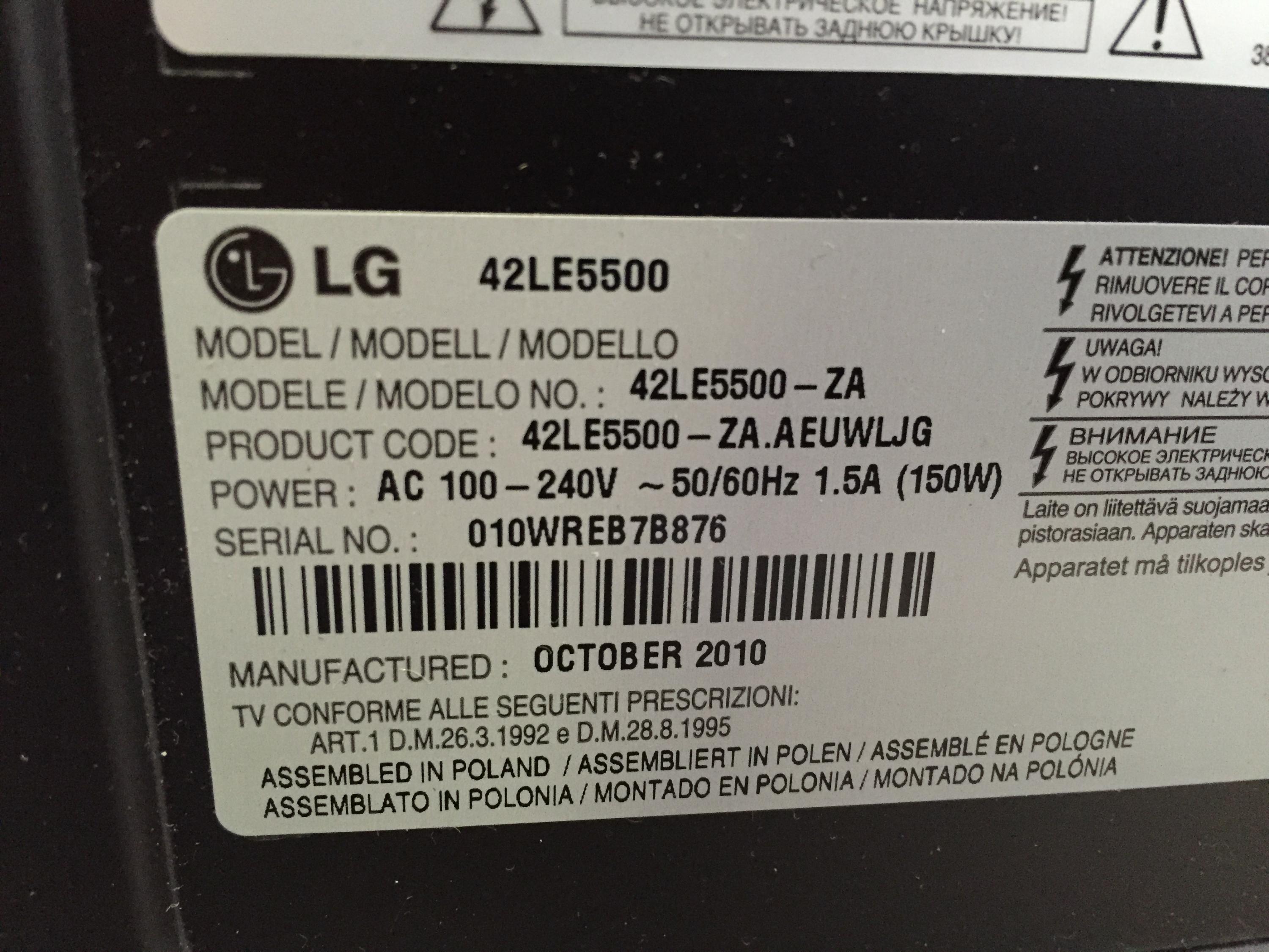

TV Lg42LE5500 pink screen with stripe

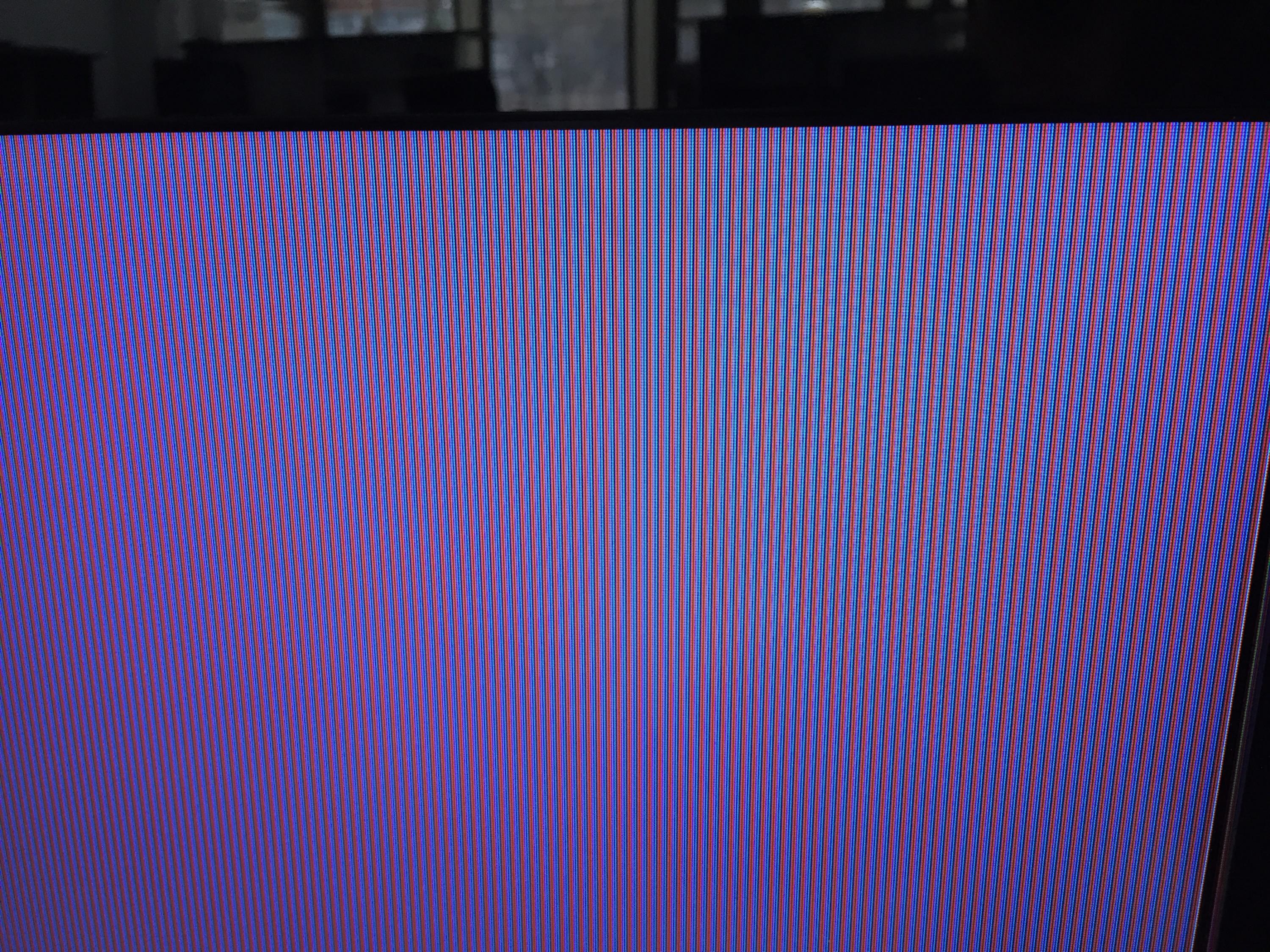

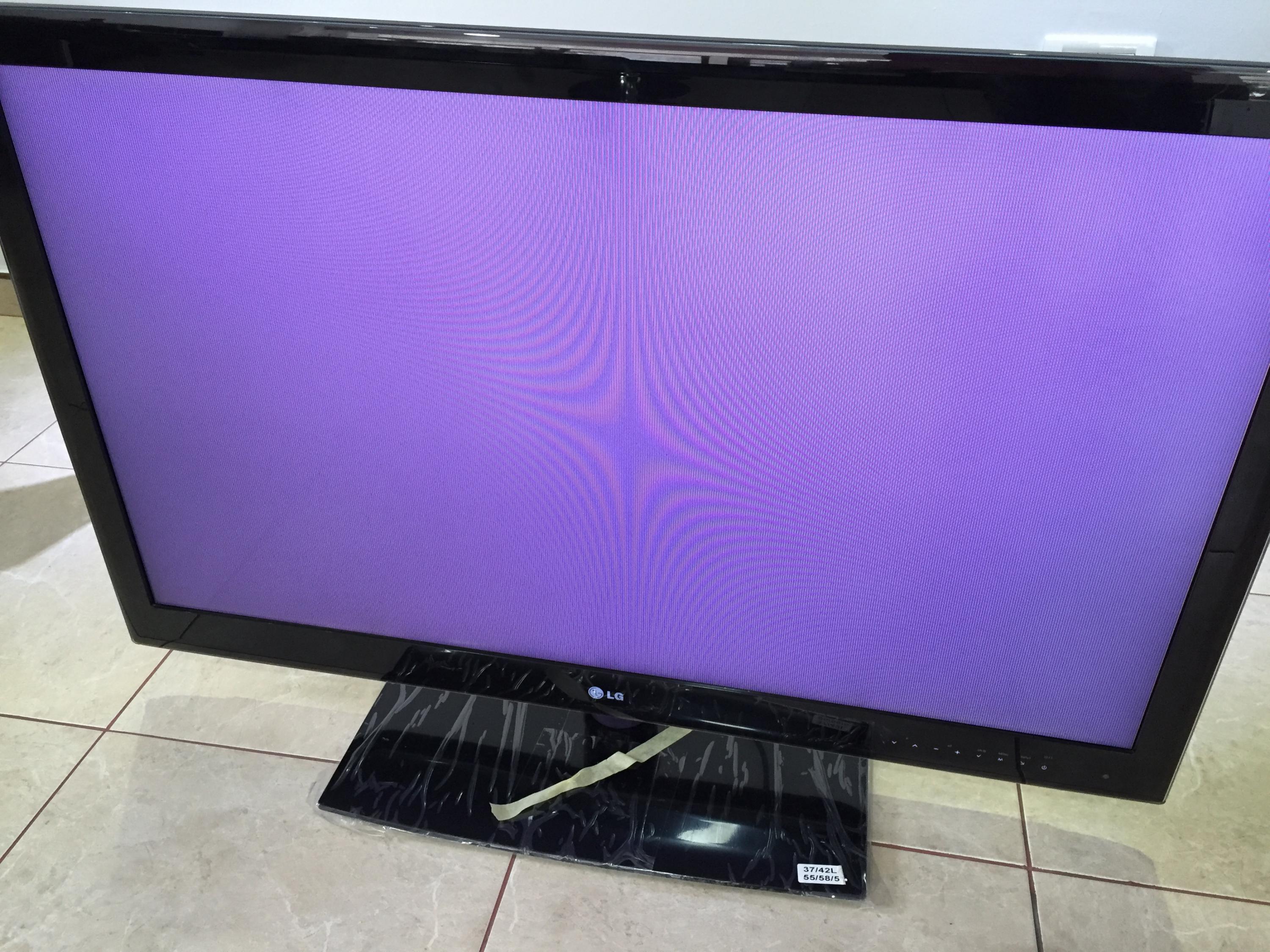

    - the tv has been in LG authorize service and was diagnose with fault mainboard / logic board
    - i want to see your opinion.
    I remove each strip from panel , and one side remains white , and other , pink
    Re: TV Lg42LE5500 pink screen with stripe
    Any idee please ?
      Panel fault not fixable sorry.
        good shout Reece
        could be mainboard i saw something last night about it its common on lg the processor chip needs reflowing only a temp fix though
          I'd be surprised if that's not a mainboard fault.
            Worth noting incase you can't find a mainboard for your model, you can upgrade the tv to a 42le4900 by swapping the mainboard.
              i make a reflow at main lg XD chip , and no result, possible fault chip
                @Hamie , you think is a mainboard fault ?
                  50/50 chance for me. Seen this as a main board fault and seen this as a panel fault too. Just to add to the confusion.
