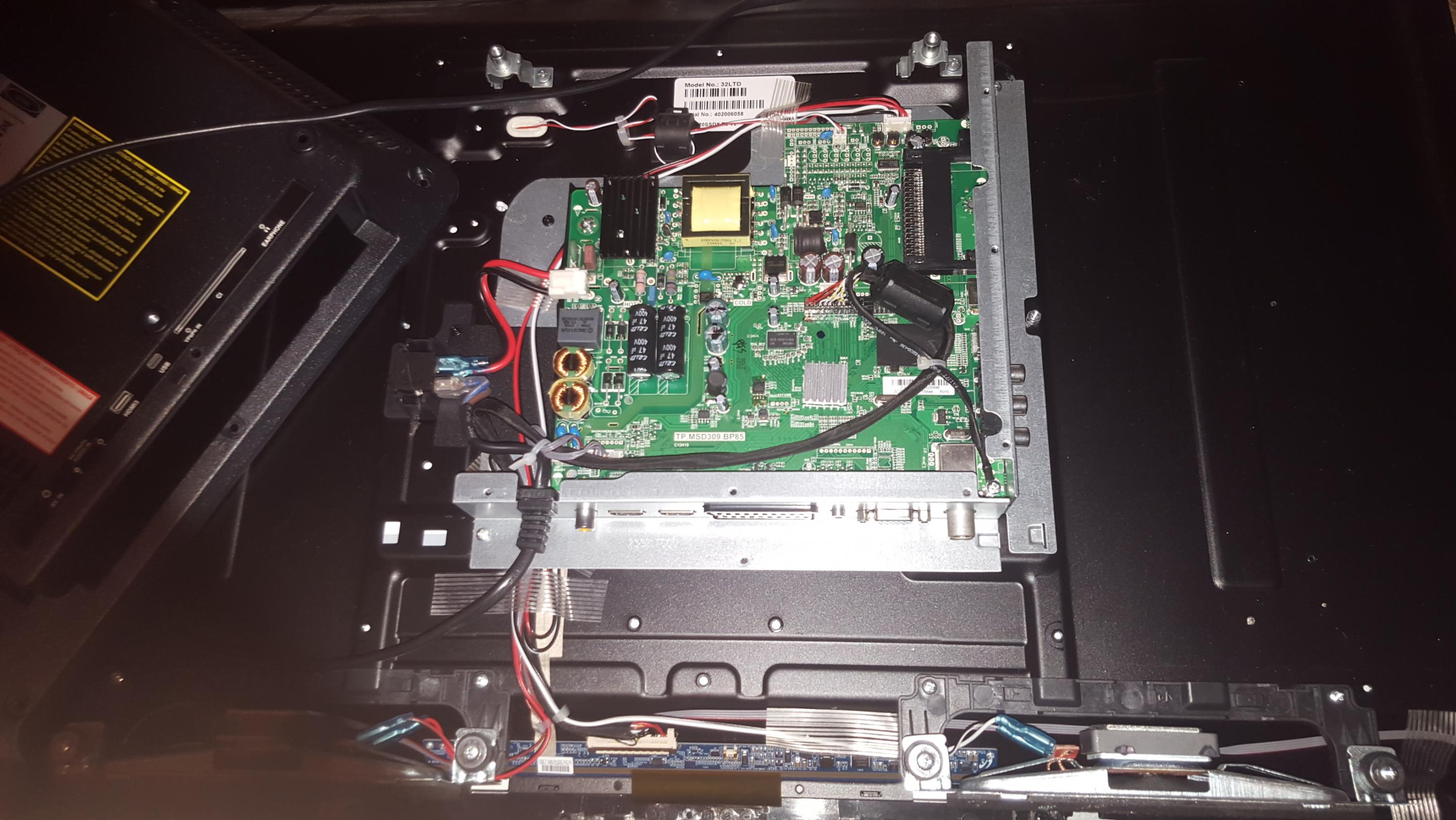

    got this tv today tv will turn off back lights flash on but then keeps restarting in a loop
    suspected that its a bad led but voltages are stable going to back light around 60 volt but then rises once backlight comes on then decreases and tv then restarts over and over ?

        A picture from the back showing all the boards and how they are connected will help us help you fix this TV.

          its early TO March LIE...
          how did you changed eeprom. ? and which bits you wrote on it...

              Thats literally it in the Tv lol one big Pcb. Its just shit haha

                Preprogrammed one from OHM supplies.

                  i see it seem the photo on first post before replacing eeprom... sorry....

                        Hmm doubt the Bl would be causing that though. It should work with the Bl on or not, what happens when you in plug the Bl ?
                          Re: blaupunkt 32/146L-GB-6B tp.msd309.bp 85 restarting
                          if you mean unplug the backlight ?
                          then its still the same i thought that i found a diode that was shorted but once removed from circuit it was fine

                                you have bad led open and one shorted

                                        So it keeps restarting, and still doing the same without LED connector (the one with RED/WHITE wires).
                                        Will it also restarting if LVDS cable is also disconnected?
                                        And how do you stop it from restarting? Unplug the AC power cord or you can still use the power switch or the remote to turn it off?
