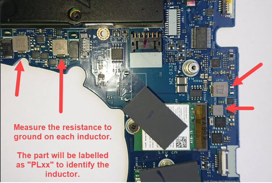

                  Ok. Power down and remove the adapter / laptop battery (if connected).
                  Meter in resistance mode (200 ohms).
                  Black meter probe on ground.
                  Red meter lead on each inductor (rather large grey parts with 2 wide metal tabs). These are the heavy current switching inductors and therefore larger than most surface mount components. Also are shielded to prevent interference to nearby radio equipment.
                  See attached. The pattern on these HP (Compal) logic board appears to be that they are with the "PLxx" (where xx can be any number) for each inductor. You will need to do this for every PLxx inductor.
                  Write and post the resistance values for each inductor. Again, searching for some very low values to possibly identify a bad cap (often a tantalum) that may be causing this pulsing / post code event.

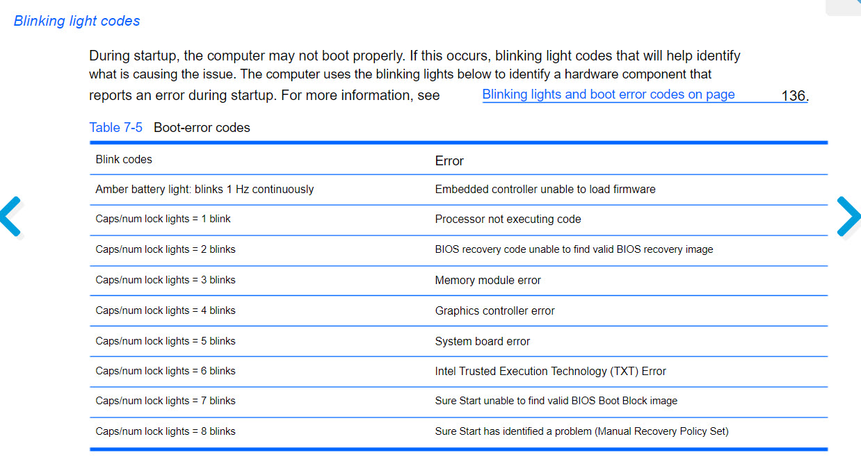

                  Followed your post on the video - that LED pattern must mean something to HP. Did you ever find a look up table for these LED (post codes) ? I think that will be a logical start to solving this issue.

                    Hm, propably identified bad one ? PL37, every other were possible to measure, but not the PL37, for a very very brief moment i saw some value, but not again when tried to measure again.
                    https://imgur.com/a/PZ79JoQ
                    PS: PL37 was unmeasurable on any range of Ohm set on multimeter
                    PS2: Inscription on PL37 :
                    4R7
                    612

                      I did another round of same measuring, but now with range set to 20M Ohm.
                      PL8: 0.01
                      PL39: 0.01
                      PL40: 0.02
                      PL37: started at 2, then climbing steadily to around 6, after that it was climbing much slower
                      PL59:0.12
                      • murko1
                        • May 2021
                        • 12
                        • Slovak Republic
                        Re: HP zbook 17 G3 T7V35ES - endless restarting pre-POST loop
                        Measure voltages when powered by external power supply:
                        PL8: ~1V
                        PL39: ~3.4V
                        PL40: ~5.15V
                        PL59: ~19.5V
                        PL37: ~0.2V

                          Home in with a clear picture of PL37 inductor and surroundings. There should be local caps to filter the rail along with mosfets and a local switching power supply IC. We need to review the laser markings on each component to ideally hunt down a typical schematic on how it may be applied by Compal for this design.
                          Cannot imagine any voltage on this logic board being normal @ ~0V2.
                          Also believe to have found the blink code sequences for this laptop. Please see attached. Do you see any of these patterns on your box ?
                              I think I found the problem thanks to the picture on the g3 light codes you posted.
                              Indeed it is the embedded controller which cannot launch the firmware, the first at the top of the list.
                              Do you think Mon2 there is a way to fix this.

                                Hi. Personally have not worked with reprogramming the EC devices, yet but others here in the forum have for assorted boxes. From my knowledge, you will need to review the EC part # -> check on which tool can reflash this device -> then apply the specific firmware for this target. Believe that there is an embedded 8051 inside these devices that lose their marbles once in a while. Not clear on this but thought that a bios upgrade can also refresh the EC firmware. Wait on some feedback from @SMDFlea and/or others on this topic.
                                • radegoub
                                  • Jul 2018
                                  • 9
                                  • France
                                  ok i understood, i have to reprogram the ec, it can't be the bq24780s charging chip which does not supply enough current to the ec. i looked everywhere for the firmware of the ec, and i don't found nothing.
