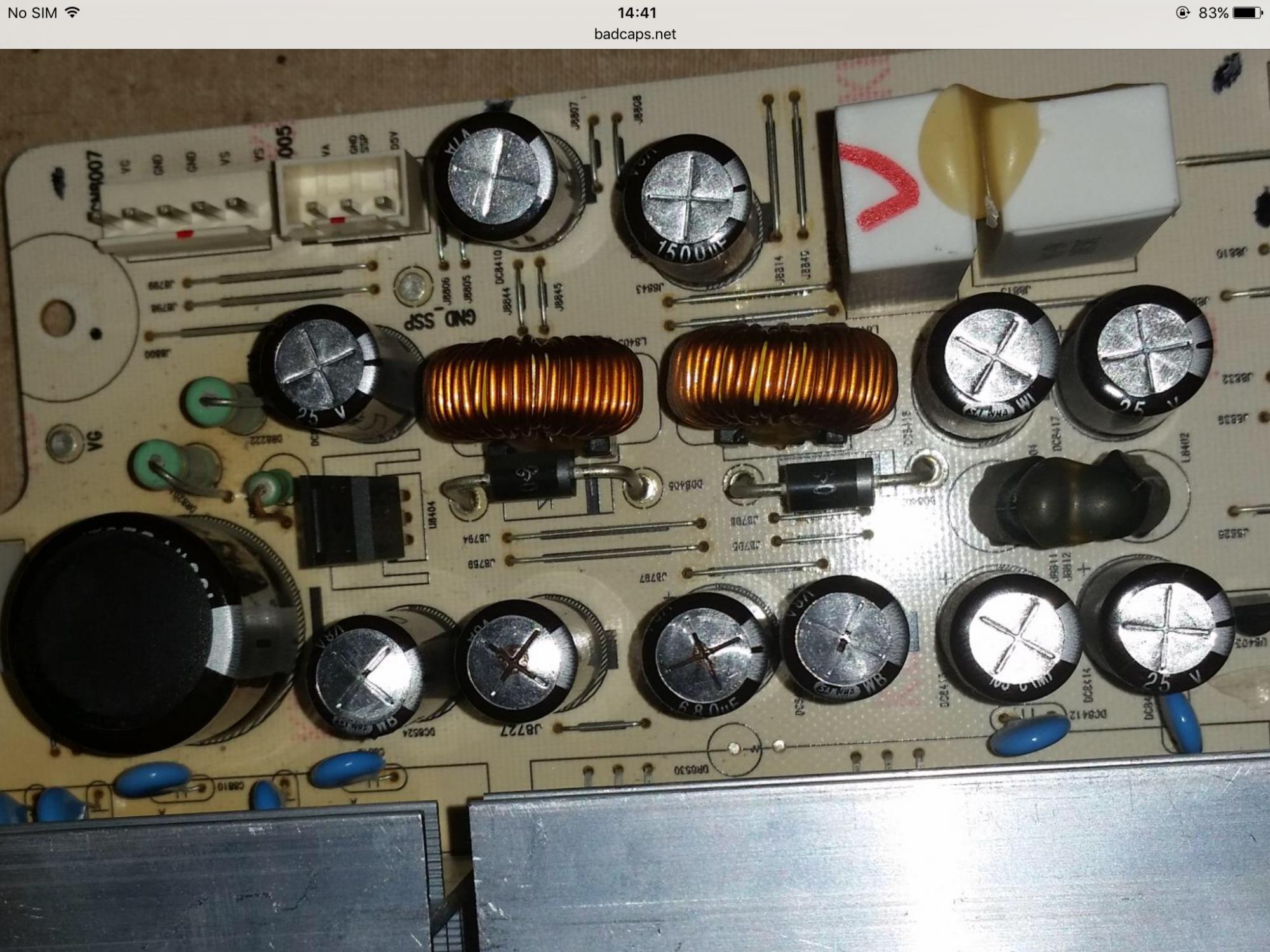

      Re: philips 50pfp5332d/37 keeps blowing fuse
      All the bulging capacitors will require replacing too.

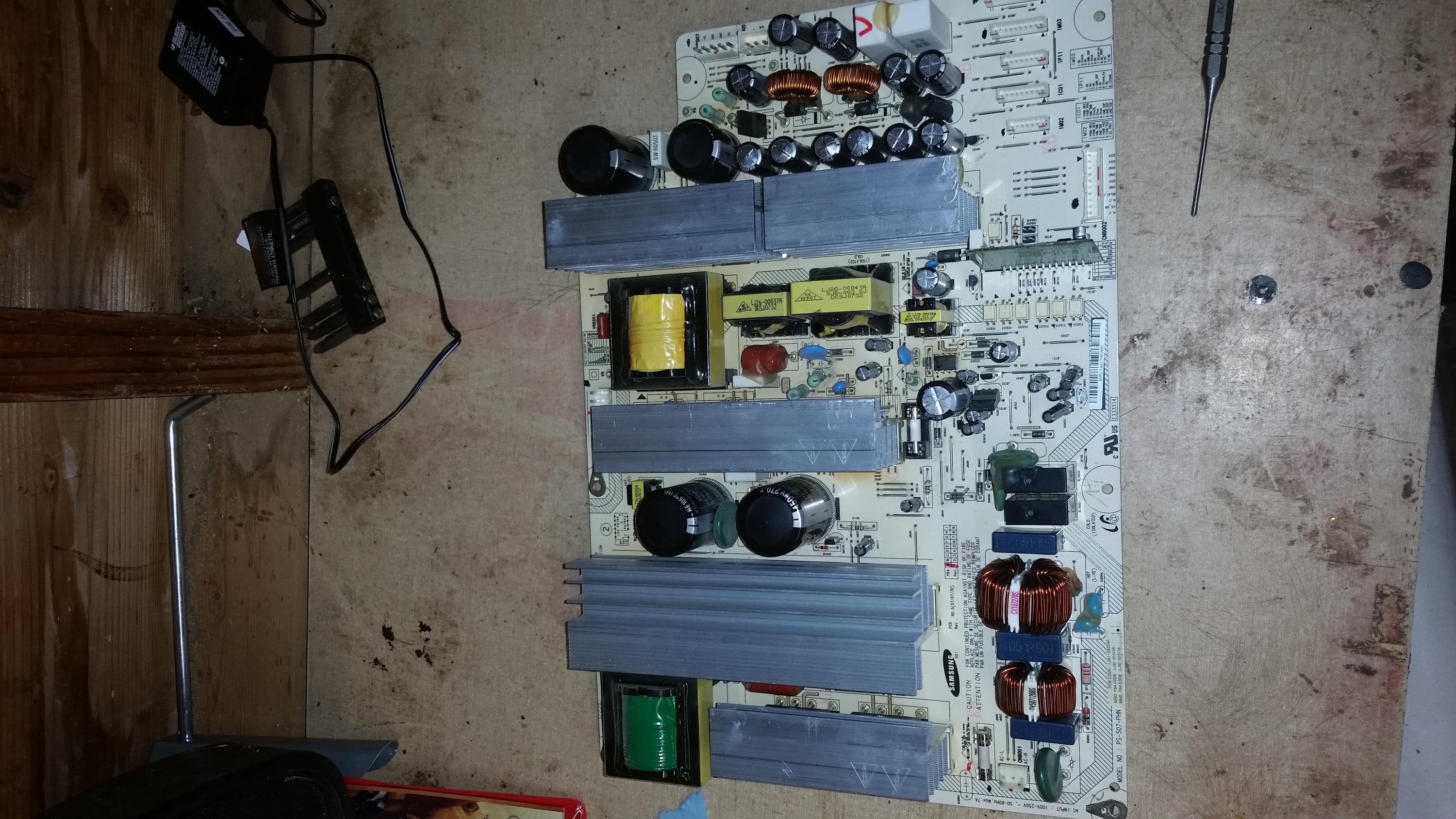

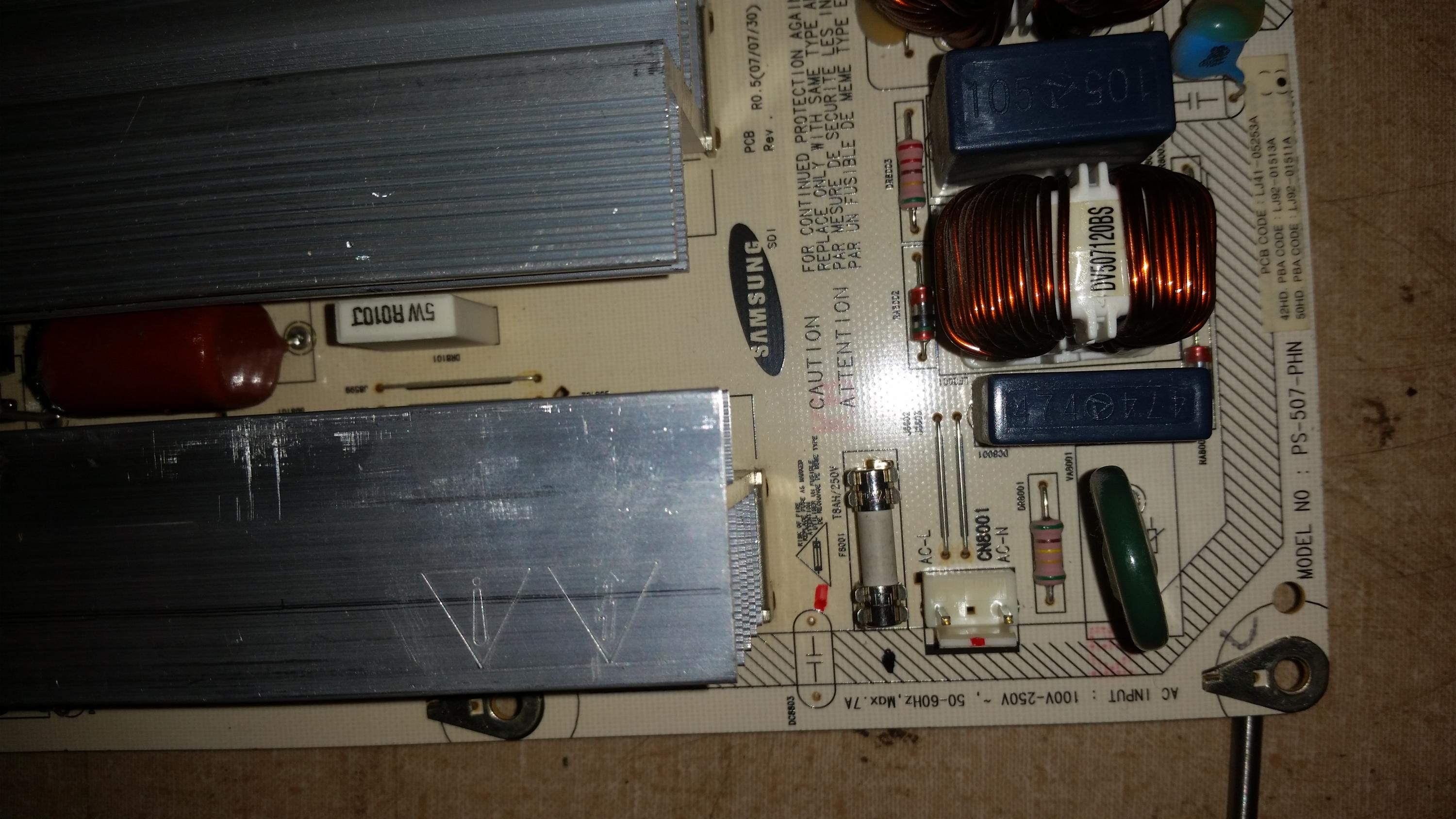

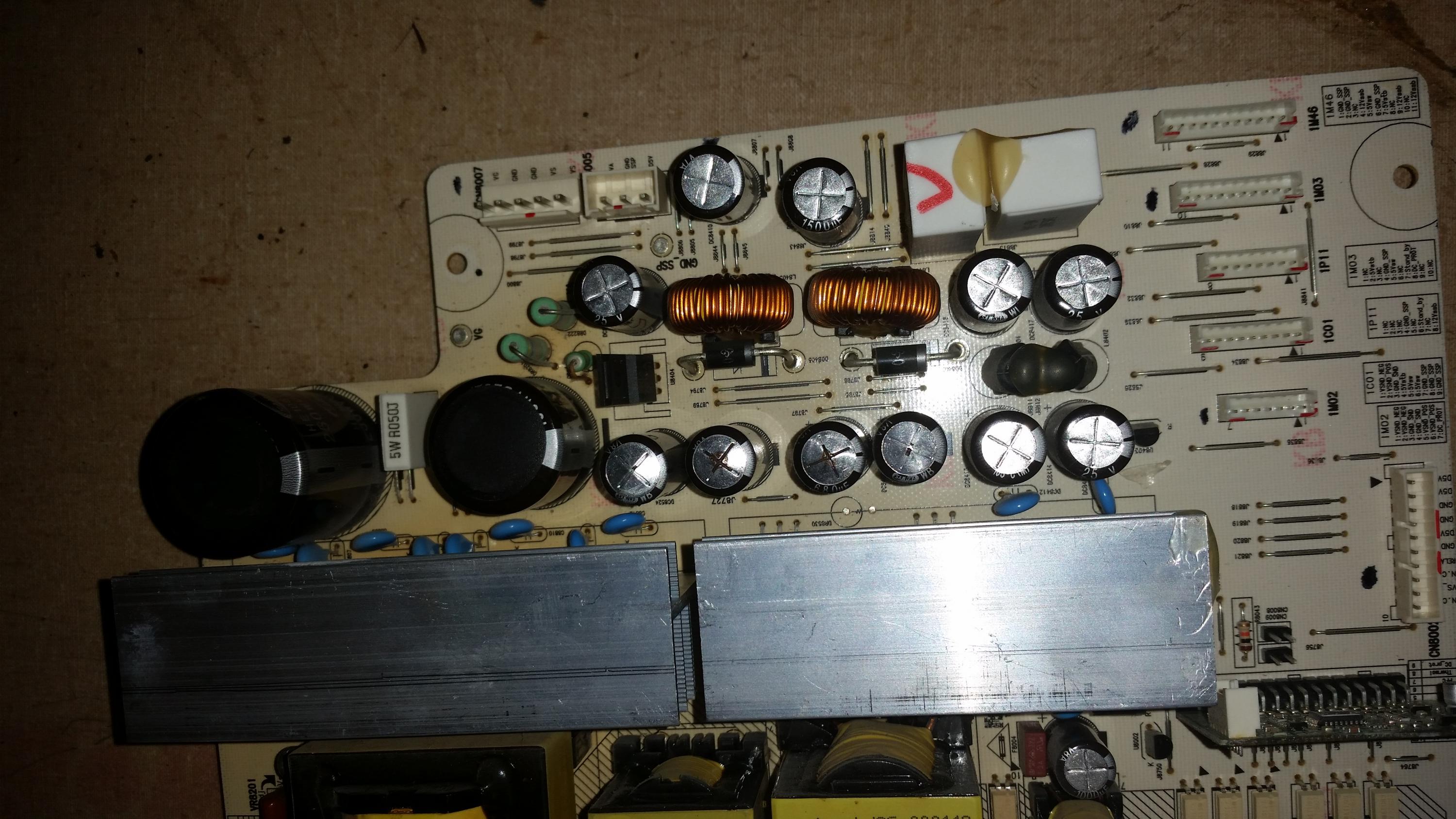

              I dont have a dmm at the moment,the board # is lj41-05253a hope these pic loaded right, thanks
                Also the board does have the pba code lj92-01511a
                  The capacitors that are bulged will need changing have you checked if all fuses are blown ?
                      This board has two bridge rectifiers fitted to the left hand heat sink (that them with four legs) just above the fuse that is blowing. when you have a dmm come back we can run though testing with you

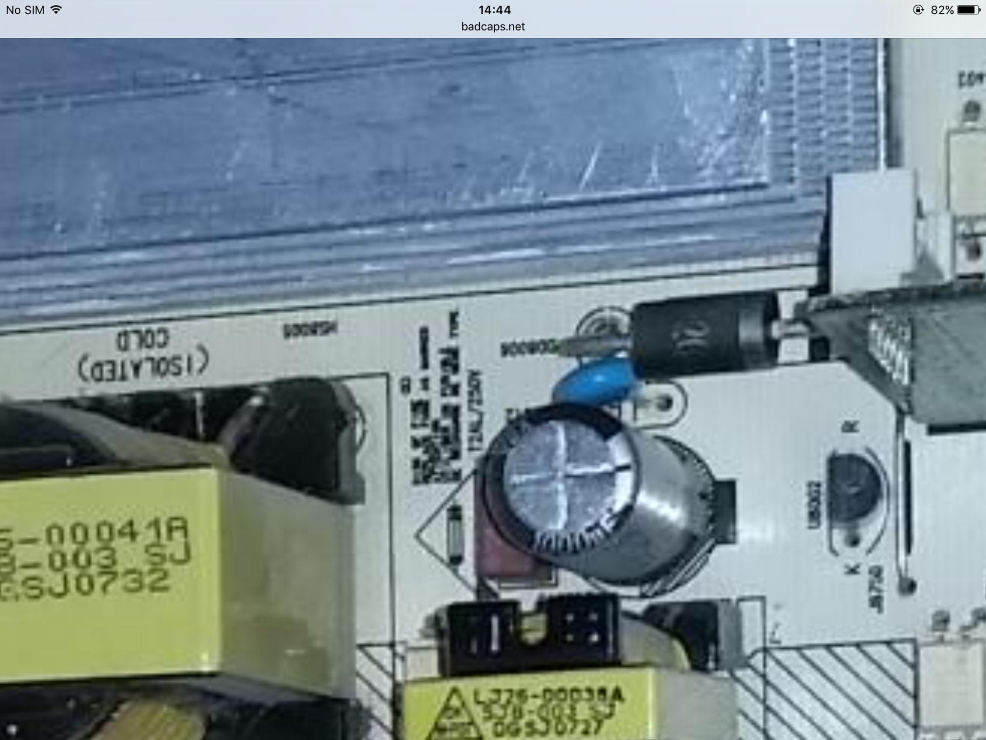

                          5vstby cap needs to be changed after repair too.
                                    I just repaired one of these exact TV sets.
                                    I had to replace inrush limiting R4006 and R4007 with Large NTC Thermistors because the blowing fuses smoked the originals. The NTC Thermistors are better anyway.
                                    Replace BOTH SAMWHA 450V 270uf with something similar or longer lasting. I had a SHORTED cap in mine causing it to blow fuses, the fuse located between the caps. I used Samsung 220uf 450V.
                                    Replace the G-LUXON 250V 820uf with something longer lasting. The value (uf) doesn't have to match, just put something better in there. I used a Nichicon 250V 470uf.
                                    On both of these replacements, the caps are taller and narrower so they will not be as close to the heatsinks, and makes the caps have longer life.
                                    Now Replace anything SAMXON!
                                    All the little green and black low voltage SAMXON caps near and under the heatsink replace ALL of them with similar or better. Also replace the two black SAMXON caps 680uf, 100V. I used 470uf 100V Nichicon, lower ESR caps, they are slightly taller too.
                                    Once you remove and replace all SAMWHA, G-LUXON and SAMXON caps your set will work, these are known issue parts on most PHILLIPS TV, just search this forum, it's well known.
