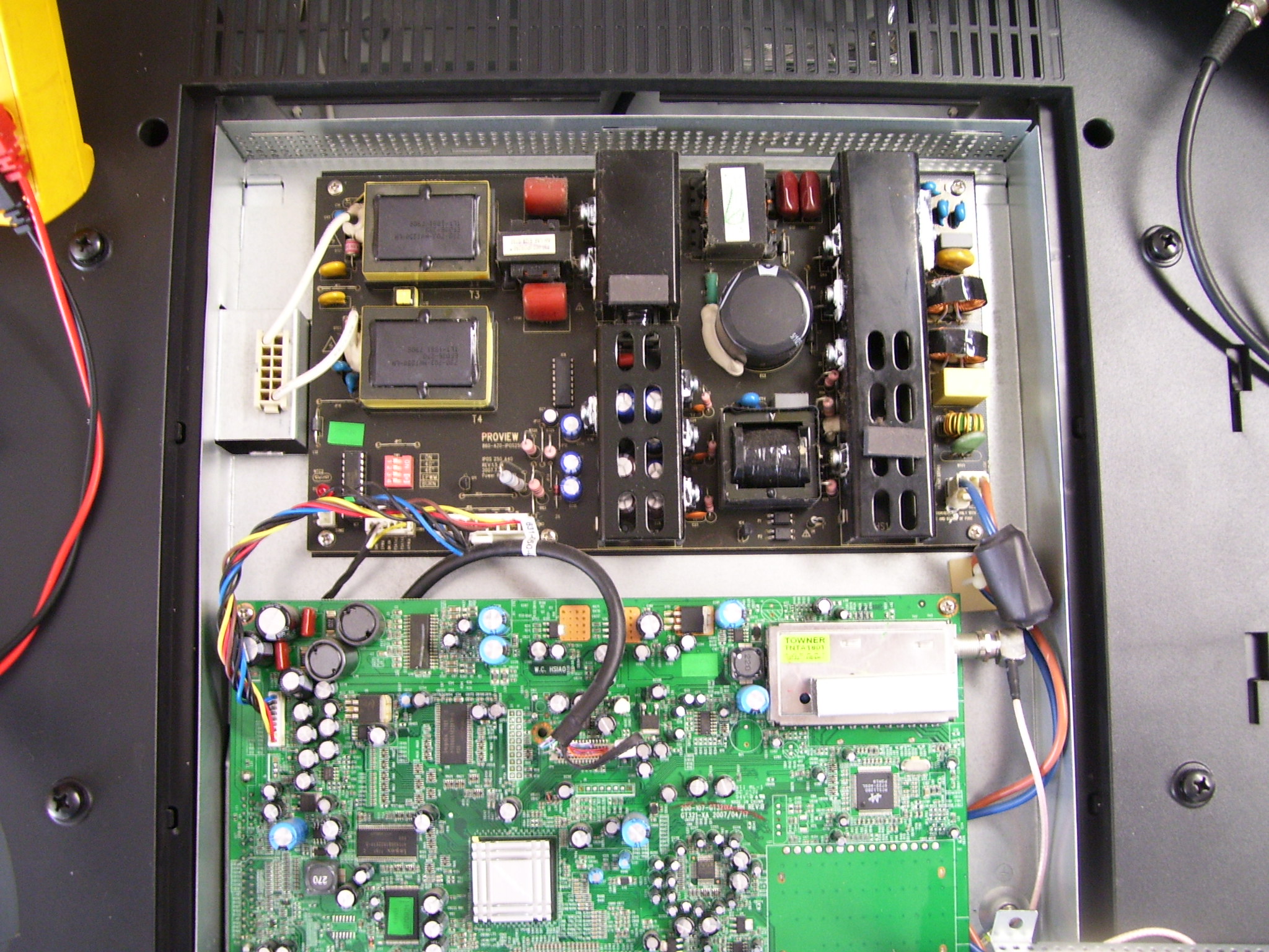

    Have a Polaroid TLX-04240b Has picture, no sound. Headphones jack works. Common in other models. I can not seem to find the resistor on this model
    Help!!

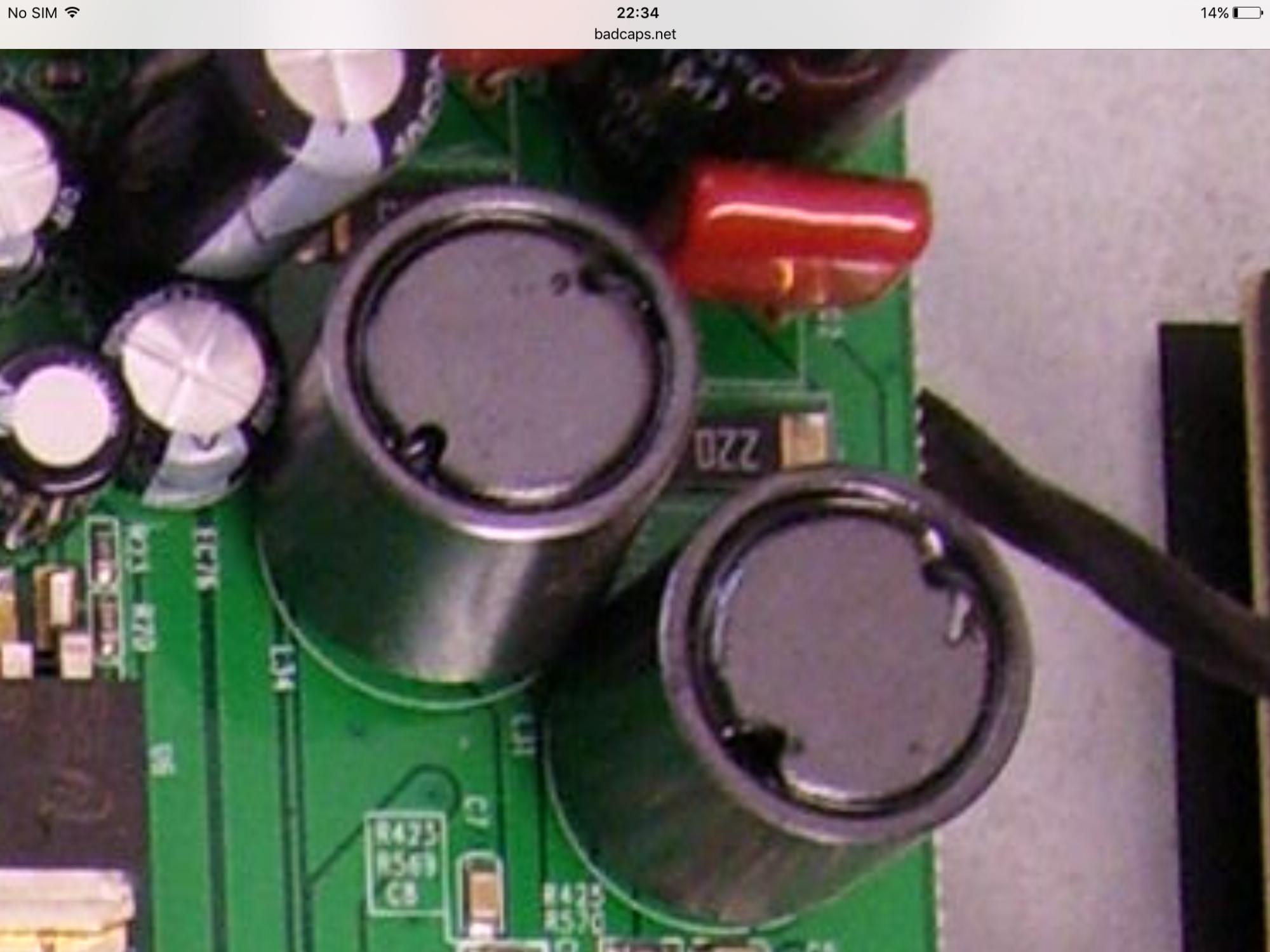

    Sure its the resistor I have imaged here, check it in circuit:

      The 220 is good, other ideas, also can not find the service manual.

        Are you getting any DCV on that Class D amplifiers IC (32-pin IC) next to the two output filter inductors?
        The internal speaker ON/OFF in the on screen user menu is ON?

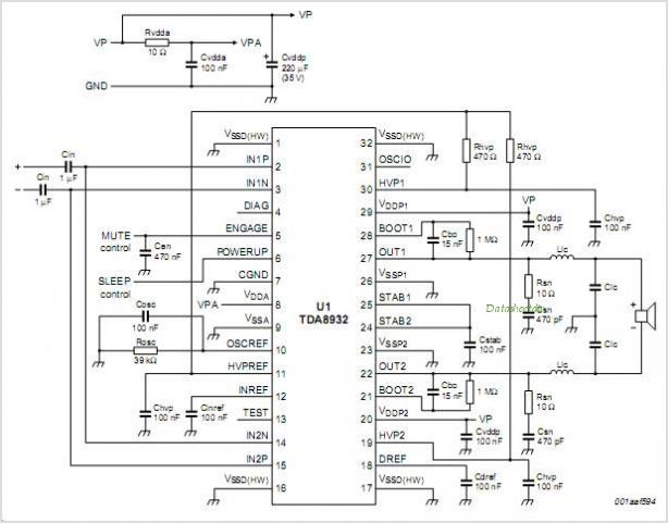

              if the dip switches setting did not fix the problem, then the next will be getting the P/N of that IC and see the circuit application notes which will be enough to guide you through the troubleshooting in that section, most manufacturers will just copy the application circuits and use them in the products. Do you have scope?

                    TDA8932t is the is

                              Spec sheet.
                              You may want to check the MUTE control line to see if it is set to MUTE.

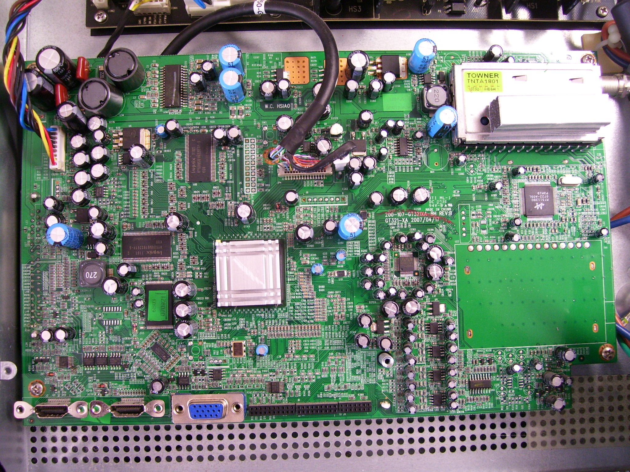

                                    Looked better at the IC (TDA8932t) Found cold solder joint on 3 pins, gave them all a new coat,----HAVE SOUND!!!
