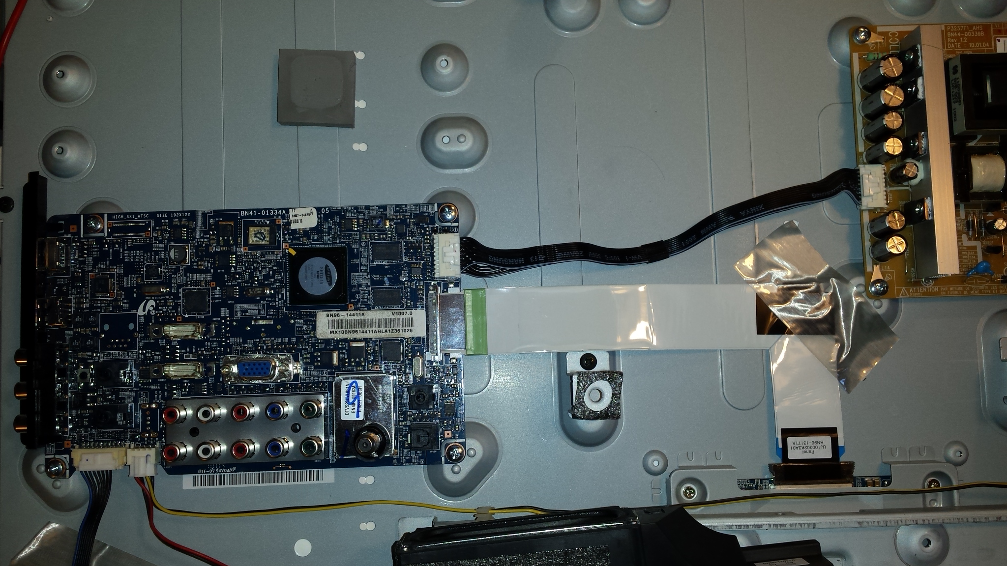

        Thanks for the heads up. Looks like I neglected a shot of the full power board, I apologize. Please see attached where I measured. I believe that was what you were referring to. 169-170V.

          How about uploading some pictures of the whole boards?

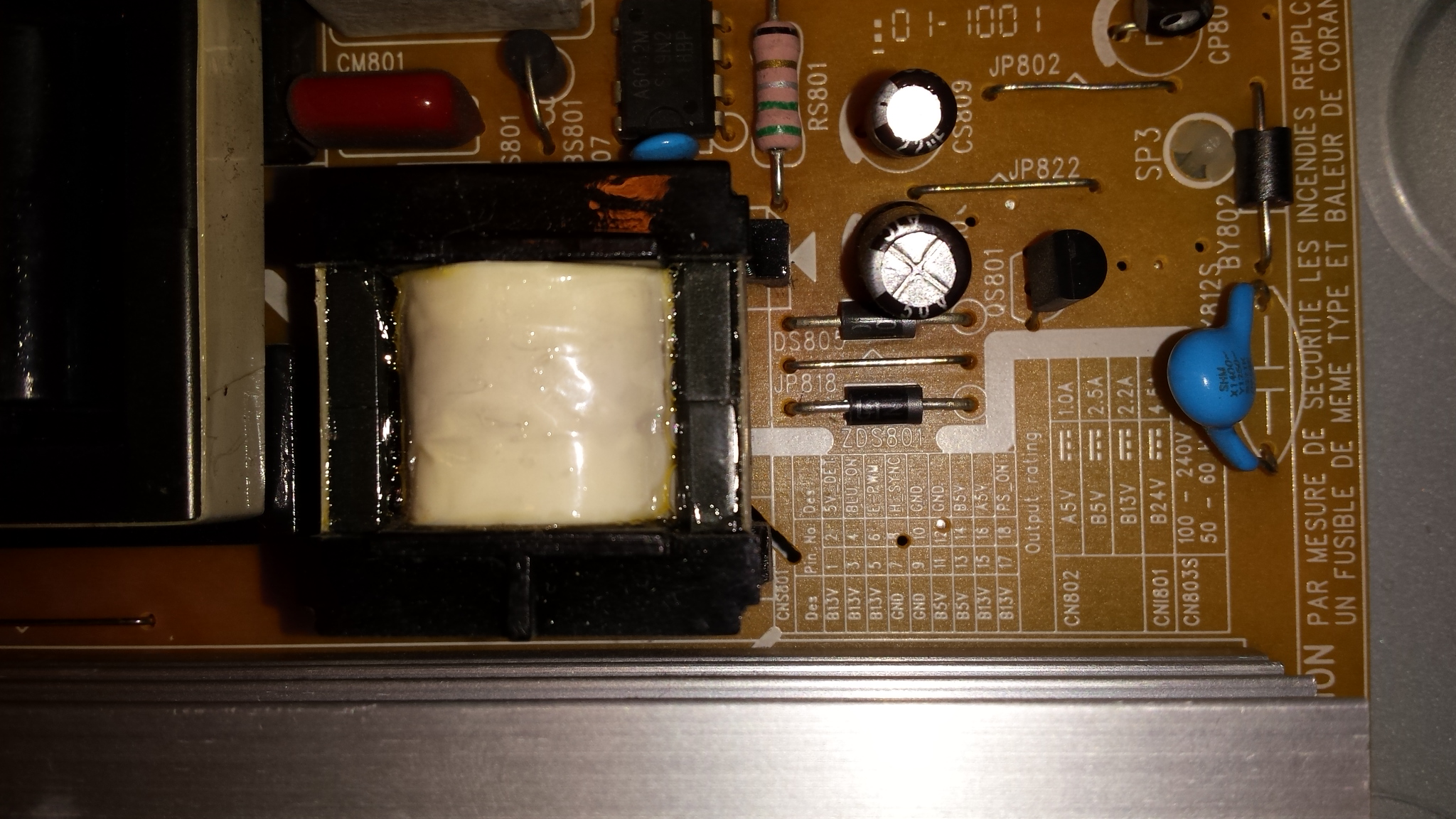

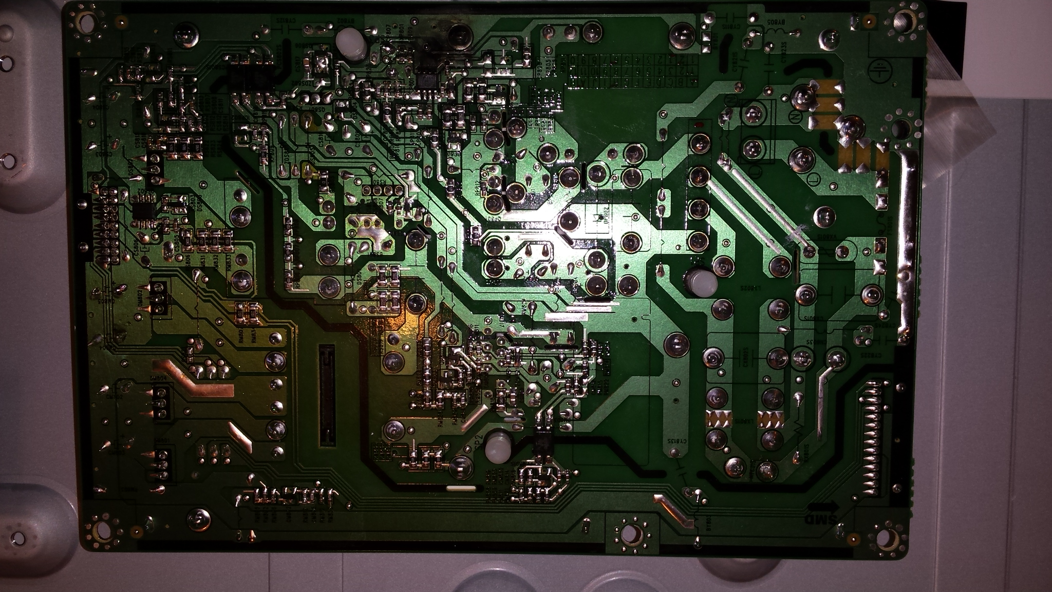

          Thank you for pointing this out, I realized I neglected two. Power Board shot is in my reply to Nick's post. Control Board Attached. Thanks!

            Power supply board: BN44-00339B
            http://www.shopjimmy.com/samsung-bn4...upply-unit.htm
            Sch attached.

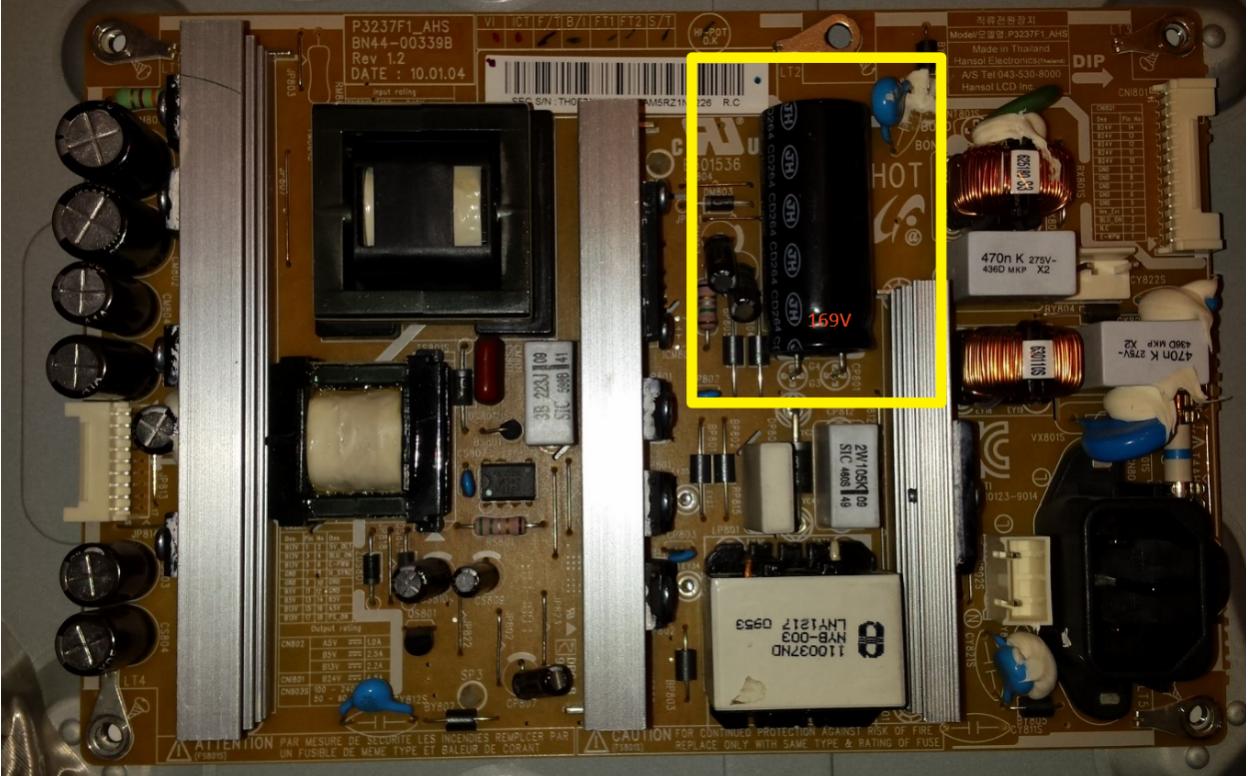

                  Please see the attached picture, I want to ensure "main filter cap" is what is referenced in the picture. Disregard text on the picture, I'll measure voltage again and verify those 3 items as requested.

                    That cap you circled is the main filter cap. If the PFC is working, you should have >360v DC there

                      Re: Samsung LN32C530F1FXZA No Power, No Standby Light
                      Wife's TV since 2010ish to present. No previous history of repair. I can't rule out power surge, but has been plugged into surge protector. All other electronics in the house work just fine. TV failure was a surprise to us, didn't show any signs beforehand.The only thing that may be worth mentioning is for the past 2 years we've had a Roku stick attached in the HDMI. This requires external power source. Plugged into same outlet.
                      That is the main filter cap, measure right between the two legs.
                        Thank you CapLeaker, found it OK

                        Setup 1: Main Board disconnected
                        Main Filter Cap - 390V, BL Voltages 24.2 V, and visually confirmed back lights on.
                        Setup 2: Main Board connected (immediately after Setup 1)
                        Main Filter Cap - Voltage dropped --2V / sec until reaching 169V. BL Voltages all 0, visually confirmed back lights off.

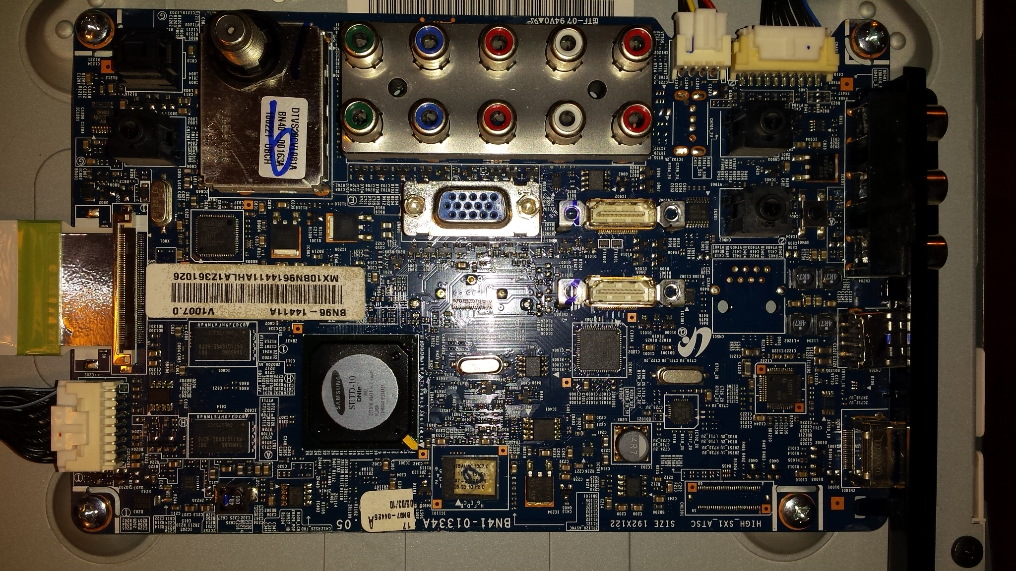

                          OK, the main board is not sending the PS-ON.
                            Bad main board then, common issue is corrupt epprom/firmware.

                              OK I see, thank you both for the guidance! Is there a way to test for a bad EPPROM?
                              I wouldn't know how to check firmware
                                you can try freezing it with a can of air upside down, then turn the TV on.
