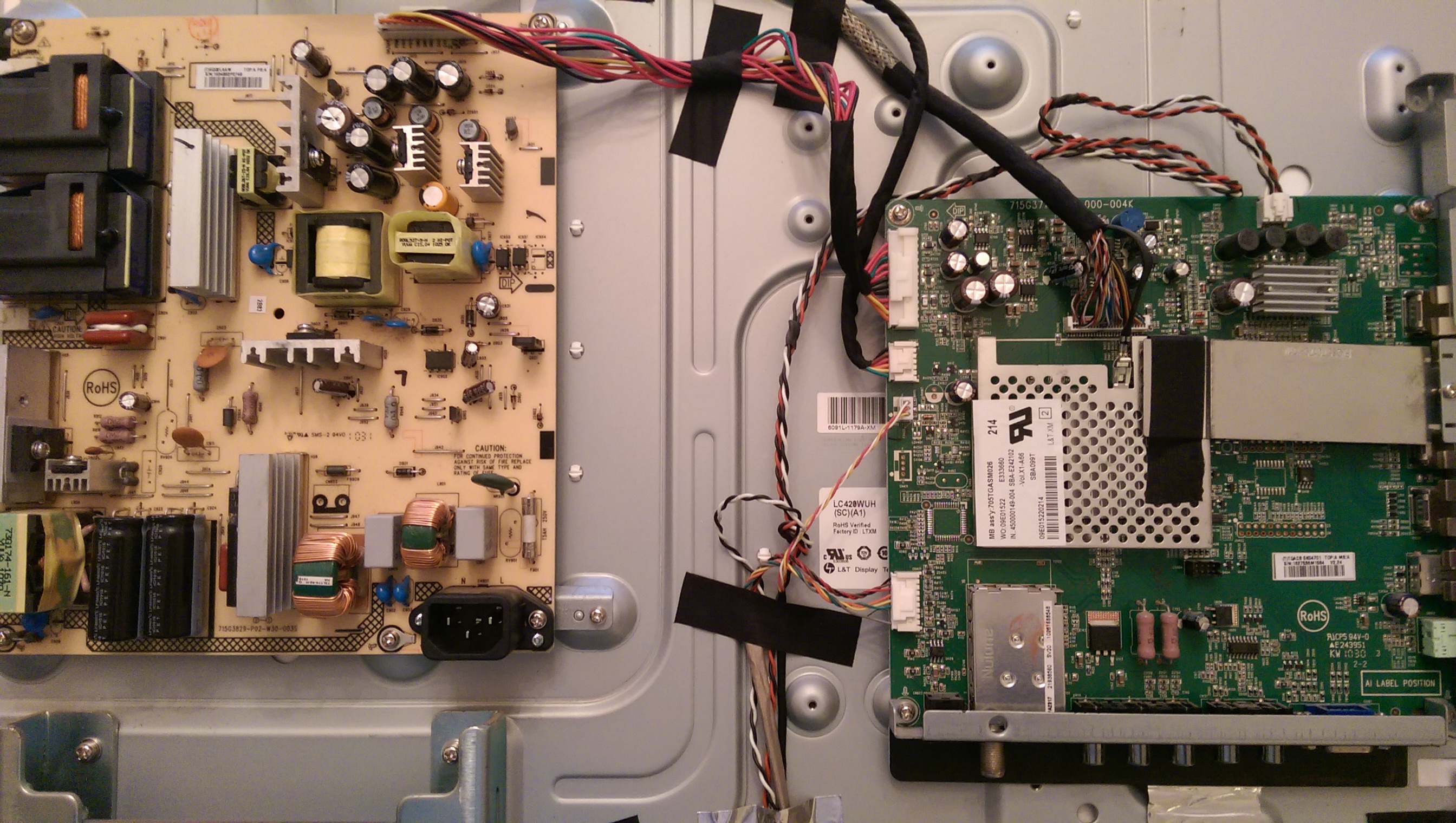

    No standby light. When testing voltages I find that the power supply puts out a good 5v when the logic board is disconnected. When it's reconnected the voltage drops to 2.7v. Would somebody please send me in the right direction to determine what may causing the voltage drop. Thanks again for your help.

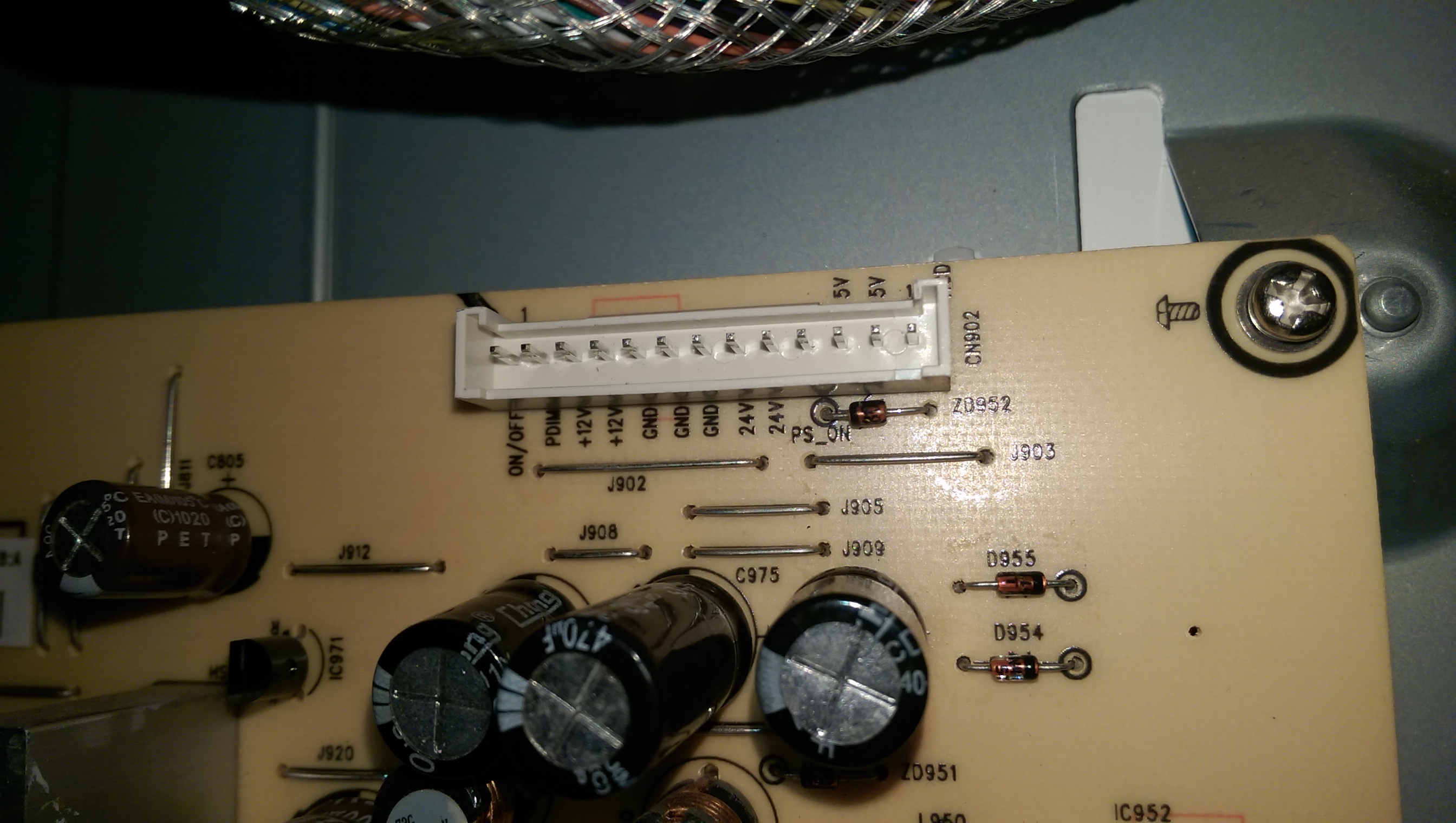

    What are the symbols alongside the top red connector, from left to right?

      Re: Vizio E421VA No picture
      See photo
        Disconnect the power supply from the main board and power up. Hopefully the +5V will come up as you indicate in your initial post. If it does and while still disconnected from the main board use a 1K resistor from +5V to PS ON and then measure the 12, 24V supplies.
          Well, that's interesting. When I ran 5v to PS-ON the 12v & 24v terminals showed 2v and 4v volts.
            What voltage is on PS On before you connect +5V to it?
              The PS-ON has no voltage. Only the two 5v show anything. OK, I think I did it incorrectly. 5v to PS-On now gives me 12v and 24v.
                I did mean the PS_ON Pin. So it's 0v before you connect the 5V with 1K resistor which is fine. Try a 470 Ohm resistor or there about and see if that makes any difference.
                When disconnected as described above if neither the 12V & 24V come up then you appear to have a power supply fault.

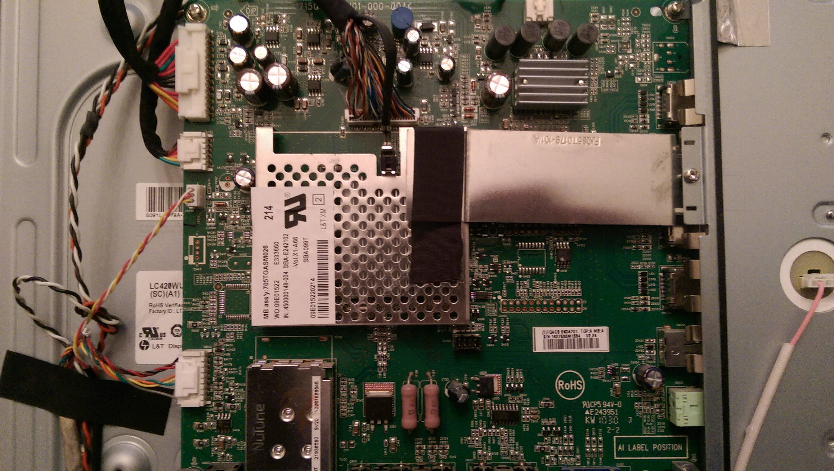

                    Look on the main board for IC regulators. The chances are that one of them has failed. Perhaps you could post a sharp image of the main board so we can see the components.
                    • rod30
                      • Feb 2016
                      • 33

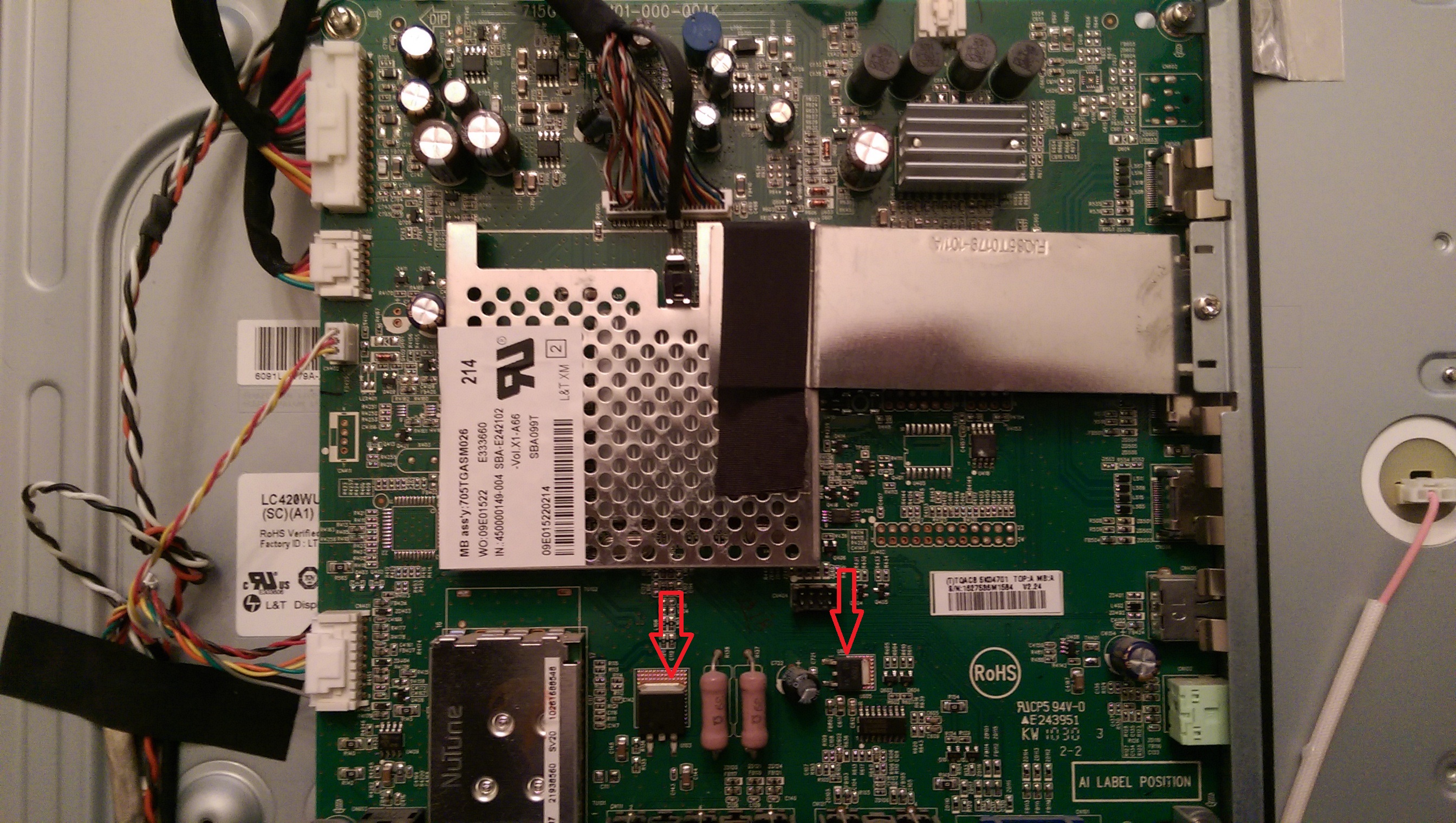

                      Let me know it this is OK. If not I will do it again.
                        What's the number on top starting 715G-xxxxx
                        Any of the 3 pin devices marked as Uxx
                        • rod30
                          • Feb 2016
                          • 33
                          715g3715-m01-000-004k
                            I cannot make out the components on the picture but can see what appears to be two of the larger regulators as marked on the photo. There may be some 1117 regulators or similar which are also on the board that would need to be checked. Any capacitors with swollen top caps?
                            • rod30
                              • Feb 2016
                              • 33
                              The caps appear to be OK. In the past I have found a few that look good but were not. My next step was going to be to remove and test them. I have never attempted to replace an IC regulator.
                                diagnose by dick_barton correct ... to be more sure disconnect the load of the Regulator, plug out the socket which go from main board to IR board. and check for 3.3 V and check the 5V go down.
                                • dick_barton
                                  • Aug 2015
                                  • 6643
                                  • Wales
                                  There's something pulling down the 5V supply and it could be one of the regulators because it's not quite a short circuit. As Diah suggests they probably obtain the 3.3V from the 5V via one of the regulators.
                                  • rod30
                                    • Feb 2016
                                    • 33
                                    I have remove all the cables from the main board and the voltage is still at 2.7v. Something on the main board is pulling down the voltage. At this point I will try to find a replacement board. I appreciate your time and effort going thru this with me. Sometimes they show up on Ebay and shopjimmy does have them. Do you know of other places I get a used one?
