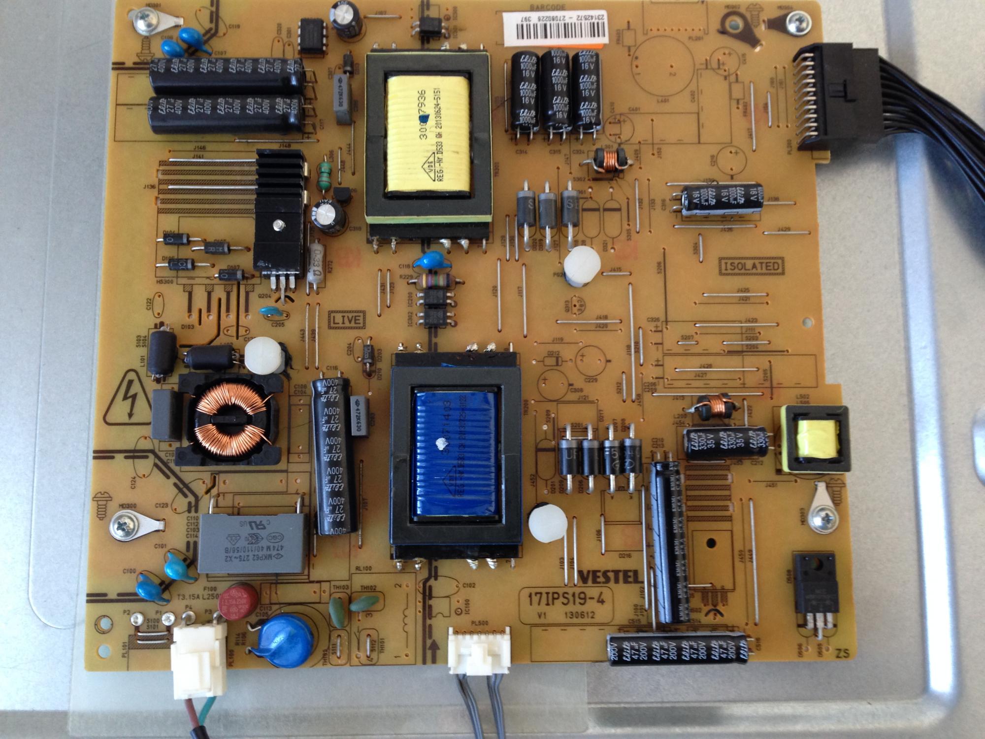

    just got hold of this and was told working but the screen is flashing,
    great, i thought,dead led causing the problem, well it turns out after removing the screen it is bottom lit with LED'S, i've put a video up on youtube https://www.youtube.com/watch?v=P_y-TTOpEU4
    so you can see what happens,
    checked the normal diodes and mosfet, but all are fine, anyone got any ideas,
    voltage from the power board to LED's seem stable ?

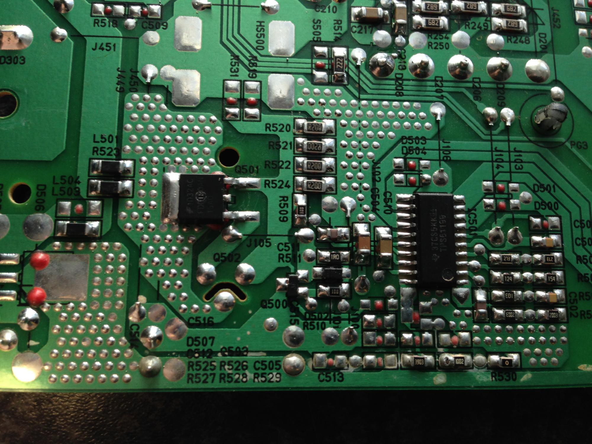

    Check the 4 string driver IC MP3394S and 14N25 fet on rear of the power board. most common parts that fail on the LED side of this board

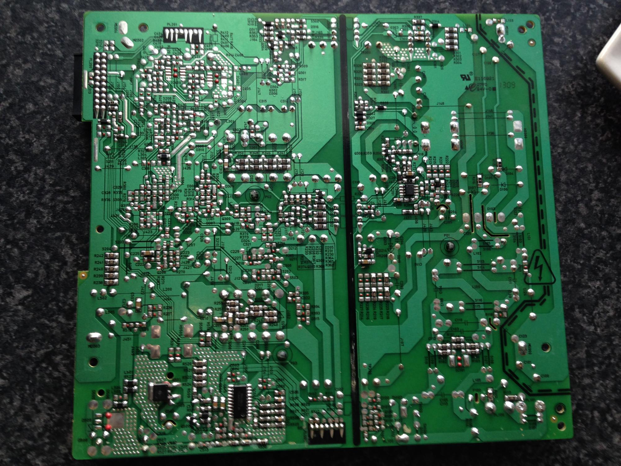

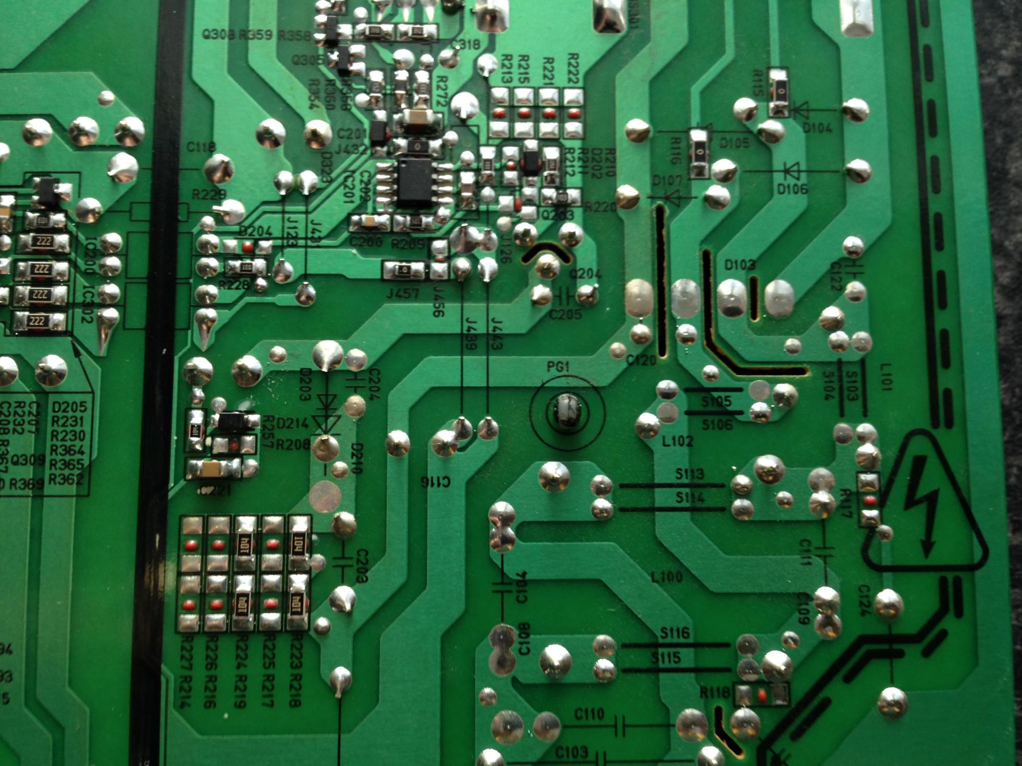

      Any pictures of the bottom side of the power supply-LED driver board?

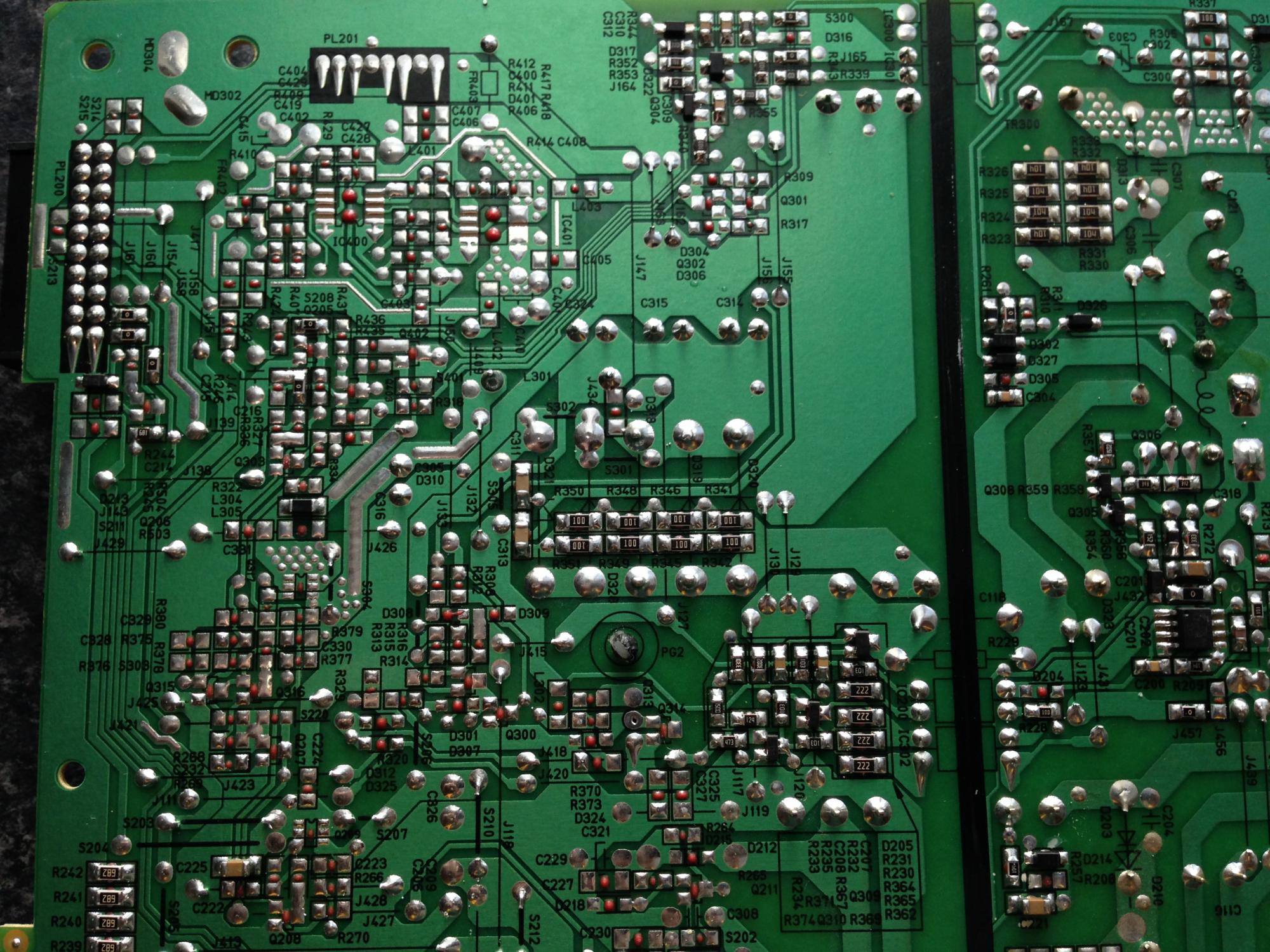

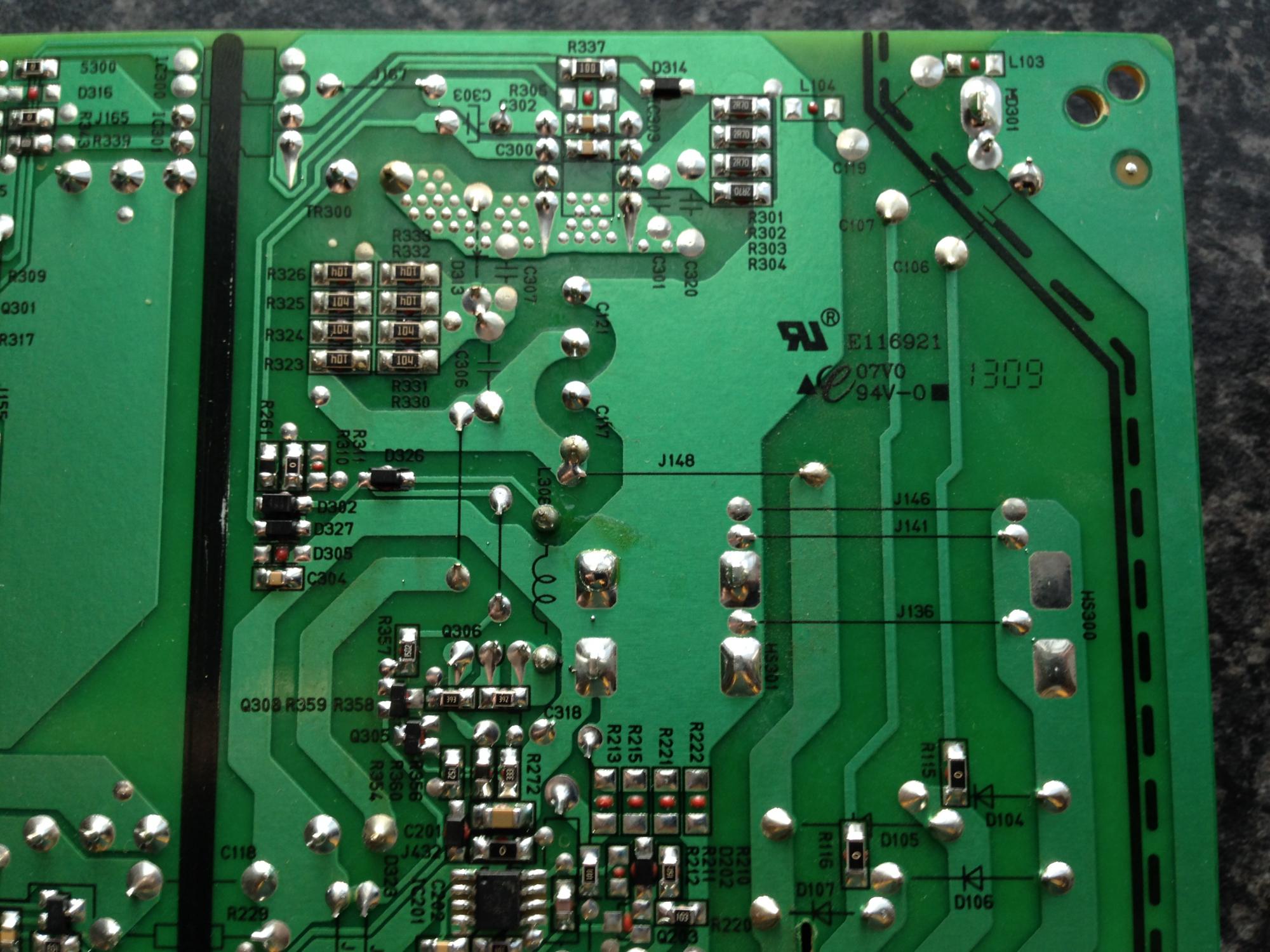

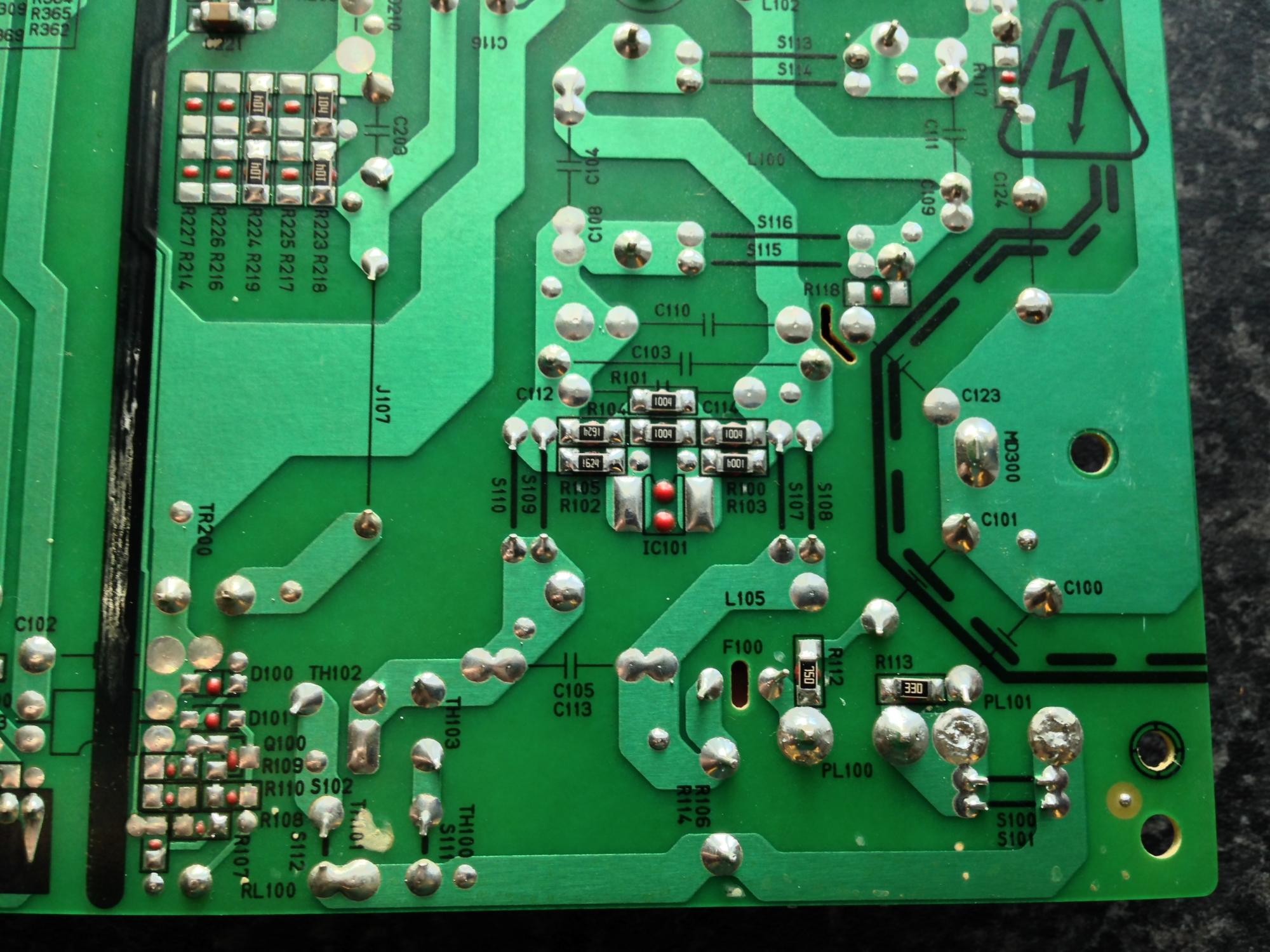

        Re: BUSH LED40127FHDCNTD, flashing LED'S
        bottom of board as asked for.
        fet test ok, no shorts, but the big IC, if thats the one your talking about, then i have no idea how to test.

          Data sheet may be able to help you diagnose the chip.

            So the Boosted Voltage at the LED connector PL500 pin 1 and 5 steady?
            And the Dimming control signal at connector PL201 pin 2 is also steady? Same for BL_ON/OFF pin 1? Same for +24V?

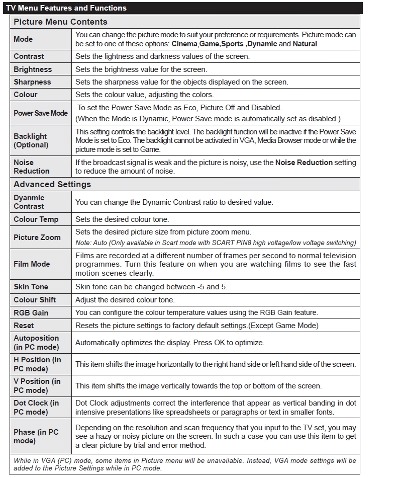

              right, just been messing with the picture settings in the menu, i have stopped it from flashing, i have turned ECO OFF and GAME mode on, this is the only setting that the LED's are not flashing, maybe this will give a better idea as to where the problem is, any other picture mode on the tv is flashing and darker with ECO OFF
                So if you reduce the backlights level to as low as possible, the LEDs will stop flashing in any mode?
                  cant find a backlight level ajustment ?
                    Intermittent Led within the strip not fucking easy to find Does the Bl go completely out after a min or two ?
                      It says OPTION so not sure what it really means for this model, is it greyed out?
                          This is a Vestel set so there is. Set the picture to "dynamic" then yoh can set the Bl to "low" doing this will turn off any other adjustments for the Bl on these sets.
                            its ok, got it, because it was on game, the backlight was on auto, and could not be changed,
                            so this is what i now have, with backlights on full, i have 3 modes that are fine, GAME, SPORT, DYNAMIC,
                            other modes still flash,
                            setting the backlight to any lower setting it all goes back to flashing, so where is the problem,? Mainboard ? or the IC on the power board ?

                                I would say the Ic that sends the Pwm signals to the Led boost mosfet is failing. Its on the power board and im also sure its a common failure on these boards too. Wait and see what others think.
