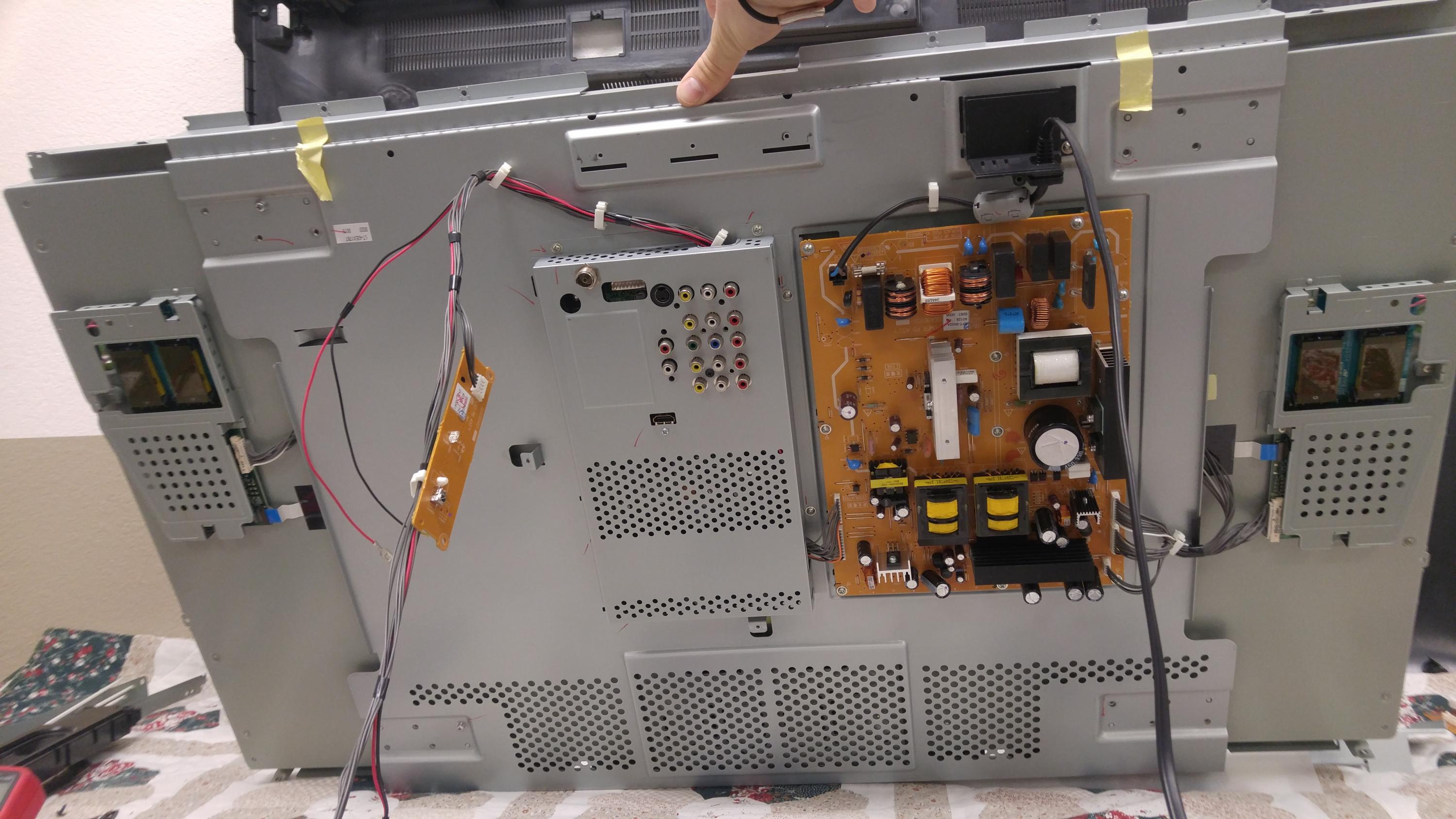

          anyway, here are pictures of the JVC CCFL's and the back of the panel.

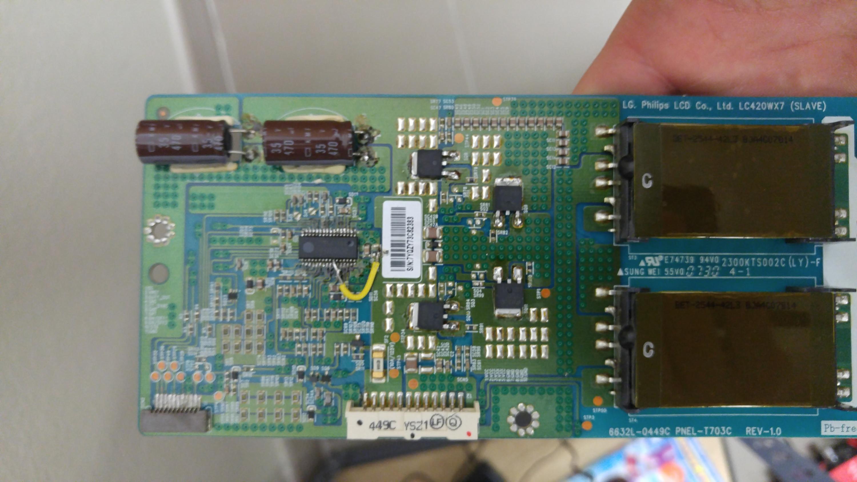

          The board I supposedly fixed is part number 6632L-0449C
          See attached pictures for CCFL's and the back of the panel.

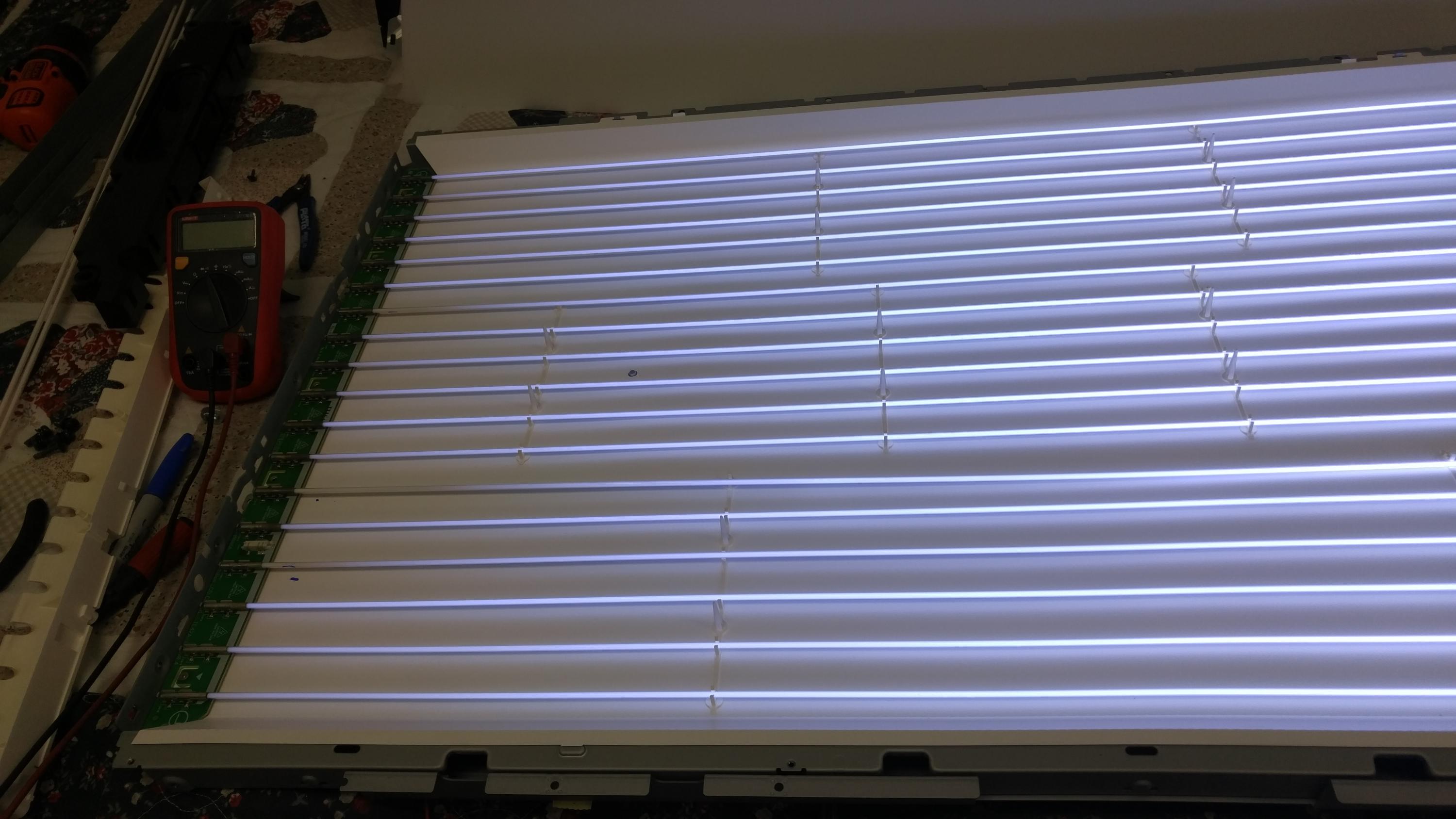

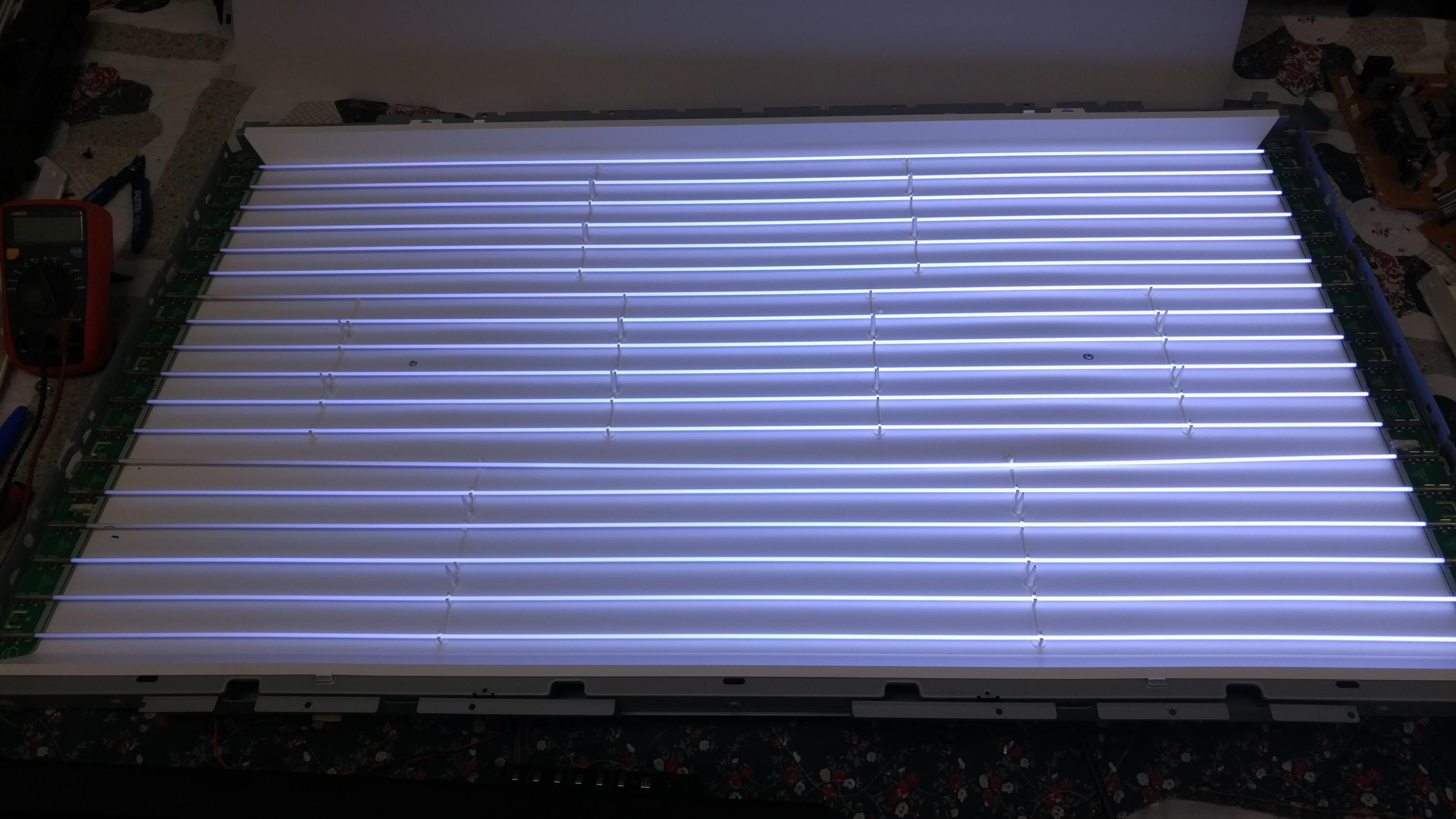

            I see that some of the lamps do not light up the same as the others, and the lamps look to be EEFL type.
            https://www.badcaps.net/forum/attach...7&d=1457368574
            #6 (counting from the bottom looks strange, sagging lamp?
            You can also try disconnecting the power to the Slave inverter to see if you will see the same symptom.

              #6 from bottom is my fault, I didn't place it back in the plastic holder in the middle properly. Does the fact that they are EEFL vs CCFL's affects the set in any way?
              Disconnected the slave power but left the ribbon and the backlight stayed on. Now the lamps are just pretty much all off equally on the left side and are off for a solid third of the set.
              So does that pretty much guarantee that the inverter was not entirely fixed and still has a fault? Or could this still be caused because of another fault?
              On the slave inverter, I replaced the large/long IC since it appeared physically damaged from burning out. The copper trace also burnt out and since the trace goes under the IC, I had to bridge it over the IC with a wire. The diodes all checked out ok, so I didn't replace them at first. When the set started acting up as it is, I decided to replace them as well but obviously that didn't make a difference.
              Could the transformers be bad?
              Pics will be added in 2 minutes

                  Usually when that IC goes out it will take the 4 Power MOSFET along with it.
                    Re: LT-42EX17 LCD backlight issue
                    I did replace those without a difference, and I do get 24 volts now going out of those to the transformer.
