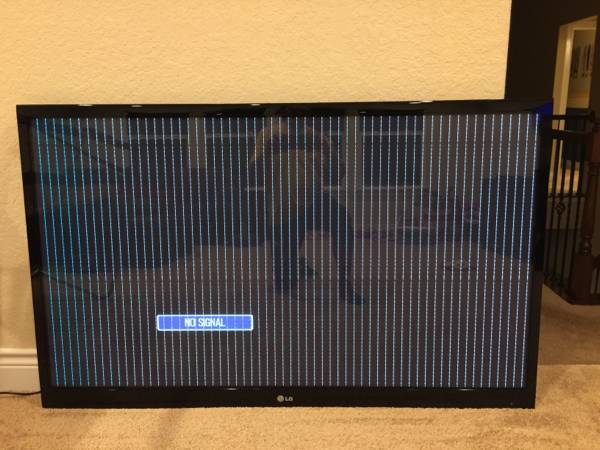

    Lg 60pk550 lines, then half screen blackout issue
    I got this for a deal. It came with vertical white lines across the screen, evenly spaced i would say maybe 1.5 in between them. The lines appear to have orbiting pixels of mainly white but seem to also contain a little occasional confetti of color i think is what I see.
  • Diah
    • Feb 2013
    • 6590
    Re: Lg 60pk550 lines, then half screen blackout issue
    put signal and take photo

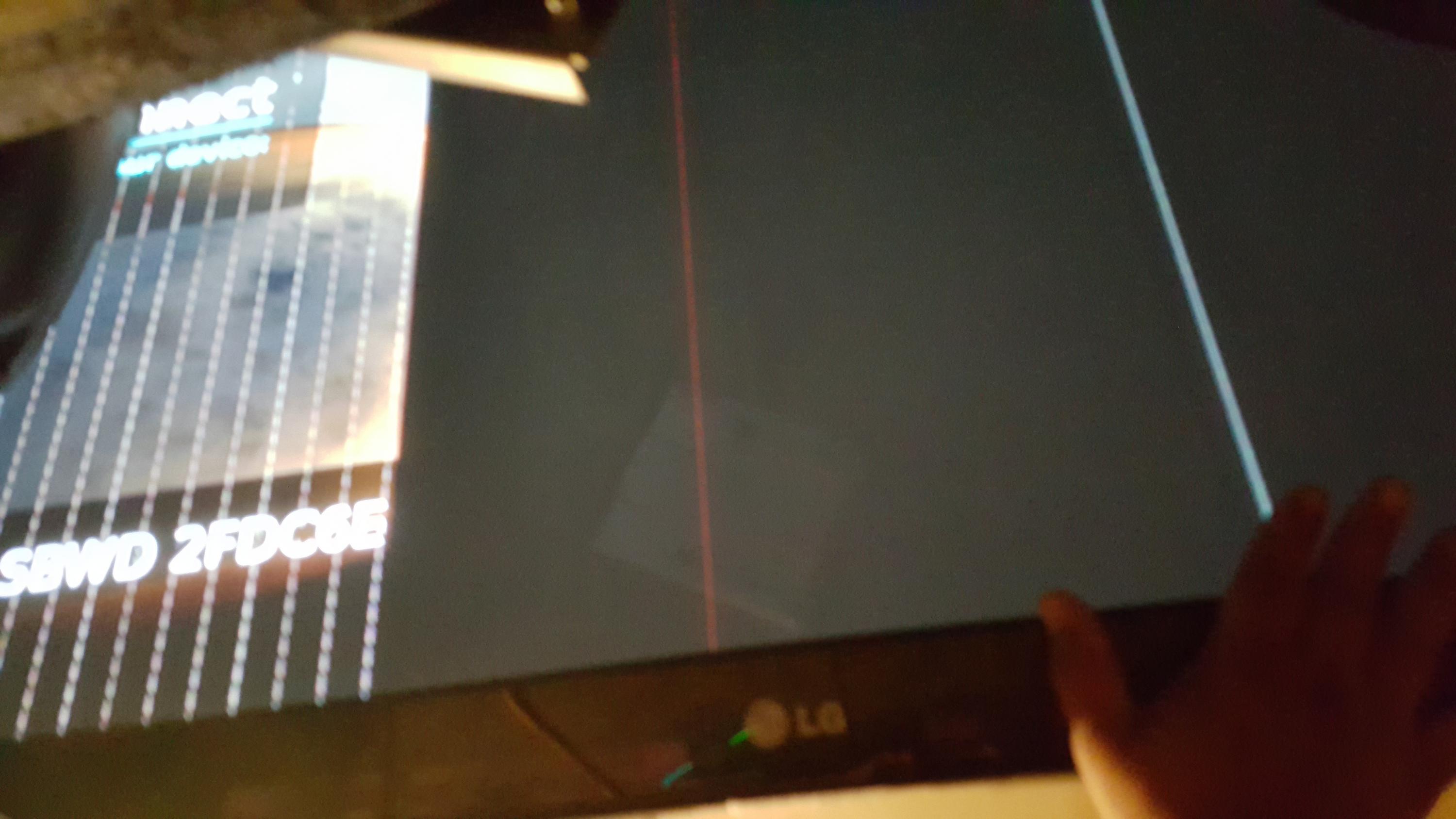

        Well--All it needed before was a Control-Board....
        But Now--After it let the smoke out--who knows!
        Sounds like you killed the COF chips on the pane, by running with no heatsink--and also the possibility of spiking them when disconnecting/reconnecting when there's a possibility of some voltage still present on the Va etc lines to them...
        --Need to leave set OFF for a full 10 minutes before re-connecting/disconnecting any Address-Chips of a Plasma set....
        The COF chips are part of the panel, therefore if damaged/killed is Unrepairable....
        Should NEVER run any set of any type without the heatsinks on the COF Address-Chips--They will self destruct due to overheat in a surprising short time.
            That side of the panel shows activity in the form of lit up black and a couple thin lines. Is that indicative is a dead cof chip? Ill post a pic tonight of its current state. Ill be ordering a control logic board if theres signd its not messed up.
              Alright, took a pic, but remeber its resting panel side down on a leather black chair and i lifted it up to take a pic, and the red line is in the center if 60in screen. The pop i heard was not loud at all, and i dont think it came from the board that is working. I dont believe i disconnected the x buffer boards with power on either. I had left the tv on for awhile hoping something would warm up and fix itself, but it didnt. I should have come here and asked first (kicks self).

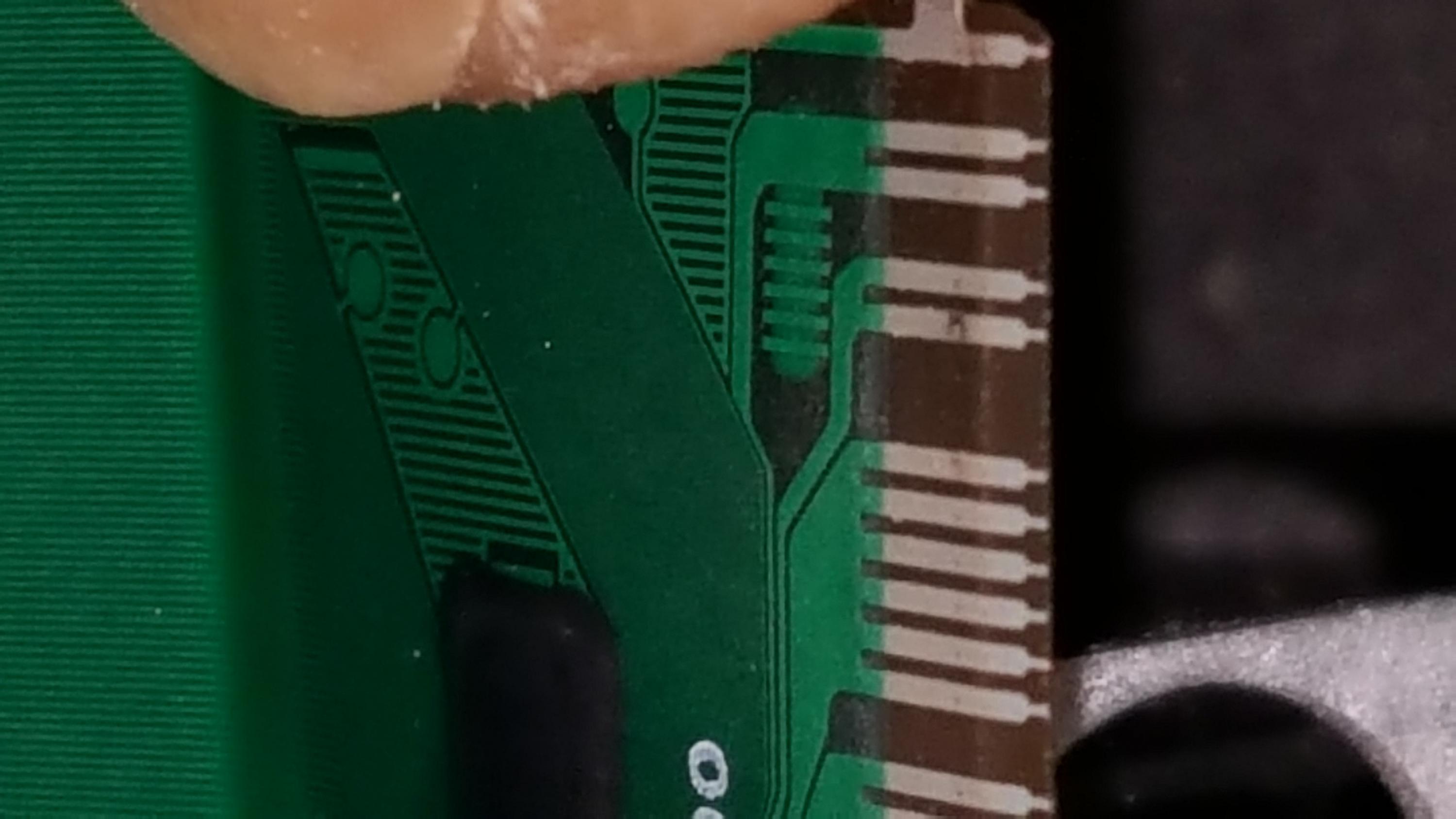

                        you need to take out the LG front cover ting to access to ribbon CNT cable to push them with finger to see if one caused this to panel.
                          Check the Data-Lines to the affected area of screen with Scope. Also check for supplies Va and 5V to the affected areas.
                          --Thats how you can confirm the COF Chip destruction.
                          COF chips are VERY EASY to damage. Never ever mess with 'em if there's no need, and there clearly wasn't in your first picture--It was a Control Board issue (Regular lines all over screen).
                          Y-SUS will Not cure this problem, only Panel Replacement will..

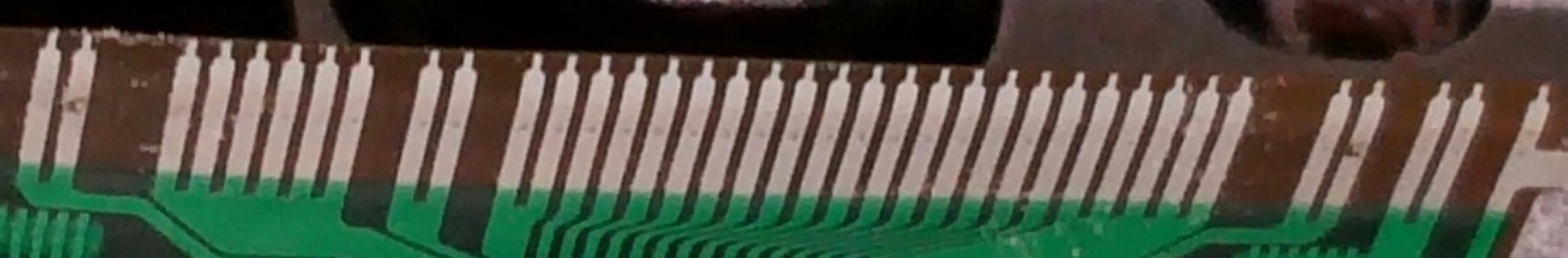

                                  I wonder if this is the culprit here.
                                  • mmartell
                                    • Oct 2013
                                    • 3189
                                    I can't make out those pics but if that's a burn mark under the cof then yes it toasted itself.
                                      It's ok, it's burnt for sure. There were scorch mark's on the "thermal paste?". I think I'm more bummed because i f"d up
