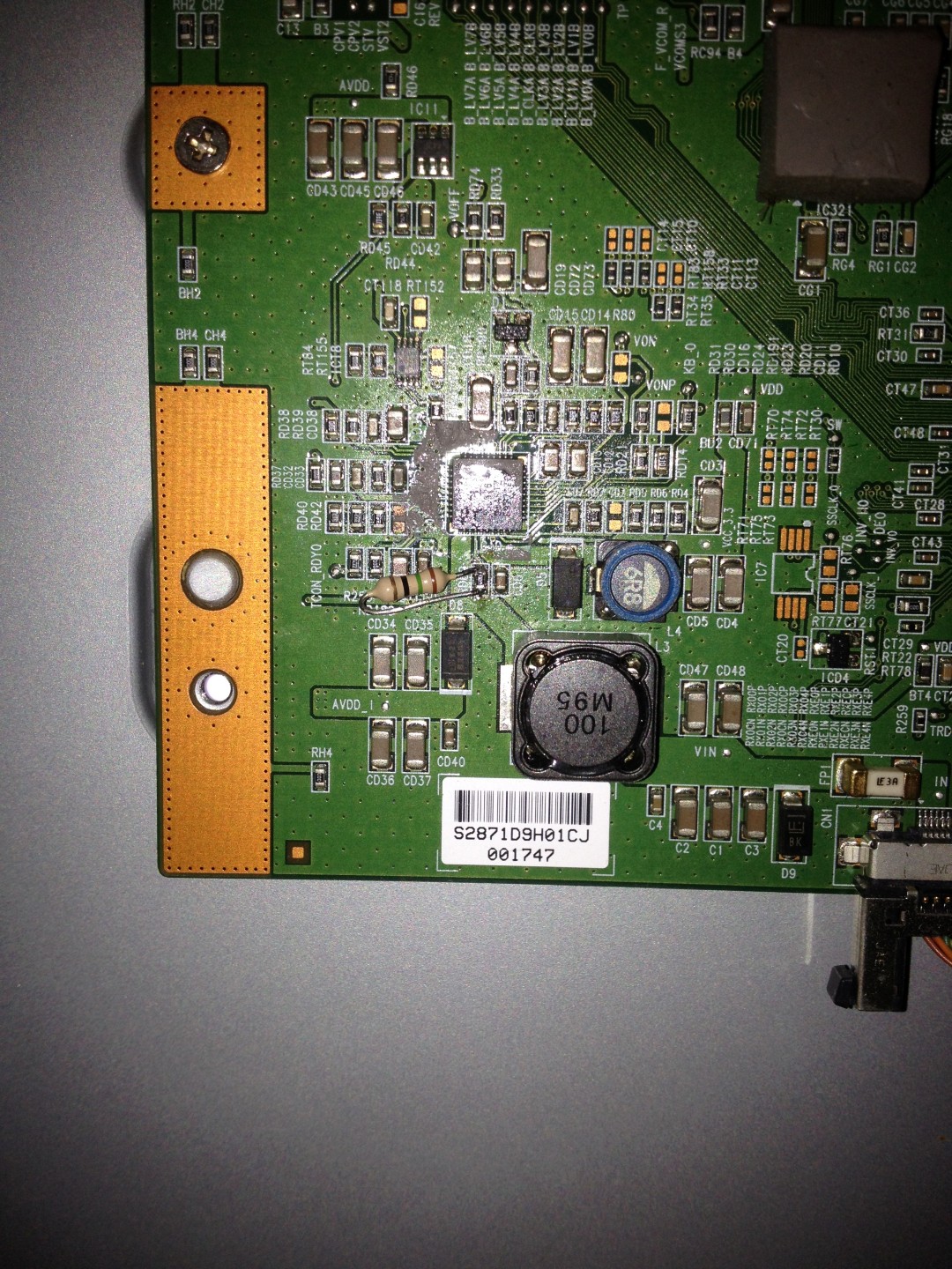

    Thought I share this for maybe future sony guy's.
    I have a KDl-52S5100 that would loose picture after 30 seconds,backlight would stay on,sound works,just no picture.
    Measuring around on t-con I found RD69 to be stable 4.5v on chip side,3.2v and dropping on other side.
    Soldered a 15 ohm on top of it and it brought voltage up to 8.2v stable.
    TV been on for 48hrs now.

    What is the P/N of that IC? It looks like multiple switching power supplies controller.
    Vin is fed into that inductor L3 and that resistor is connect to the output side of the inductor, it looks to be for making VDD_1.
    L4 is for VDD.
    If you can get the spec sheet of the IC then you can tell what the function of that resistor is.

      I've been looking for my magnifying glass without any luck. Wanted to read the numbers on that resistor aswell. I cant read the IC,my eyes are old.
      I was wondering if the value of the resistor is in direct control of the voltage produced.
      15 ohm was a total guess,it gave me the 8.2v I was looking for,lol.

        ISL97650ARTZ
        Could be 10 or 11 ohm going on the SJ images and versions I see. looks like 100 or 110?. I can make out the ARTZ in your shot.
        Could be pin 3, CB, Logic buck, boost strap pin
          Re: sony T-con repair
          The resistor RD69 (it does look like 110) is between pin 3 (Logic buck, boost strap pin) and pin1/2 (LX1/2 Internal boost connection)? Need verification, same for CD6.
          Per App notes Sch, the CB pin only has cap connected to it.
          What DCV do you at AVDD_I?

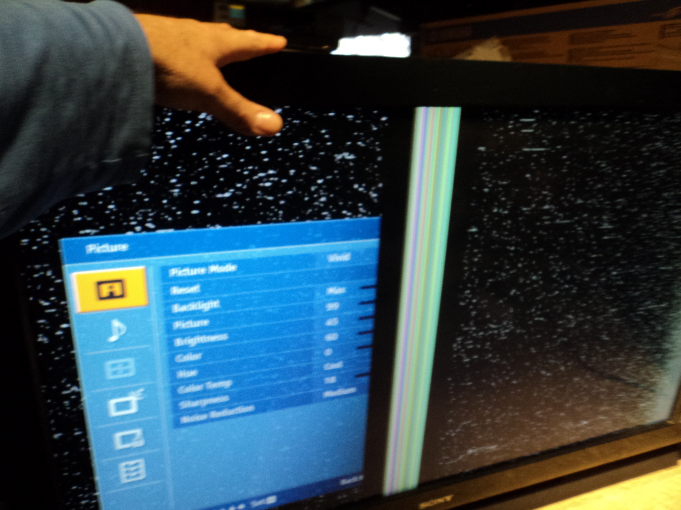

            Hi guys;Ok since the T-con board is the same of my KDL46S4100 i went to check RD69
            and i can reed clearly 110 =11 ohm correct me if i'm wrong.
            Also turned tv on and i only have 0.230v or so both sides.
            here some strange i just went back to the white FP1,and i get 11.6v on one side and on the other side i get about the same as RD69,is this normal?
              you just found the problem with your t con board !
              That fuse blew open,probably due to fatigue.
              Replace that fuse and you should be up and running

                Thanks maritino i will give it a try,can i use any other fuse or i have to use that specific white one, just to try if it works? thanks
                  You can use 3A fuse with lead wires and solder them to each end of the blown fuse to test.
