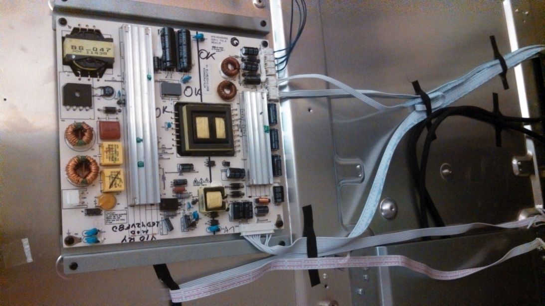

    Now, a year later, it wouldnt turn on again. This time rather than recap, I replaced the entire power supply board.
    It turns on but there is no longer any sound through the speakers. There is still sound through the headphone jack.

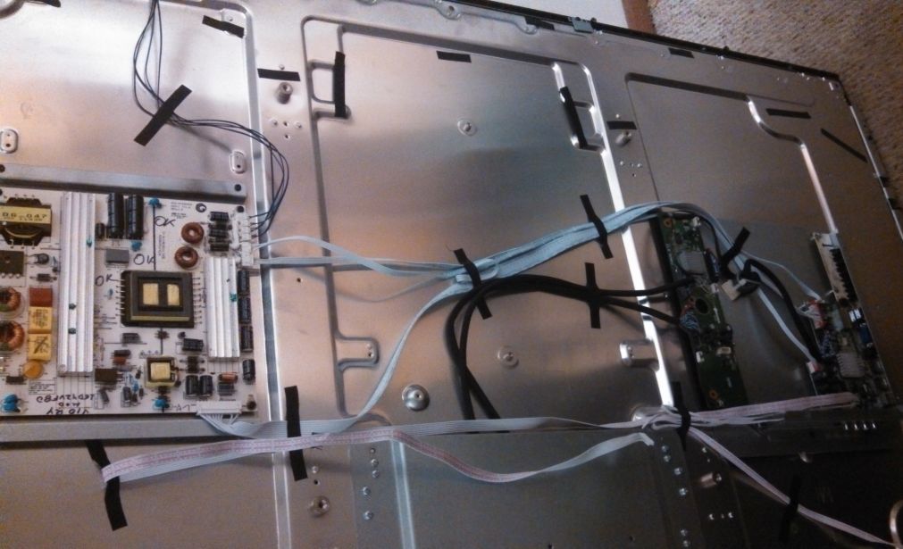

    Overview

      Replaced power supply

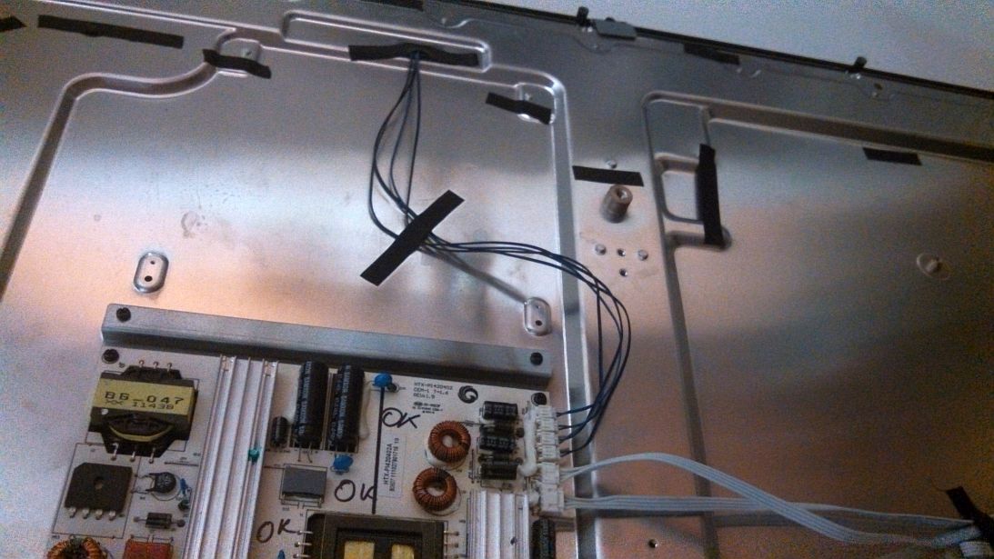

        Been trying to figure out what these blue leads go to

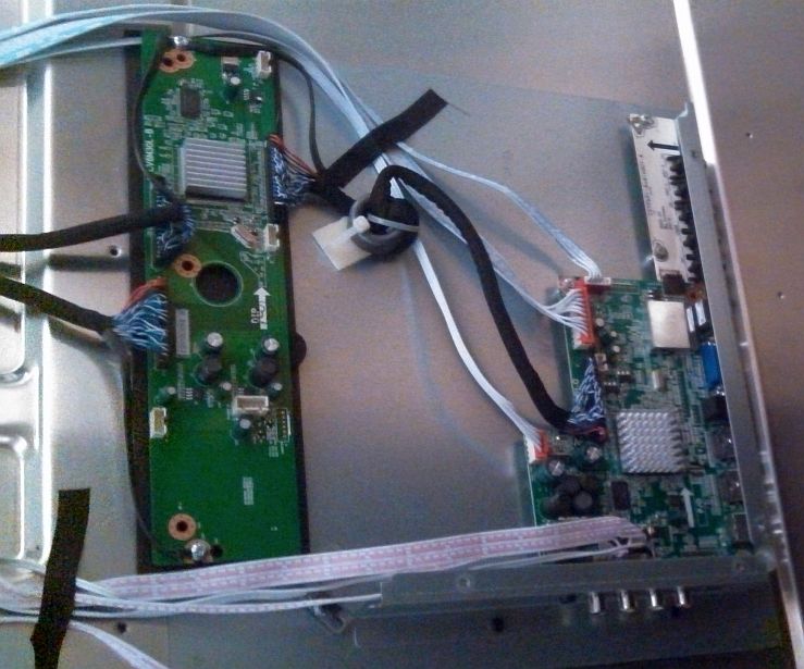

          The "amplifier board" and the adjacent board.

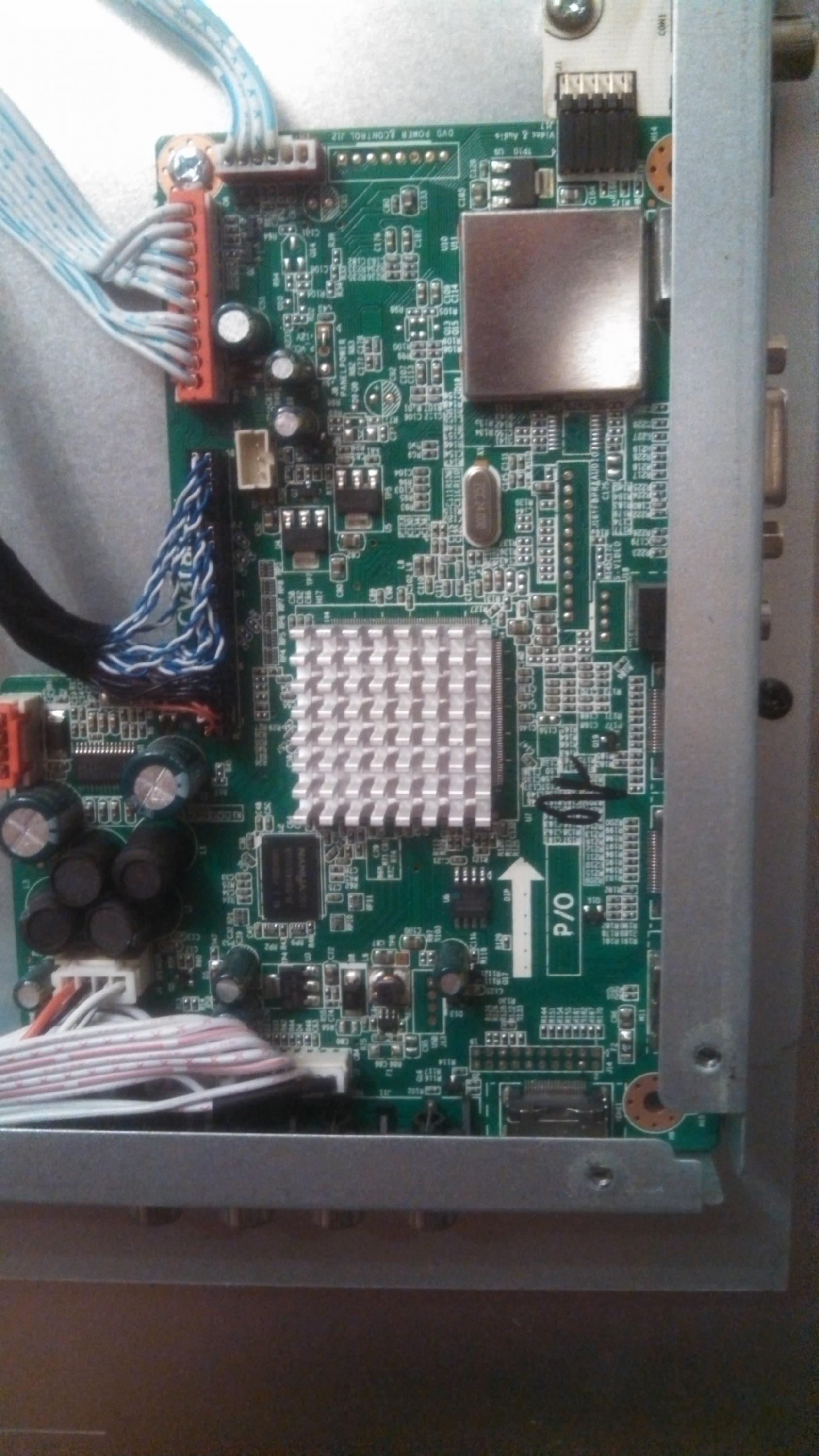

            The TCON (Timing Control) board is only for the LCD. Has nothing to do with the sound or picking up channels. On your last picture the board in the bottom right corner is your main board. That's where the trouble lies and the board you need. The leads that disappear deliver the power to the backlights behind the LCD panel.
            Now if your symptoms are the result by replacing the power supply, we would have to do some diagnosing first, before throwing parts at it. Post a nice straight shot, high res. picture of the main board, so we can see something.

              Re: Proscan PLED5529A Troubleshooting
              How's this?

                Try heating up the main board with a hair dryer and see what you get.

                  That is FRC (Frame Rate Coversion) PCBA.

                                Heated the main board with a hair dryer and reseated all the molex connectors. Now I have sound. The tuner does not work unless I stick a screwdriver where the broken coax jack was. Is there a way to replace only that part of the board, or is my only option to replace the entire main board?

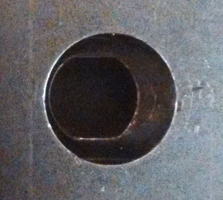

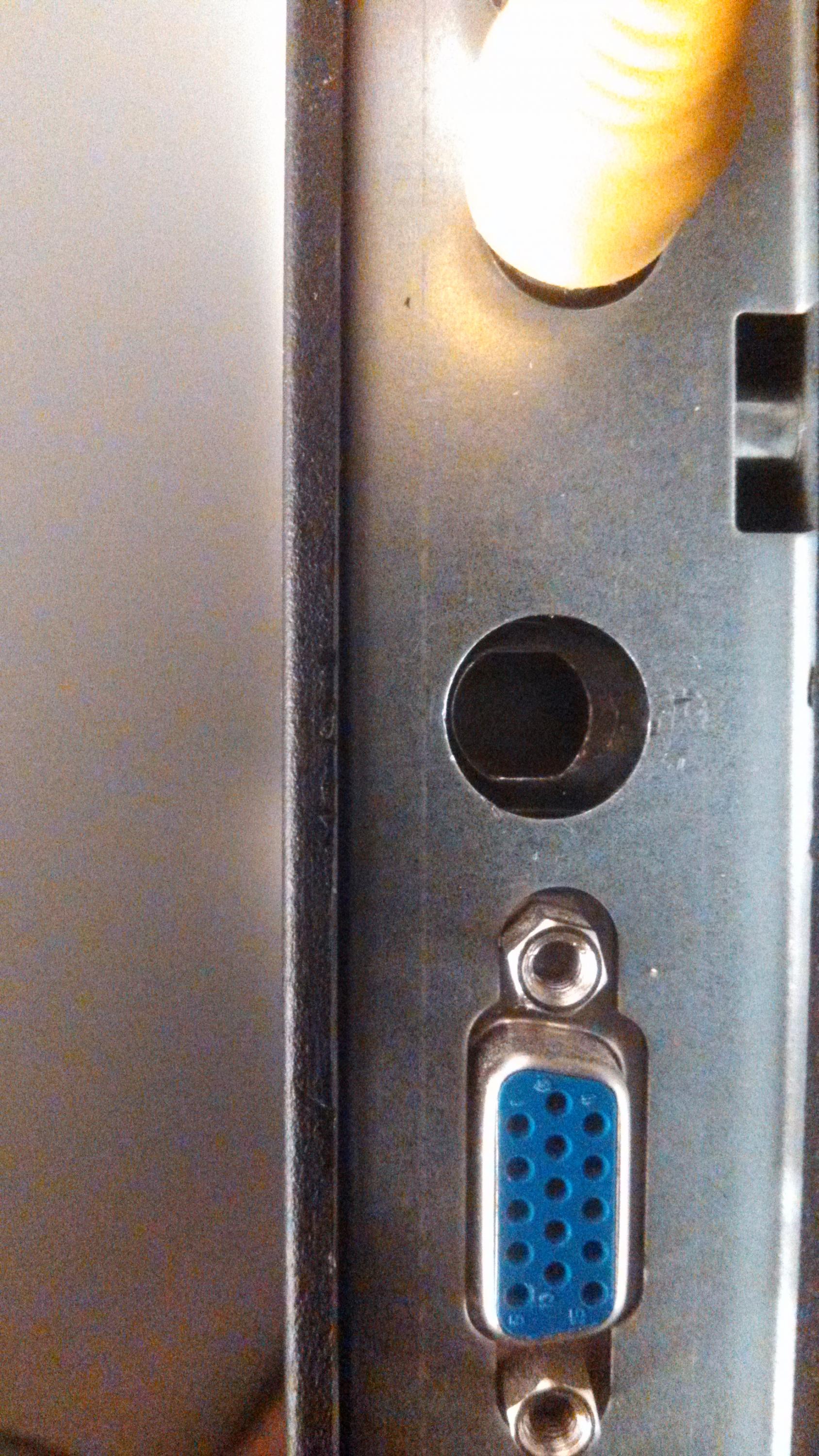

                                    It's more than just the coax jack, it's broken off inside the shielded case. I assume I'd have to replace whatever is inside the shielded case.
                                        Here's the best picture I can get.
