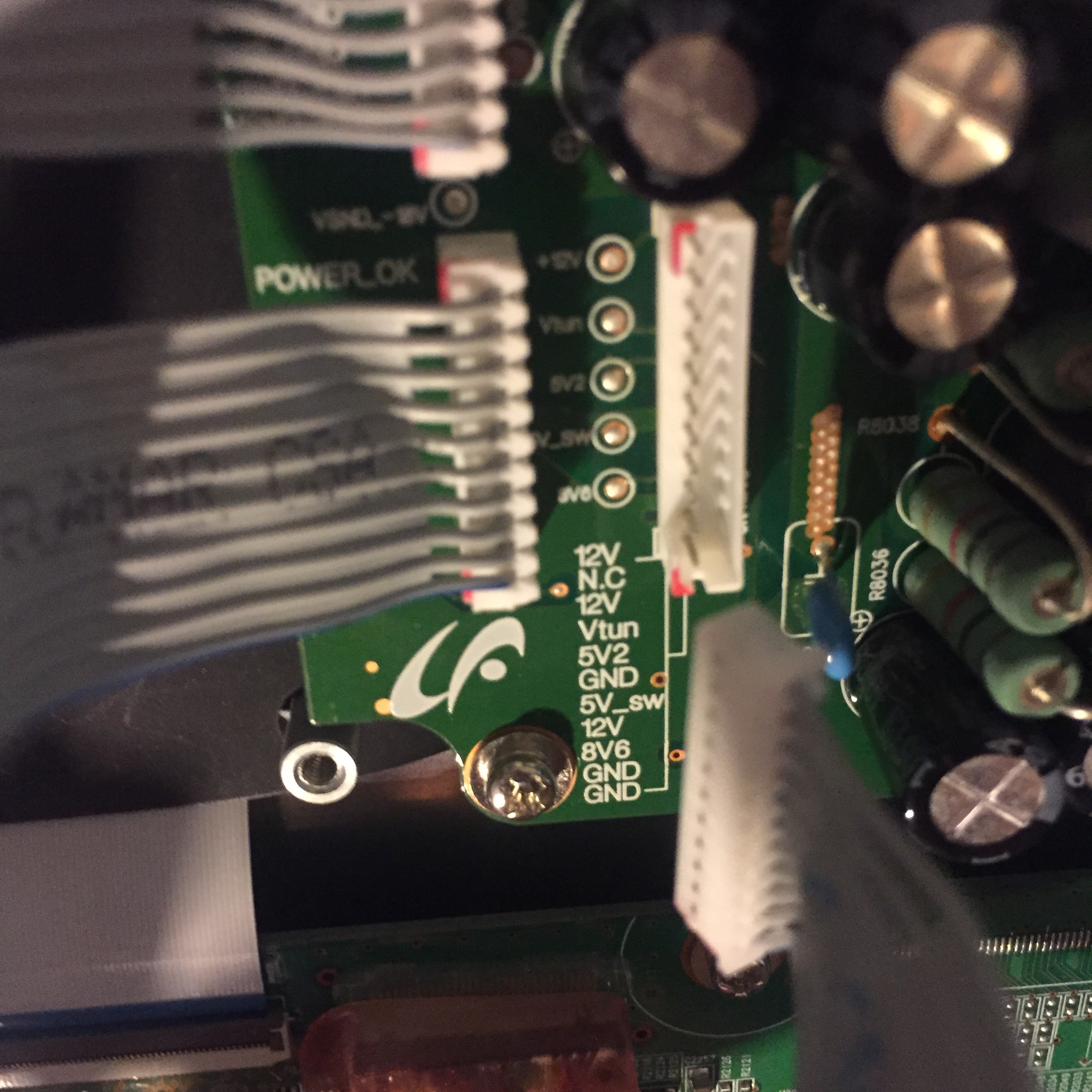

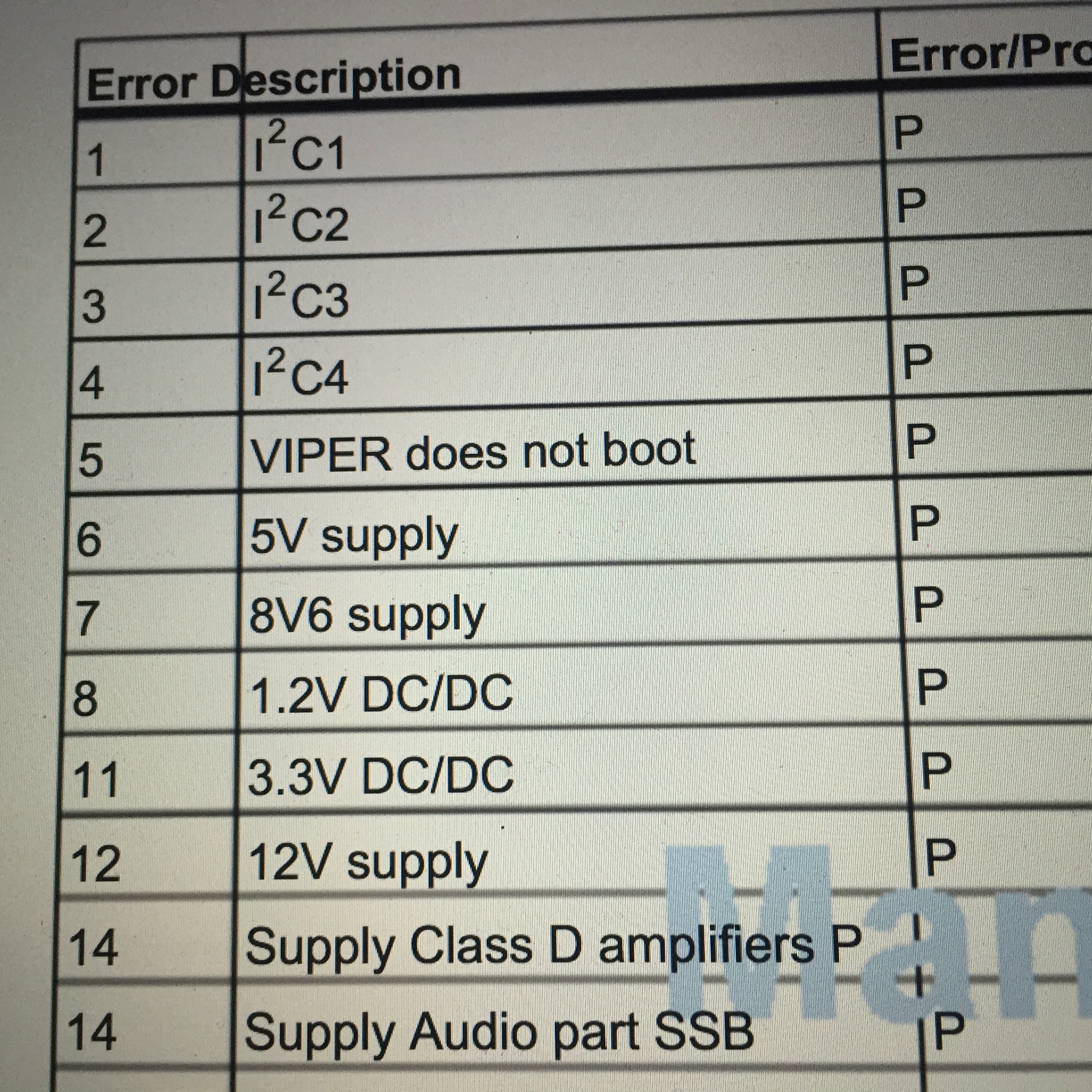

            Re: Philips 50" Plasma 50PF7220A/37 - Progress and Update
            Posting some new information here today and asking for help.
            I have not replaced any more caps yet on this PSU. Just the C8059 and C8060 from a few weeks ago. Still getting the 7 red blinks on front LED and 4 green blinks on the PSU itself (which is the DV3V code). Standby power is failing, apparently, and I've narrowed it down to three possibilities:
            1) The caps on the PSU (C8059, 8060, and/or others) are faulty.
            2) The logic board is not processing the DV3V voltage properly.
            or
            3) The SSB is faulty and prohibiting the set from powering up.
            My question is:
            If all of my essential initial voltages (meaning DV3V, DV5, 8V6, and all the others one might suspect) BEGIN TO RISE, but then never quite reach the levels they ought to be before rapidly falling off when the unit shuts itself down (about 2 to 3 seconds into it), is this more likely due to bad caps on the PSU or to a faulty Logic Board or a faulty SSB/Main?
            The key fact that leads me to think that it is NOT the PSU is that if I disconnect the C8006 connector from the bottom of the PSU that leads directly into the Logic Board, I no longer get the 4 green blinks on the PSU but I get 13 instead. And, whereas 4 green blinks indicates a DV3V problem, 13 green blinks indicates a DV5 issue. So, my reasoning is that the PSU is indeed attempting to generate the correct and necessary standby voltage (DV3V), but it cannot sustain it because the Logic Board or SSB fails to do its work. I would think if it were bad caps on the PSU that were the root cause of the problem, then I would get 4 green blinks on the PSU whether or not the connection to the Logic Board is made through this C8006 connector. Does that make sense?
            This, combined with the fact that the 7 red blinks on the front of the set appear to indicate an 8V6 problem (see attached pic), I am thinking that the problem lies within the SSB/Main unit because the PSU connects to the SSB/Main through connector 1M46 (see other pic) and that is the only connector that has the 8V6 labeling on it.
            If I try to replace all the small caps (about a dozen) on this PSU, I feel like I am likely to do more damage than good. They are difficult to desolder correctly as it is a double-sided board with through-hole connectivity being imperative.
            The DV3V voltage only rises to 2.2, and no higher. This seems to be the crux of the problem as the 4 green flashing LED light on the PSU itself indicates exactly the same according to its Alarm Code labeling (i.e., DV3V). I have run a lot of voltage tests on every connector, and can provide those numbers in response to anyone who replies and wants to know how those look.

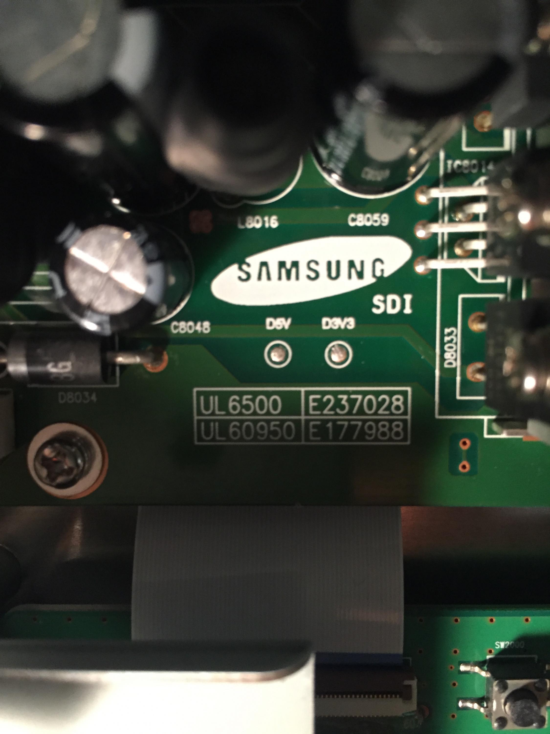

              More proof that the PSU (Power Supply Unit) is not the issue, or at least the primary issue:
              Extensive testing using the DV3V test pin found under the capacitor labeled C8059 (see pic attached below) on the PSU revealed the following:
              1. D3V3 voltage rises to 3.3v if the Logic Board is disconnected from the PSU.
              2. D3V3 voltage rises to ONLY 2.2v if the Logic Board is connected back again to the PSU.
              3. DV3V voltage rises to ONLY 2.2v if the Logic Board is connected to the PSU, and the Logic Board is disconnected from the SSB/Main.
              This appears to indicate that the Logic Board may be faulty. Or, ... because I am getting 7 red blinks on the front LED (indicating an 8V6 error), it may simply be that the SSB needs to be replaced (see my previous post for more pertinent info here.) before the D3V3 voltages will process properly within the structure of the Logic Board.
              So, my plan is to do the following:
              First, replace the SSB only and see if that resolves all of the issues.
              Second, if the new SSB fixes the 8v6 problem (i.e., no more 7 blinks), but the DV3V problem persists (as probably then indicated by 11 flashing red lights on the front panel of the set (see Error Code pic again), then I may have to replace the Logic Board as well.
              After that, I will return to the idea that one or more caps might be bad in the PSU. Or, follow in the direction that any new error code information reveals to me.
              So, all Badcappers.net Agents of Advice and Wisdom out there ....
              Does this sound like the best and most logical plan of action?
