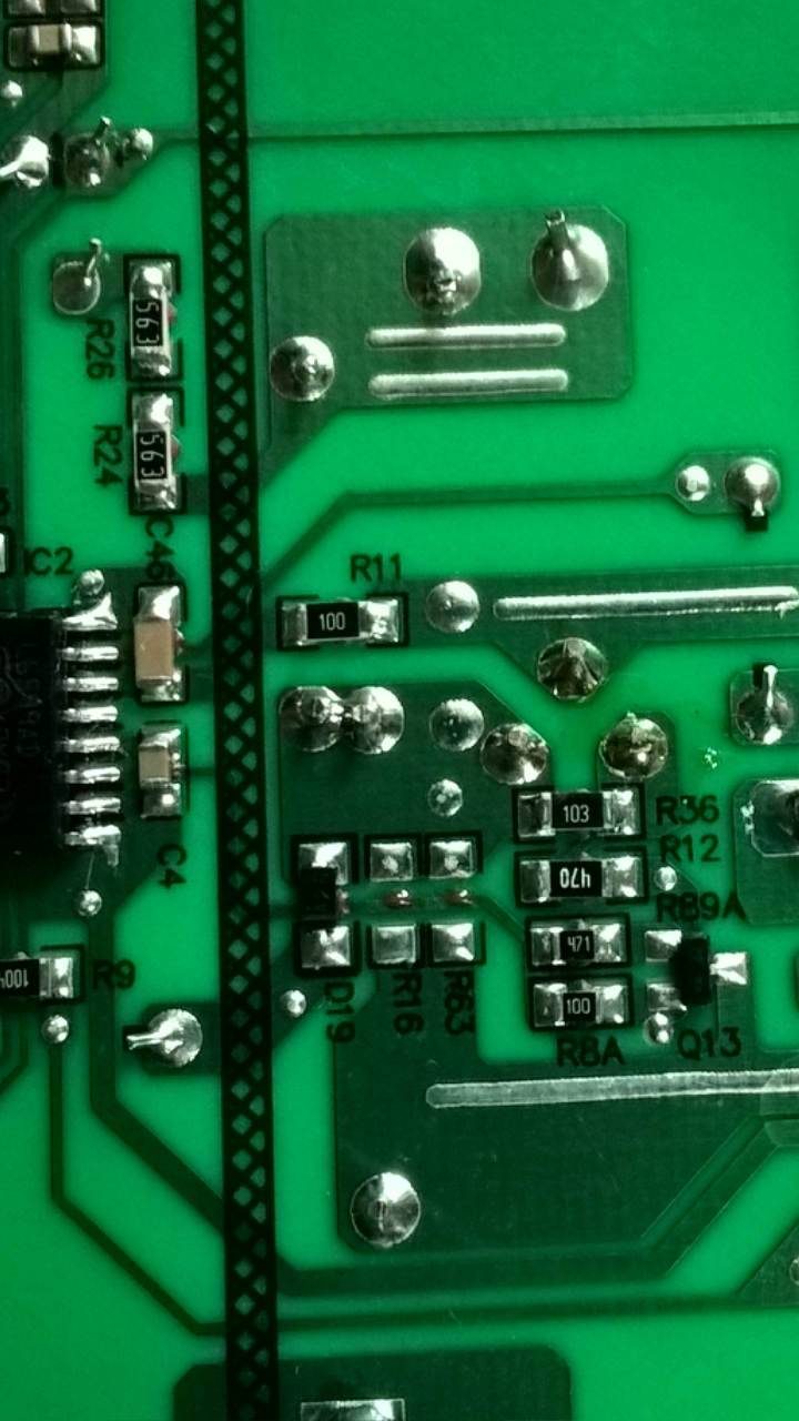

    Originally posted by x_orange90_x
    Your tracing appears correct. I checked resistance between the resistor 000 and pin 12, from 000 to both sides of C4, and also from the incoming side of 000 to both ends of C4 and to pin 12. I get a reading of 1 with all of them, however a couple of times i had it bounce all around from 70.0 and below when checking the incoming side of 000 to the outgoing side of C4.
    "from 000 to both sides of C4" what kind of resistance it showing on the meter 0 Ohms to both side of C4?
    We need to know if the resistance is in OHM, K OHM , or M OHM.
    Since you have 12V at BOTH end of that '000' OHMS resistor and it has connection to pin 12 of the IC then it is impossible to get 0.28V as you report earlier. You have to think logically at this point when it does not make sense based on your DATA, or error in your measurement. Point 'A' has 12V and is connected DIRECTLY to point 'B' so it is impposible not to have 12v at point 'B'.

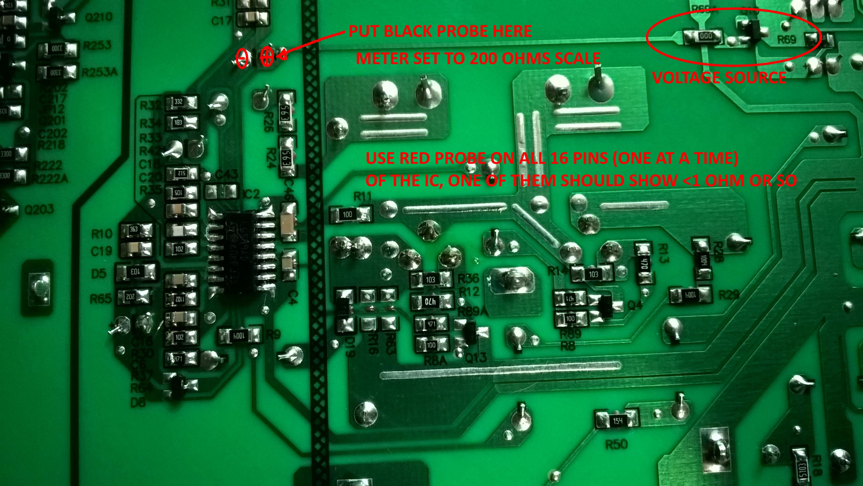

                #107
                Re: Rca led50b45rq
                Stay with 200 Ohm scale, we need to see <1 Ohms or so resistance when tracing the direct connection between point 'A' and point 'B'.
                We need to find out what that end of 000 resistor is connected to.

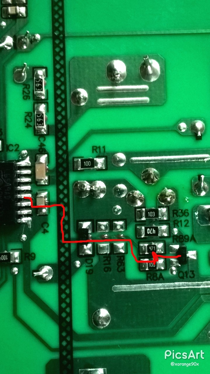

                  We need to find out what that end of 000 resistor is connected to. That VCC pin 12 of that IC should have direct connection to Emitter/or Collector of the switched transistor some where on the board, just a matter of finding it.
                  Check out the attached pictures and let me know what you think.

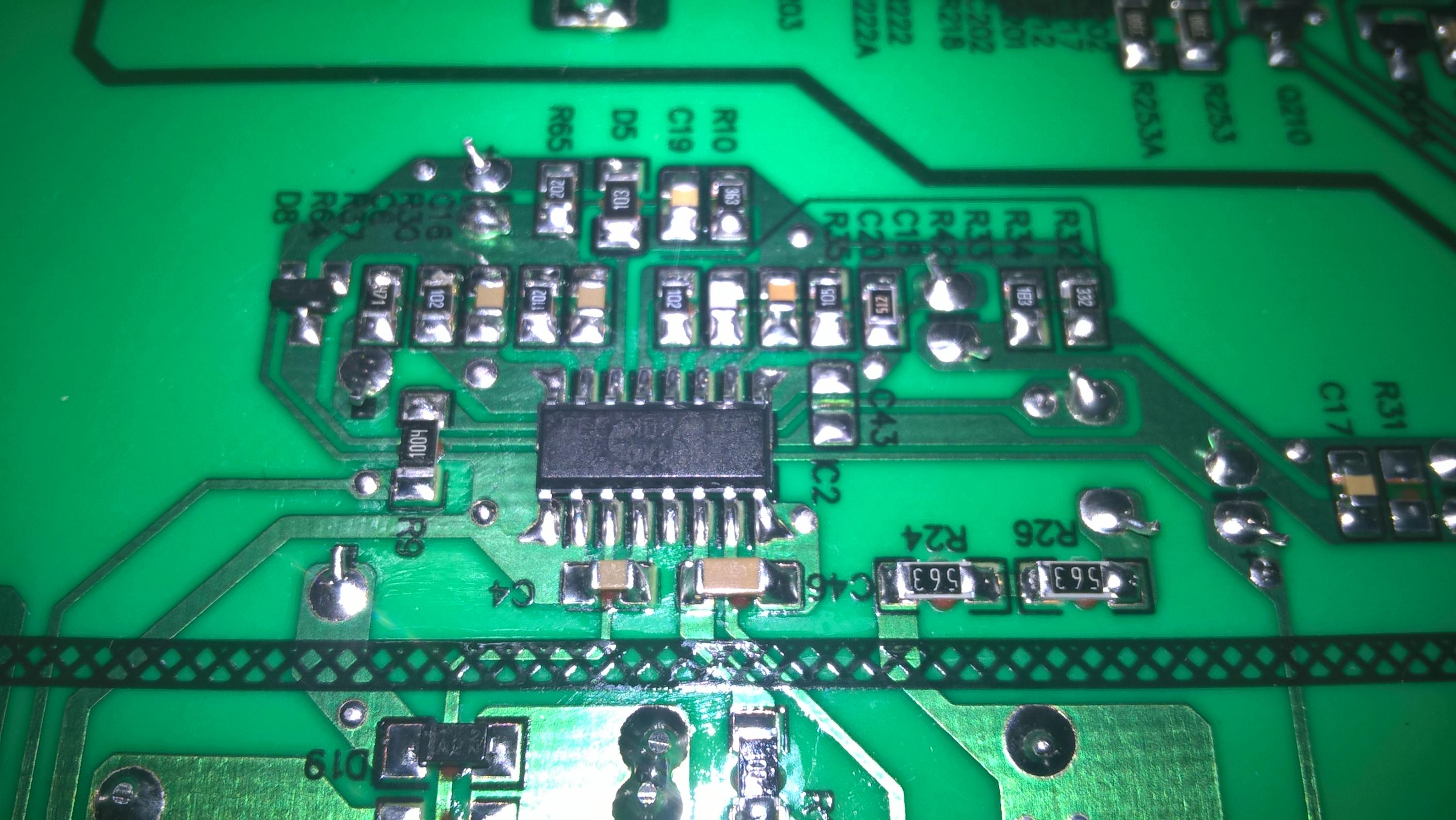

                    #109
                    Re: Rca led50b45rq
                    https://www.badcaps.net/forum/attach...0&d=1491216069
                    So pin 12 goes to the EMITTER of Q13? That section is for the current sensing of the for the Power MOSFET that drives the transformer.
                    I think you need to find out which pin of the IC is connected to the 0 Ohms resistor, I can only see the trace going the IC but cannot tell unless you Ohm it out..

                      I shared that picture and tracing with you because it *looked* as though it may go that route. I can clearly see a trace going under C4 and over to Q13.. But i don't really know what I'm looking at. That's why i wanted to share it with you. The P/N is L6599AD. I downloaded the Spec sheet for it in order to get the Pin-out.
                        #111
                        Re: Rca led50b45rq
                        At this point I would put one probe on the 000 resistor and another probe on each pin of the IC to see which pin will show <1 Ohm resistance, meter in 200 Ohm scale.

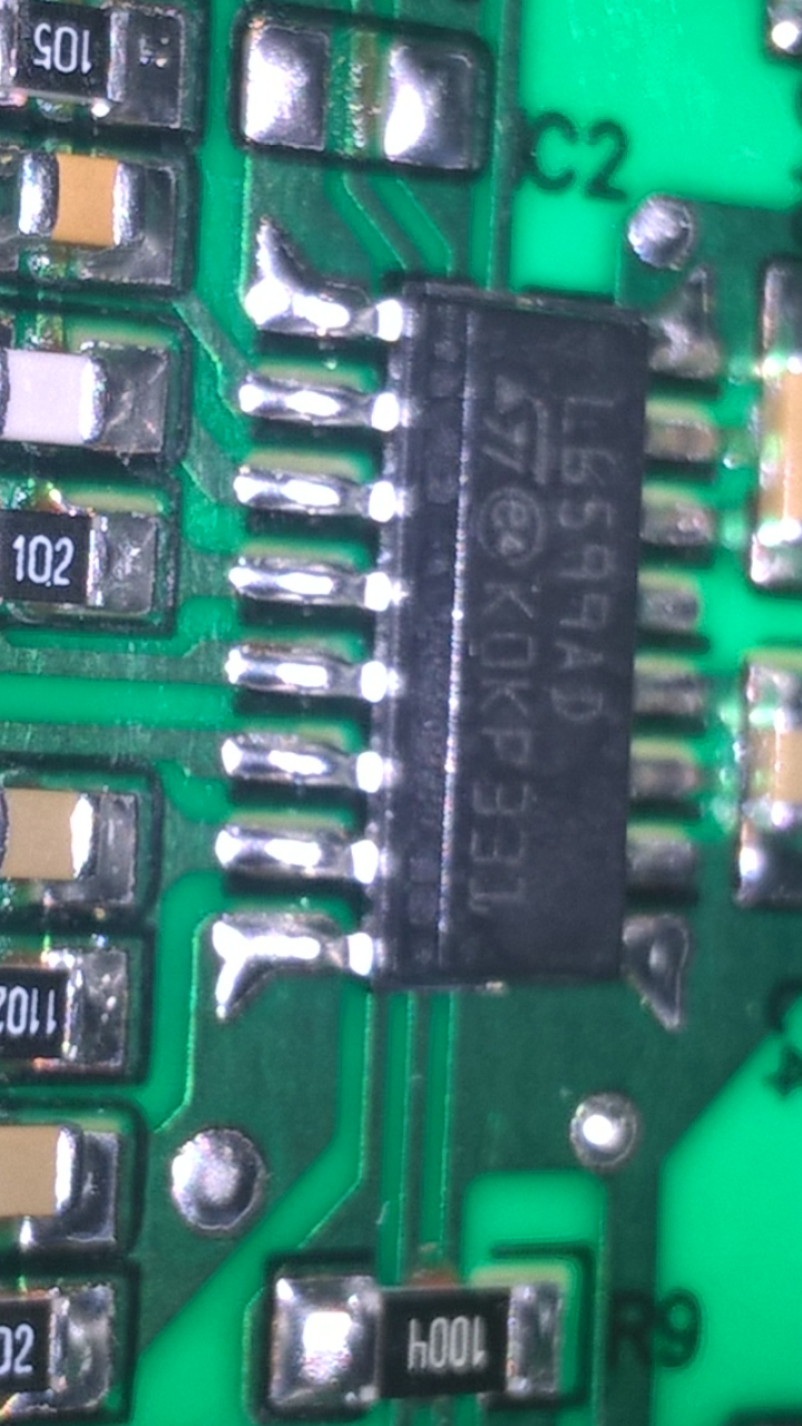

                            #113
                            Re: Rca led50b45rq
                            Post a photo of the IC to help identify pin 1
                            • x_orange90_x
                              • May 2015
                              • 727
                              #114
                              Re: Rca led50b45rq
                              If you google an image of this chip, some of them do have an indicator hole located in that bottom left corner.
                              • dick_barton

                                #115
                                Re: Rca led50b45rq
                                Is there a chamfer down the left hand side of the IC looking at the photo you've just posted?
                                • x_orange90_x
                                  • May 2015
                                  • 727
                                  #116
                                  Re: Rca led50b45rq
                                  The attached picture is from the other side of the chip.. No chamfer

                                    #117
                                    Re: Rca led50b45rq
                                    Is there a chamfer down the left hand side of the IC looking at the photo you've just posted if not then it looks like as you have already numbered.
                                    http://wb5rvz.org/common/locatingPin1
                                    • vinceroger69
                                      • Mar 2012
                                      • 6714
                                      • uk
                                      #118
                                      Re: Rca led50b45rq
                                      i have fitted one of these ics a while ago and fitted it thinking bottom left was pin 1 the psu worked fine so must of been correct

                                        If I am correct one of that IC pin should have direct connection between the two points. That switched Voltage source has to used for something.
                                        • x_orange90_x
                                          • May 2015
                                          • 727
                                          #120
                                          Re: Rca led50b45rq
                                          OK.. I think I've finally got what you're looking for. Between PIN 12 (yes, the one we've referred to the entire time) and that point you marked (which i believe is C5 capacitor on the other side), i got 1.4-13 on the 200 scale. ALSO, this time between the out going side of resistor 000 and PIN 12, i got 5.7-195 on the 200 scale.
